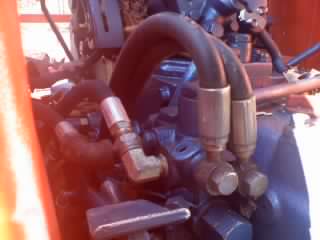

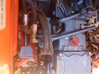

I can email pictures of the valve & lines,

Here are two views, Hopefully it is a common hook up on tractors!

Great information. Now a couple questions,
Does the Logsplitter have it's own control valve?
Is it an open center valve?
Did you want to add remote plugs to the back of the tractor?
Please let us know. You have a few options for setting up your hydraulics.
