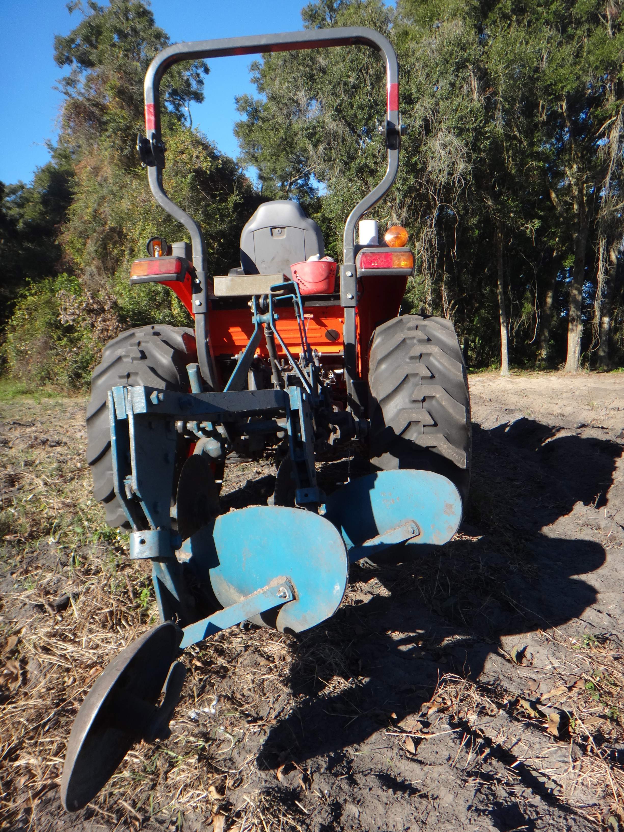

R4s are usually right at 12" wide on 25 horsepower to 35 horsepower tractors. I have R4s on my Kubota L3560 pulling 12" a two bottom Ford 101 plow and the R4s fit in the furrow fine as the tractor weight bears.
To be sure, put a tape measure across the tread of your rear tires. Google is not enough.
