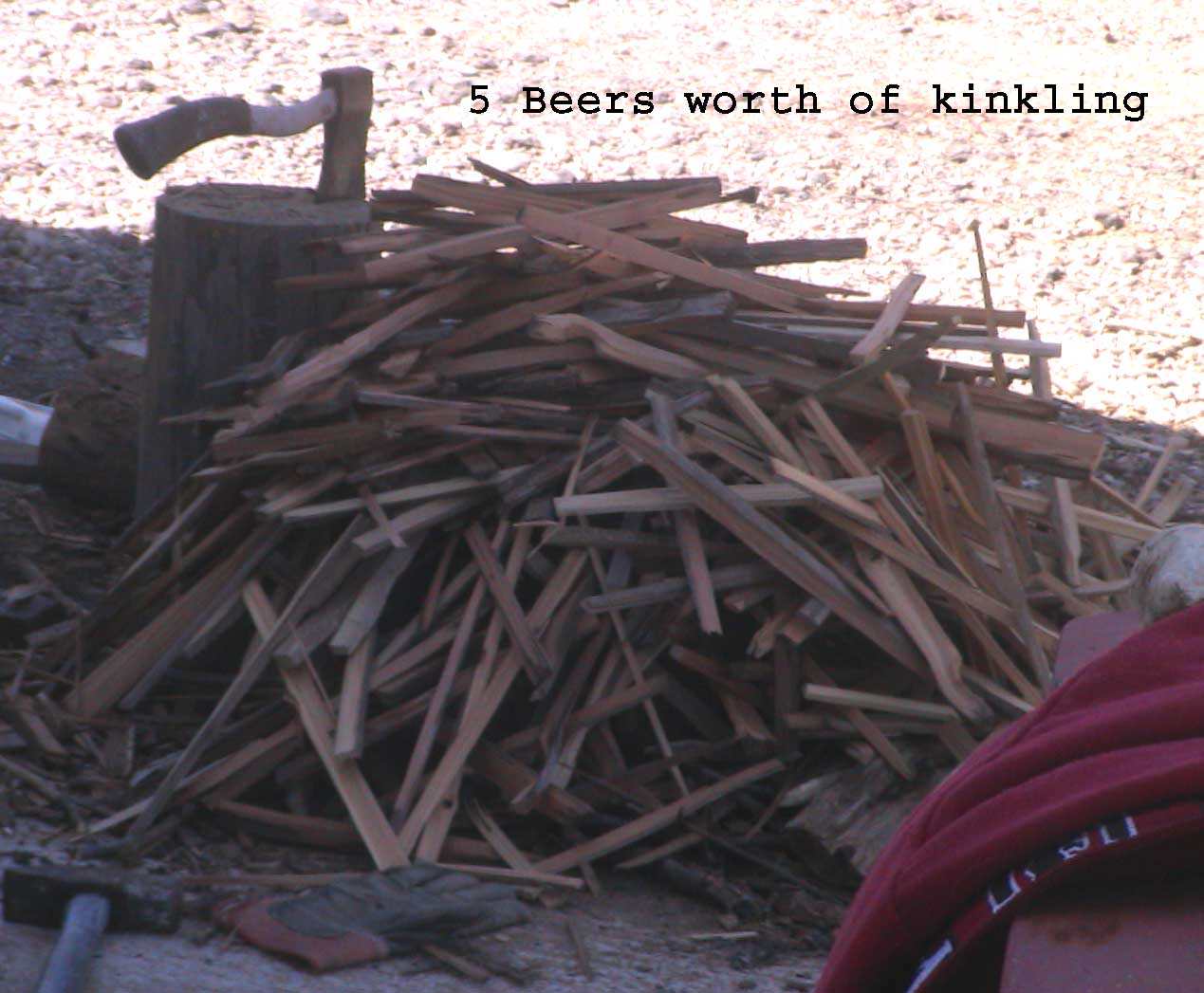

/ kindling machine #27
im an eagle scout so paying extra for some one else to us a hatchet seams mad, however you can probably call a fairly high price for kindling get dried ceder and split it a super sharp hand ax will cut it right up work with say 8-10 inch pieces a litttle safer than 16 in, also you could buy cader shake and split it prolly just break even on it but would satisfies the customer,
I fine it hard to believe that some one can't or is to lazy to split kindling. :(
I started to split kindling when I was about 4 or 5, now at 71 I can still do it. Don't wait until its needed, split a little at a time through out the year. When I Don't feel like working and need to get my blood circulating I split a little. Some times at the end of the day to wind down, I have a beer :thumbsup: and split a little.
Construction cut offs are great and easy to get.
Don't put you holding hand on top. hold what you are splitting, about 1/2 down, sink your hatchet, then just pound you block.
If that is too much for you. Throw out your wood stove and get an oil burner.
Safety Police, yes I still have all 10 fingers and have not ever really hit my holding hand with the hatchet.
