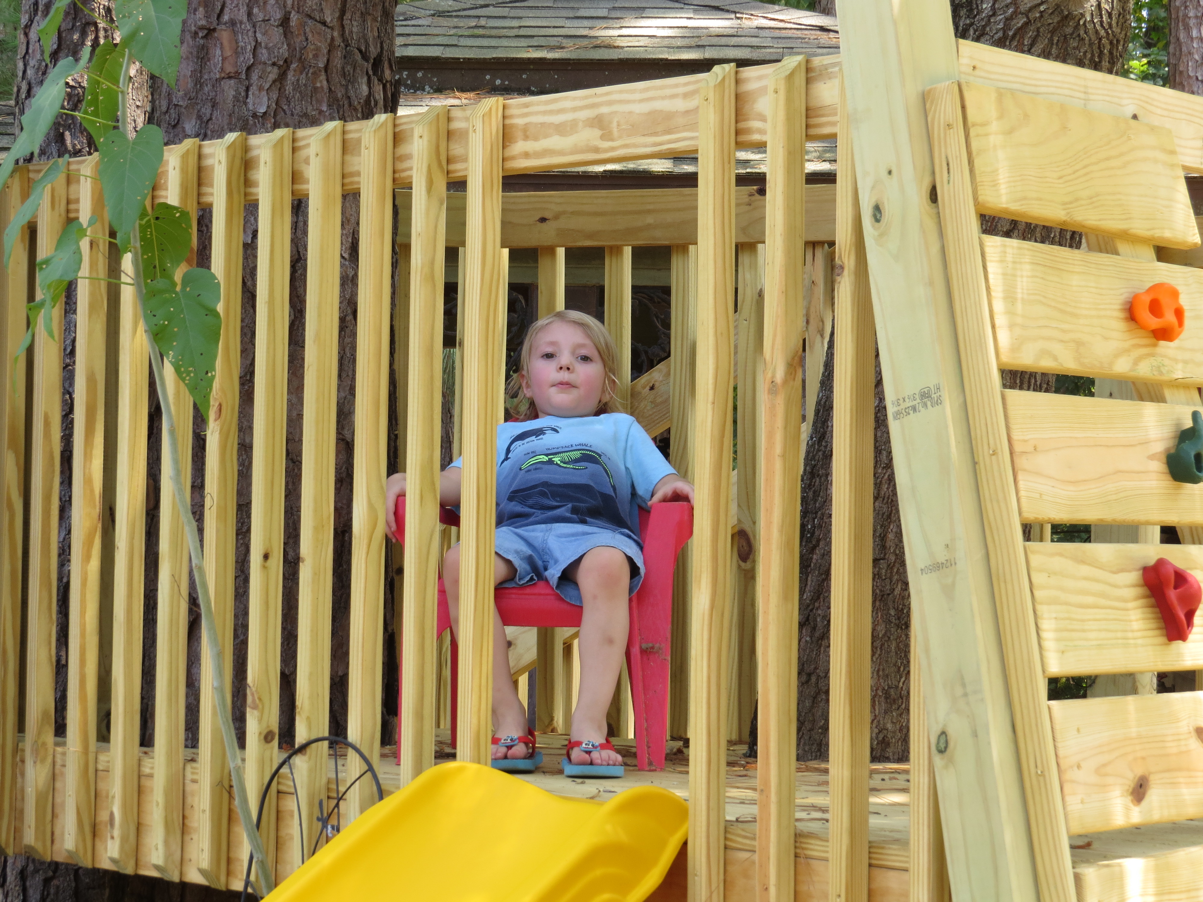

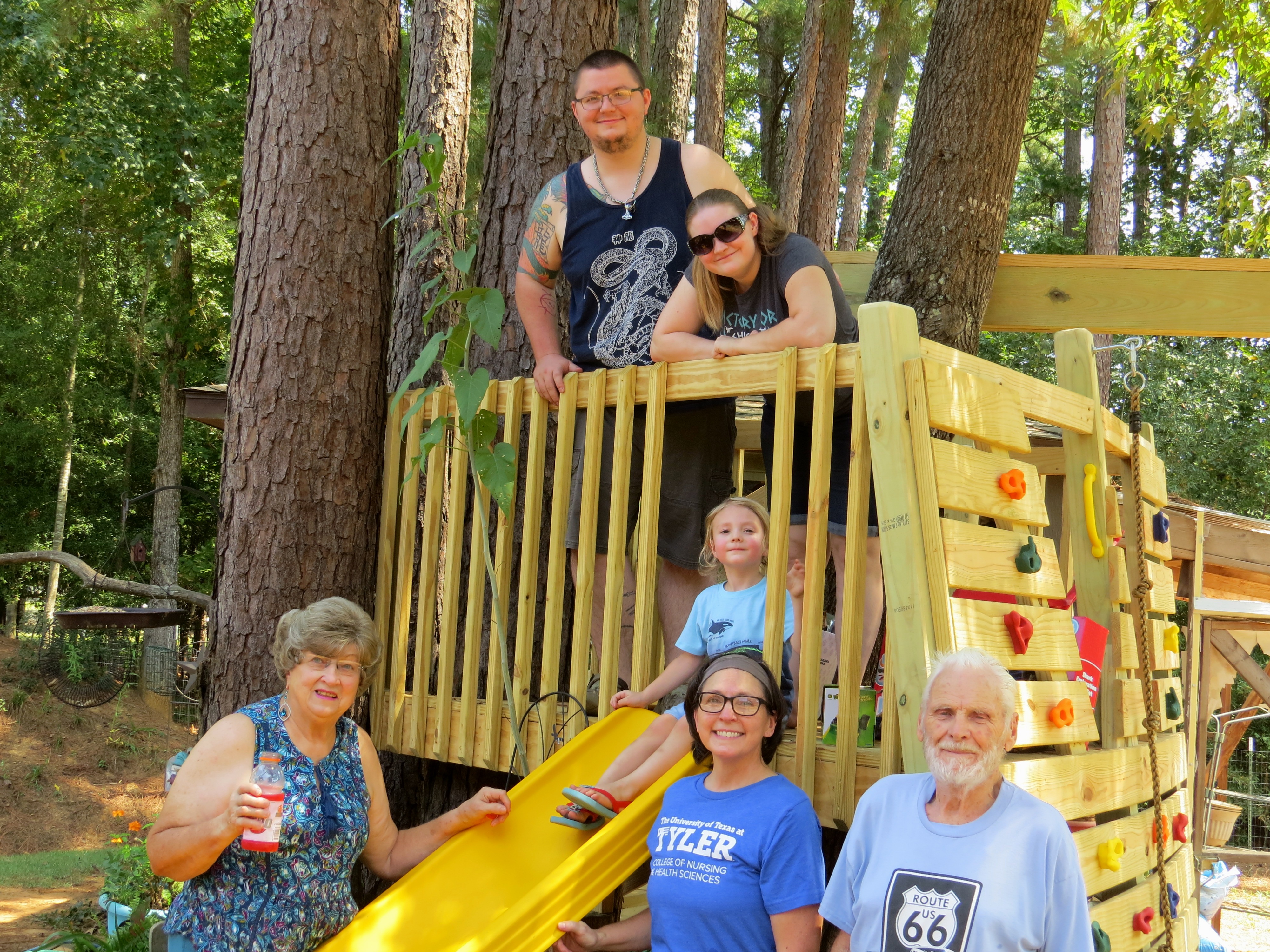

Finished Phase 1 of the playground and we surprised him with it yesterday.
I bought the slide from Home Depot. It was a lot cheaper then Amazon, but I had to pick it up at Home Depot. The rock wall kit and swings where from Amazon.
Once the slide got here, I was able to determine the height for the deck. It's supposed to be 4 feet up, but I'm building on a slight slope, so I measured with a level from where the slide touches the ground and went up 4 feet. When done, we felt it looked too steep, so for his party I put a sack of red mulch under it and another to land on. We're going to take it out because that was a little slow for him.
I angled the posts for the rock wall, and rounded the wall. I thought this would make it nicer. Since I've never done any other version, I don't know if it was worthwhile or not, but I like it this way. I also created a W into two openings for him to crawl through on the rock wall since his name is Warren. The kit came with a rope, so I added that. He doesn't have any interest in it yet, but he might in time. It also included the handles, but he hasn't used them either.
The swings turned out to be a huge hit. Neither my wife or I can remember the last time we swung on a swing. It has to be several decades. When I tried to swing for the first time, I wasn't sure how, but then it sort of came back to me. I just don't remember it taking so much effort to get going!!! Warren absolutely loved being pushed on the swing. I made one lower for him, and the other at adult height. Warren would just giggle and say how much fun it was. So when his dad wanted a break from pushing him, I would take over, and then my wife took over. He swung for a very long time!!!
We put "his" chair up there, and he went right to it. He opened his gifts up there and that was great for photos.

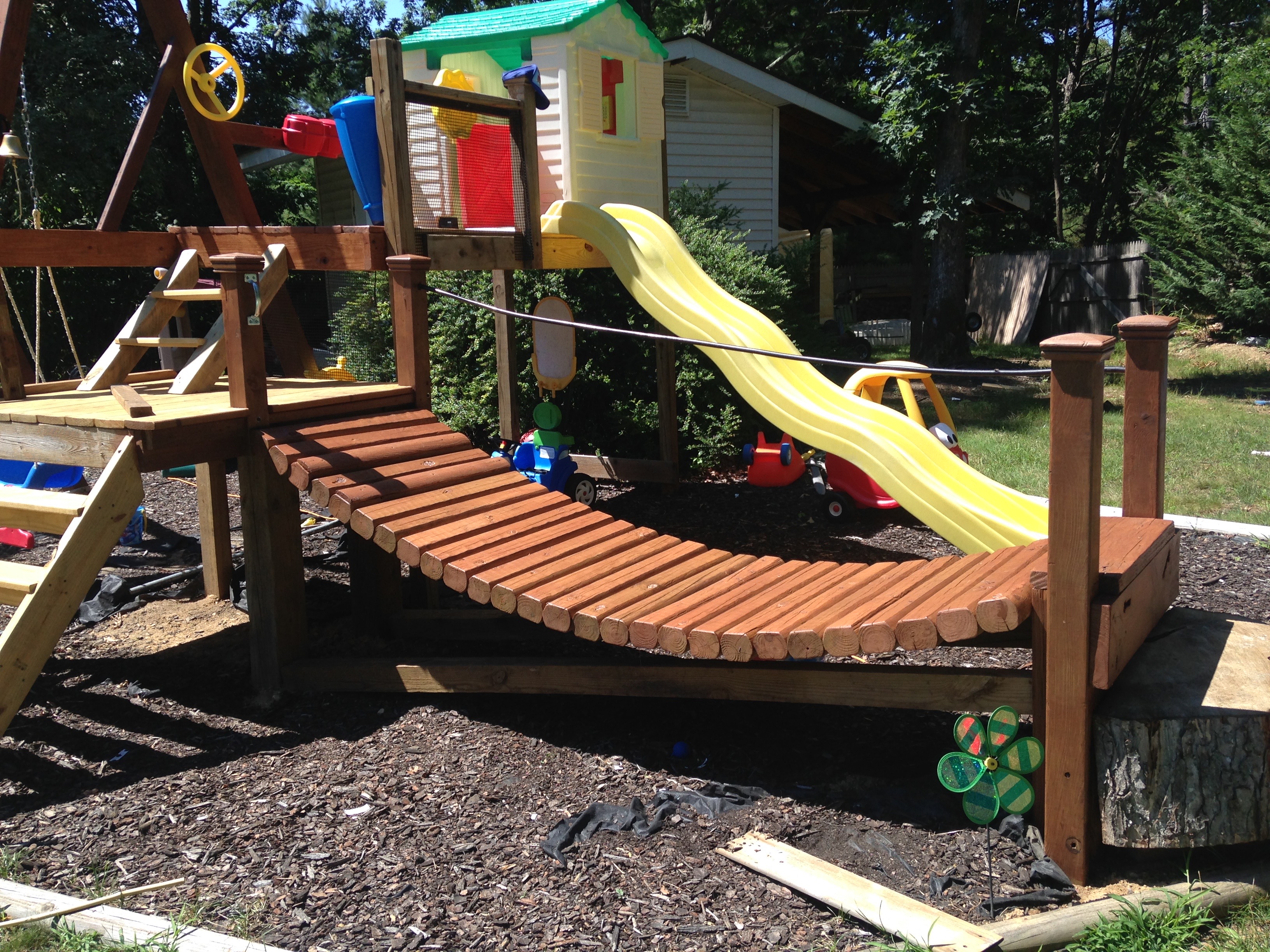

Some stuff I built for the grandkids. Wood bridge is a clear favorite.
Swing made from 12 ft. 4x6s from Lowes. Pirate ship uses dog ear fence pickets from Lowes.

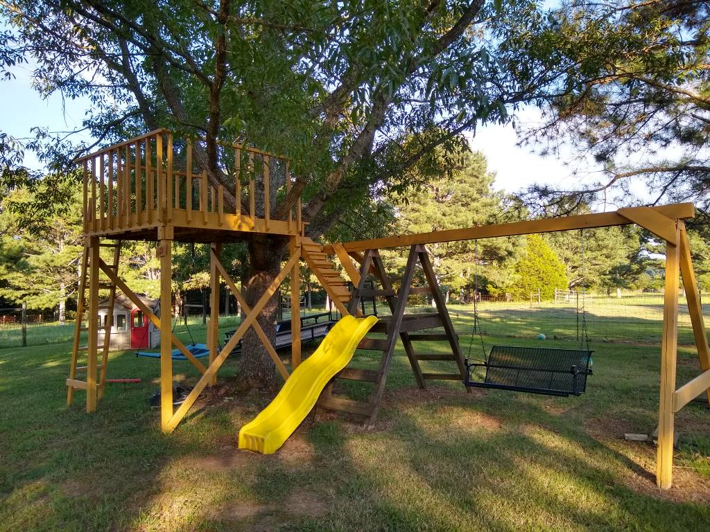

Here's something I threw together for my boys which is built off of an existing swing set which was given to me. Part of the platform was an old deck. I just reused the joists.
I have more pics of you want any.
That is superb! Great job; looks great too! I do have one question; how are the rails secured to make them strong enough to stand up to rambunctious little rascals?

Very creative and nicely done!!! I have a few ideas for Phase 2, and then Phase 3, but haven't thought of a bridge like yours. What did you run through the timbers? I'm thinking cable so it will last.
Made the first one in the 1980s for my kids.
My daughter ( lower left kid) wanted me to make another for grandkids a few years ago.
First one I used ground wire from house service wires.
For the new one it was steel cable from Lowes.
Landscape timbers stained for bridge cut around 31".
