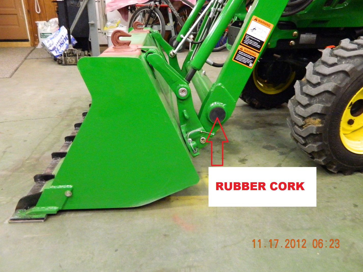

Nov 17, 2012 / KEEPING THE BEE'S OUT - FEL #1 BIG DOOLEY Platinum Member Joined Aug 25, 2012 Messages 601 Location MICHIGAN Tractor JOHN DEERE 2320 I had bee issues with my clothes line pipes and some fence posts near my kids pool in the backyard. This is how i keep the bee's out. Rubber corks. Tom

Nov 17, 2012 / KEEPING THE BEE'S OUT - FEL #2 bigtiller Super Member Joined Feb 1, 2006 Messages 7,540 Location central Iowa Tractor John Deere 2720 John Deere 3039R John Deere Z545R That looks nicer than the expanding foam some use. Where did you find a rubber cork that big?

Nov 17, 2012 / KEEPING THE BEE'S OUT - FEL Thread Starter #4 OP BIG DOOLEY Platinum Member Joined Aug 25, 2012 Messages 601 Location MICHIGAN Tractor JOHN DEERE 2320 Size 13 Black Rubber Stopper Each Solid 68x27x59mm | eBay Is a link to ebay. Grainger sells them in a 4-pack I used #13 stoppers Tom Last edited: Nov 17, 2012
