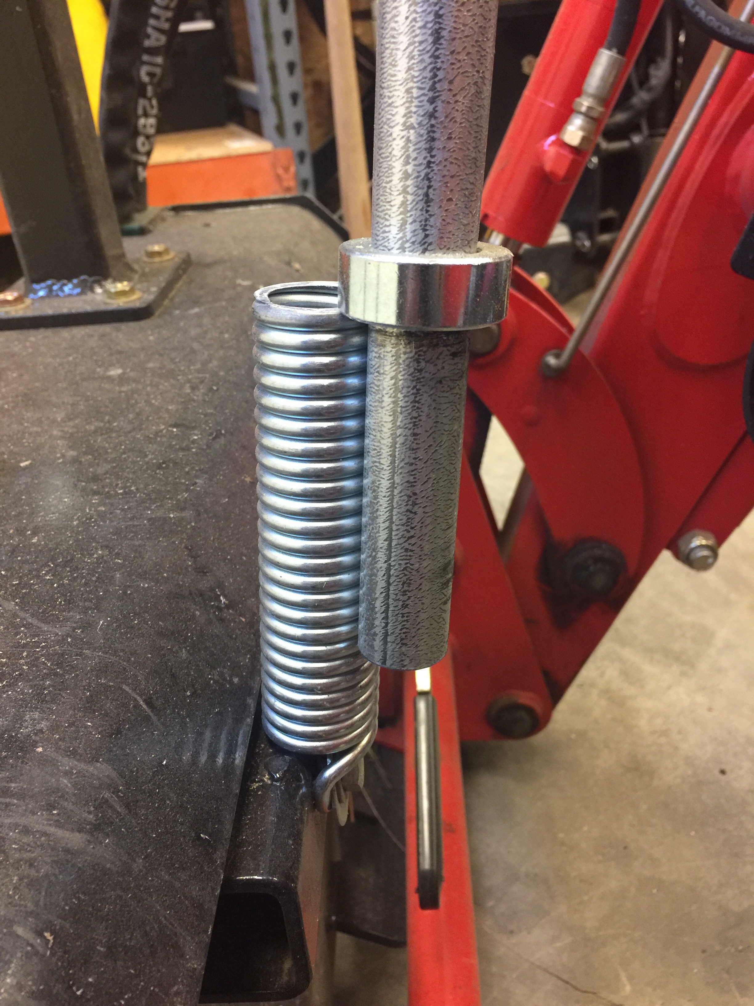

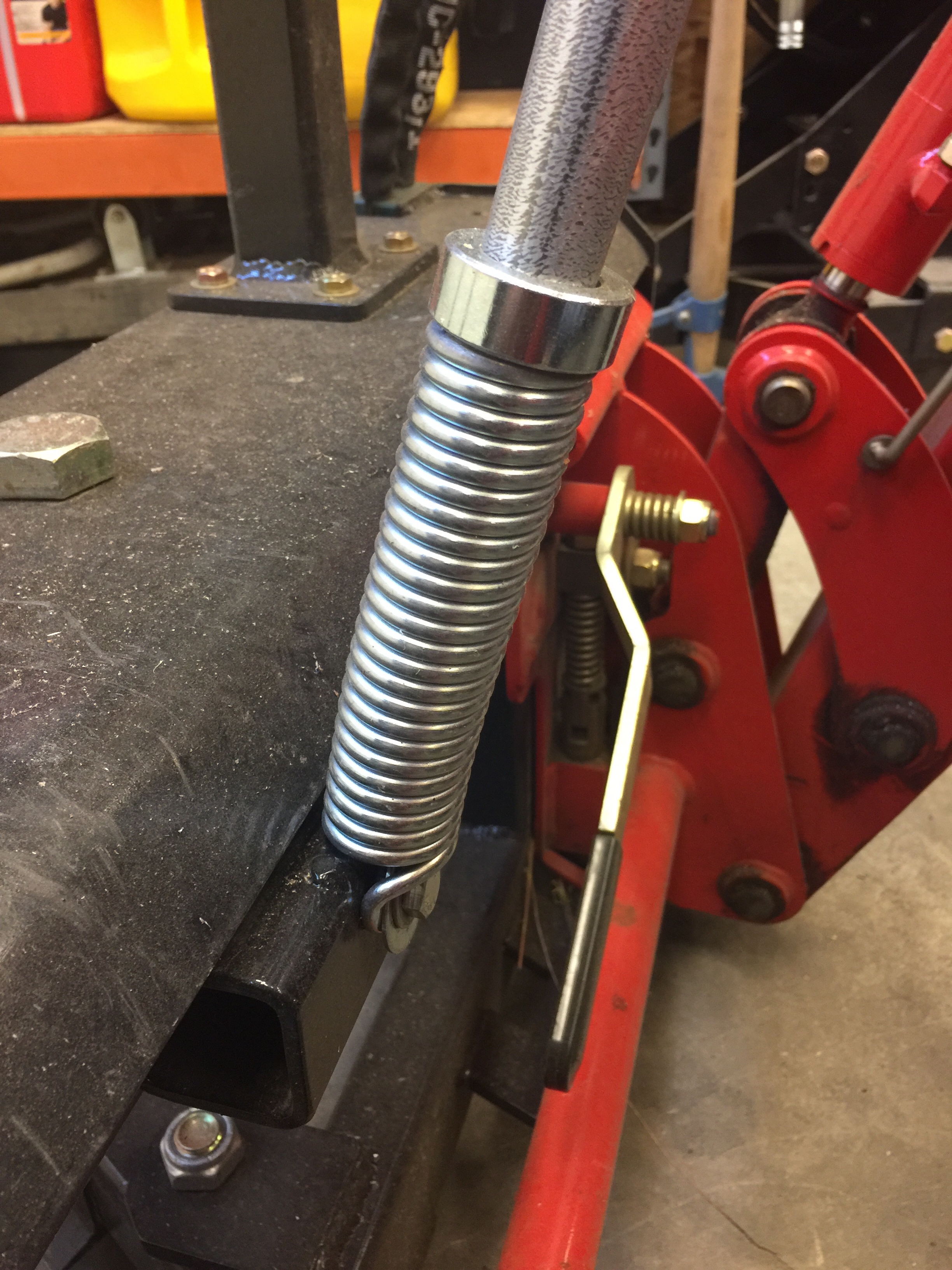

I’ve made my own with a spring from Ace hardware, dual hose clamps from the local hydraulic supply house, an electrical conduit pipe, a ring collar with set screw and a little welding to put this together. It sits in the spring holder loosely and doesn’t fall out unless it gets snagged so I consider that a plus. I built two, both stay on my grapple and the tree puller that I built.

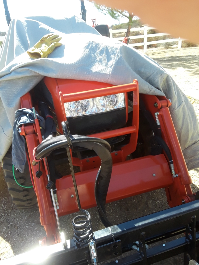

Ive seen in the past a metal spring deal with two eyelets on the ends for securing things that required a lot of stretching.
My grapple hoses are dragging/just getting in the way, I'm afraid tbey are gonna catch something.
Can someone tell me the name for that springy thing that might work.
If this was my machine Id start by putting a 90 degree bend in the bracket attached to the loader boom so the hydraulic couplers would be facing forward instead of pointing to the ground.
/ Keeping hoses off ground #27
Yup, that would be my first step also.
