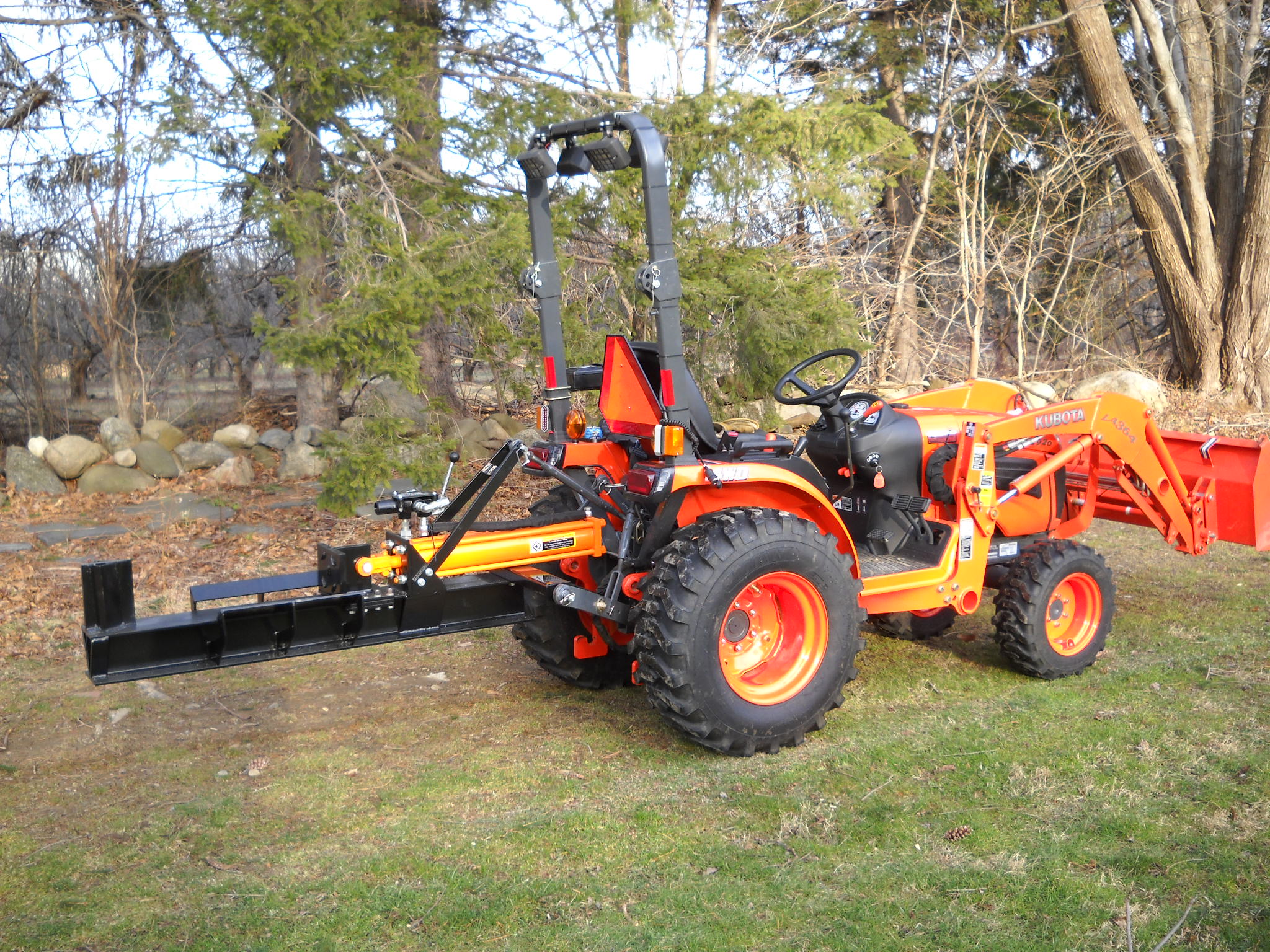

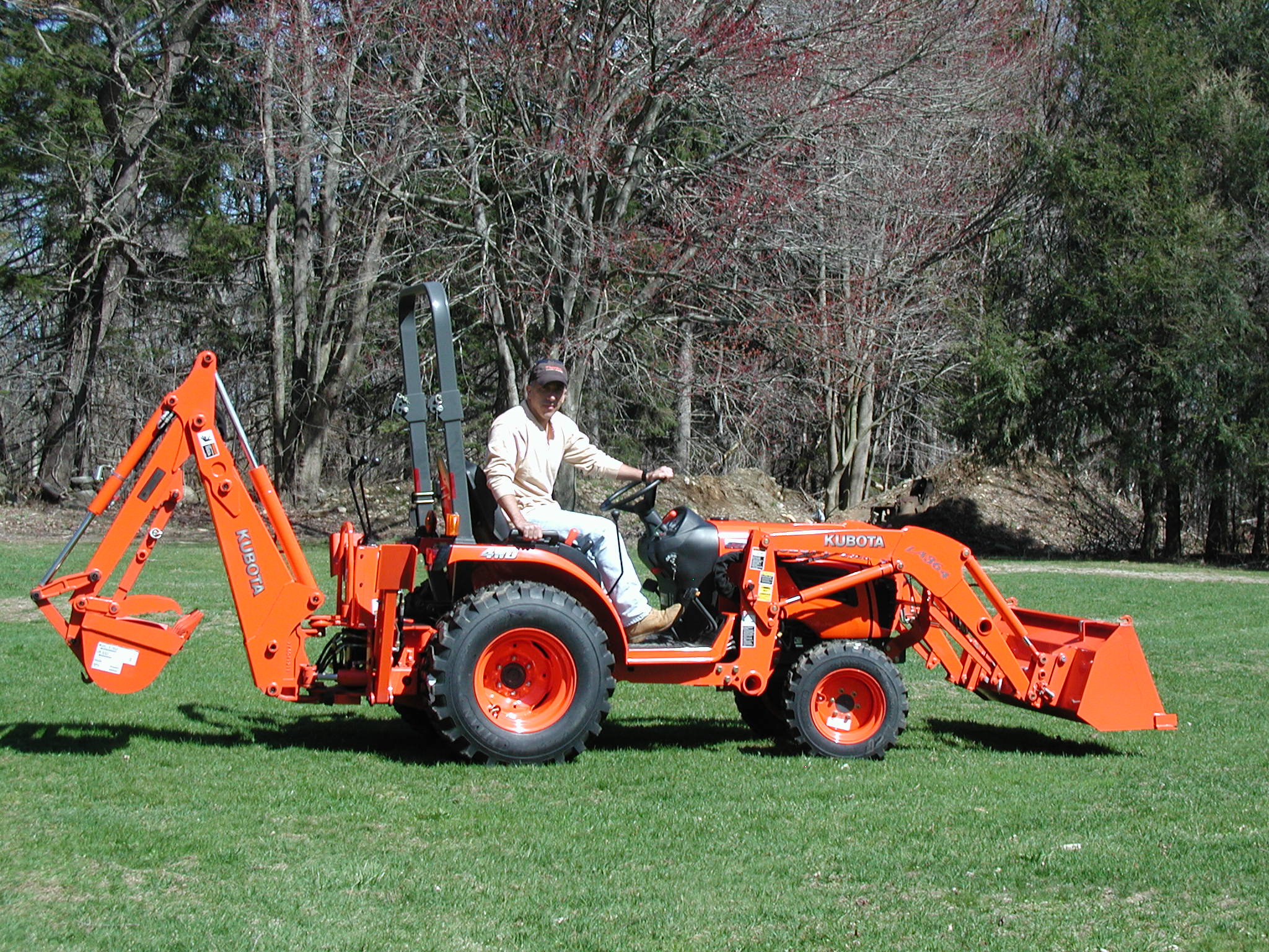

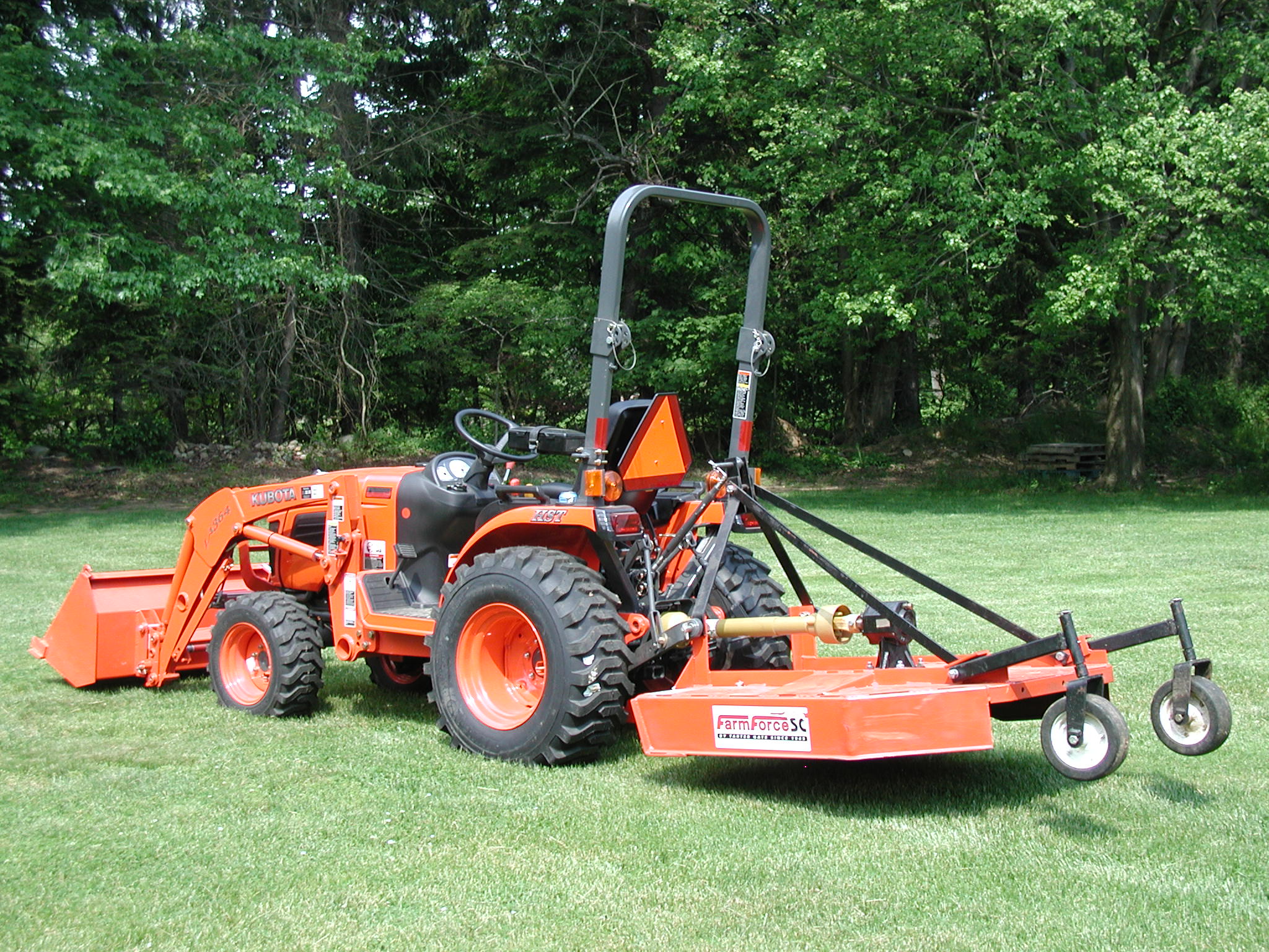

As with Chuck I too had a BX (first a BX2200 and then a BX22). Last May I went with the B2920 - not that I needed it but I had the tractor itch and needed a scratch. The BX22 would have done all I needed however I too like the idea of a bigger tractor. I only have 2 acres for my primary land and 24 at my other property. I use the B 75% of the time on the 2 acres. It will NOT mess up your lawn - I have R4s. Of course if it is really wet then thats another story. At the end of the day I am not looking back. I do miss the BX22 at times it was a kickin tractor but I like the bigger platform - for me it fulfills my need for a tractor that looks like a tractor and not a lawn mower on steriods (this is to be a a compliment). BTW - I thought the B3200 was where I wanted to be but it was a seat of the pants feel I had when I sat on a B2X20and a B3200 side by side - no question but for me the B2X20 was the ticket.

As with Chuck I too had a BX (first a BX2200 and then a BX22). Last May I went with the B2920 - not that I needed it but I had the tractor itch and needed a scratch. The BX22 would have done all I needed however I too like the idea of a bigger tractor. I only have 2 acres for my primary land and 24 at my other property. I use the B 75% of the time on the 2 acres. It will NOT mess up your lawn - I have R4s. Of course if it is really wet then thats another story. At the end of the day I am not looking back. I do miss the BX22 at times it was a kickin tractor but I like the bigger platform - for me it fulfills my need for a tractor that looks like a tractor and not a lawn mower on steriods (this is to be a a compliment). BTW - I thought the B3200 was where I wanted to be but it was a seat of the pants feel I had when I sat on a B2X20and a B3200 side by side - no question but for me the B2X20 was the ticket. Good Luck, have fun and be safe
