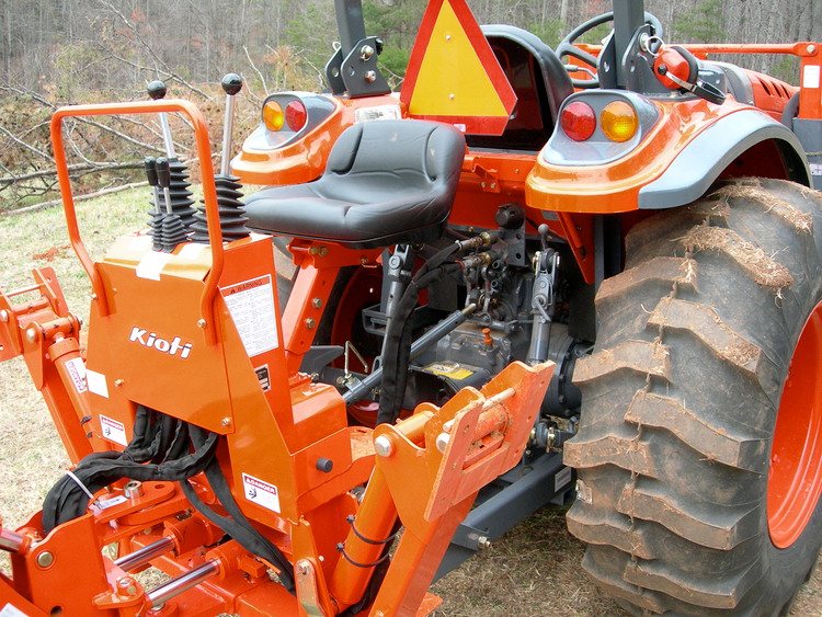

From this picture,"it appears" the pivot plates on your hoe are the same length as these, so it looking like cylinders. Get measurements if you can.

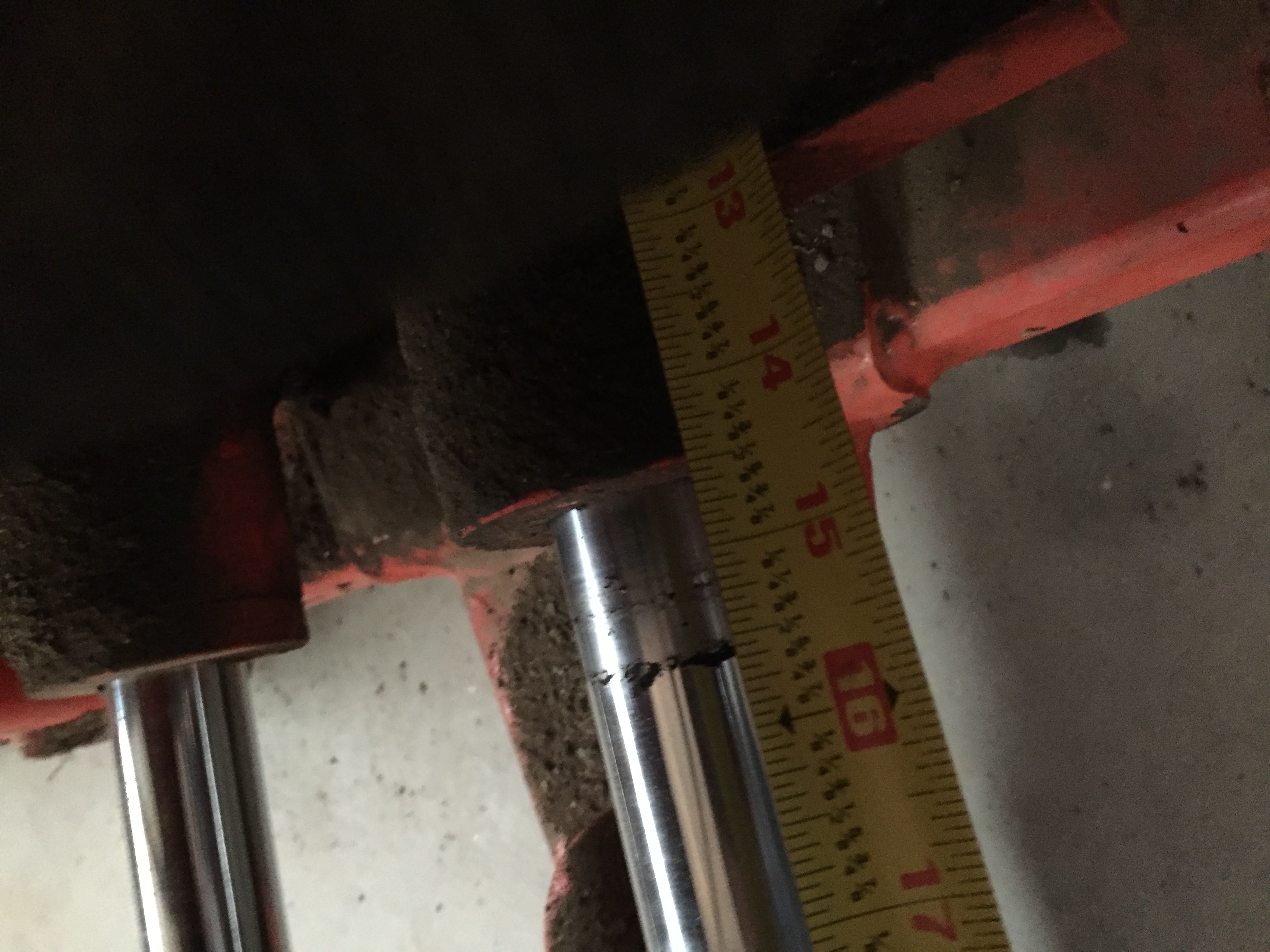

It appears your 2385 cylinders are smaller than mine so the theory you have the wrong cylinders maybe true. Hope this helps. Shortening the shaft will only create a bigger problem, maybe adding 2" block attached to the end could help. cylinder.JPG
   / KB2385 limited swing #27
If I hook a tape on the flat end of the cylinder, I measure 10 5/8” to the center of pivot and 14 3/16” overall cylinder length. According to my backhoe Manual KB2475, the swing cylinder assembly part number is 2252-6000.
   / KB2385 limited swing #28
My picture is from flat end to flat end of cylinder. I have a 2385, the swing cylinder part # is BS 18-0100 So if his 2nd picture is done the same way his cylinder is 2" short. I would guess that would equate to 4" or so.

I suggest it's as simple as disconnecting one cyl at the OB pin and swinging fully to one side as was mentioned.
It's there that I believe what 2" more travel (9" vs 7") can be easily recognized as adding SO MUCH more to swing. (a geometry thing)
That said, I also agree that the swing cylinders were most likely replaced with the shorter (read 'cheaper'?) ones that would 'bolt up'.
