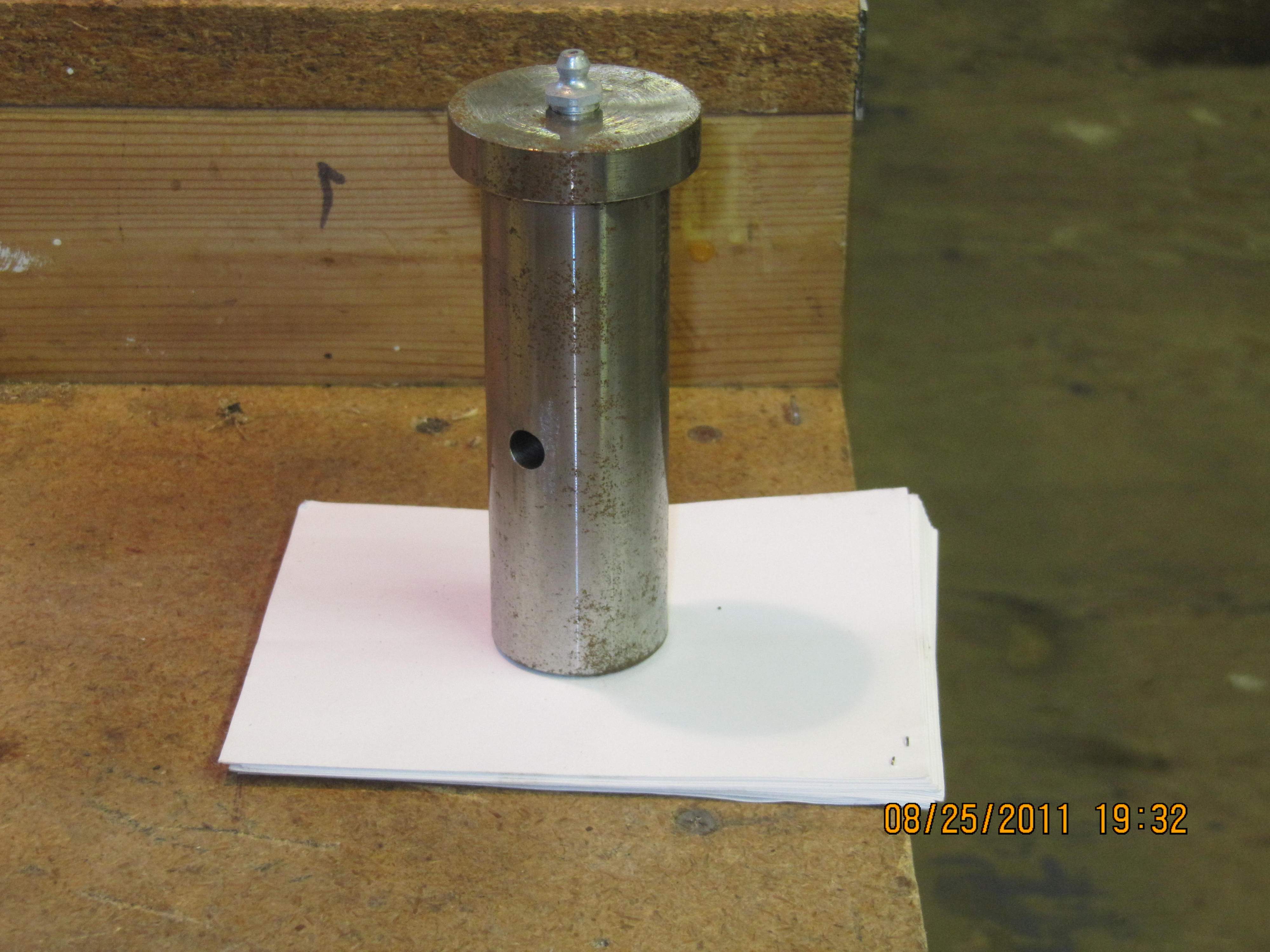

Happened to me, twice. I blame poor design and me. I think the problem is the small bolt that holds pins in place at bottom of pin. They break over time and when passing over very rough roads too fast. First time, I had just started digging after driving over stone path. Second break occured when in transit, not digging. Once the bolt breaks, pin drops out (because there is no top hat/crown to hold it from falling through). Once pin drops enough to free one or both pivot plates, bad things happen including the same break on cyl knuckle as you. I have had two new pins made that are same dimensions as old but have a top hat/crown. I will take photo's after work and post.
   / kb2375 backhoe broke again #8
Here is a photo of the pin I had made. Same dimensions as OEM except I added the top-hat. Drilled the zerk and it's good to go.

What matters is do YOU think it is a good deal? Are you able to afford to move into another BH at this time and do you use any BH enough to justify the price of a trade? Or do you want to find out what it will cost you to refix this one, hopefully permanently- with the suggested mod of the capped pin with built in Zerk?
If you can afford a trade it might be your best bet- but remember it only comes with a 1 yr. warranty.
