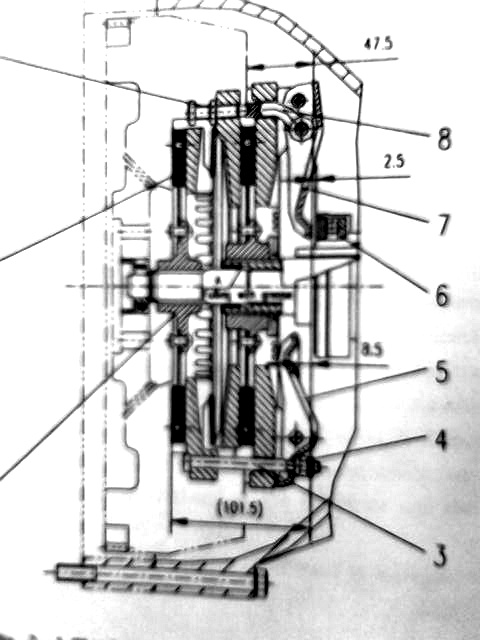

WOW! I'm almost there. Hydraulics working, FEL is working. Somehow I managed to mess up the throttle lever that's on the right rear fender. A lot of slack in the cable and no springs appear to be missing. No huge thing I can probably figure that one, BUT I think my last hurdle is the proper clutch adjustment.
I only let it out about an inch from when it disengages and it's pretty herky-jerky and I'm afraid to dirve it for fear it'll die again.

From what I have read the fingers have to be almost exactly the same clearance from the throw-out bearing or it will do what you described. A shudder when the clutch engages?

Many, Many thanks to you!! PTO works, Hydaraulics work and even the doggone clutch is working reasonably well. Fixed the throttle linkage too!
