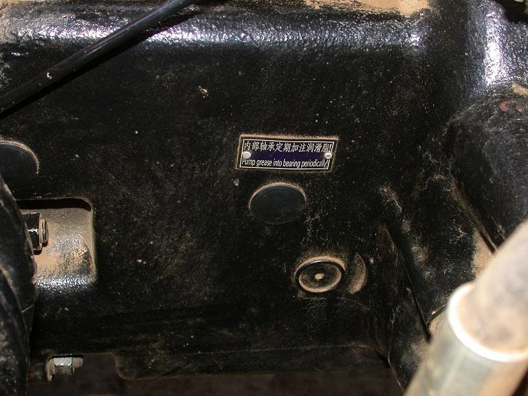

Hi,
I need some help here with figuring out where to add grease related to this little sign on the right side of the flywheel housing (I think that's what it's called)...I'ts the housing right behind the engine but in front of the transfer case.
There are 2 rubber plugs and a sign that says to "pump grease into bearing periodically" What are they talking about?
I'll attach 2 pictures for anyone who knows.
Isn't that where the dry clutch assembley resides? Is there supposed to be grease or oil in there?
Thanks,

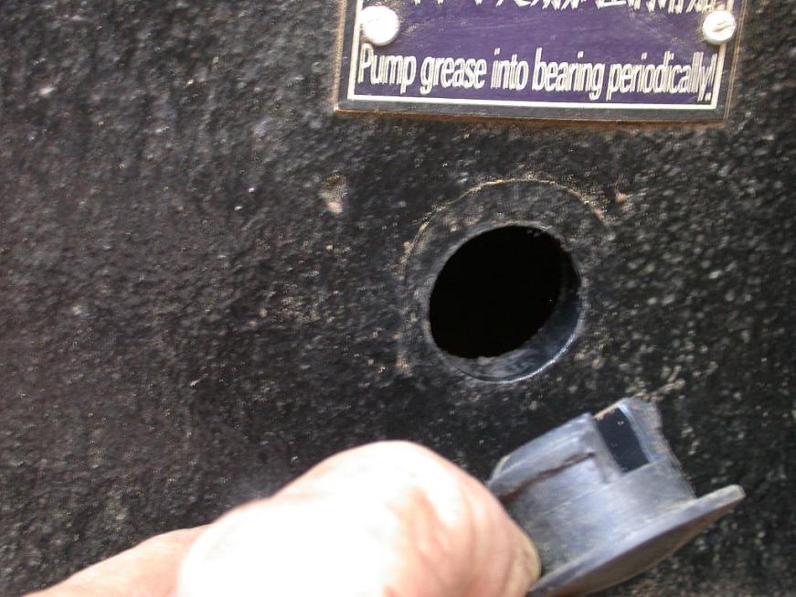

</font><font color="blue" class="small">( There are 2 rubber plugs and a sign that says to "pump grease into bearing periodically" What are they talking about?)</font>
Attached is a close up picture.

There is a zerk fitting inside on the slide for the throw out bearing., it will work best with a rigid grease gun. This greases the slide for the throw out bearing to travel back and forth. don't overgrease it or you will end up with a lot of grease in the bellhousing (it would take a lot to get enough flying around in there to get into the clutch, but you dont want a greasy mess if/when you split the tractor.

Do I access this zerk through one of those holes covered by the rubber plugs then? Is that correct?
   / KAMA Flywheel Housing #5
yes, should be the plug by the little sign that says to grease here.
   / KAMA Flywheel Housing #6
Chip is correct. Pull the plug. I used my little pen light to see.
I did use a flex line but it would be much better with a rigid type
Patrick

What about the rubber plug to the left of the one where the grease nipple is? Is there anything in THAT hole to grease? You can see it on the attachment in the very first post above.

nothing behind the other plug, just access inside the casting. No grease to rear axle bearings, they are massive roller bearings and lubed with the rear/trans oil.
