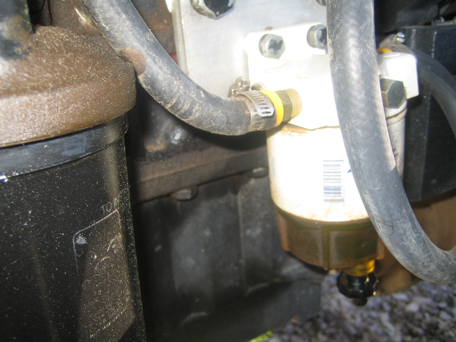

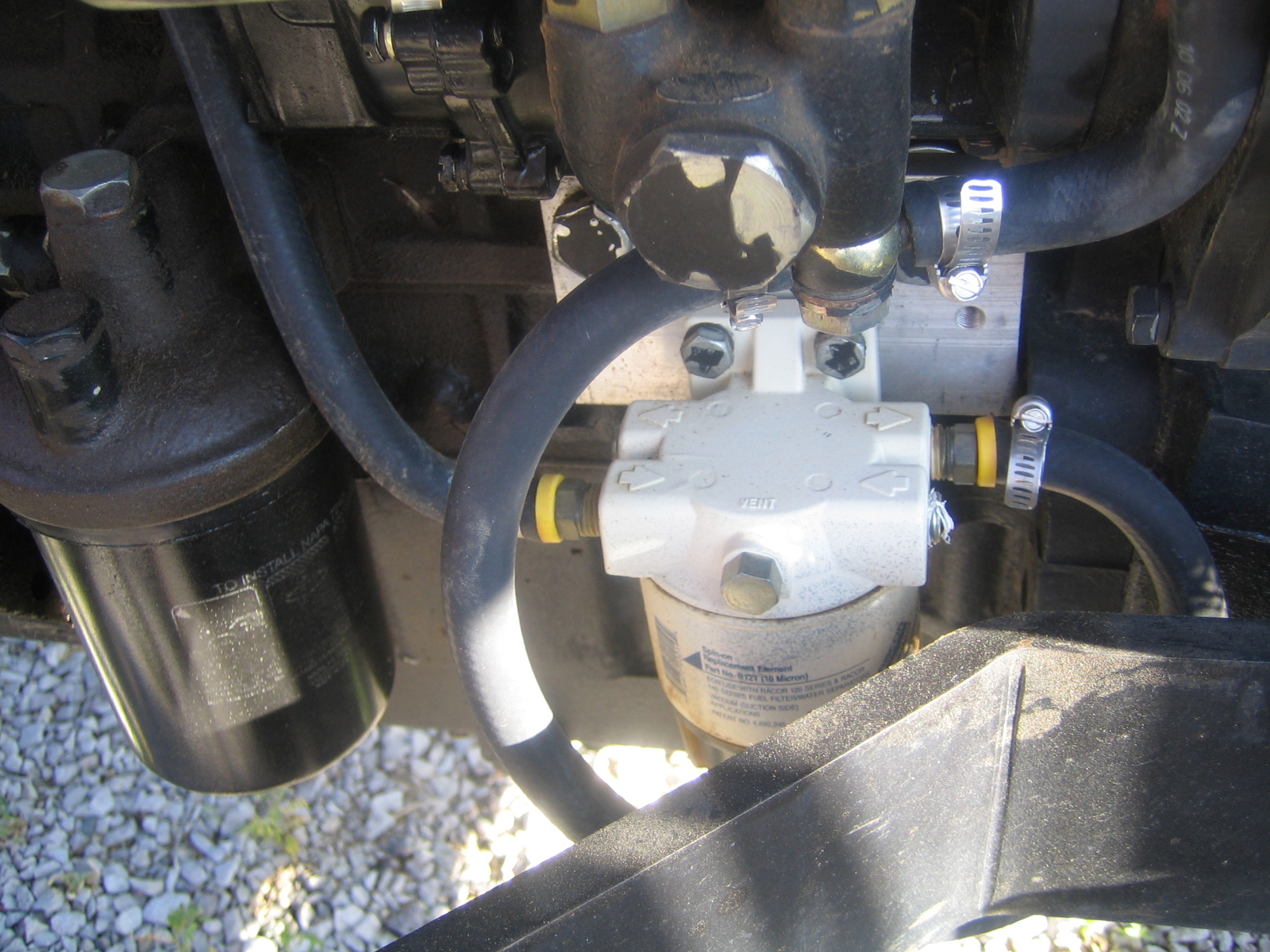

That's one of those baby Racor's and it possibly has one of the 3µ coalescing elements in it which won't pass water, and bugs will plug it in a New York second. Unfortunately it's a cartridge filter so you can't inspect the element. Check the screen in the top of your sediment bowl.
The same thing I said about running out of fuel and the bowl remains full also applies to the Racor filters.
/ KAMA 454 engine dies when warm... #22
Take that filter out of the loop for a test run.
Chris, you may not realize doing that will introduce unfiltered fuel to the injection pump. That after-market spin-on assembly has been bolted in place of the OE cartridge filter assembly.
That said, the problem could be with the spin on filter itself - specifically with the bypass valve. When removing the original assembly, the original bypass capability went with it. That gray spin-on cartridge may have the wrong kind of bypass valve for your fuel pressure. Or maybe it just failed, and the filter itself needs replacing.
//greg//
/ KAMA 454 engine dies when warm... #23
Yea Greg, I did not realize there was a filter there to start with. I guess the best thing to do would be set up another fuel tank to feed the injector pump directly, bypassing he filter. That way you know the fuel is clean and you are eliminating all the hidden in hose screens and possibility of a collapsed hose.
