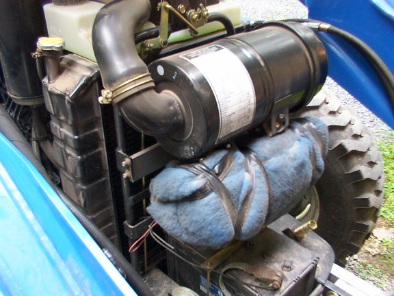

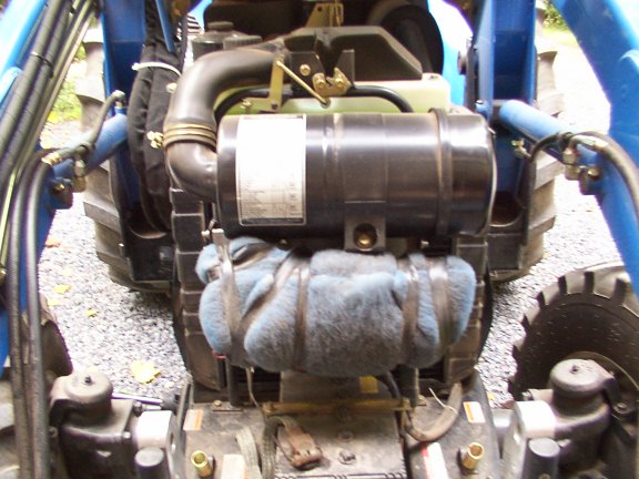

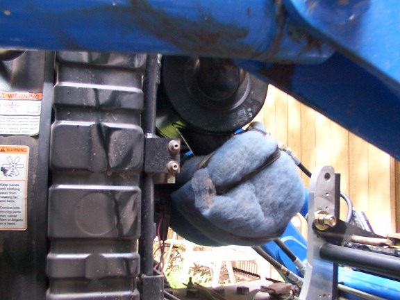

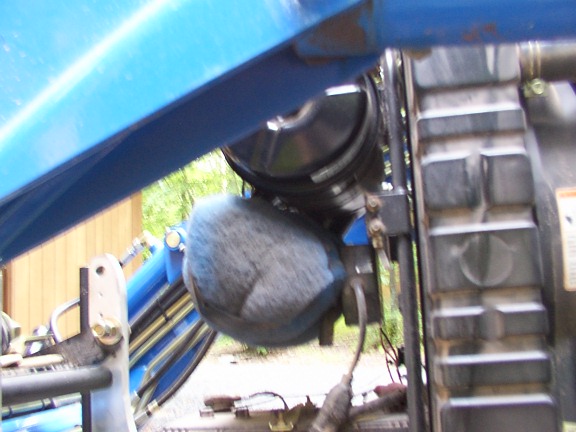

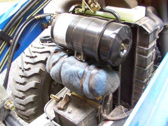

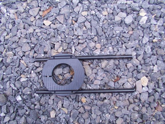

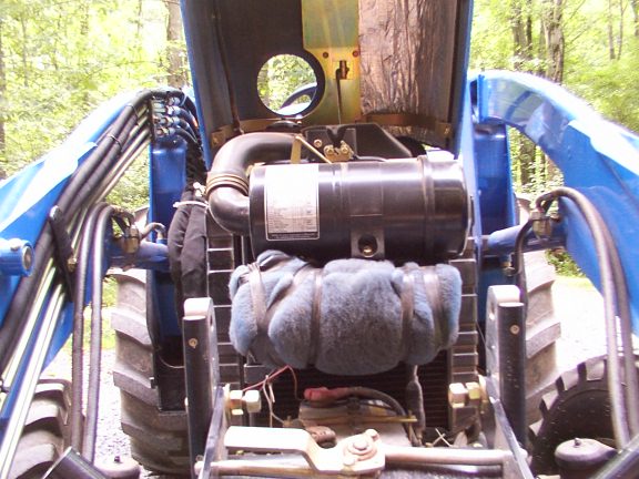

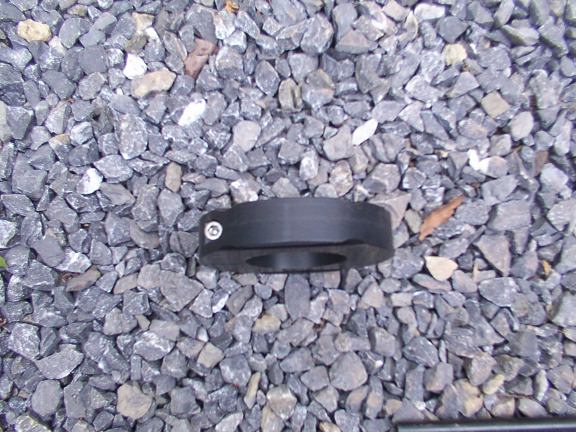

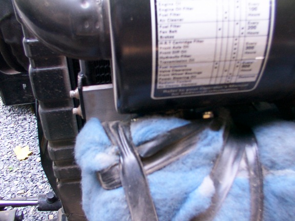

350, yep! With you on both points. Cost, and needing a large area. I also thought of using a shop vac filter. Large area, and lends itself to using PVC plumbing pipe, and hose clamps. Abandoned that idea also after inspecting several at Home Depot ans seeing that they have a thick filter material than regular air cleaner paper elements. Here's a few photos of what I did. I've run the tractor all through this summer, and the temperture gauage never goes above 1/4 from the cold mark. I guess it's a bit of a cold running beast. The radiator is a heavy duty unit as you can see from the pictures.

Well fellers I serviced the prefilter, and there wasn't that much to toot out. It's a breeze to wrench off, and reverse blow out from the inside with compressed air. How are the builds goings???????:)
