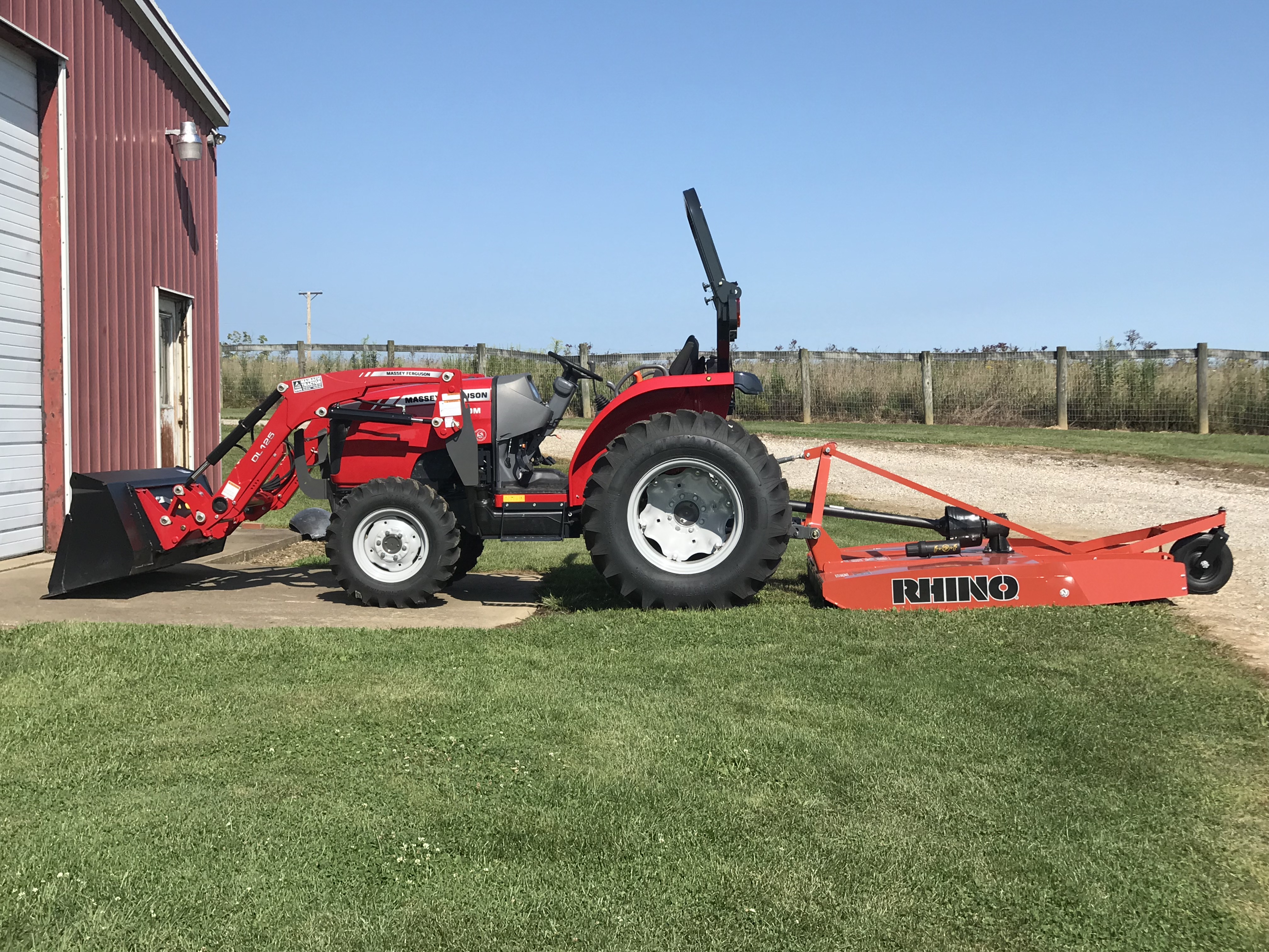

Tractor was delivered this morning. Unfortunately I will be out of time for the next week so my wife will be breaking it in. Only question I have right now it that some of the controls seem a little stiff. Will they loosen up over time?

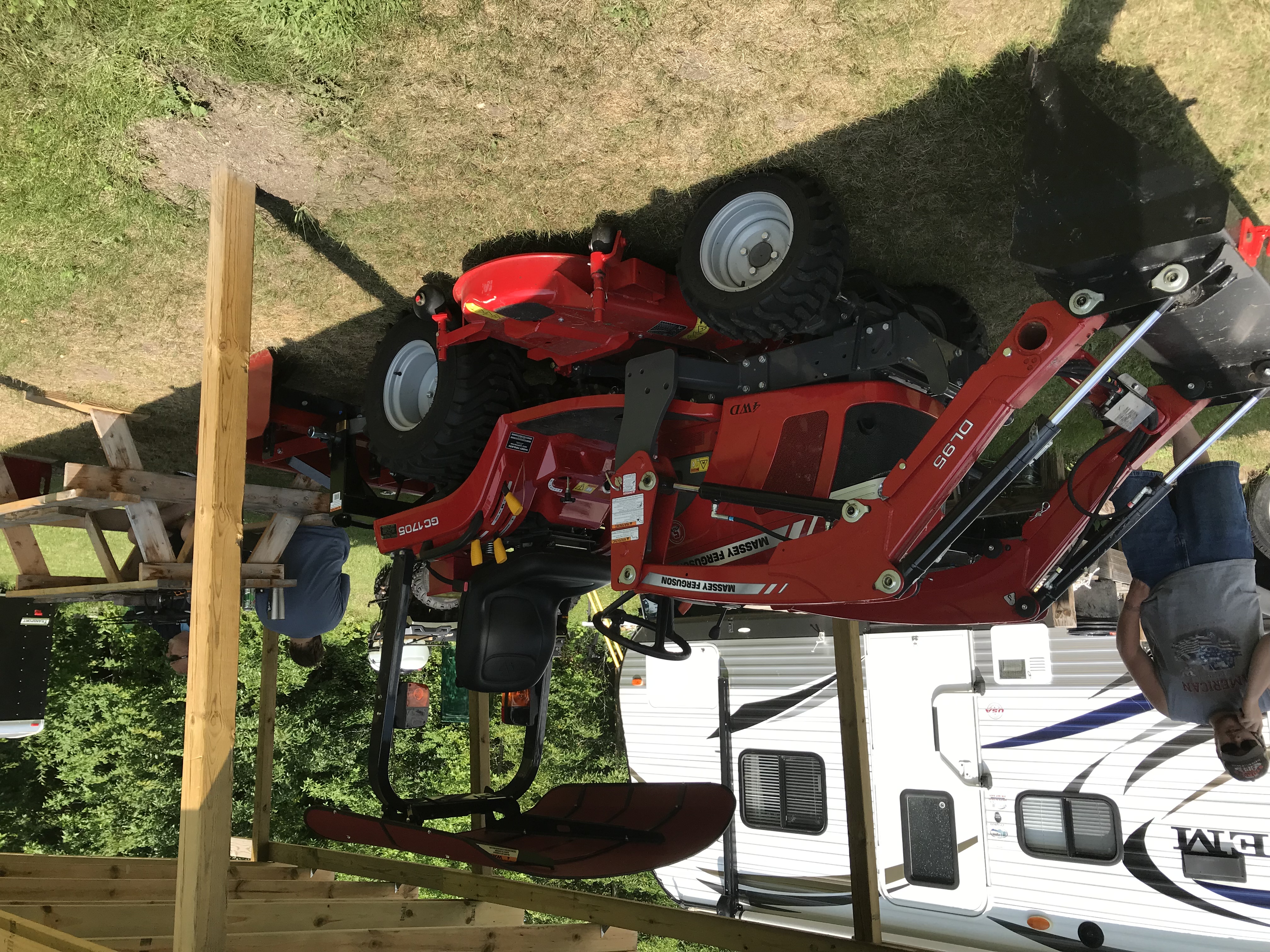

Congrats! Nice looking tractor wish I could of justified buying one like that, maybe in 3-4 years being my neighbor out at my other property offered to sell me the 40 acres next to my 12.7 acres in 3-4 years so that will give me a reason to upgrade.
I took delivery of my new MF GC1705 last week, Green and Orange didn’t seem to interested in answering all my newbie questions so I went to the MF dealer about a hour away and the salesman had no problems answering my questions plus he asked me questions like what size property I had what was the main use for the tractor and what else I was going to us it for, he spent a lot of time with me on this deal, I went back 3 times before I bought it and in the meantime I tried going back to a couple other dealers but got the feeling I was wasting their time again although I did find out from the Orange dealer that all the emissions stuff basically starts at 26 hp on up.
