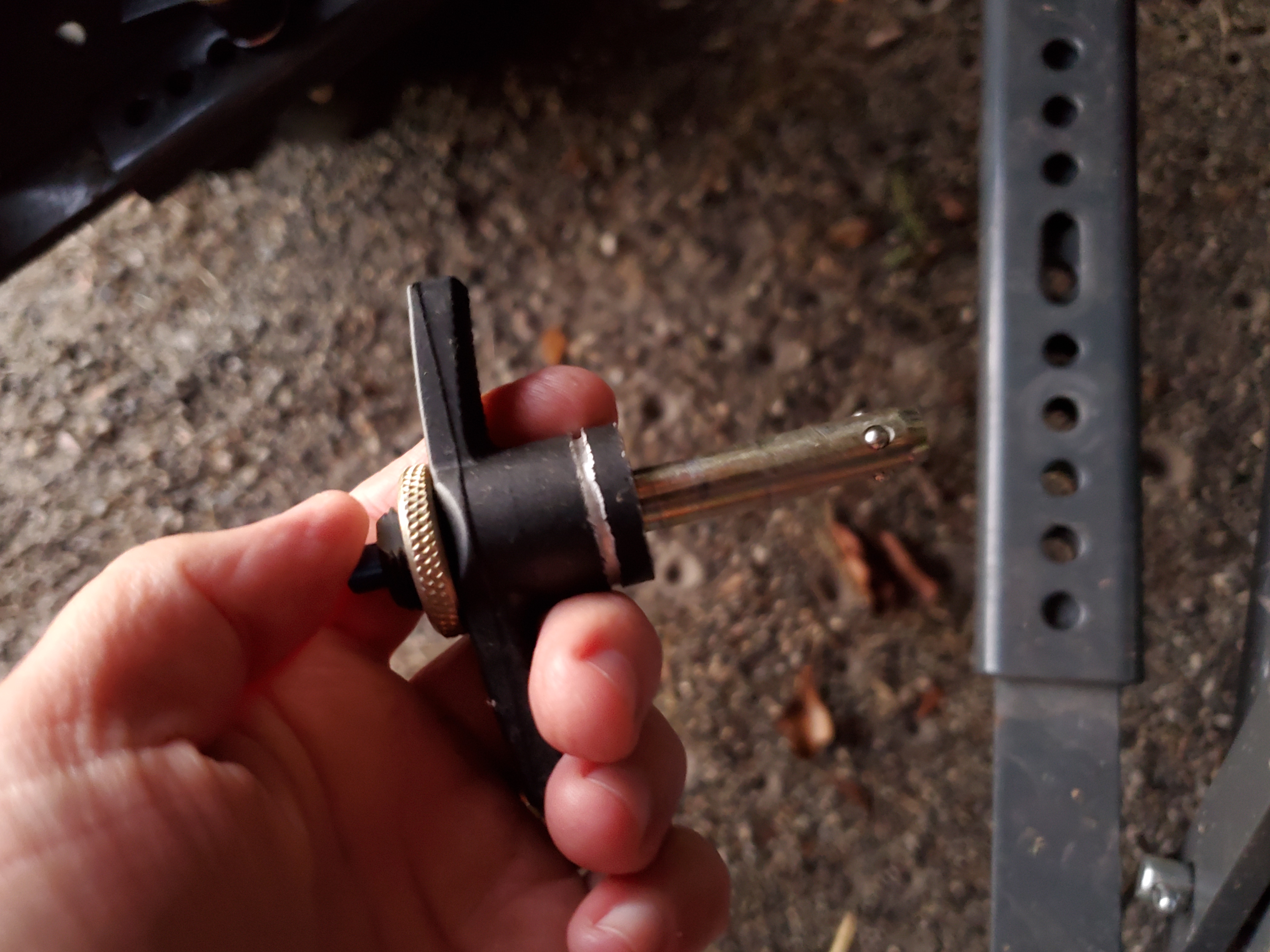

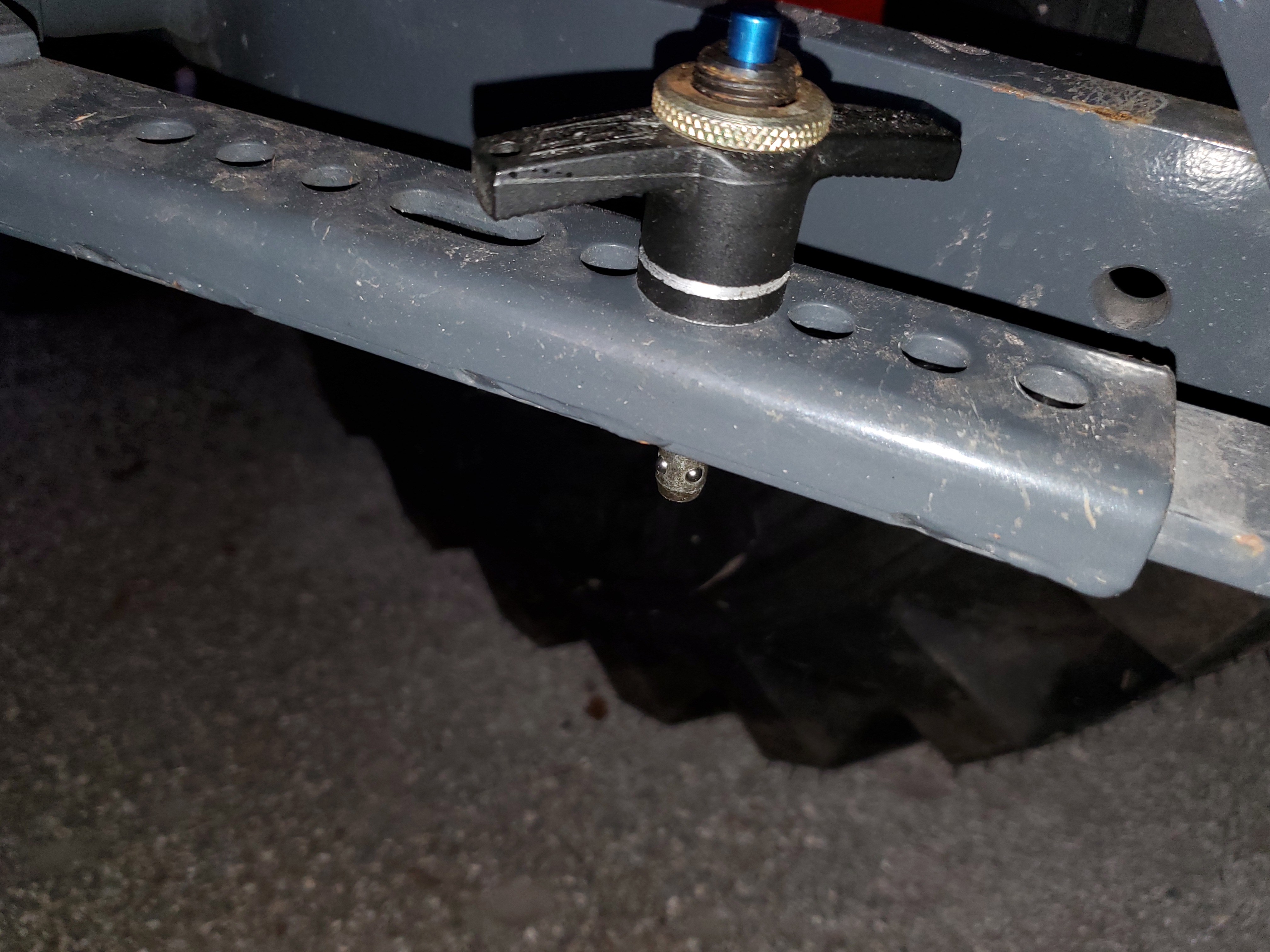

I also got some PIP pins for the lower stabilizer arms, so I don't have to fight with the OEM pins and keeper pins. I got them on Ebay for $24 for the pair. Now, I just push the button to release the pins, move the arm, but pin in new position and let go of the button. They are made of stainless steel and are adjustable for the length.

TWO (2) NEW CARR LANE 6-ABPT-1.25 ADJUSTABLE BALL LOCK PINS (T HANDLE) 3/8" | eBay
I chose these, because they have 4 retaining balls vs 2 on most of the others. This one is a T-handle and the length is adjustable. Most of the other sellers were wanting around $15-$20 for each, but this guy had 2 for $24. I'll have to measure it tomorrow, but yeah, mine seemed a little higher than I would have thought. I do have the larger tires, so that may be contributing to the height.

Thanks for the link to the pins, and you used them on the inner stabilizer bars, correct? I am at a point in my life where I like the EZ button. I hate fooling with the little retaining clips on pins.
   / Just Purchased an LX2610SU - Loader Questions
#70
Yep. I'll post a picture tomorrow when I get home. They held great for almost 3 hours of use and will not pull out unless you press the blue button.
