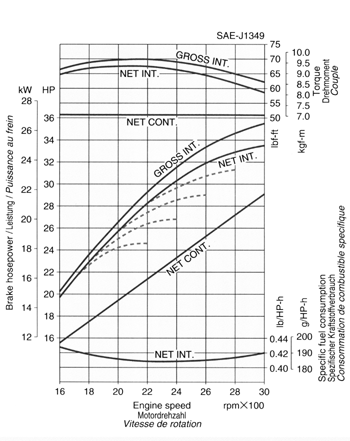

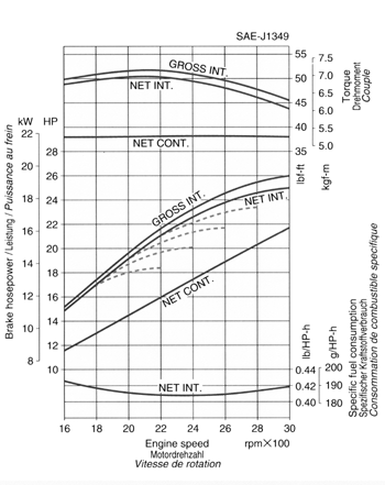

Glowplug said:
psdx--That's very good. I have always known that torque is more important than hp in this context but kind of lost notion of that in all the minutia. Steeper torque curve with a higher overall torque and at a lower engine rpm is an excellent plus!!
Sometimes it is helpful to look at the actual hp/torque curves to identify the "sweet spot" for your engine. Since this thread covered these four tractors, the performance curves for the B2630, B3030, JD 2320 and JD2520 engines are attached. Note that the net intermittent values are most relevant for comparison. They all have a pretty broad torque curve except the JD 2320.
