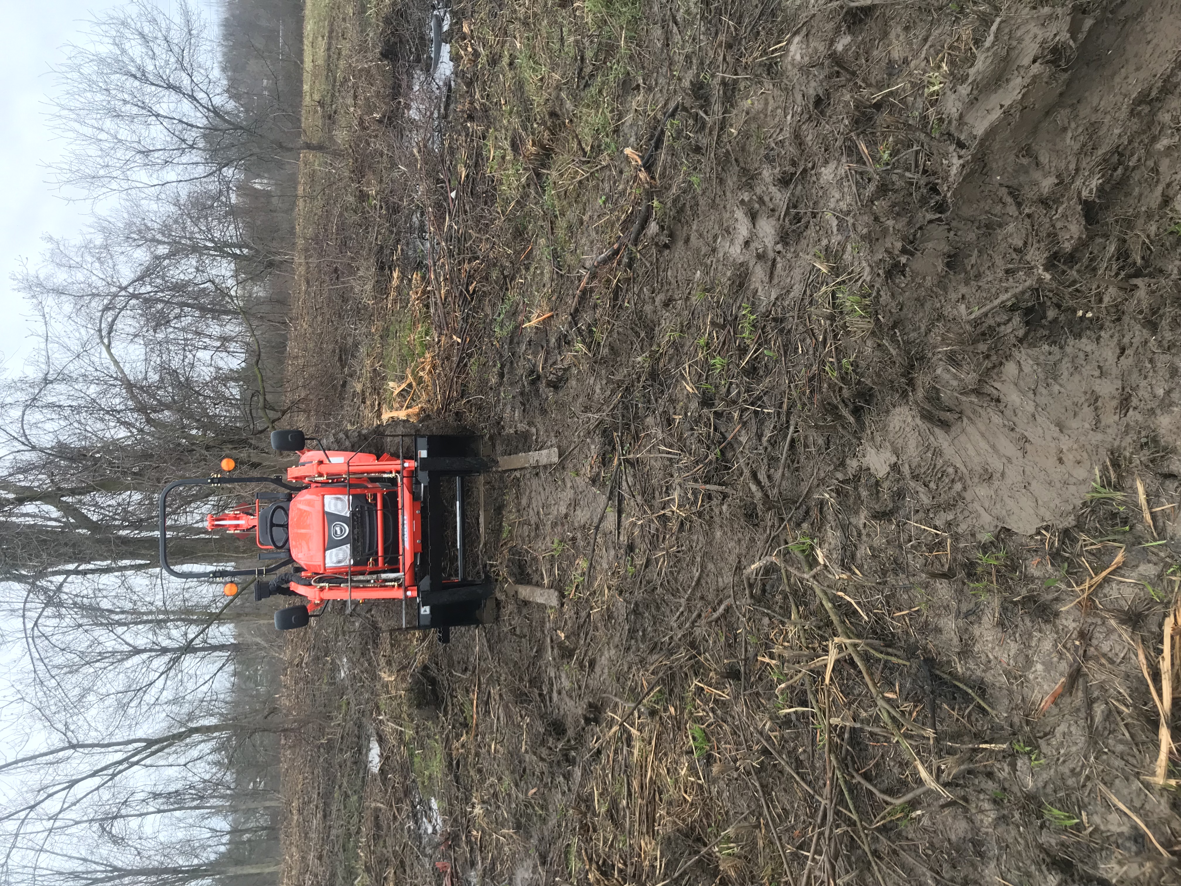

I finally got unstuck. My friend came over this morning and worked his magic on the backhoe and I drove the tractor and also use the forks to lift the front tires, used them as skis so they would lift and also allowed the front to skid along while he pulled us around with the backhoe. No video but I took a couple pictures to show how the surface of the field was so soft. Need to let things dry up for a few days and try it again.IMG_6741-1.jpg

So, I went out tonight to start the tractor and mess around with the backhoe and the hydraulics didn't work. Well the backhoe would not lift up. I tried dropping the stabilizing feet and they dropped very slowly and did not push into the ground. The backhoe only would lower, it would not lift. I am hoping this is an easy fix. Anybody have any ideas. Maybe I ruined something earlier ?

Remote lever in neutral?
   / Just ordered my Kioti CK3510 #37
You will probably notice that the tractor is making an uncharacteristic "squealing" sound, which is the relief valve bypassing the oil flow back to tank. And several other weird things.
Check and make sure that the detented rear remote hydraulic valve is in it's center position.
You most definitely DO NOT want let the tractor idle/run in this condition for any significant amount of time!

So, my grandson was sitting on my lap and of course he has to touch everything within reach (he just turned 2) and he flipped the PTO auto manual switch on the dash. Once I flipped it back to where it was, the backhoe was in full beast mode again. Thank you for the input Jim and Amvcane. Now, I just need my property to dry up a little.
