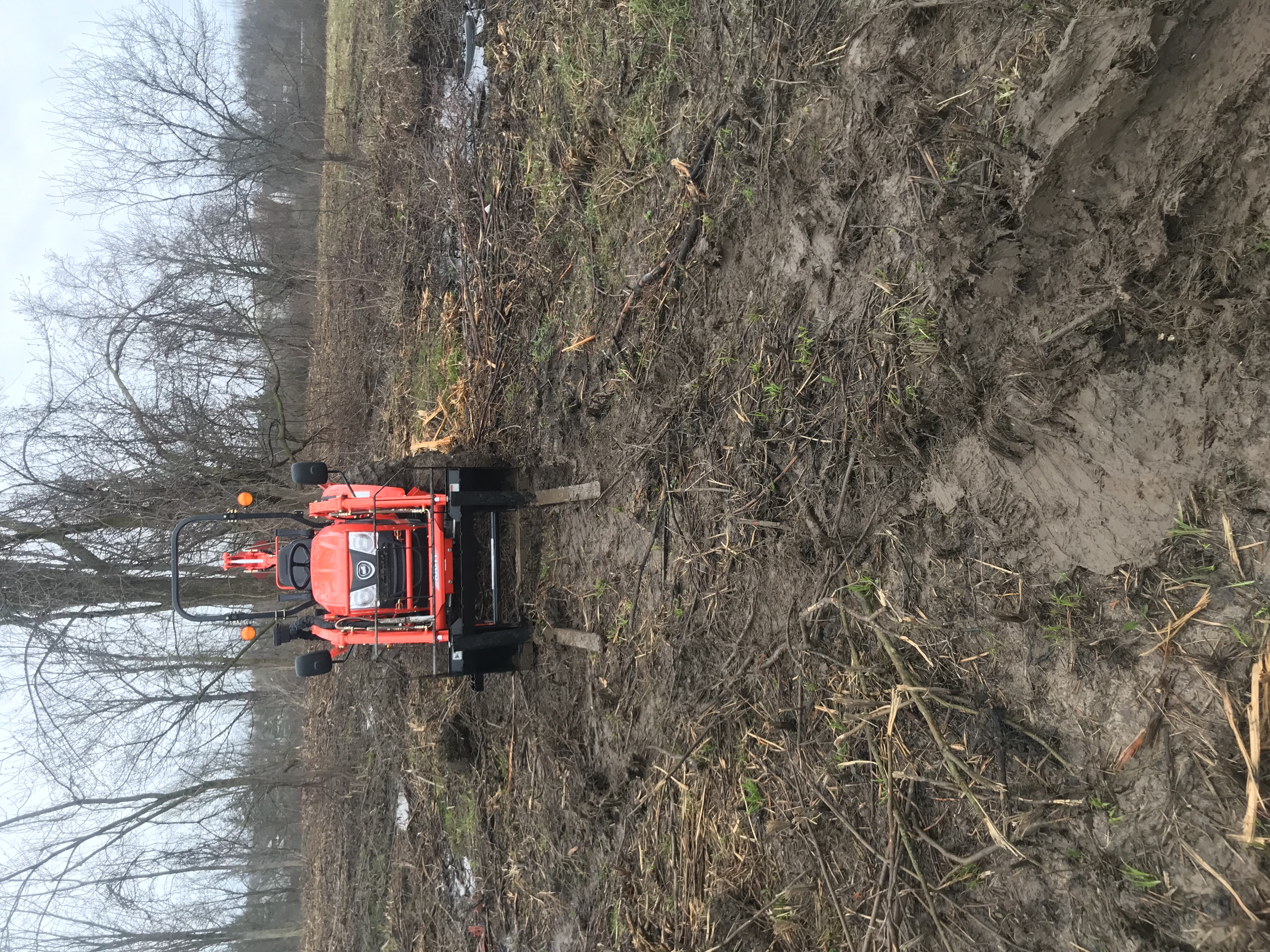

Soooooo, I received my tractor this morning (not sure how to download pictures to the forum) and I went out to my field and immediatly got stuck!!! My property was very wet and very soft (clayish) and now I need to get it unstuck. It is supposed to rain pretty much all week. So, I can't even get unstuck without immediatly getting stuck again. :confused: I am totally open for suggestions. I have the back hoe on and the forks.

I have a friend coming over tomorrow. He is an excavator and said he will help me/show me how to get it unstuck. I'll let you know how it goes.

Raise the outriggers - won't go anywhere with them down like that! :dance1:
Seriously......if you can't "pull" yourself back a little at a time with the BH, 4WD + Diff Lock won't get you out of the soup, a real long chain/towstrap (28 lbs. Capacity 2 in. x 2 ft. Heavy Duty Tow Strap) to a truck in 4-low will do wonders. I've unstuck mine a few times with just a bunch of chains daisy-chained together then my F150 in 4-low. Just at idle, the F150 is enough extra in combination with the tractor to get it going.

Thank you for the advice. It rained all day today and it looks like rain for the next several days. I will let it quit raining and dry up a little before I try to get it out and get some work done. I really can't get my truck back there without certainly getting it stuck also. It is very wet, I should not have brought the tractor back there. Hopefully, I will get some pictures of the Kioti when its free at last.

I finally got unstuck. My friend came over this morning and worked his magic on the backhoe and I drove the tractor and also use the forks to lift the front tires, used them as skis so they would lift and also allowed the front to skid along while he pulled us around with the backhoe. No video but I took a couple pictures to show how the surface of the field was so soft. Need to let things dry up for a few days and try it again.IMG_6741-1.jpg

I finally got unstuck. My friend came over this morning and worked his magic on the backhoe and I drove the tractor and also use the forks to lift the front tires, used them as skis so they would lift and also allowed the front to skid along while he pulled us around with the backhoe. No video but I took a couple pictures to show how the surface of the field was so soft. Need to let things dry up for a few days and try it again.View attachment 600937
Glad you saved her! Now wash her up and enjoy!
