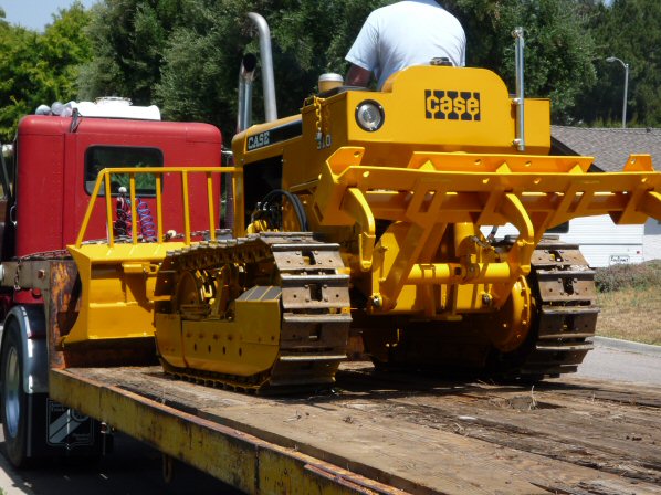

My brother and I have a 66,000 GVW rig, still to small for some of our stuff. It just is never big enough at one time or another. :eek:
