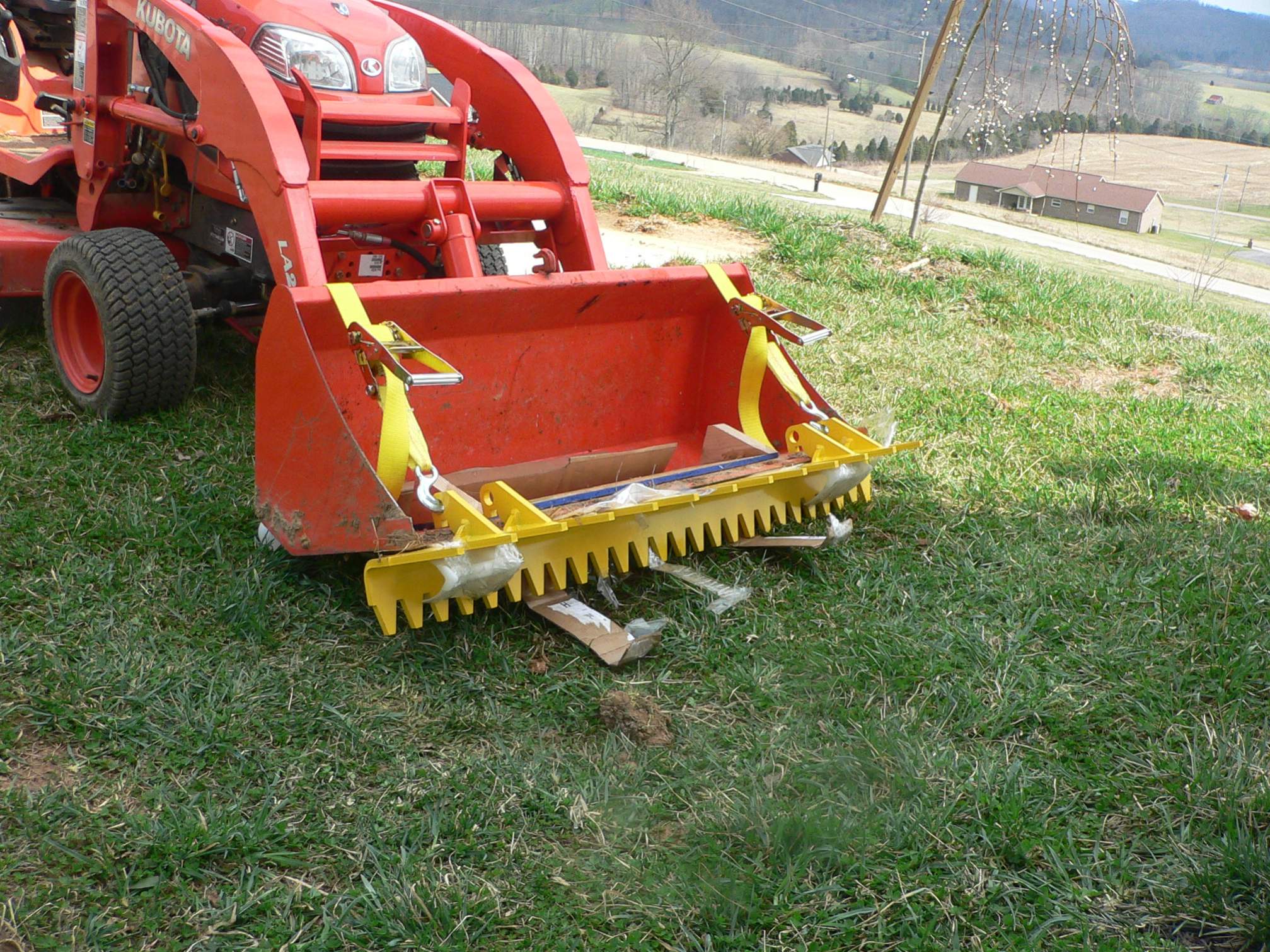

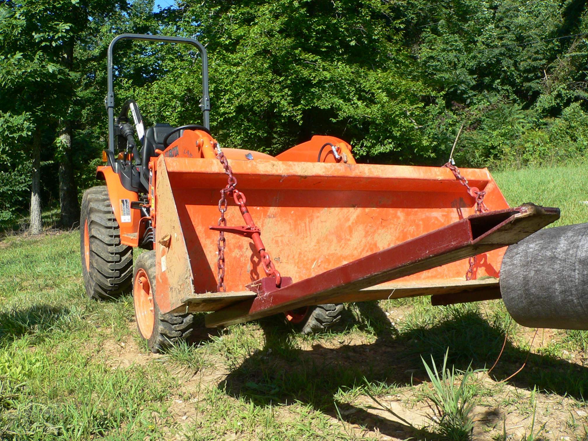

The skid plates are a must, I made my own out of an old street sign, brotec thumb is a must i love mine. One thing that also is a must is a tooth bar, mine was put to great use, and is well worth the money. My machine (bx24) with loaded tires would not dig well without the tooth bar. I am out in Woburn got my machine out in harvard ma where did you get your 25?
Where did you get the tooth bar? How does it attach to the bucket?

I got the tooth bar off ebay and it was made here in mass i had a buddy pick it up locally down in weymouth. If i can find the seller i will post it. FWIW harbor freight opend up a new store in danvers, although i think you may be closer to the worchester ma store.

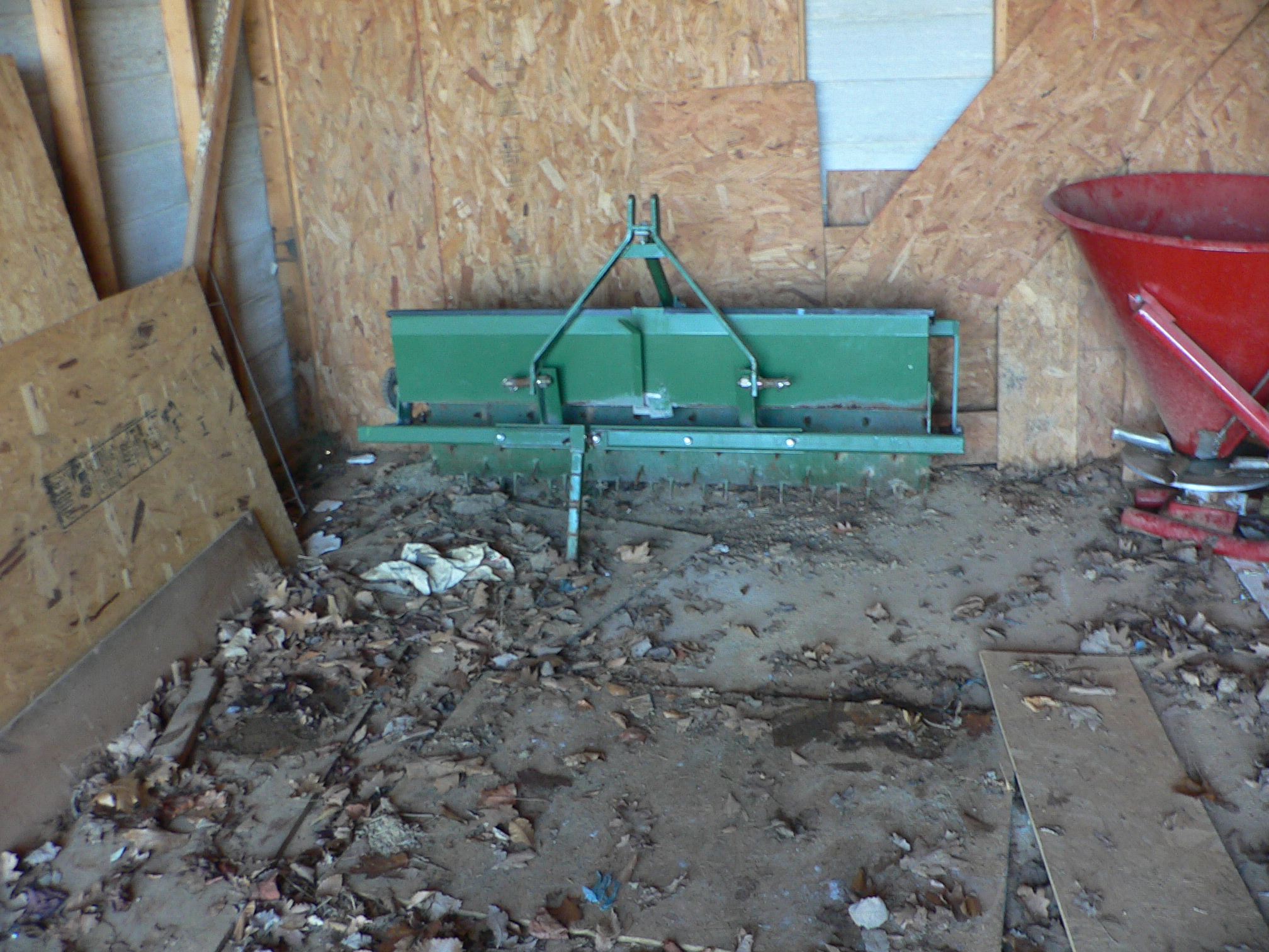

For building the pond, I'd recommend a sub-soiler to rip and then a toothbar to help scoop with the FEL.

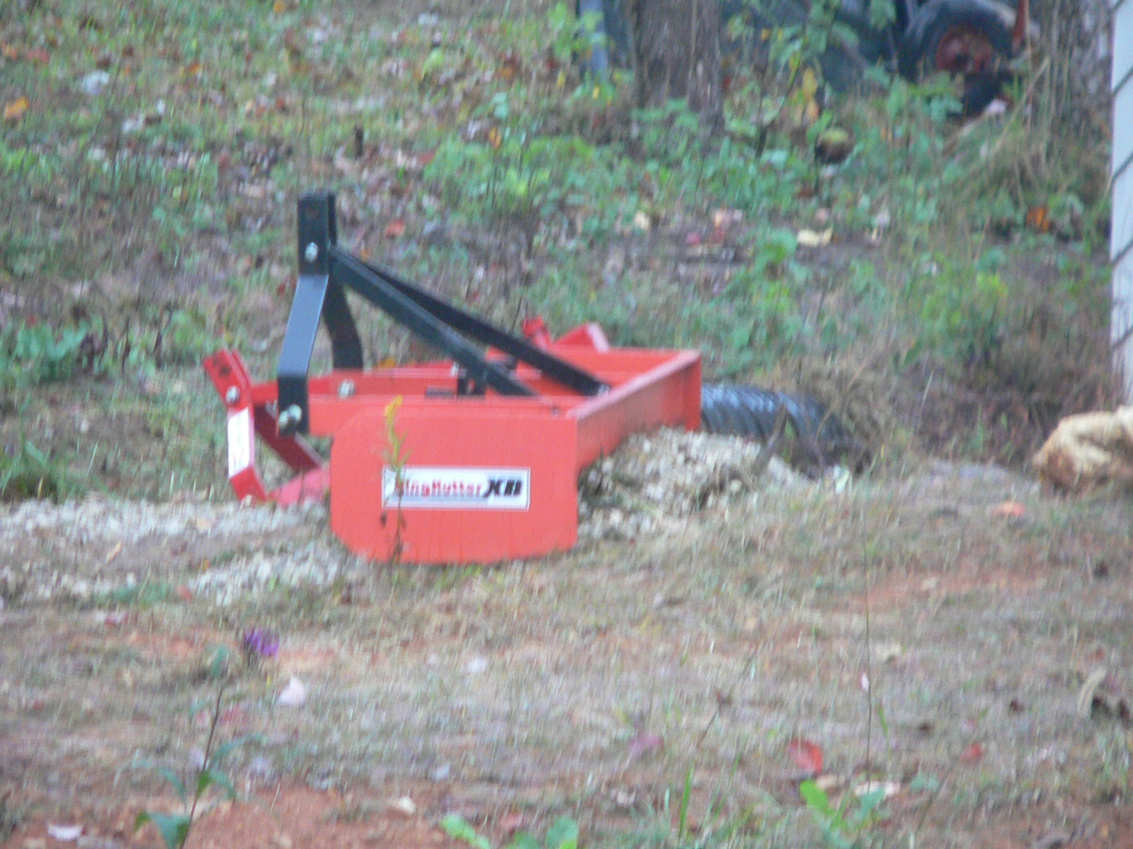

Another possibility is a box blade to move the soil and shape it if you are going to use the excavant close to the hole.

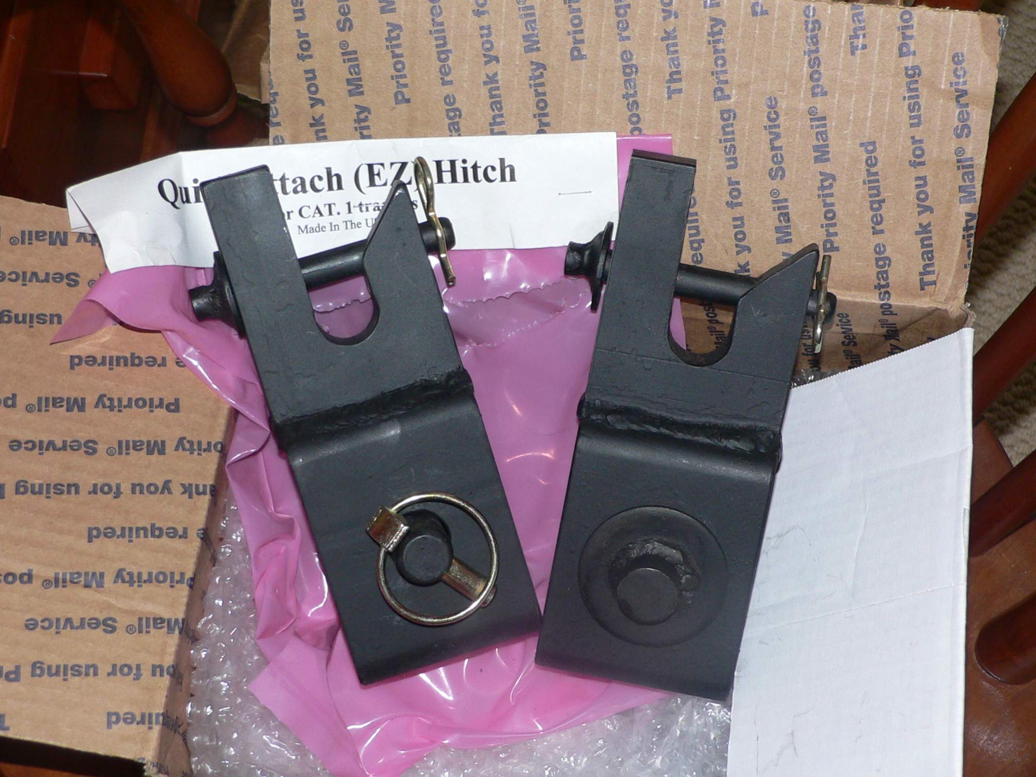

I've bought three different sets of quick hitches. Pat's, which I've sold to Milkmans brother and two other different ones from Ebay. The ones from Ebay came from someone that makes them in Indiana or I guess they make them. This set is my favorite since I can stand them up or point them down and they don't extend the reach so my tiller will work with the drive shaft that is on it. With the Pat's and the other copy of Pat's they extended the distance so much that the upper arm and drive shaft wouldn't reach. The upper arms are cheap at TSC but drive shafts are more expensive.
Pictures of all of them and notice the BB attached with QH facing down.
Do you have an eBay ID for the quick attach seller? Tiller was delivered yesterday and the extension to the mount they did looks great.

I have the two different ones shown here and prefer the ones that let implement sit on top or under the QH.
