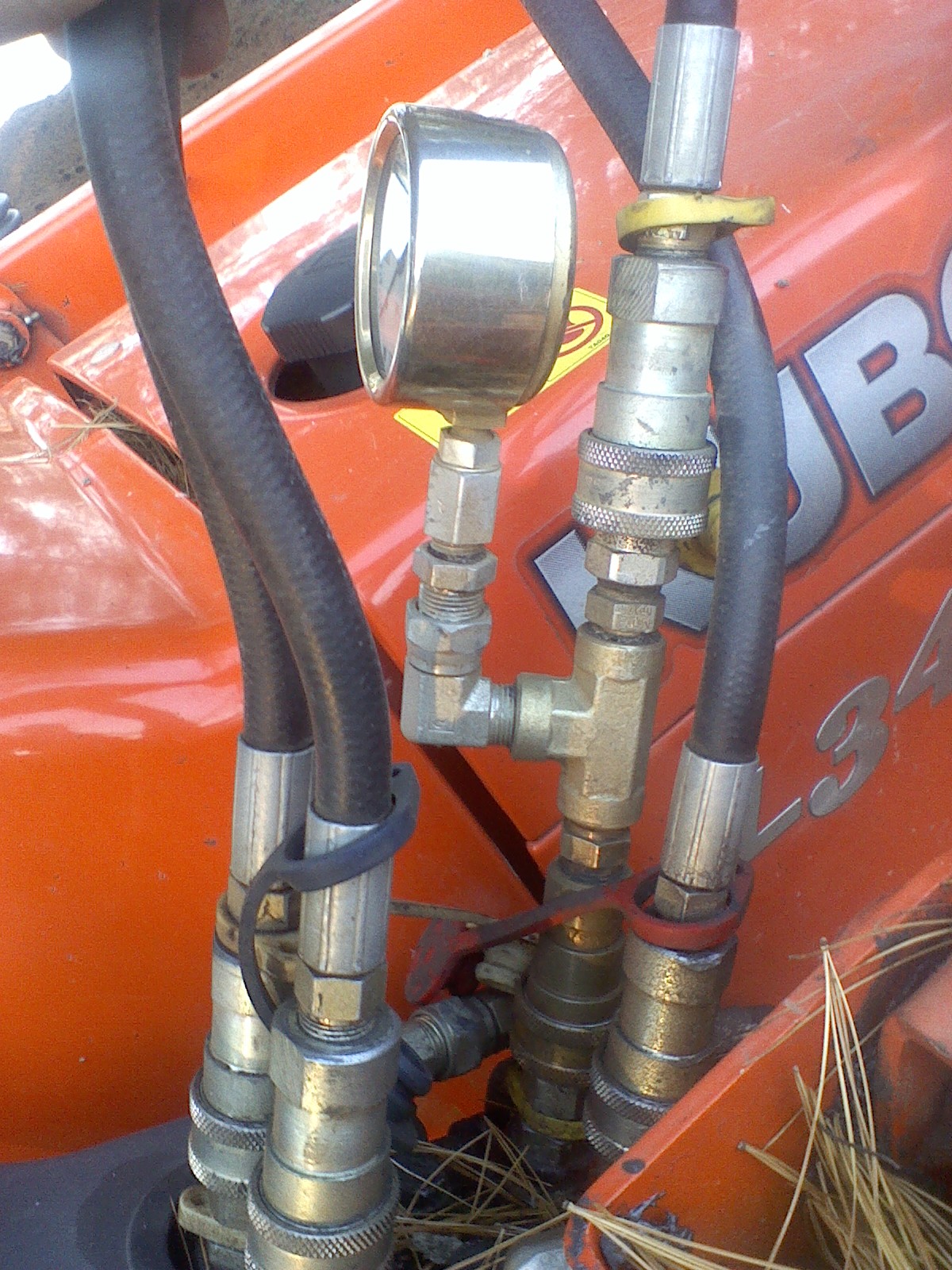

The higher you raise your loader you need to extend your curl arms to level the forks to get under the load. I cannot lift the load with the curl arms extended and cannot curl the load back. When the Load is on the ground the curl arms are retracted and can lift the load no problem but if I extend the curl in the air I cannot curl it back. I know I am running the loader to it's max but I just need A little more.
   / Just ordered A 4047 Shuttle Will it lift 2000lbs on a pallet? #23
The only way to get "more" is to raise the pressure on the Relief Valve. Have you checked your pressure to see if you are set at factory specs? You just need a proper guage and a hose and adaptors. Once you know what it is, you will know how to proceed. It is up to you if you want to exceed factory specs, but if it is below spec right now, I would have no problem in raising it.

Ken's Bolt On Grab Hooks sells a gauge set all put together...If you don't feel like fiddling with the parts. I have one, it works good. I think it was $40.00 with a male quick connect. Does the LS use an ISO 5675 quick connect? Probably a #12 size?

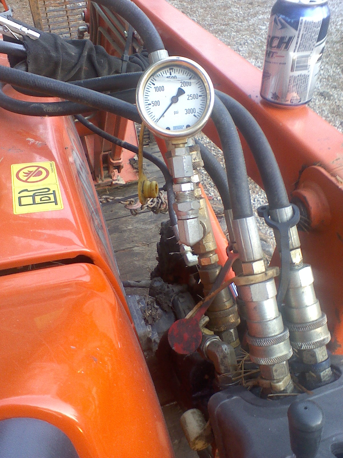

You could always do like I did too and throw a tee in there and leave the gauge on full time. Pretty handy for doing dirt work, as how high the gauge reads is a good indication of how good of a bucket load you got.

When I did my gauge Tee, I used parker 60 series. Which according to parker is listed as 7241B
So how is that different than an A??
The ones I used look Identical to the ones that came on the kubota in every way, except the parker logo is all...
