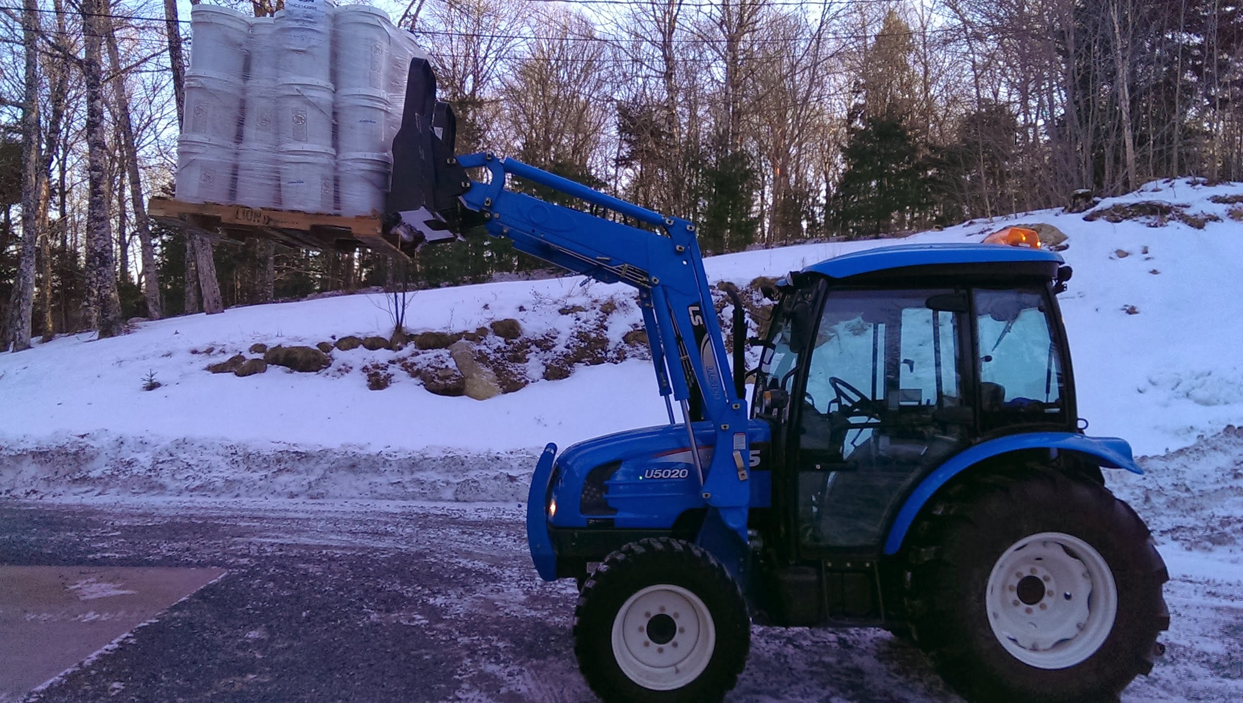

Bosco350, I would say that it will lift it, but with some ballast/counterweights. I have an LS U5020C with a LL5100 loader and I can lift ~1900lbs (1800lbs of cement + 36 Pails & Pallet) to full height at idle with no problems other than starting to get a little light in the rear. I used no ballast, but my rear tires are loaded. The LL5100 is rated for 2650lbs at the pin. IMAG0643-ERASER.jpg
