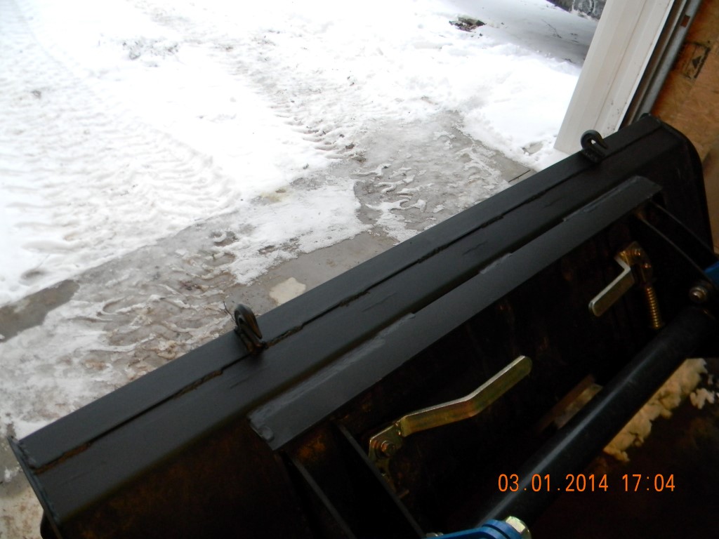

Did my own inspection on the tractor earlier today. minor adjustments to level mirror brackets, air pressure in tires, fluids, etc. Then went to local TSC store for some materials. I welded a piece of 2"x2" angle to the top of the bucket to add strength and welded on a couple hooks. Primed and repainted. Then I added a couple D-rings to the brush bar to use as chain tie down points when I need to haul it on the trailer. Put a large Clevis on the rear draw bar for rear chain tie points.

FYI - unless they changed the bucket design, the angle iron was likely overkill. That top portion of the bucket is a 2" x 3" box tube, using I believe 3/16" thick tubing. I bolted my hooks on directly through it.

Those hooks on the top of the bucket look good. Those are very useful. I also like the tie downs.:cool:

Bucket is still the same. I like overkill.
