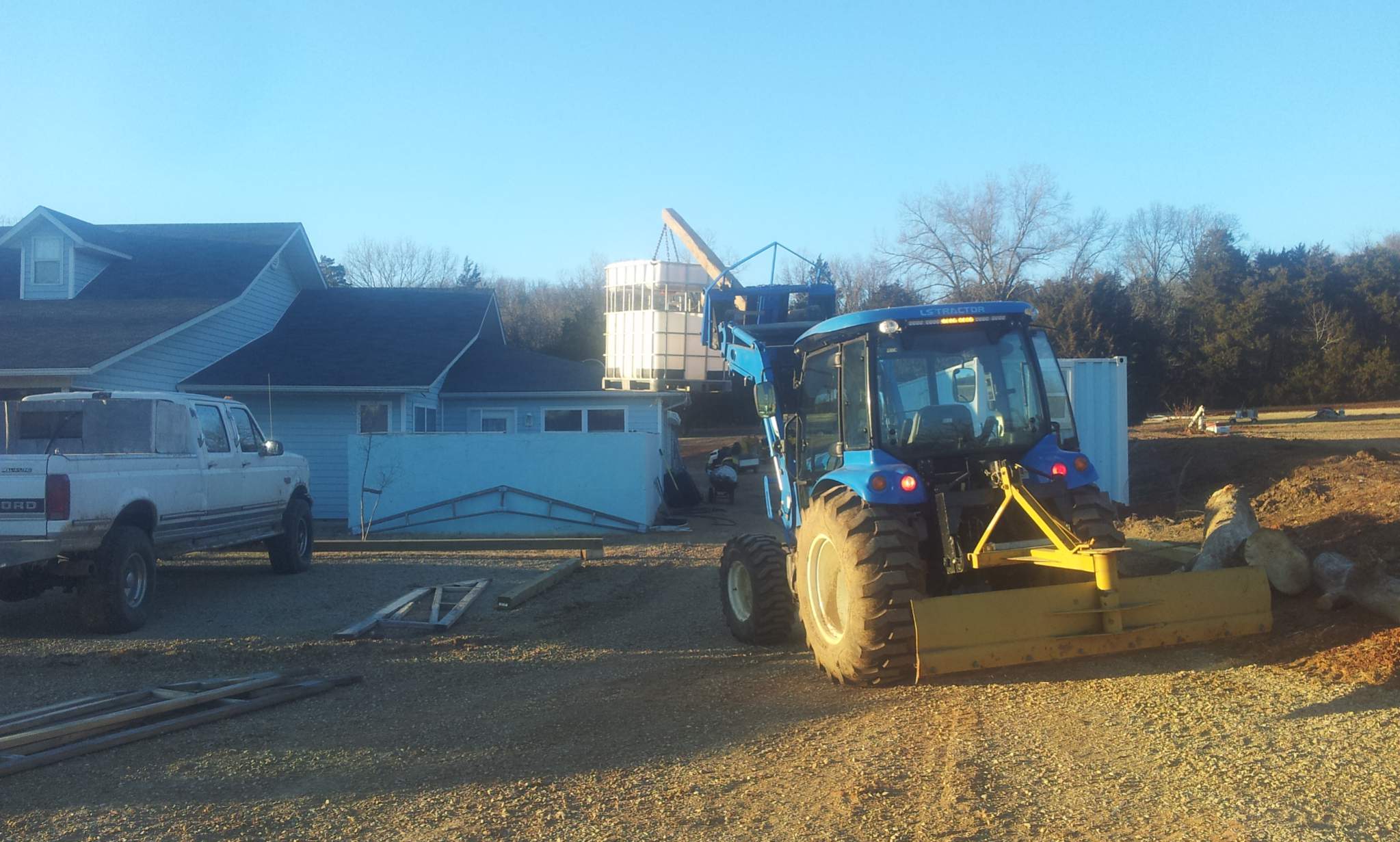

20140226_172011.jpgI contacted LS about the plug in for the strobe, and you have to buy the whole kit, $200+, so i bought a stobe bar on ebay for $53- it works nice. I had to take a couple of the blank switch plates and mount the controls to the strobe in them. that wasn't too hard but it did take a little engineering. the wiring is in the tractor already. BTW nice tractor. :)

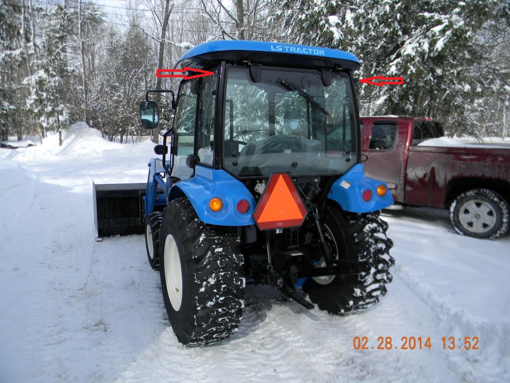

Which strobe did you buy? And what are the brackets and plugs are for on the back of the cab both left and right sides?
I also see your mirrors are like mine were. They seem to be tipped down. Support bar not level. That bugged me so I fixed mine this morning by loosening the bolts then removed the lower bolt and put a washer spacer between the mirror and mount plates. Now the top support bars are level.

that is what the brackets and plugs are for on the back. I just thought the price was really high for the LS strobes and I couldn't get any info on them. the one I bought was -http://cgi.ebay.com/ws/eBayISAPI.dll?ViewItem&vxp=mtr&item=291073356684- and it worked out ok, I just had to add my own wiring which was not that tough. I also had to add a small bracket from each of the rear flood lights to mount my light bar. I'm not near the tractor until tomorrow but I'll take a few close ups of what i did. I am going to add the LED floodlights also but the wife won't let me spend anymore money for a while.
