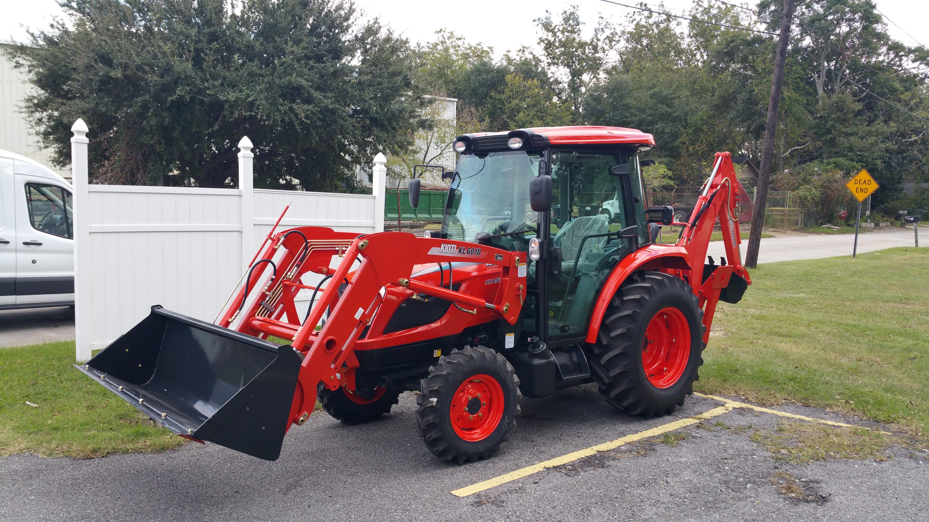

Hello,
I just picked up my new NX4510HST Cab Tractor Loader, Backhoe.
It's amazing so far but I haven't really used it yet.
I got the extra hydraulics but am not sure how to use it yet.
I would like to have to have the option of a thumb on the backhoe and/or a grapple bucket if I get one. What else would I need the hydraulic for? There are 4 ports on the back and two are connected to the backhoe. The other two aren't connected so I'm assuming those are they. But, where are the controls for them?
I'm new to hydros so this is a learning experience for me. I've used rented equipment a lot but never needed to hook anything up before. I'm coming from an old Ford 8N used mostly for bushhogging and box blading and brush clearing so this will be fun.
Got the cab with A/C and heat. Is this even considered work?? Kioti20151021.jpg

Welcome to TBN.
Nice...darn nice looking investment,and your bones muscle will thank you in years to come.

Congrats on a beauty of a tractor! And welcome to TBN.
You can run the aux set of rear remotes to power a Top-N-Tilt setup for a box blade for instance, since you're familiar with B blades from the 8n. Also a wood splitter, or whatever you can think of that needs remotes to control it. Also front mounted snowblower or all angle plow, etc.
Take it slow and easy while you learn all the new tricks. And YES it's work; when the wife asks what you're going out to do....:thumbsup:
Enjoy!
Did your dealer give you a run through on the machine?
I like that it has it's own lined parking space too.

Thanks for the good info. I will definitely check them out.
Sadly, the parking space is at the business location, not the farm. But it looks good.
