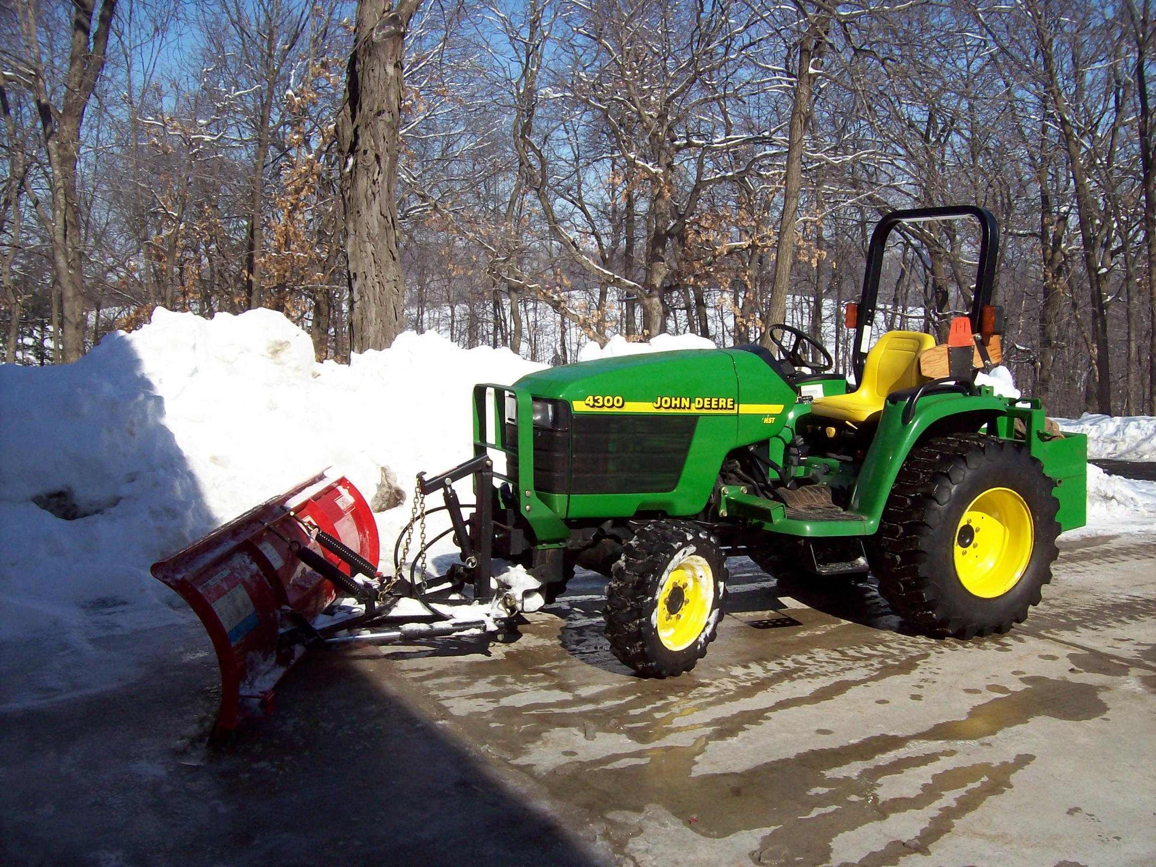

/ Just got a blacktop driveway....... #14
Have had blacktop drive for 6 years, and have no problem destroying it with either the snowplow, the side wing, or the tire chains.
Usually use chains only when it is ice covered. Not often, but a wet snow that leaves some slush before a quick drop in temps will leave ice. Then a big snow storm on top will leave you wanting chains.
Spinning on the blacktop with chains will leave marks on the surface. By mid summer, those marks are gone.
And the heat the blacktop absorbs in the winter is great to remove snow and ice and give a dry surface.
But can miss the bit of gravel that works to the surface from plowing the gravel drive, as it gave great traction. Really enjoy having a cleaner garage floor from not dragging in gravel dust and sand.
