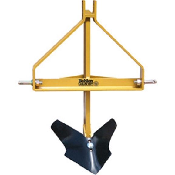

Rent the tool that works. Life is much easier this way. Subsoiler isnt the tool for this.
/ Just dont do it. #22
Here for water line 18" deep is plenty.
So for 3/4" and 1" water line, I make 3-4 passes first.
Clean out the first and last 3'-4', for the start and end.
If your pull is longer than a roll of pipe, you will need to clean out at the end of each roll and start a new roll at that point. 100' roll pulls work best, at 200' rolls you are at the max for the pipe.
Then chain the pipe to the subsoiler and pull it through.
Easy and fast.
/ Just dont do it. #23
Your running 150' of sewer line flat, with no pitch? You should really have about 3ft of drop over that distance if you want it to drain properly.
Your never going to get a 2ft deep ditch with a sub soiler much less a 4in wide 2ft deep one.
/ Just dont do it. #24
I've done deeper trenches when I leave the tongue jack down on my hay mower. Seems like this unit would benefit from some wings added to lift the soil out of the trench. Or some other method of lifting the dirt (like a trencher does).
