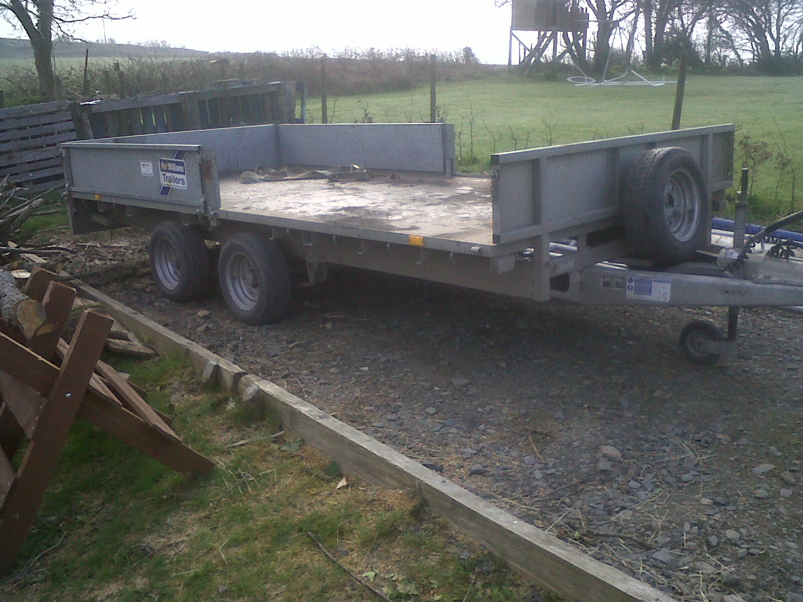

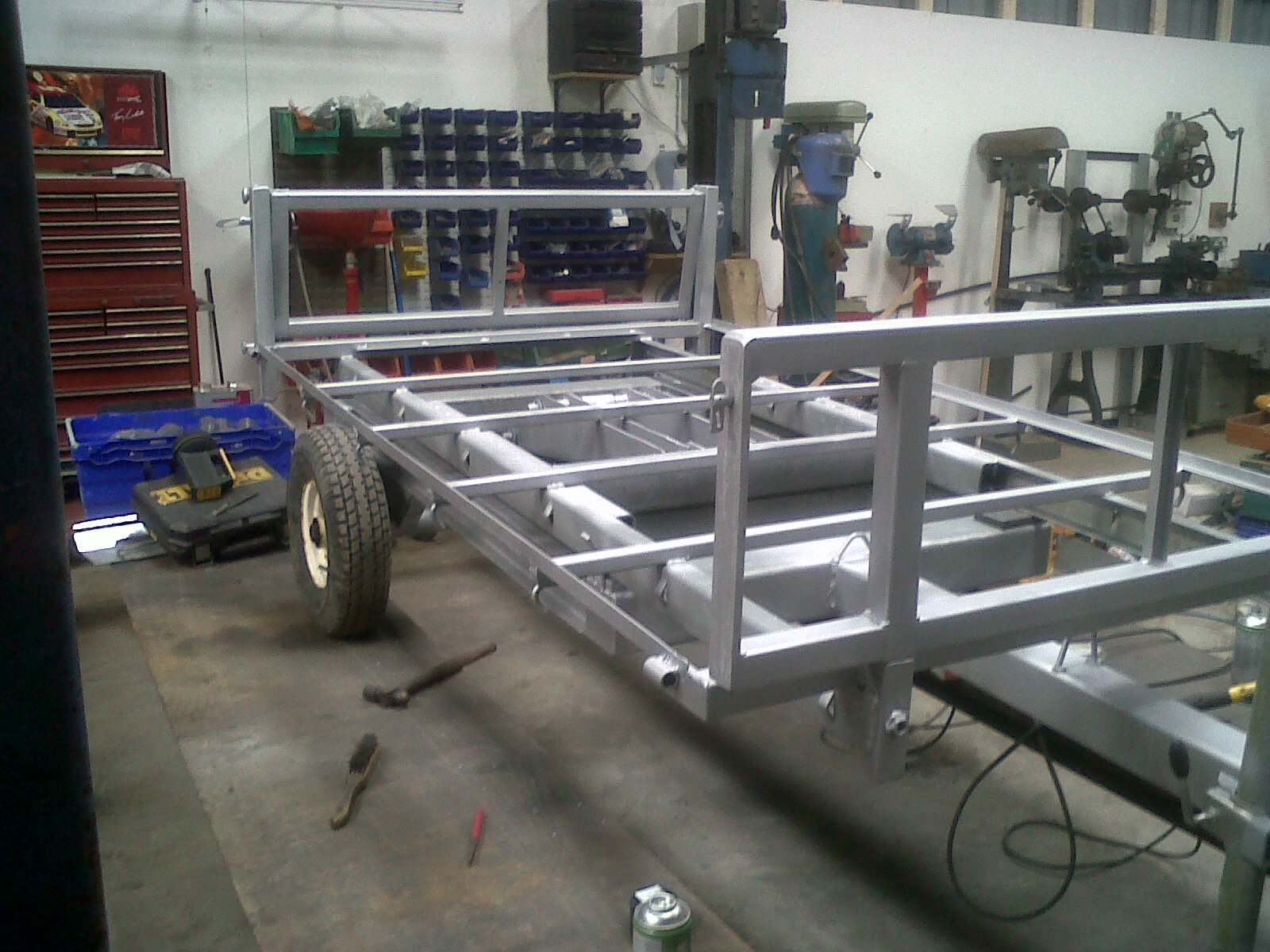

OK i have one bad pic that i took on my phone after i painted it last night before i fitted the tin sheet
More in the morning now i have worked out how to post pics:thumbsup:
Thanks for looking

That thing looks pretty nice :thumbsup::thumbsup:
Looks like you though of all the little details to make it real useful. Nice work.
Definately need more pictures now.

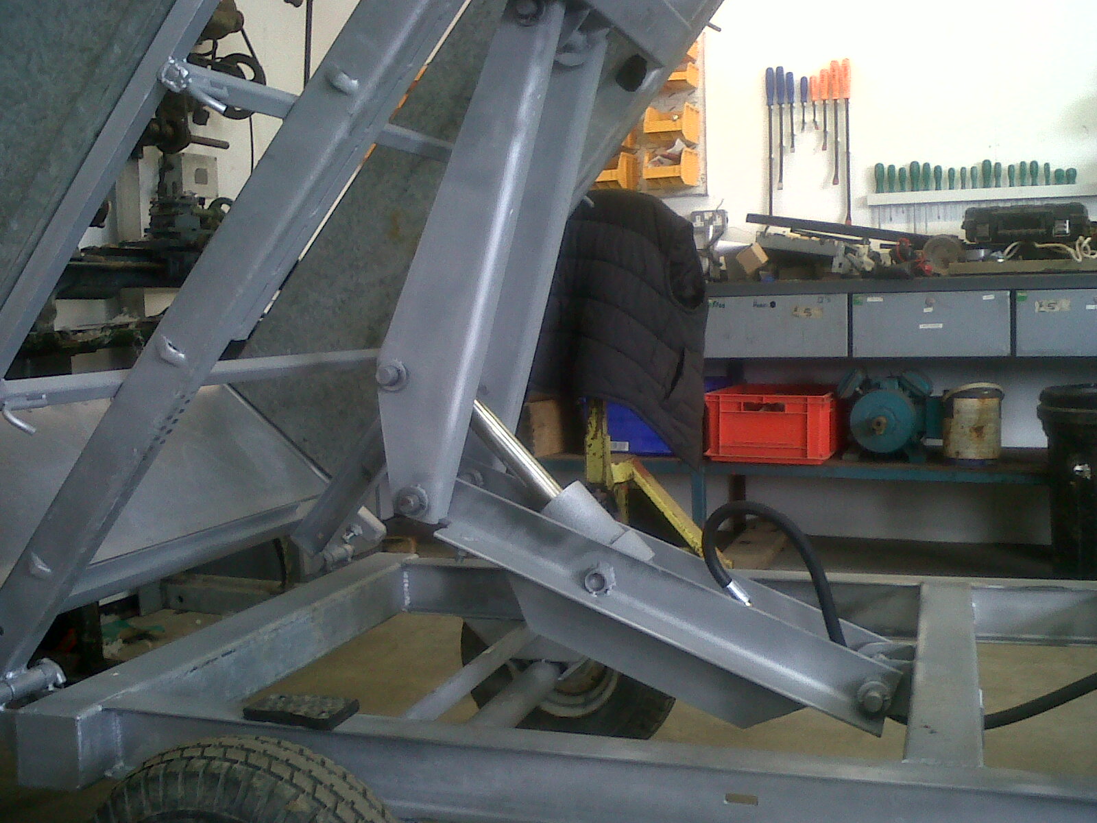

   / Just built my tipping trailer

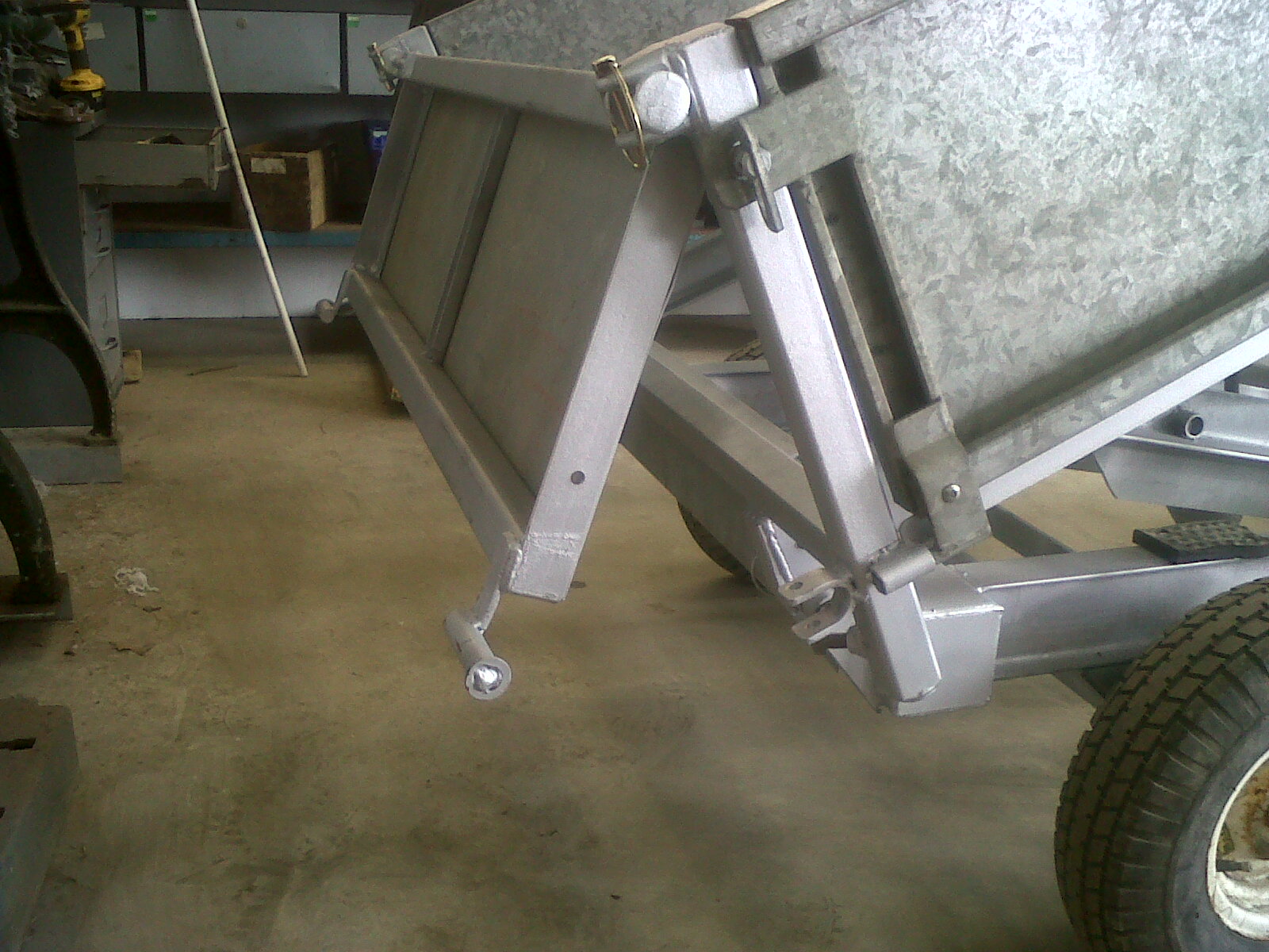

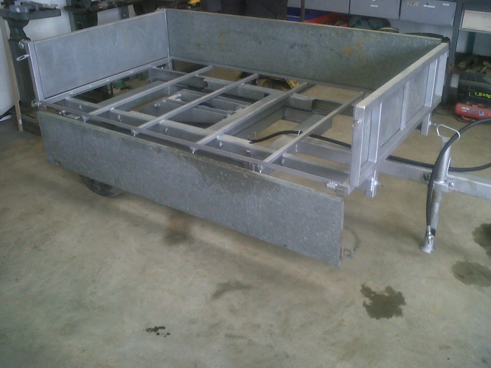

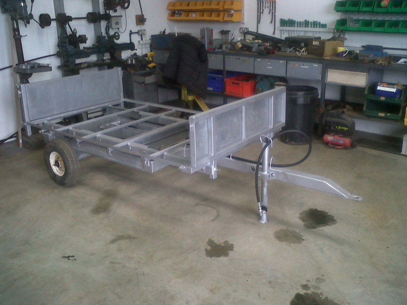

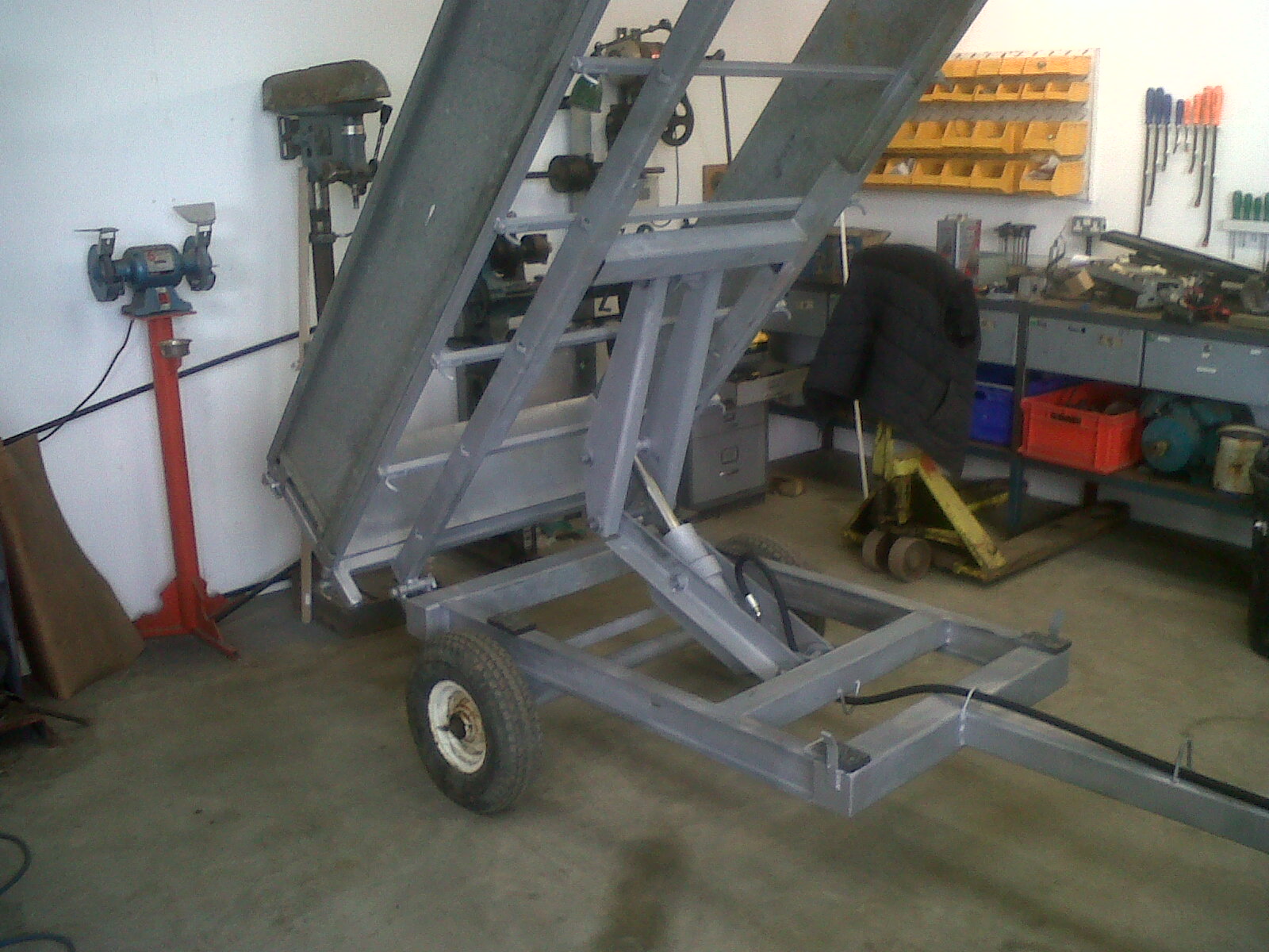

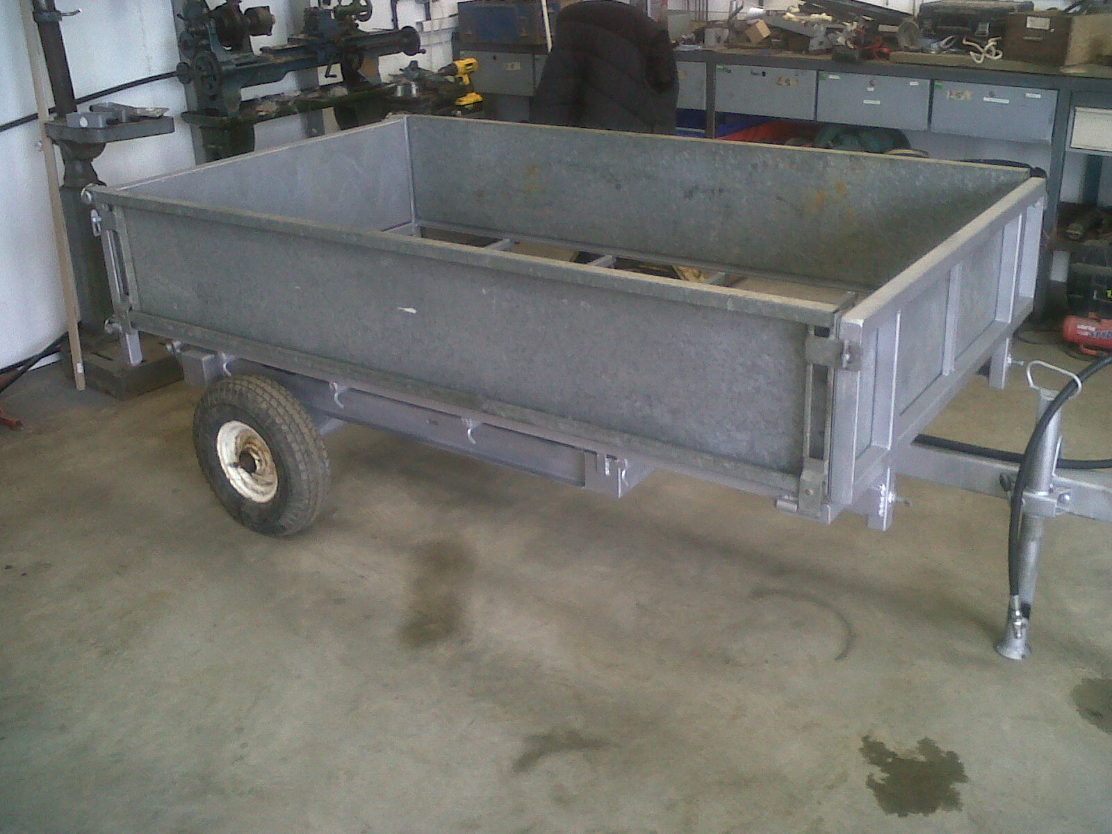

Good morning gentlement as promised i have taken a few pics this morning
As you can see the tail board is made to pivot from the top or bottom so it will fold down or up so i can let material out underneth
There are no plans for the trailer i just made it out of what i had it is the size it is as i used 2 of the sides from 14 foot trailer as you can see in the pics
I don't use the sides that often on the large trailer so sharing them won't be an issue
The tipping arrangement is a close copy from a trailer that my brother owns but modified to suit the ram i got from ebay
So just the wheels the paint and a sheet of board for the bottom
then it will be time to scratch it up:(
Almost seems a shame to use it
ps go easy on the mess the workshop is in:thumbsup:

   / Just built my tipping trailer #9
Nice trailer build, Can't wait to see it done with a action shot unloading some firewood. Good job and thanks for the pics.
Beefie
   / Just built my tipping trailer #10
Very professional build. Nice job. Thanks for the pics. I have an even bigger smile after looking at them. :)
Are you a professional welder? Looks like it.
About your "messy" shop. My wife longs for the day when mine will look as good as yours is now.
Clem

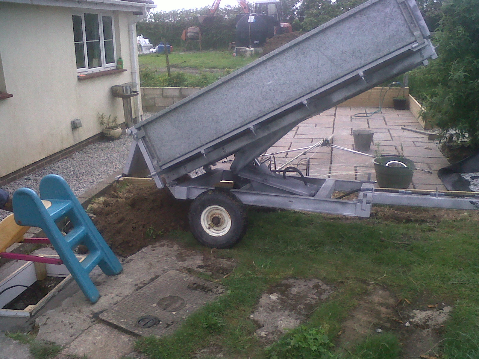

Hi guy I know its been a while but here are the action shots you asked for
I have been a little busy of late so have not done to much at home
So now it has dried up a but it is time to sort out the garden and level the lawn if i dare to call it that as the last owner just let the grass grow up through what the builders left:mad:
Been here 7 years and the thenches are still sinking and the rocks are still growing:confused2::mad:
Anyway here you go not the best pics but the wife had the camara so i took these on the blackberry

   / Just built my tipping trailer #15
Your trailer looks great. I love it. :thumbsup:
Chad
