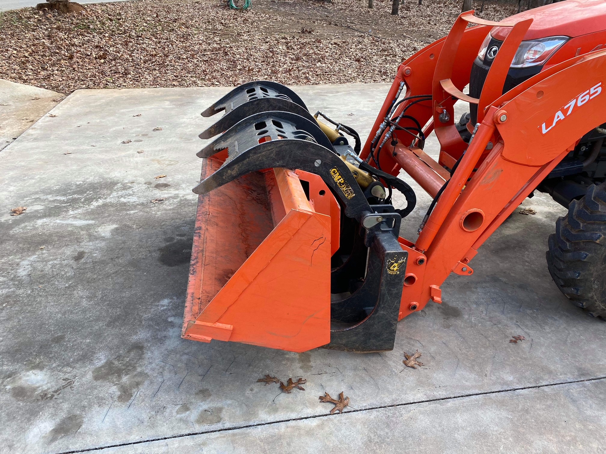

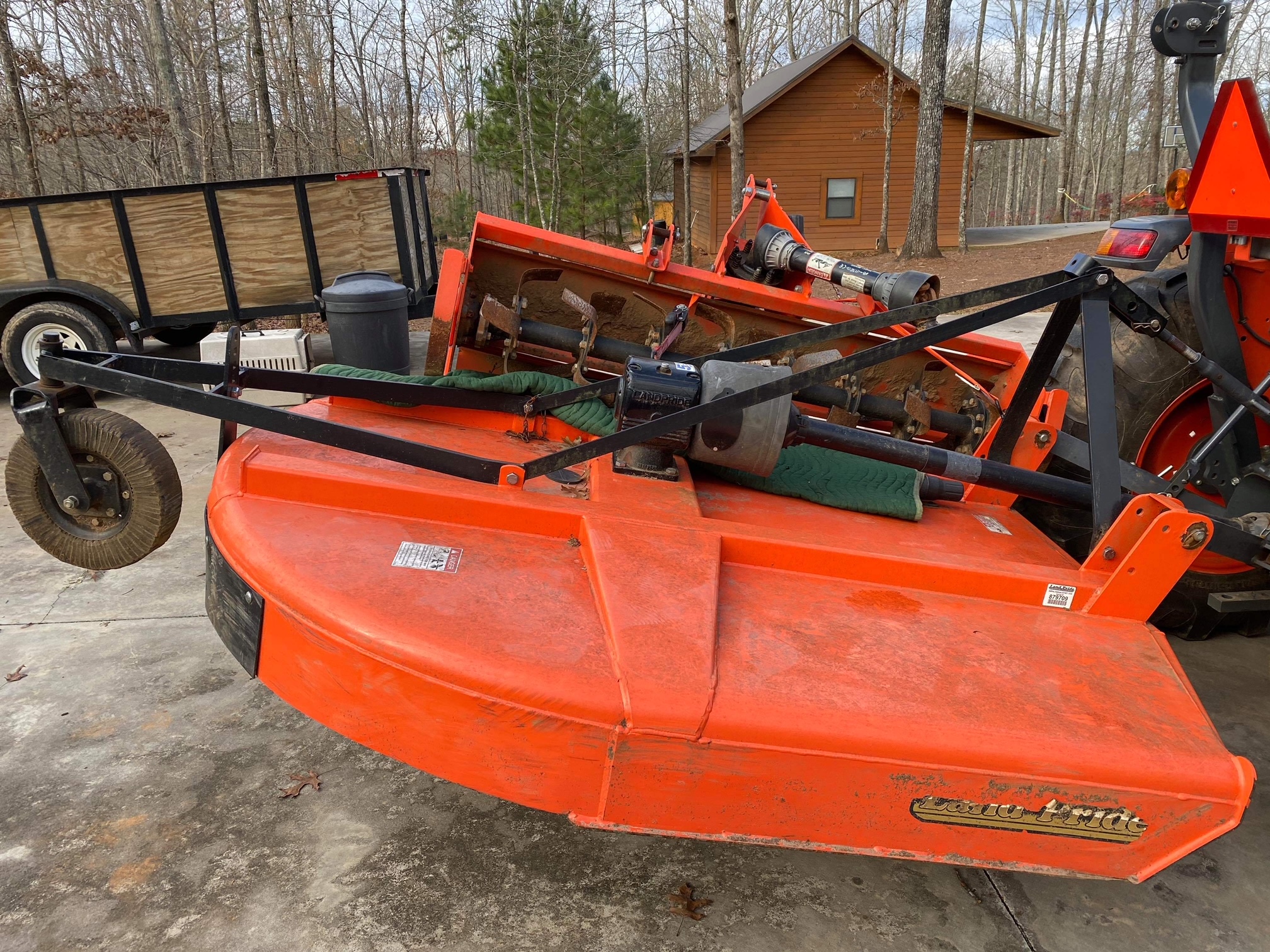

I've been shopping for a Tractor for around a year and finally got lucky yesterday. 2015 L4701 HST with 125hrs, Grapple, Bucket, Brush hog and tiller. I'd been looking at new L2501's, but was concerned about lift capacity with the grapple, and the Kioti CK2610 but didn't love my local dealer. This popped up a couple hrs away on FB marketplace and I sent the guy a deposit immediatly. Decent tractors sell instantly around here. I ended up with a lot more tractor than I ever though I'd have, but I don't ever hear anyone complaining about having 'to much' tractor...
I don't believe it ever had its 50hr service. Which I believe involves changing the HST filter and the engine oil/filter, so that will be my first project. I read there is no substitute for the Kubota hydraulic fluid. How much should I expect to loose changing the filters?
Only known issue is the guy told me that if you have the fuel filter/water separator bolted on correctly the tractor will starve for fuel, but if you let it dangle on the hoses it runs correctly.. Sounded made up to me but sure enough when I attached it the tractor ran out of gas, let it hang and it fired right back up. It looks filthy and definitely has some water in it so cleaning that will be one of the first things as well. All I can imagine that could be is trash/slime in the tank/lines? There may be a kink when its in place too I haven't had time to investigate. Tractor was stored outdoors.
Overall seems like a really nice machine. I'll be using it for woods clean-up and food plot preparation. I paid 23k for everything. Guy gave me his invoice from 2015 and it was $36,500 with tax

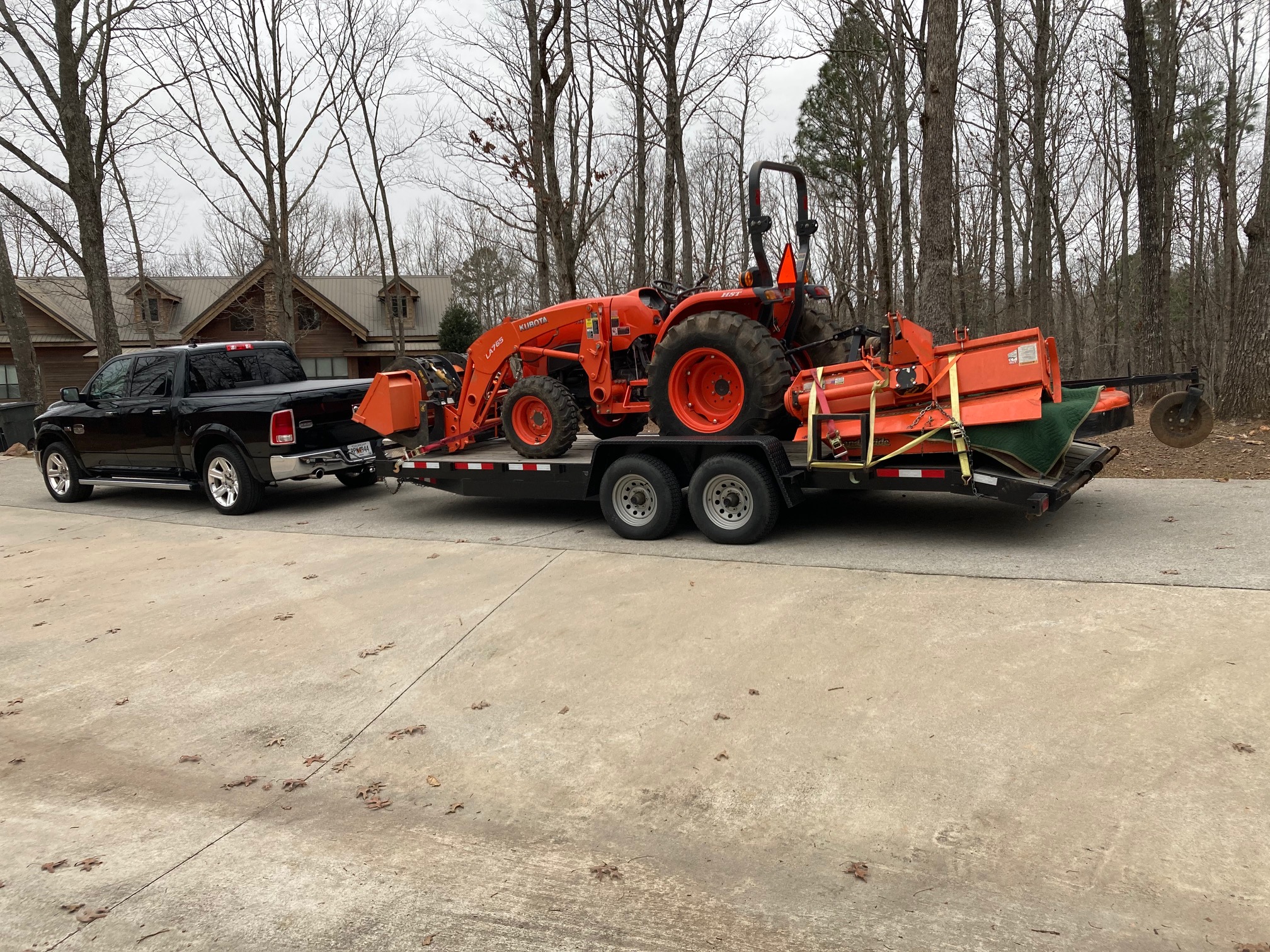

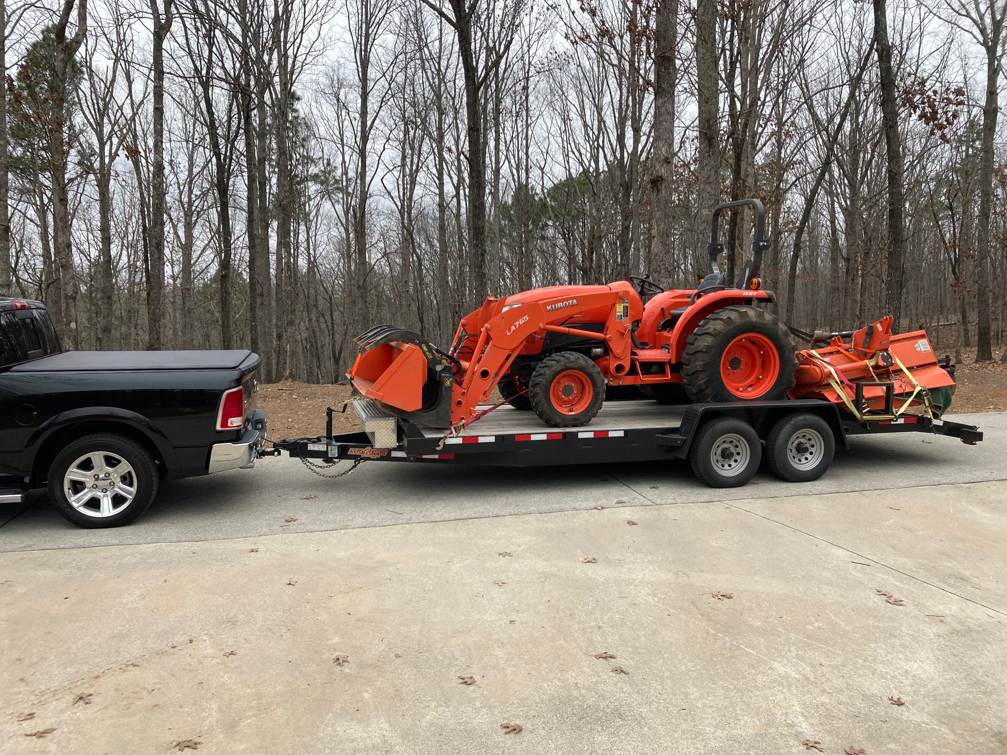

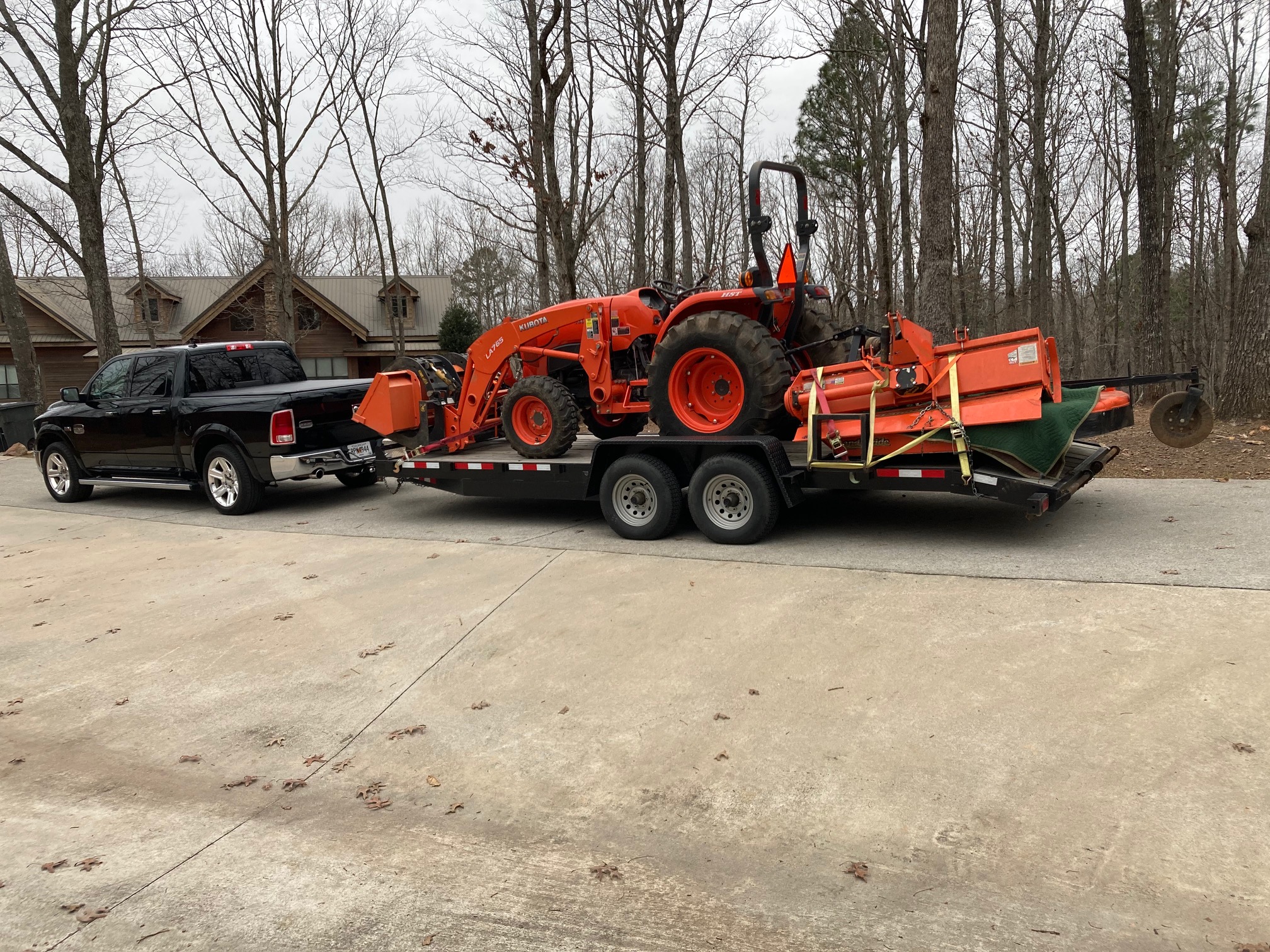

Maybe, for the trip, the safety chains were hooked from the trailer to the truck. In the picture, they were hooked back on the trailer tongue. That is one of the pet peeves that the local constabulary have for handing out "Safe Driving Awards". Nice tractor, good deal and it should last you at least two life times.
/ Just bought my first tractor
#28
Chains were hooked up for the drive but good eye!
