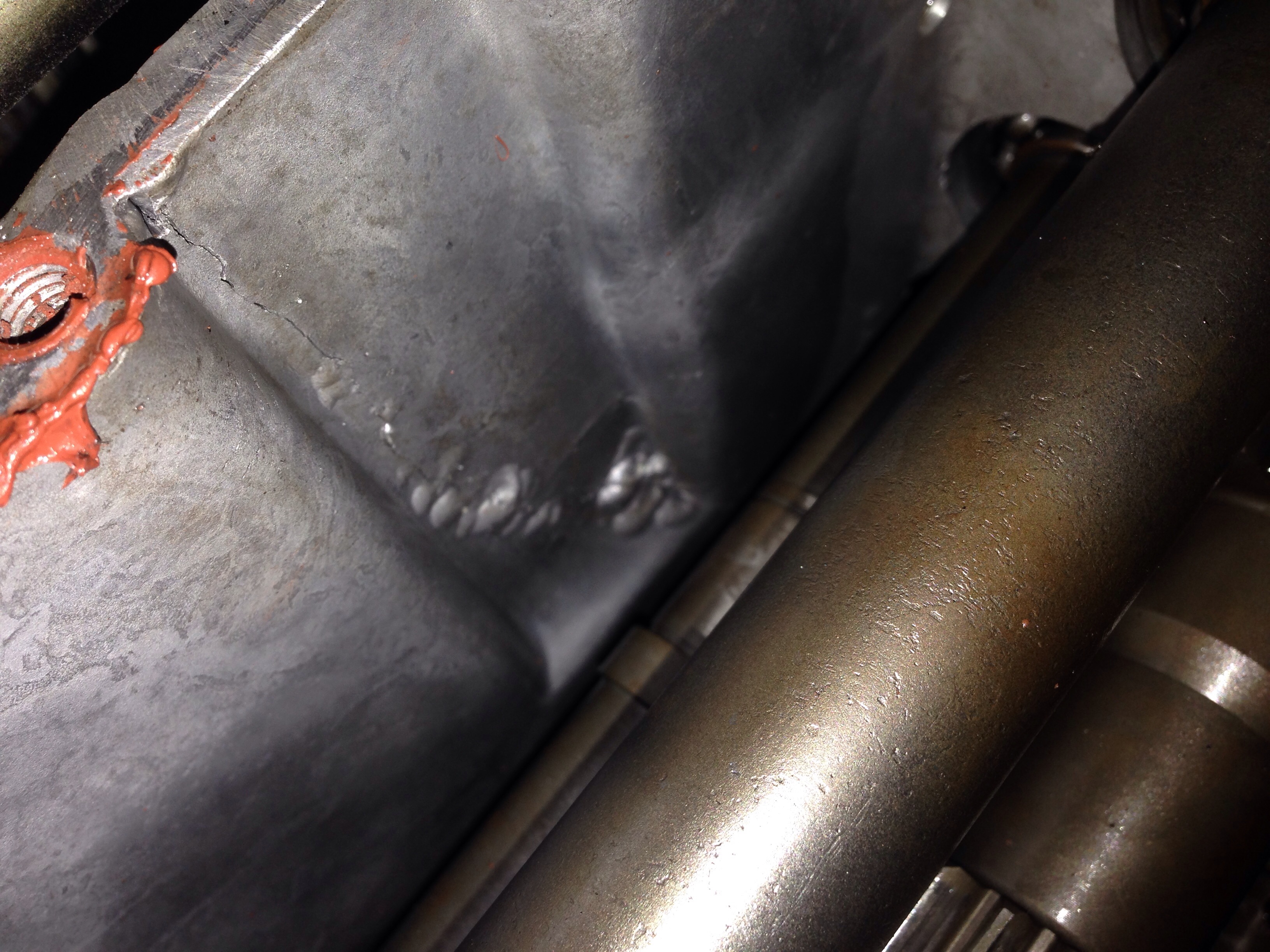

Yea I'm just going to move on. I have let this consume my life enough. I'm going to get the tractor re-welded and hope for the best.

Not necessarily the best plan of action IMO. First and foremost is to asses the situation. And right now you dont know if the leak is coming from a crack (that would indeed need rewelded to do it right), or simply a pin hole or gas hole in the weld, that some simple epoxy or a pipe plug would fix just as well, but 10x's cheaper and easier

Perhaps you should take it to a tractor mechanic/dealer for an estimate of how bad the leak really is, what it'll take to repair it, etc...?
In the end, it might not be too bad.

Thinking back on it, the New Holland TC21D (the OPs is a TC24D) was on my short list of tractors back in 2001. If the OPs TC24D is in otherwise good shape, its probably worth a repair and move along with life.
,,,...Again:
Do you see a crack in the weld? ... I dont in the pics. The leak may be just from some porosity within an otherwise strong fix. If so, you may just have a leak to stop. Forget JB weld either way. Nothing will give you enough strength, but if its just a leak look for oil tolerant sealers for tight porosity. -- Then do a clean up and fix in place. Do not use Brake Kleen because it leaves a difficult to remove residue in the metal that will degrade the adhesive as the casting warms up in use. Acetone or alcohol followed by thorough drying with a hair dryer will be much better.
