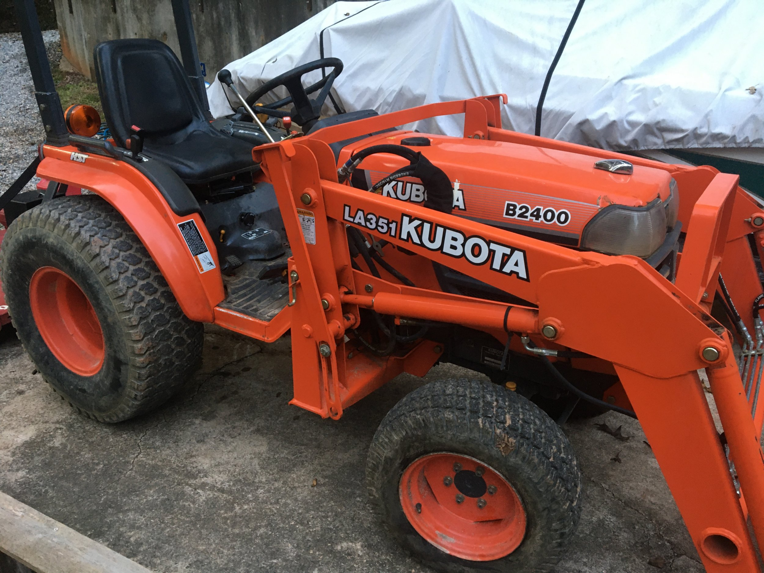

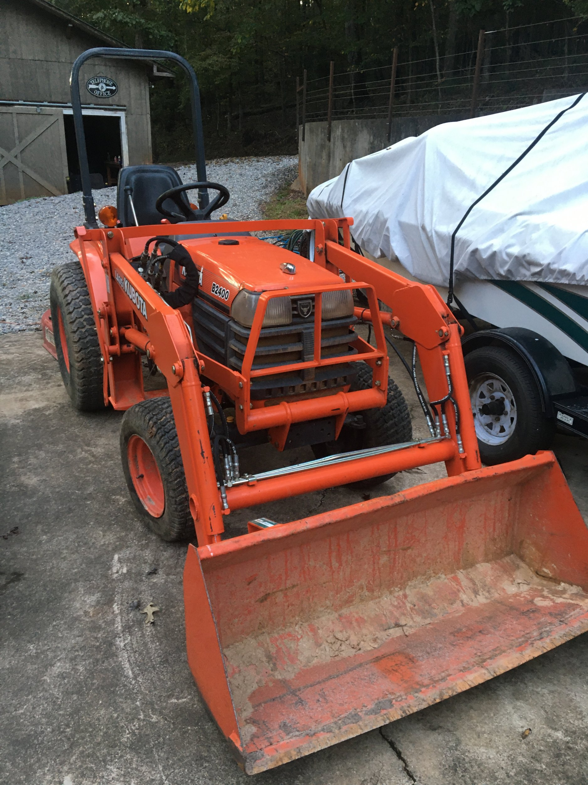

Just bought a 1998 B2400 with an FEL.
only had 201 hours when I bought it yesterday and has been kept inside it’s entire life.
The guy I bought it from got it with almost no hours and in pristine condition when he bought his house a year or so ago
However, he wasn’t very mechanically inclined and put some hard hours in it clearing his backyard which resulted in a few dings and scrapes.
Wanted to create this thread for two reasons: 1) to show off my new tractor and 2) show all the issues I’ve discovered so far and hopefully get advice on how to repair them from the great folks here.
Some background on me. This is my first tractor (and first experience with hydraulics and Diesel engines) but I am pretty mechanically inclined. Have a couple of old Gravely walk behinds I work on and use often, a saw mill whose Kohler engine I had to resurrect, and I’ve rebuilt an old cx500 motorcycle.
my primary reason for wanting a tractor was to help maintain my long gravel drive. I’d also like it help with the saw mill and to assist with storm cleanup.
First pics below are just overview.

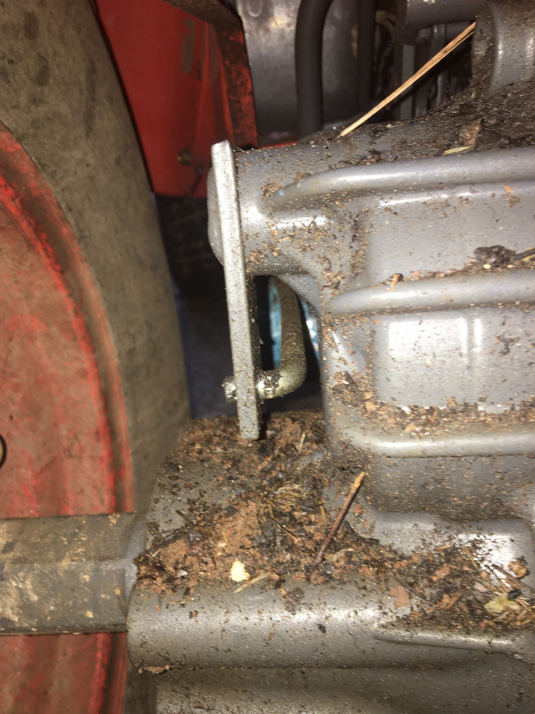

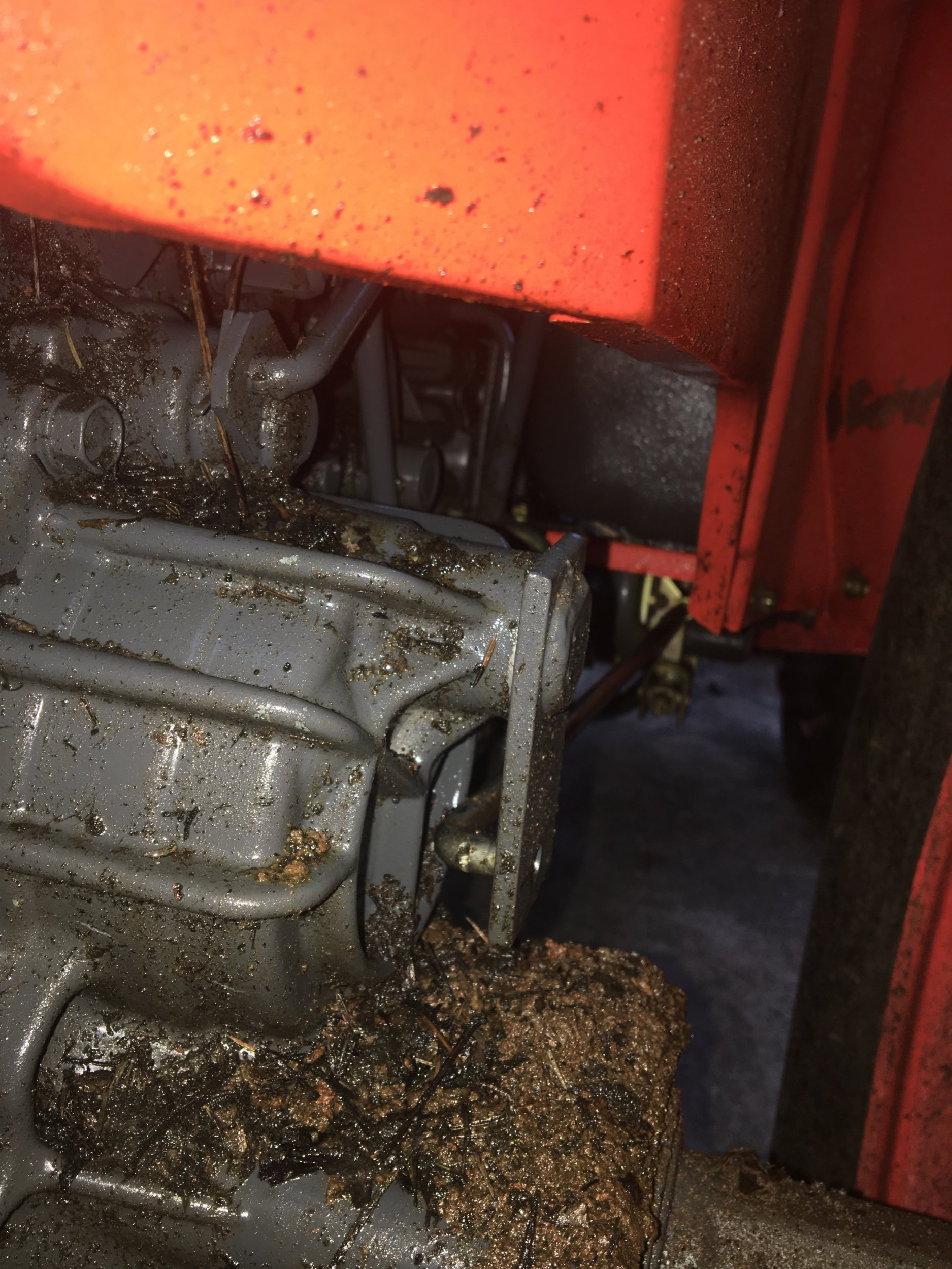

Next two are pics of right and left side of rear transmission. There seem to be 2 rods that bend into 2 linkages. Looks like they should have some kind of hair or clevis pin to keep them in? Is that right? Anyone know what these control?

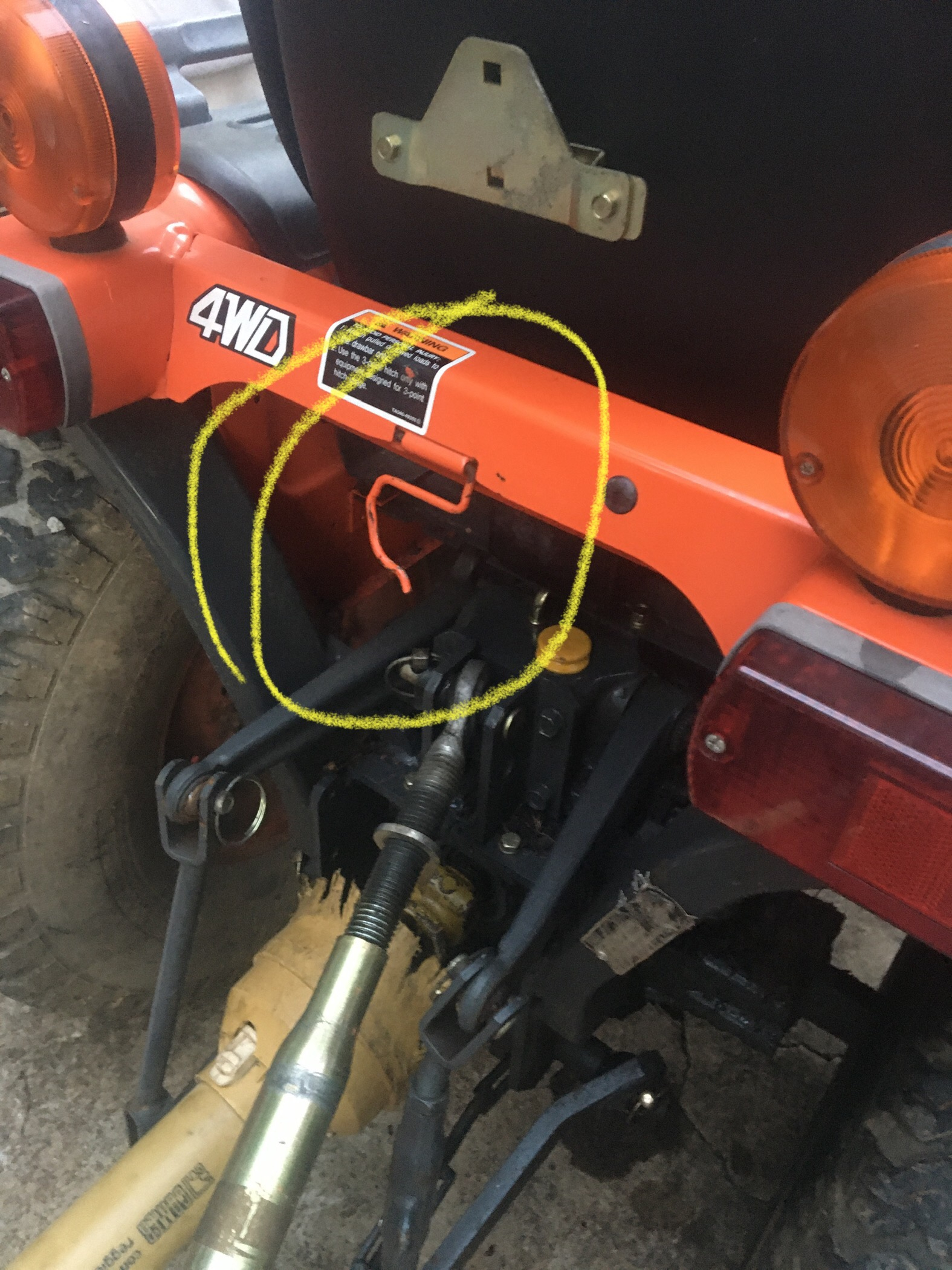

the next is of the clip that should hold the upper arm on the 3pt hitch. Mine seems to only hold the arm up long enough to make me think it’s okay to take a close look at the pto. Luckily only bruised pride ensued. Is there a trick to this? (You’ll also see I’m missing the warning sign on the back).

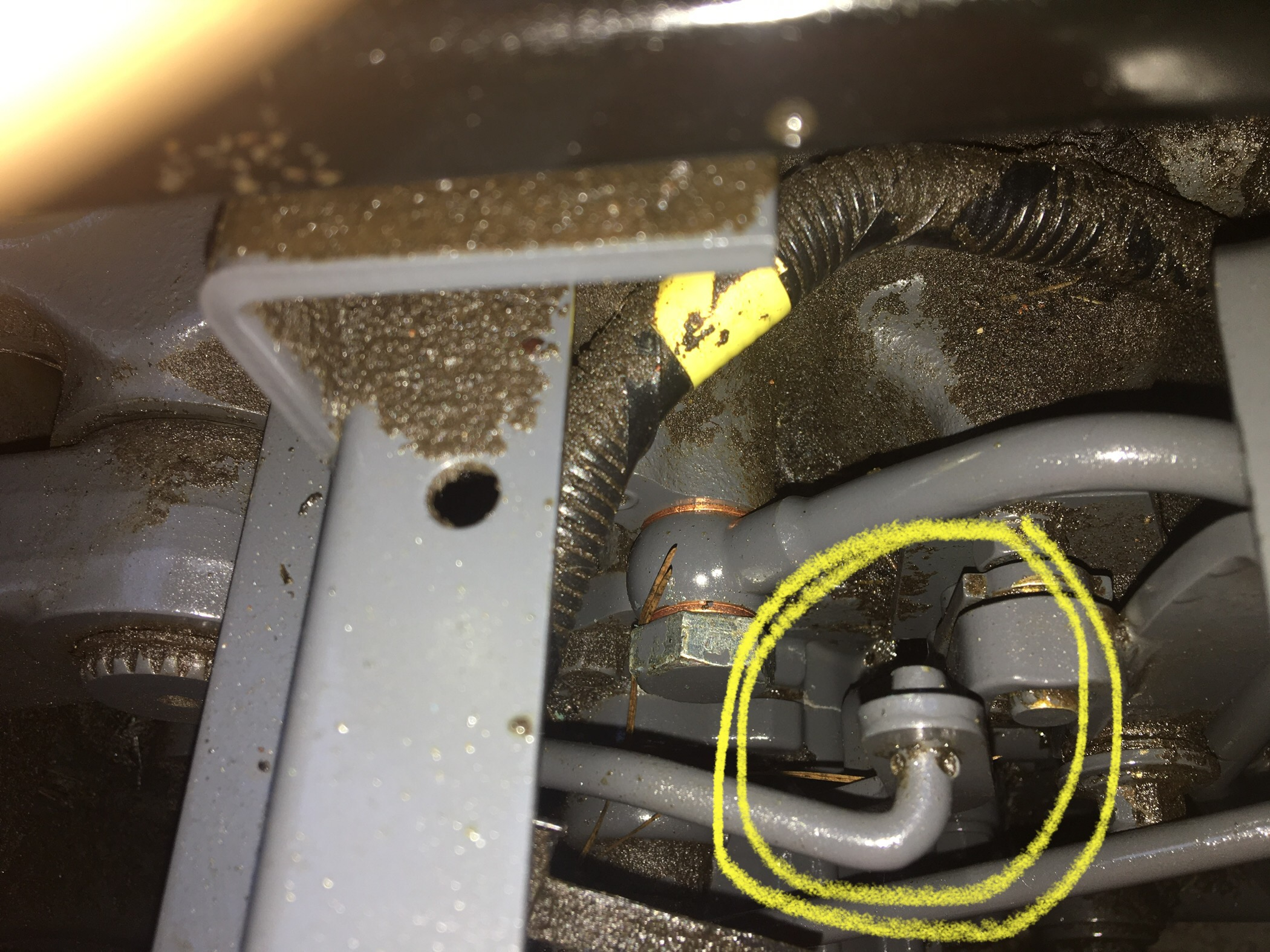

Next pic is of a hydraulic leak under the seat at a banjo bolt (I think). Sprays out very steadily. Definitely top priority.

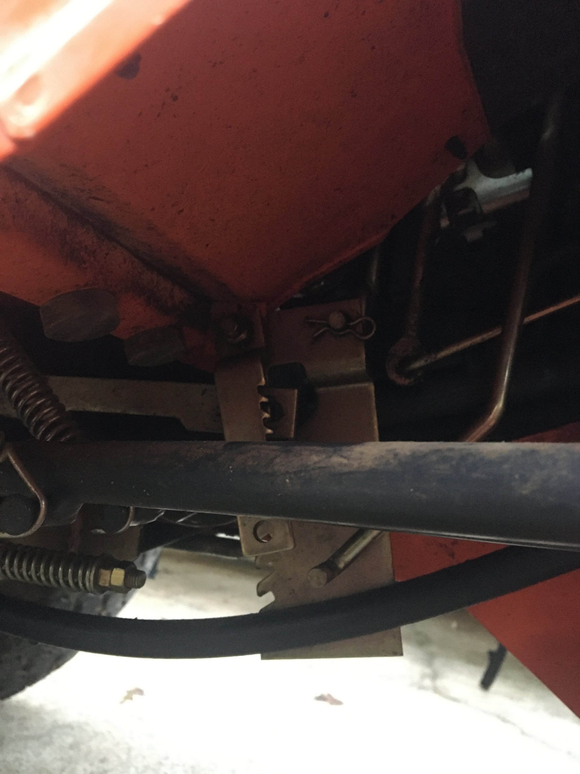

you’ll also see that there’s another linkage (pic after) near that same banjo bolt (under seat right side) that MAY be missing a hair pin? Anyone know for sure?
Final pic is of the linkage to the emergency break that keeps popping loose. does it just need a hair pin or are there washers or spacers missing?

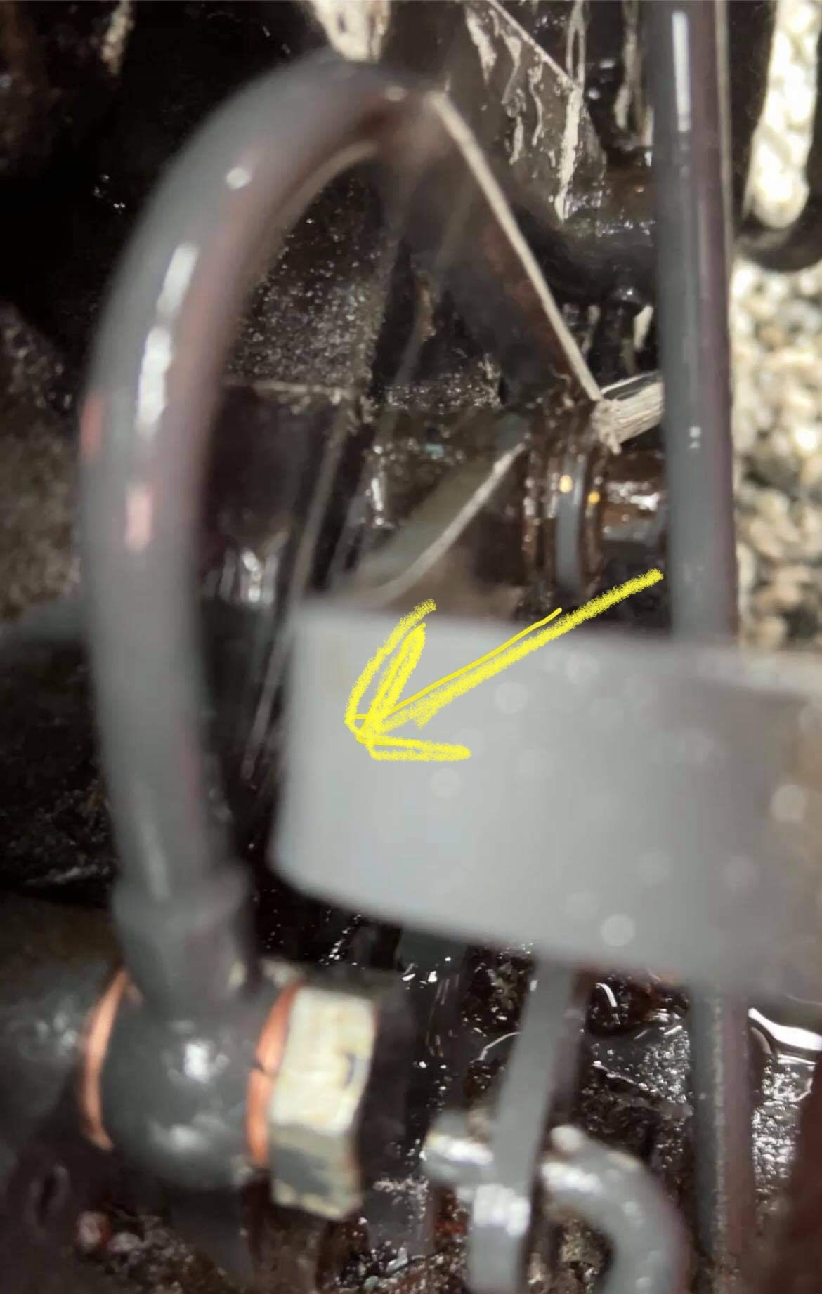

Geeze -- not sure where to start. Easy one first: the 5th photo with the circle drawn around the wire-like thing hanging there -- Yes, that is intended to hold up the top link. Terminology is "top link" not upper arm. We all speak very correctly here ....and if you believe that I also sell Brooklyn Bridges.
That heavy wire-like thingy is just bent slightly out of original shape. It should be bent back into a size of opening that will cause the top link to snap into it and stay put wiothout a heck of a lot of force to either snap it in place or to pull the top linkl free from it. Just bend to suit.

Obviously you LEAP onto that spraying fluid issue first!! I believe the pict with the yellow arrow is pointing to the high pressure hydraulic line. Most likely it simply needs tightened to stop the spray BUT no one out here can tell whether you have a broken/split open line or connector or who knows what. Try snugging what looks like a bolt head and see if the spray stops or at least changes. Inspect that area with a fine tooth comb and see if you can see the real origin of the spray. It pretty much has to be hydraulic fluid which is not much but very thin oil. Best use the stuff Kubota sells at twice the price of Tractor Supply at least until you get comfy with the whole rig. Of course I mean topping off the hydraulic fluid once you stop the leak/spray.
The last picture looks like the teeth on the lever you move in order to lock the brakes "on" having pressed the pedal down firmly. I'm not sure what that is but to my knowledge there is no such thing as an "emergency brake" on these tractors. I have 3 B2150s and one BX2200. By the way, my BX2200 has a single brake pedal that is largely a joke and worthless. The B2150's have very good serious brakes with dual pedals for left and right rear brakes.

You have a really nice little tractor there! I can't improve on JWR's sound advice but only thought to add a bit of caution about that hydraulic fluid. When the tractor is running the hyd fluid circulates under pressure somewhere around 2,500-2,900 psi, not something you want spraying on yourself for sure. Be really careful working around those lines and hoses as you close up whatever is dripping.

Good info from JWR. Some suggestions. If you have a hydraulic leak, when looking for it, Keep hands away from it. The pressure from a pin leak or crack can easily pierce skin. (if that is a high pressure line) I think I would spend a little cleaning it up. Then I think I would want to know it service has been maintained on it. That is why a manual is important. Check the hydraulic oil used with the transmission. Is it clear. It should be almost hard to see on the dipstick. Are all pins greased - if not, do that. The manual will tell you how and when to do all this. But make sure everything is in order one step at a time. I think you may find a manual online. But I know you can order one from Amazon or Messicks tractor. Check to see if the rear tires have ballast - liquid. If so, what is it - water, windshield washer fluid, look brown like beet juice, smell like alcohol (it is methonal) or is it calcium cl. It is important to know information about your new tractor. Do not assume it is up to specs on maintenance. Make sure. Most of these are low cost and something you can do yourself. But they will make the difference between having a lifetime tractor or trouble. Congratulations on your purchase. Best Wishes, Larry

Please make sure that you NEVER let that leak spray onto your body. If it sprays with sufficient force the oil can be injected into your body. This is a bad thing. I know a woman who injected plain water into her foot from a pressure washer and the docs were very worried about her having unrepairable tissue damage and infection. Hydraulic oil is much worse.

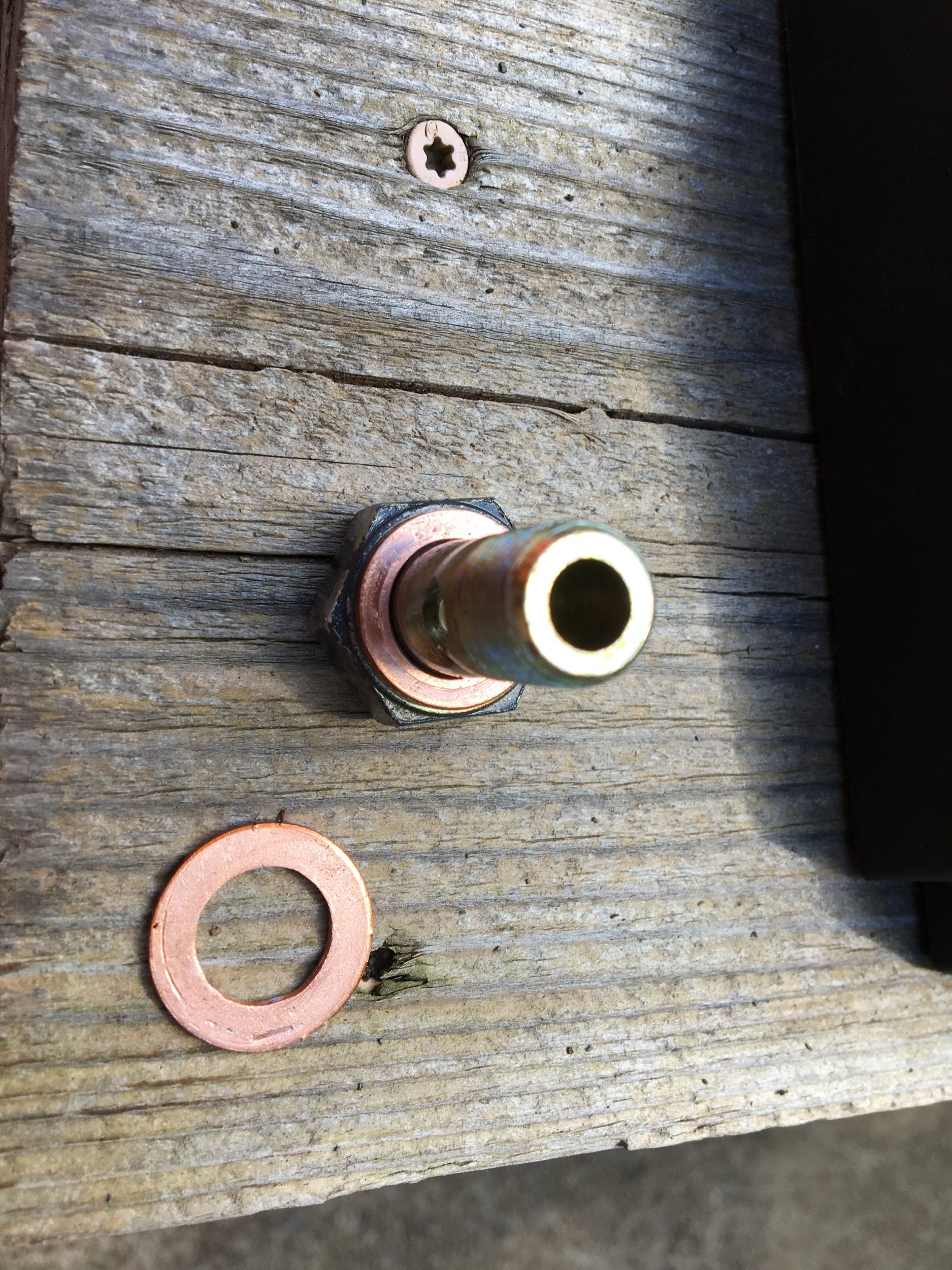

Couple of updates
1) went through and put cotter pins in several linkages that I saw were missing them (parking brake, regular brake rod at rear, clutch pedal rod at the rear linkage…).
some of the rods had come clean off the linkages (parking brake and clutch) so they are all on now.
2) pulled of leaking hydraulic banjo bolt. Saw some scoring on the washers. I’ve been told on another site that these need to be BSP copper washers. Does anyone know if that’s the case? Or could I just hear these up and reuse? (See first pic)

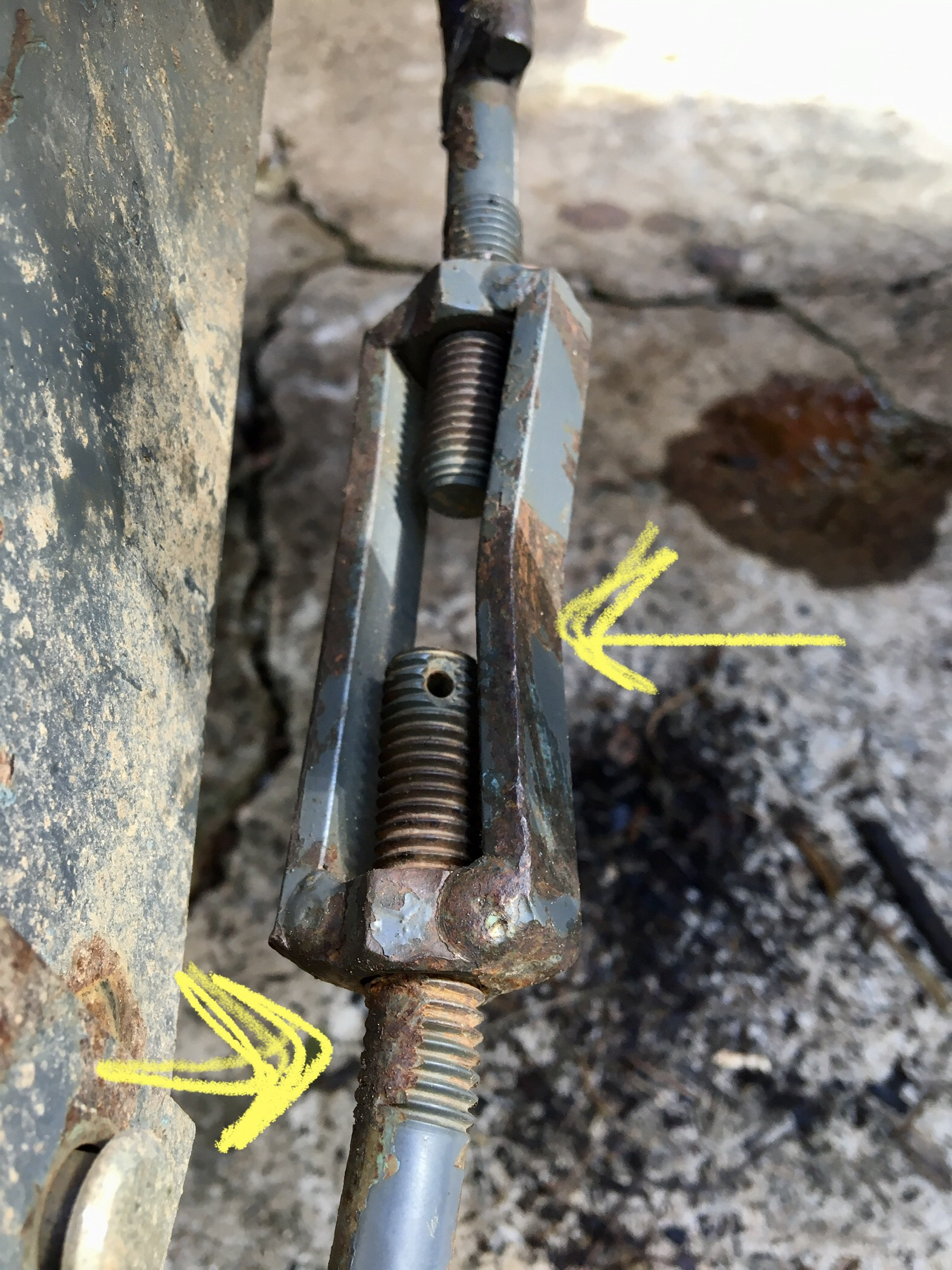

3) also noticed that the left arm in my 3pt hitch is bent and the threads have been stripped—I think it’s beyond my ability to repair. Anyone have a good source for replacements? (2nd pic)

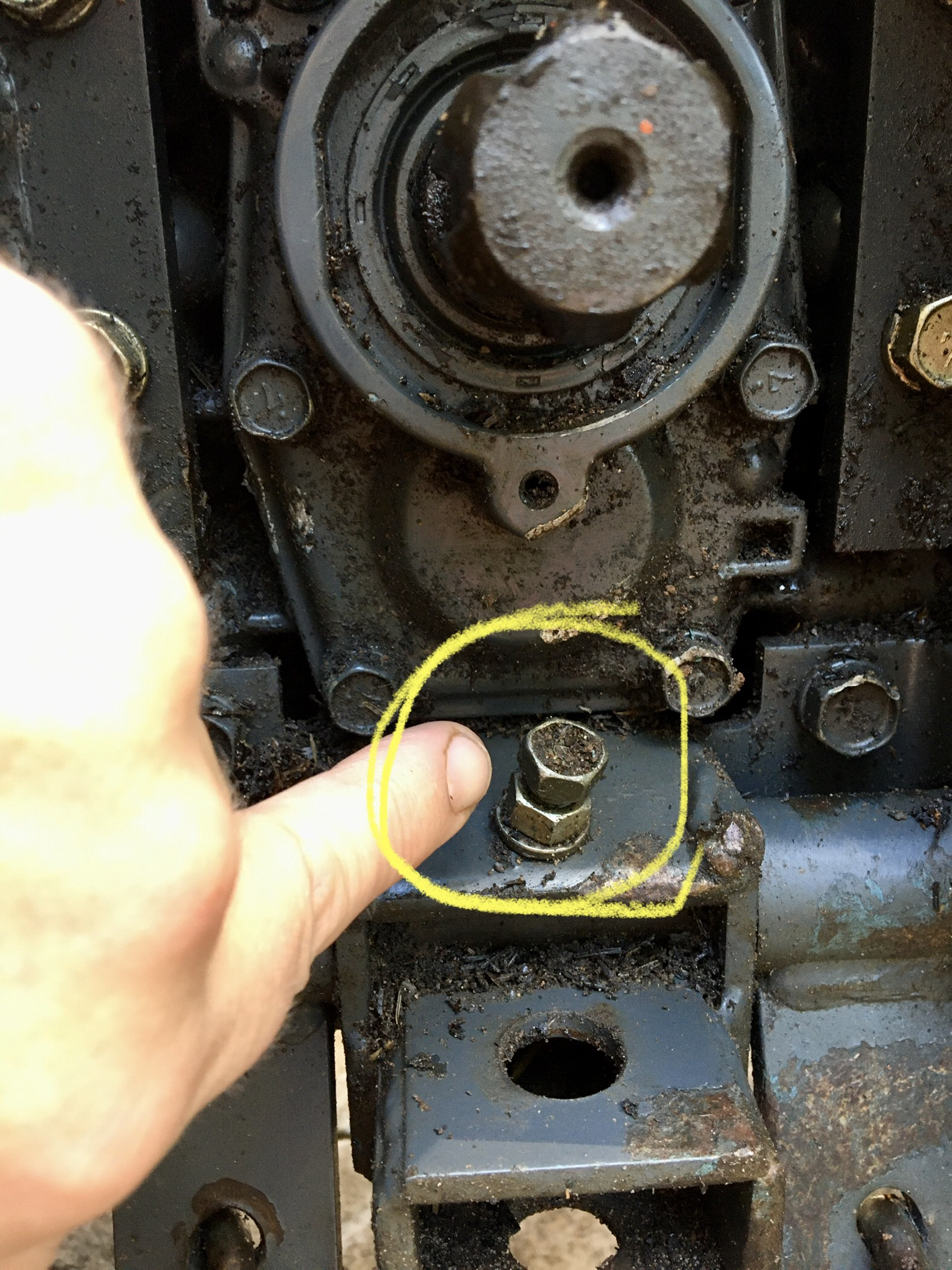

4) found this bolt just below my rear pto that is loose and bent. Can anyone tell me what this was for?
(last pic)
Thanks again!

Not sure on whether the washer NEEDS to be bsp but i know you can get a big assortment of copper sealings rings cheaply on Amazon. I bought an assortment a while back and will probably never run out.
The bent thing with thread damage is used to tighten the 3pt arms inwards, taking side-to-side slack out of the 3pt so attachments can't swing/bang back and forth. Leaving it as is would just mean you couldn't shorten that link any more, but i doubt it would actually fail. I'm not sure what they're called when used in that function right there but generically it is a turnbuckle.
The bolt in the last pic probably doesn't belong there and may have just been used as a hitch pin stuck through some clevis hitch like a yard cart. Hard to tell without knowing how long it is on the other side.
