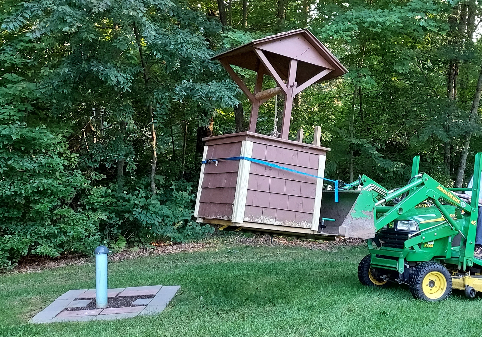

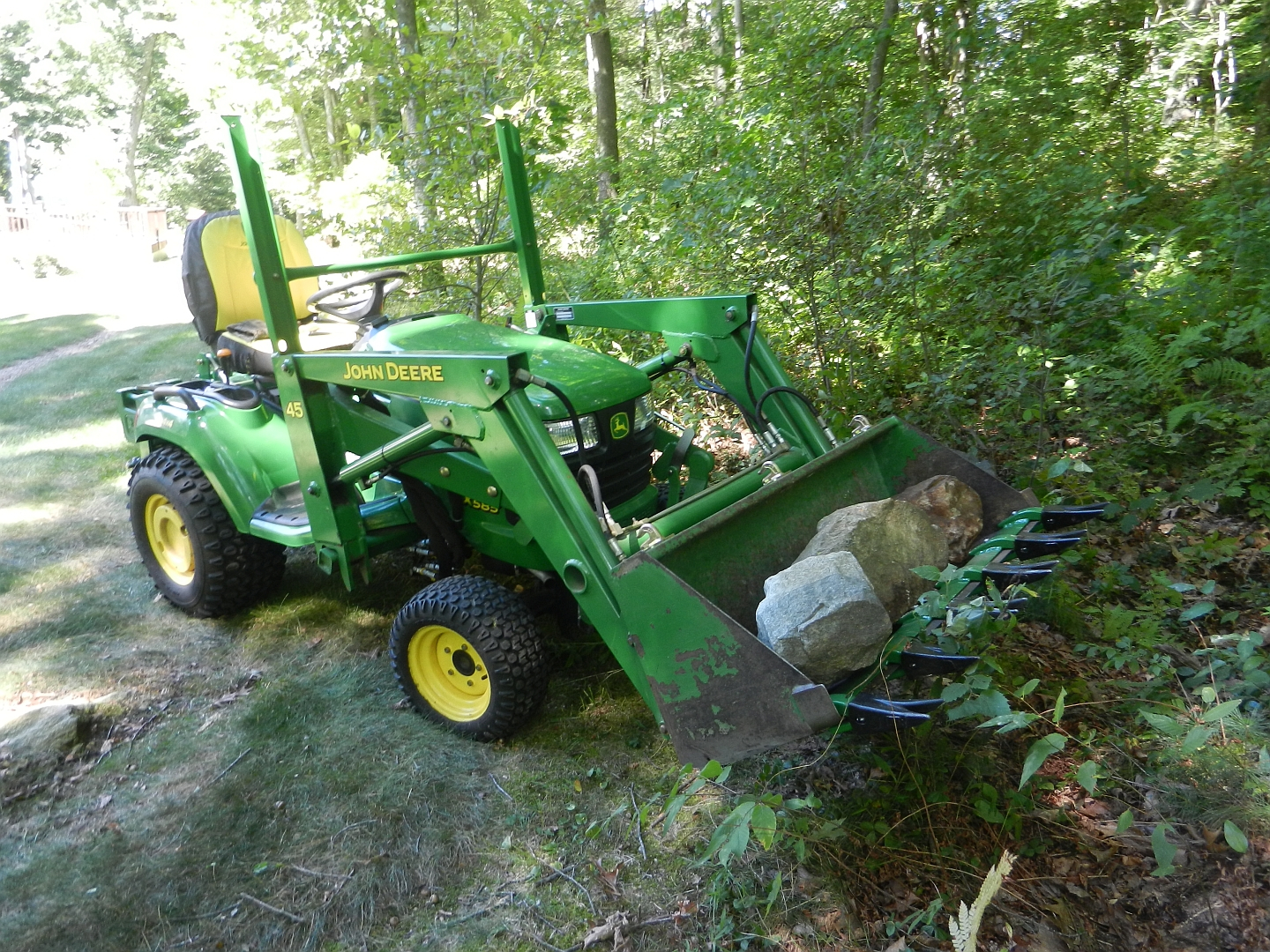

Nice find. Looks good considering the age. After you get that leak fixed, here are some other things to consider.
If a grapple is not in the cards for you in the near term for your tree clean up work, you might consider a tooth bar for the bucket and/or clamp on pallet forks. I got a nice bolt-on (no drilling needed) tooth bar from Heavy Hitch for mine but there are a number of other options/suppliers available. I got my shorter set of forks (34" working length) from Titan Attachments which are great for working with brush. You'll want longer if you expect to work with pallets or larger items. I like the 34" in part because they are lighter but also because I really didn't need the longer length and they are relatively inexpensive.
An alternative to pallet forks would be debris forks which are aimed at brush work and have four or more arms to them. Again, multiple other options/suppliers available.
One more thing to consider are hooks for the bucket. There are bolt-on and weld on hooks out there. Great for a variety of lifting tasks and securing things to your bucket. There is just so much you can do with a bucket. Have fun!!!
OH. DON'T FORGET TO BE SURE TO HAVE PLENTY OF BALLAST WEIGHT FOR YOUR LOADER WORK!

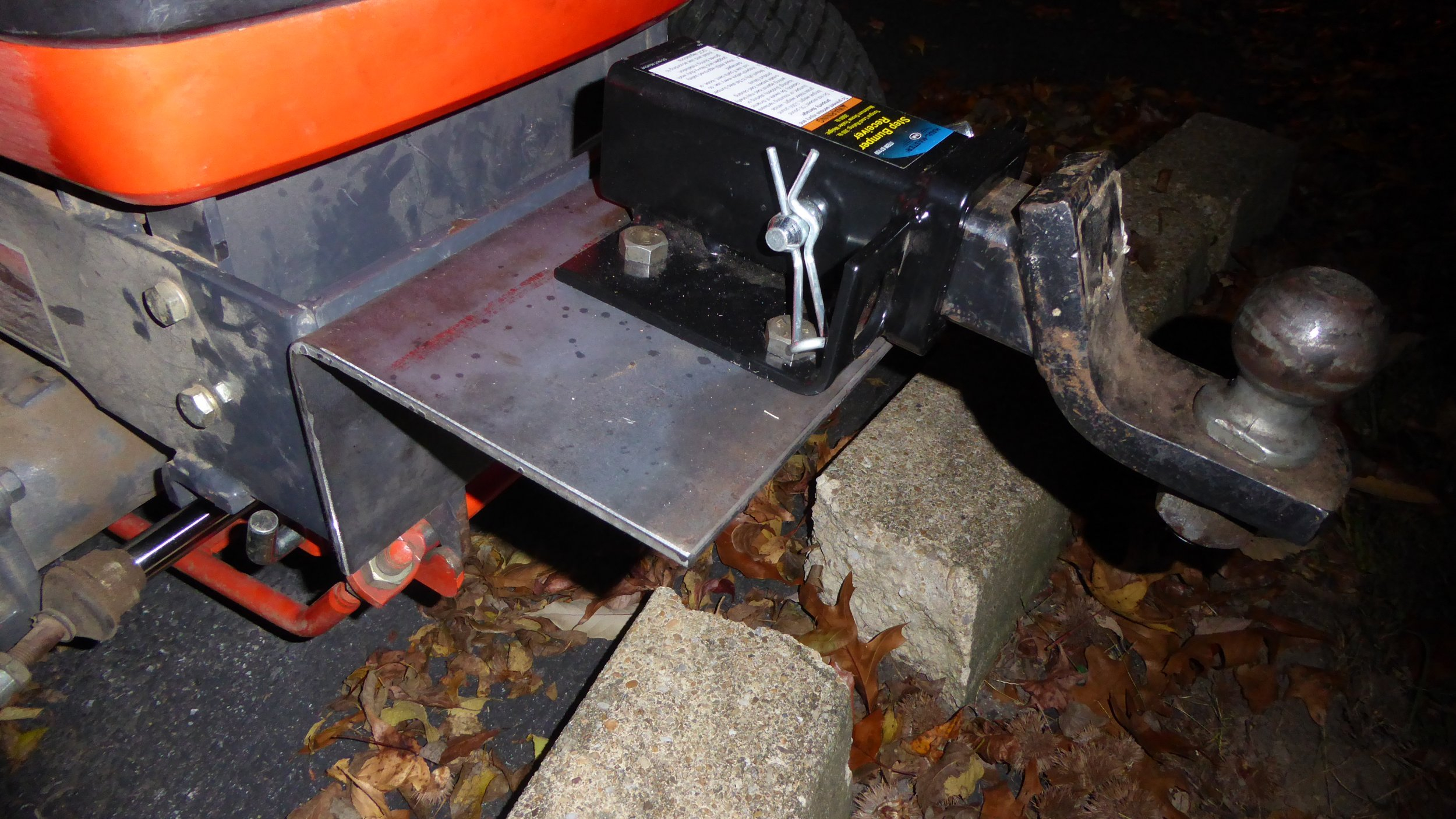

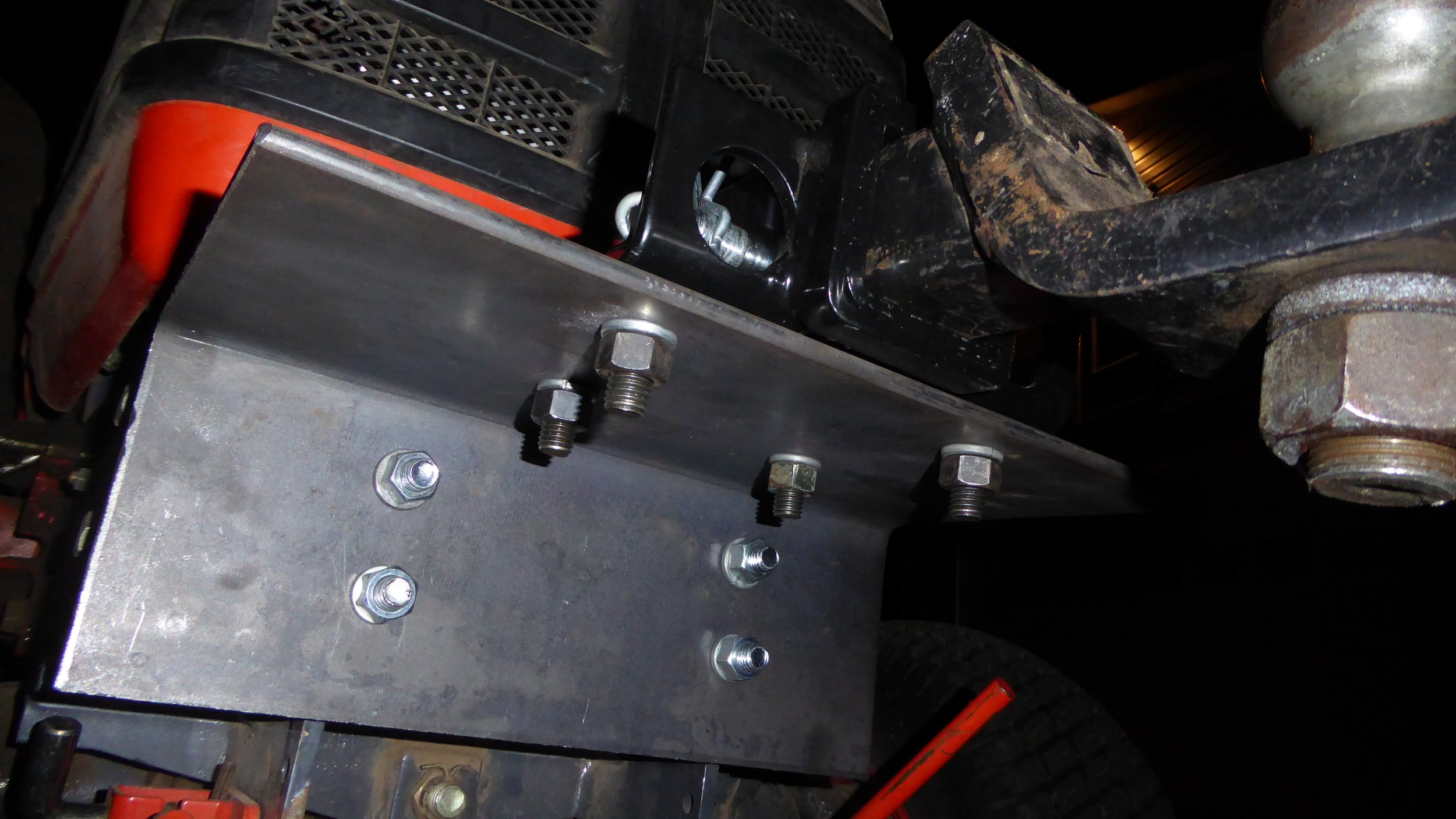

About moving and parking trailers with your Kubota: I got a foot long chunk of HEAVY angle iron from a local welding shop (around 5 or 6 " each flat surface, 5/16" thick) and drilled it such that I could bolt it to the existing holes on the front of the Kubota frame. I then bolted a receiver hitch (just the hollow tube from Tractor Supply intended to be welded probably) to the top surface of the angle iron. Pictures later if I find one. This handy attach point still clears the front end loader (gotta watch that) and is incredibly agile/maneuverable/friendly for moving trailers around. Plug your hitch ball insert into that. SO MUCH better than any kind of rear hitch point because you can see what you are doing and far more maneuverable than any rear hitch.

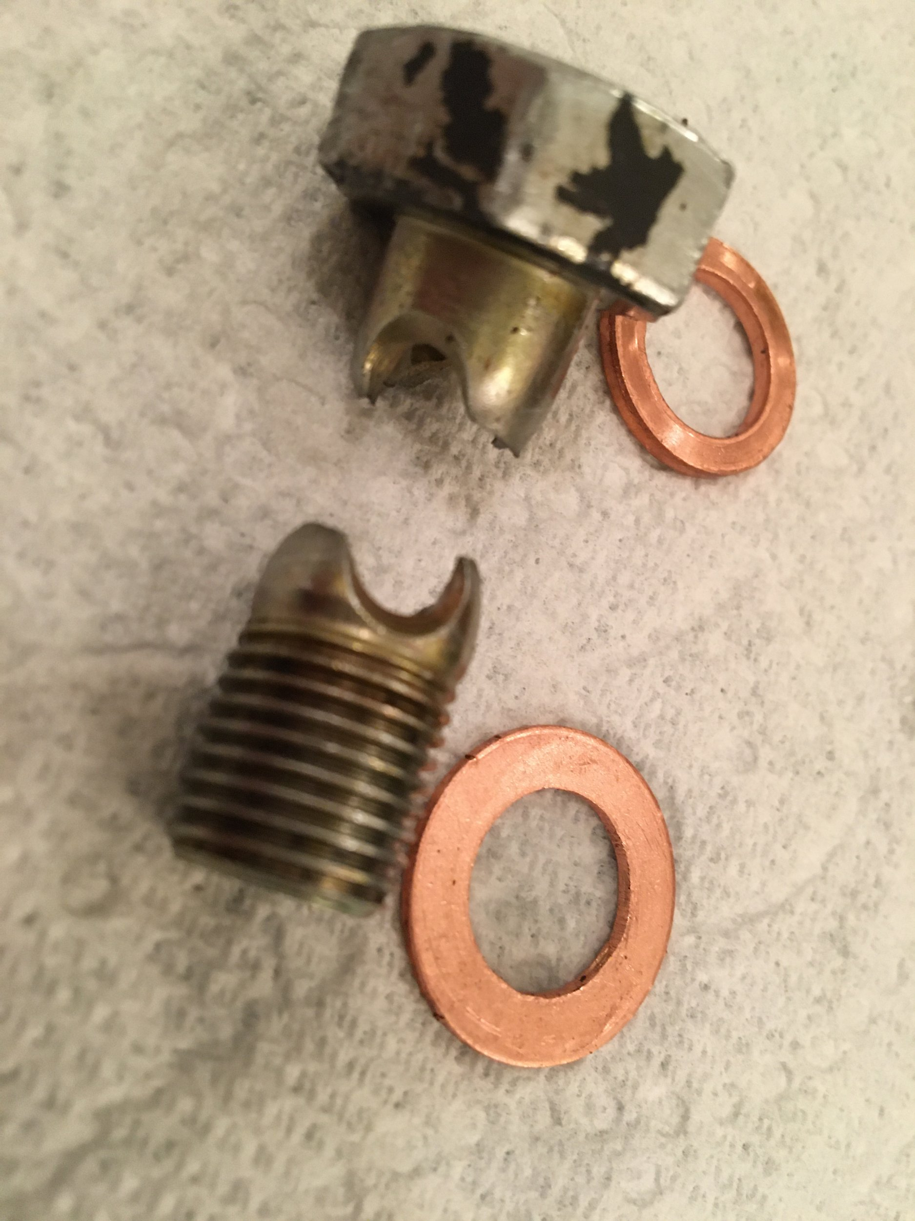

First snag!!!
Didn’t think about torque value on banjo bolt fitting and snapped it clean in two. I’m a bit worried though because I was able to back out the broken end with just my fingers. I’d have thought that it would have been a bit firmer in there if it was torqued down enough to snap. I
Now off to find the right banjo bolt to replace. Argh.

The gravel incline with an 1800 lb boat -- not sure. Certainly with 4WD and the BX power in low range you have plenty of towing ability to pull it. The whole question is traction and how steep is the gravel incline. Might want to run a test towing something else up that same incline first. Weight helps ! If you go with a front mount hitch similar to the pictures below you would be backing up the slope and could mount something heavy on your 3pt hitch.
Here is a picture of the rig I made up for maneuvering trailers with my BX2200.
   / Just bought a B2400–wanna make it right #19
Did you bend the bracket? Doesn't look like angle. Nice bend. All looks good, now traction is the next thought. Only one suggestion - I try to use grade 8 bolts on anything that deals with weight. But that looks plenty strong. When ready, prime and paint it.
