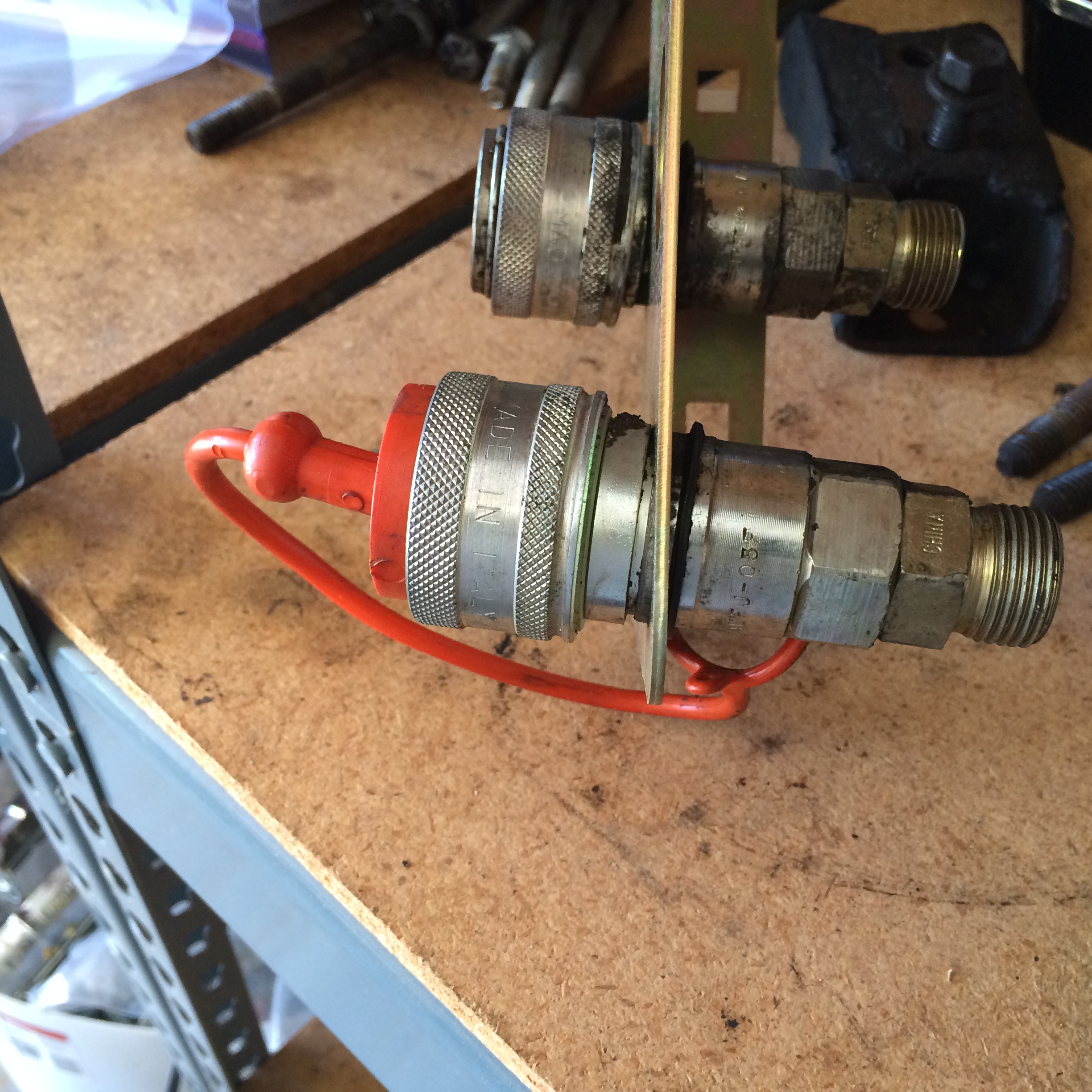

With respect to the rear remote installation ... I had to purchase a new bracket to mount the couplers on the left rear subframe. The plate is a superseded part number but will bolt up without issue. However, the couplers use a retaining ring to mount to the plate but the plate isn't thick enough to take up the room between the step in the coupler and the retaining ring - meaning a very sloppy fit. Just wondering if this is normal and the tubes add rigidity. Or perhaps the original plate was thicker or used washers to take of the clearance. A picture is attached ...

I suspect those are not "factory couplers" When I put rear remotes on my JD 4400 (related tractor and i suspect uses a similar rear remote setup.) I quickly found out the factory bracket is not designed to fit "standard" 1/2" pioneer style quick-couplers. The bracket is designed for 3/8 inch Iso-B connectors. The factory ones have a snap ring groove that will hold the coupler in tight. Not all 3/8 ISO-B couplers have the groove in the right place. Tractor supply sells couplers that will work (i.e. have the groove in the correct location). However if you have a lot of equipment with half inch "pioneer style" couplings you may want to modify your bracket instead.

/6 ... you may be right, they may not be the factory connectors. Fwiw, these connectors have two retaining rig grooves - one right next to the step and another approx. 1/8th from the step. I bought the 6 color keyed connectors from a parted out 110TLB. At the same time I was lucky to get most of the tubes, the complete diverter valve and brackets to make the upgrade at least somewhat affordable. Now if I had to pay someone to install ... well, that would be another story altogether.
