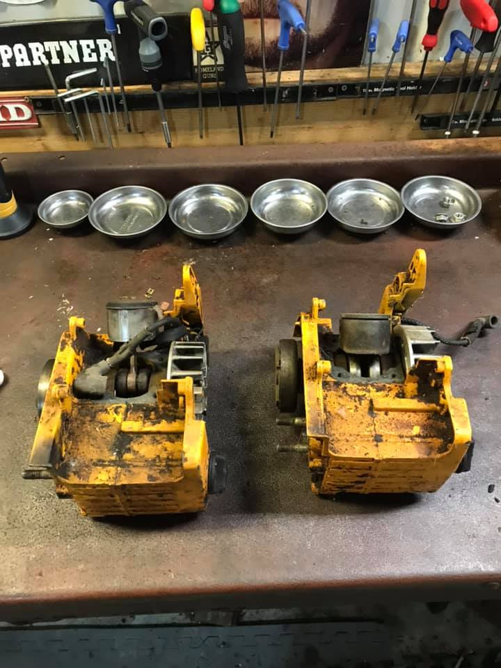

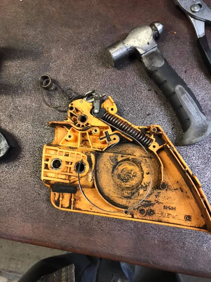

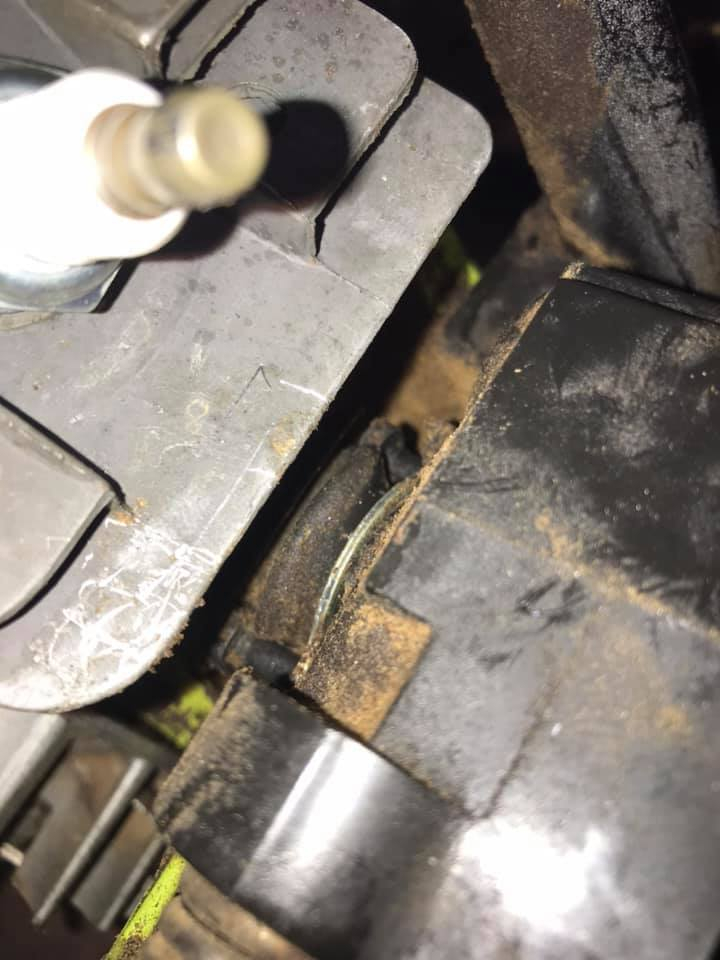

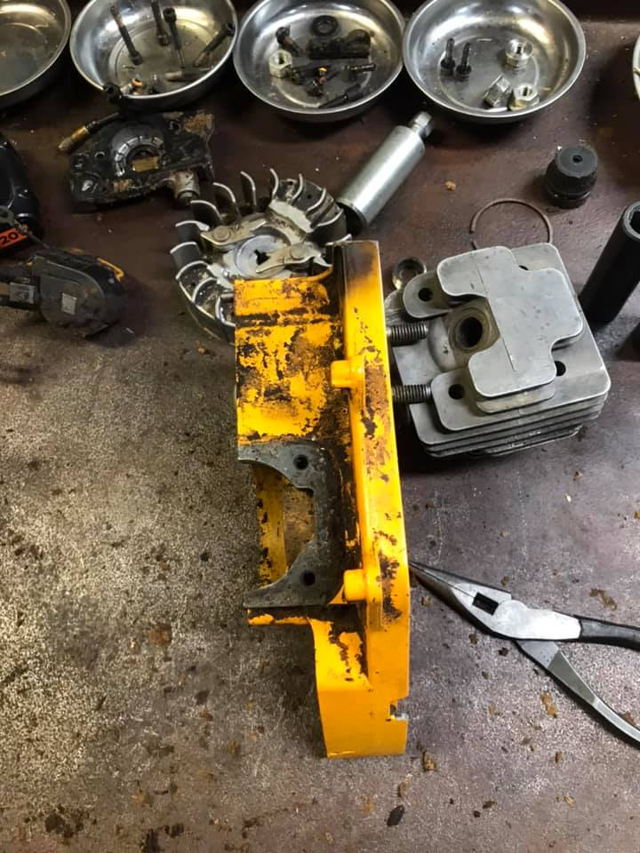

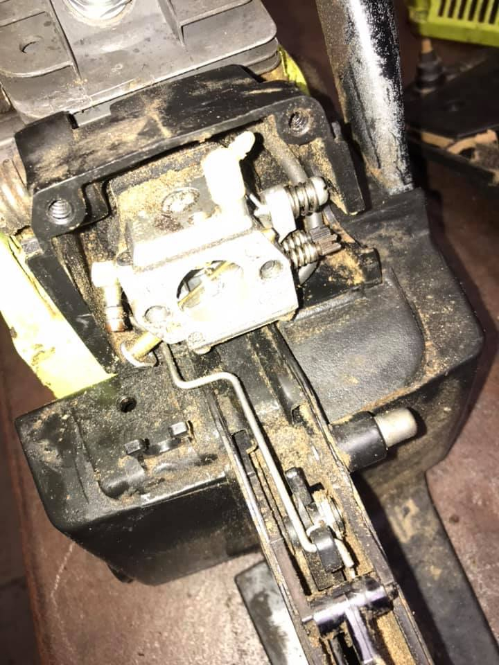

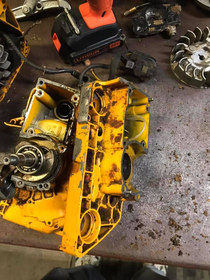

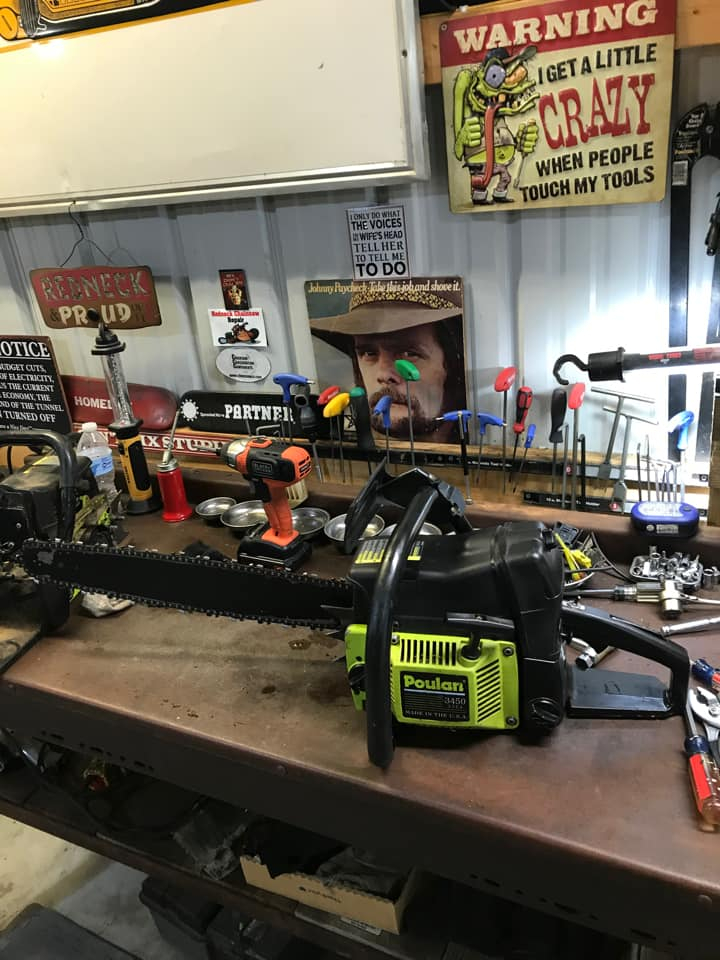

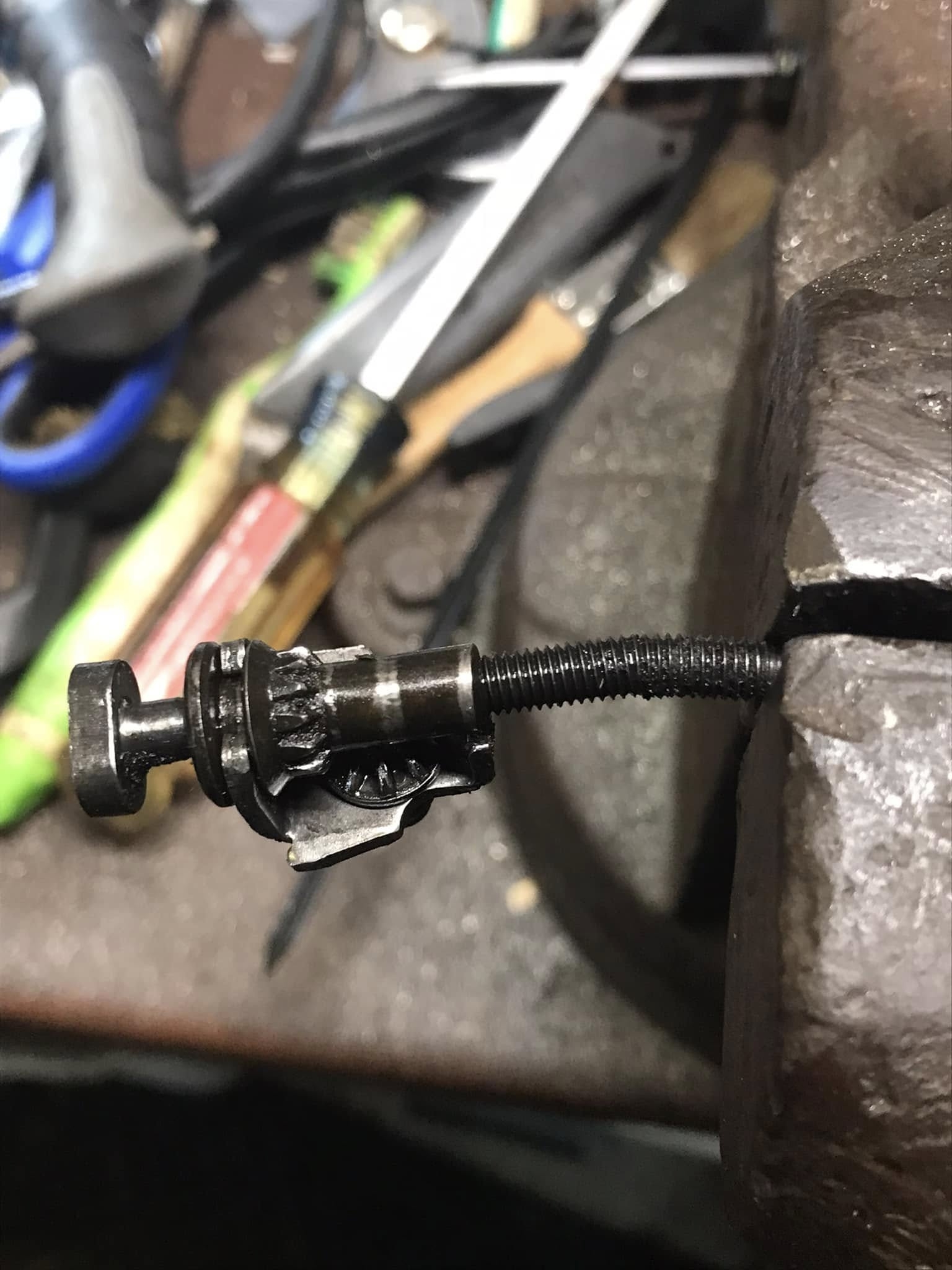

Poulan etc pin puller I got from Chris at sawsalvage for $23. If you aint got the oem tool or redneck your own. This maybe makes it so easy.
Pulling parts from a parts saw for a guy. 3700 thin ring piston and cylinder.
Been using for many years now too. Stihl one for close to 10 years.
Once you got right tool you wont go back. Just a no brainer when tools so cheap for job. Stihl 5 bucks.
The tapered punch sometimes would get stuck and mf to get out. Plus bigger pins the redneck stuff didnt even fit would go right through. Why had to use dowels etc.

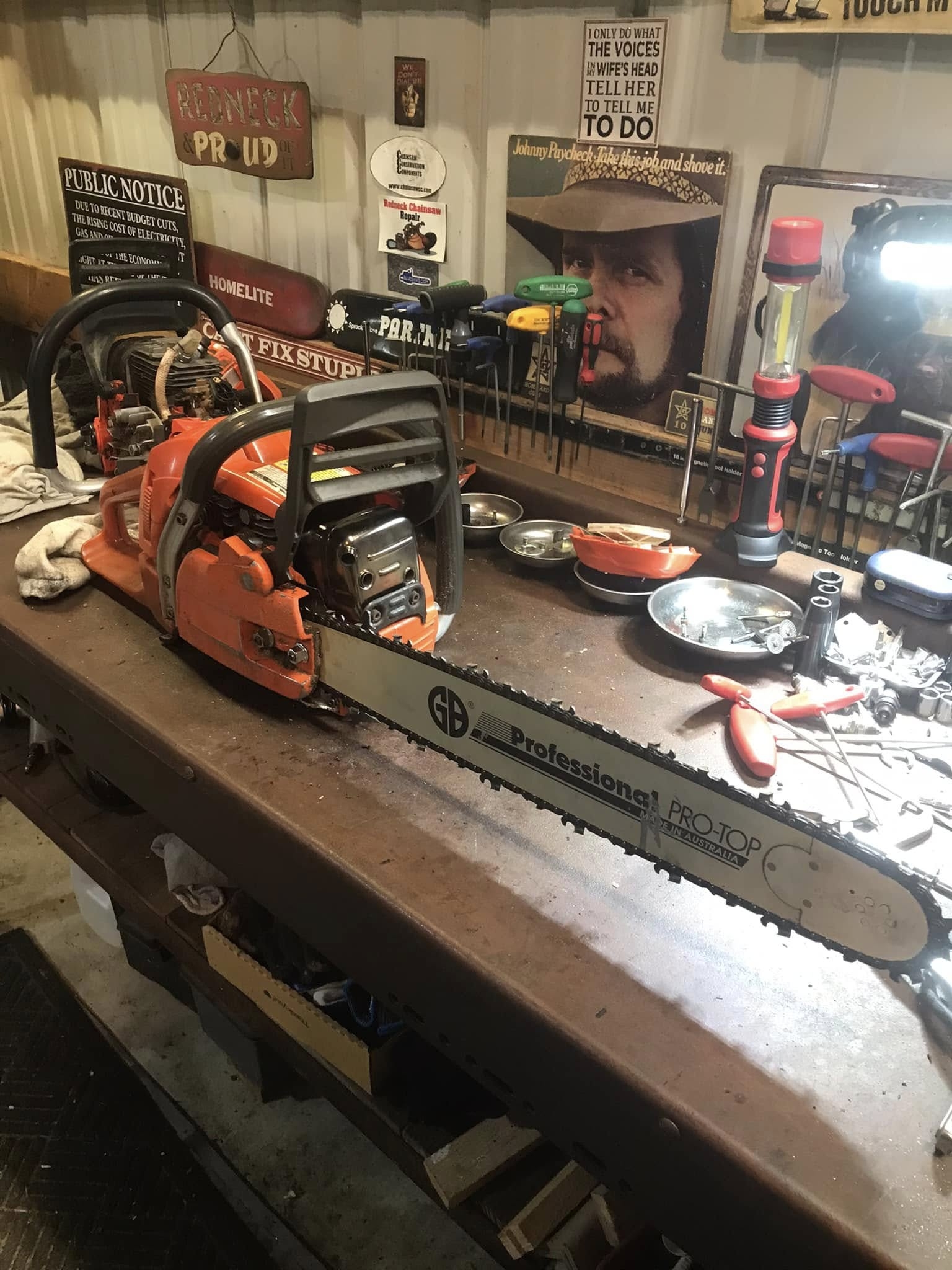

New used echo 501 showed up from TX.
Some quick free fixes.
Pull that crap from muffler 5mins tops.

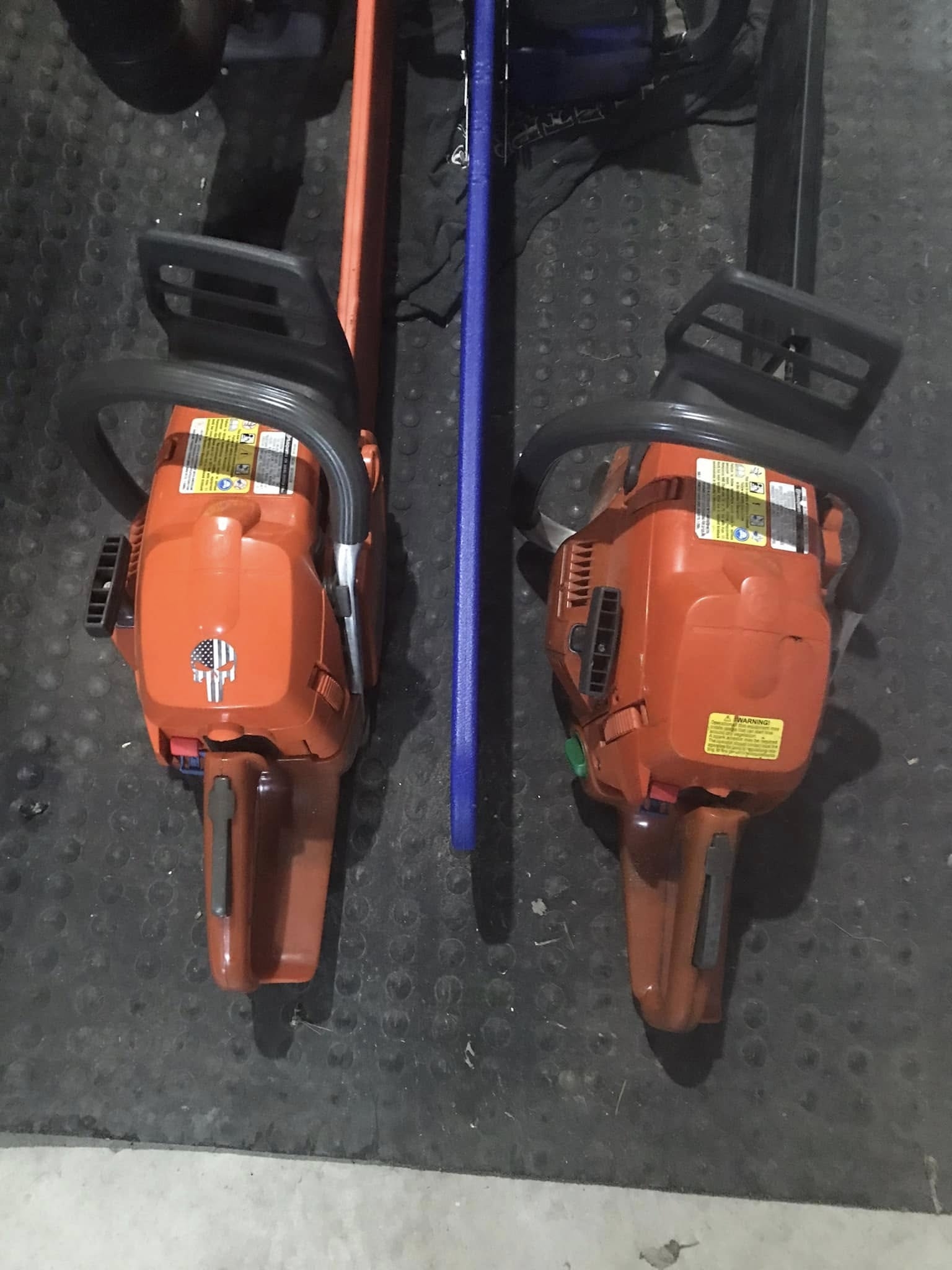

Only thing I cant stand is those freaking plastic handles on 4910 and 490. With the rubber antivibe these use can feel the vibes more.
I tested switching my other 501 handle on 490 and back forth same dang vibes felt with plastic handle. Not with metal and thick rubber coating.
If this one had been 4910 I wouldnt have bought it. Metal handles 50.

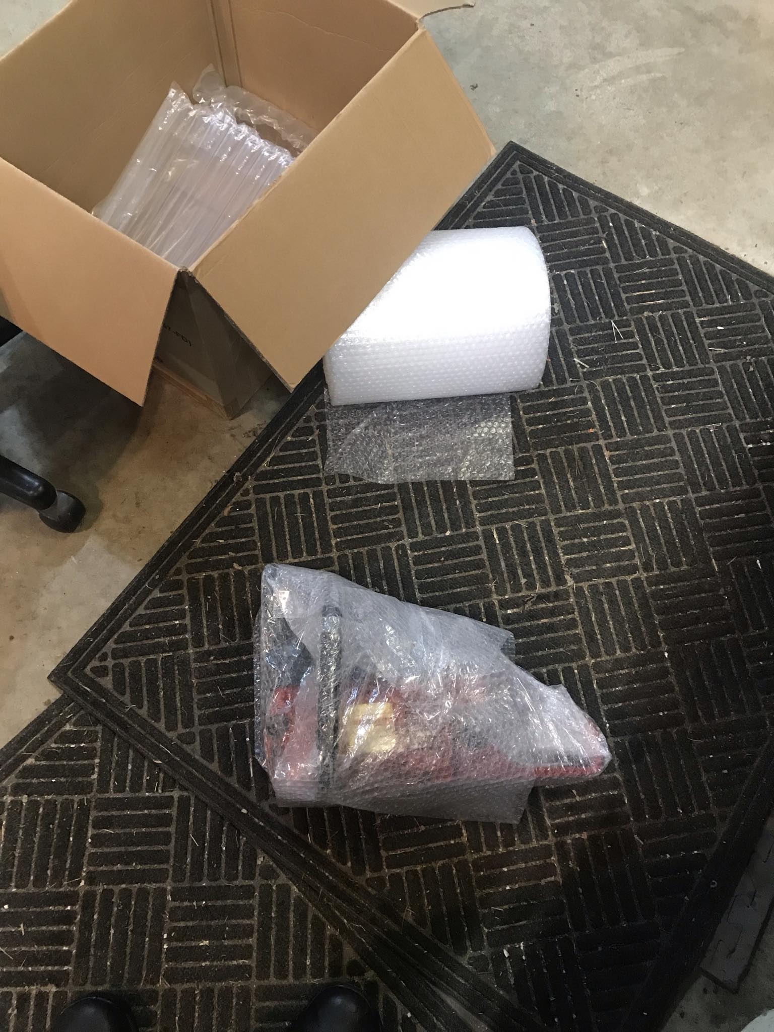

Bye bye 670 Champ. Some bubblewrap and then trash bag. Then ;) 😂 :ROFLMAO:
Collector wanted and we did some trading.
They run great for a 50mm with 34mm stroke. Was highly impressed with it.

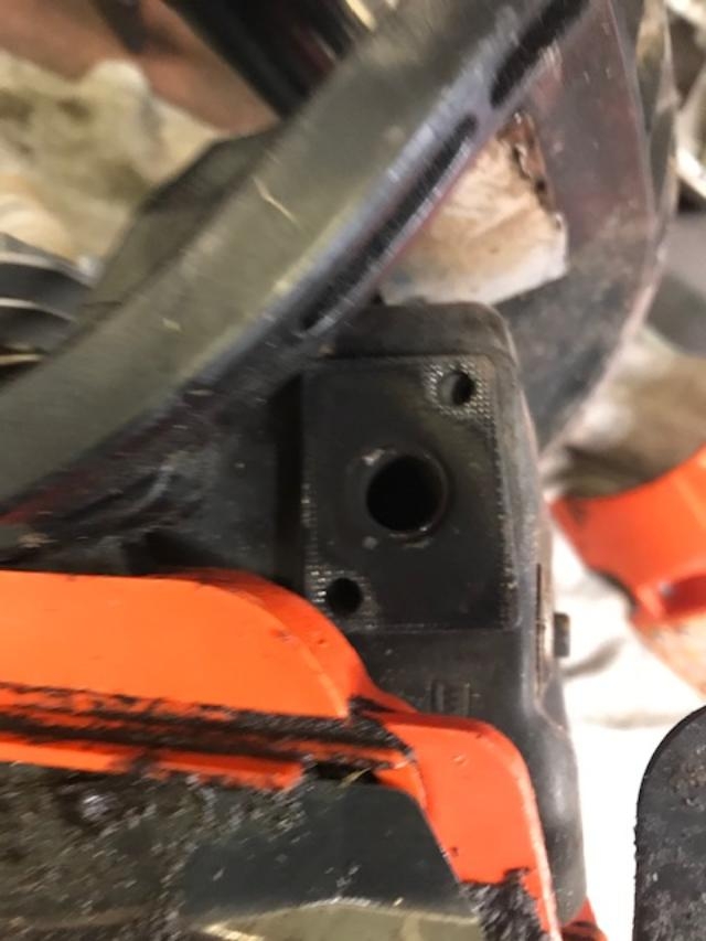

Took some trades on my jred 670 champ I had redid a few years back.
Was suppose to be getting a running 353 and running parts saw OE 346.
Well well what a surprise when it arrived. Someone fooled last owner. 353 decal on a 359.
So got the heat gun out and got that 353 decal off there.
I have a ported 359 so not worried but was surprised when opened up box and unwrapped saw.

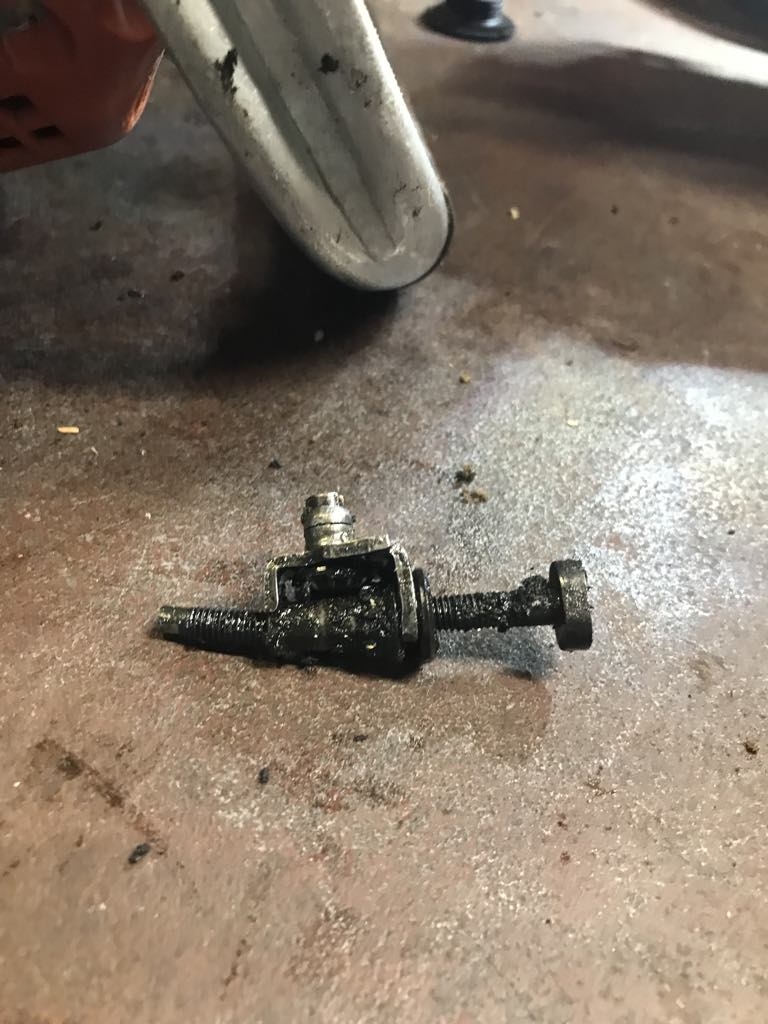

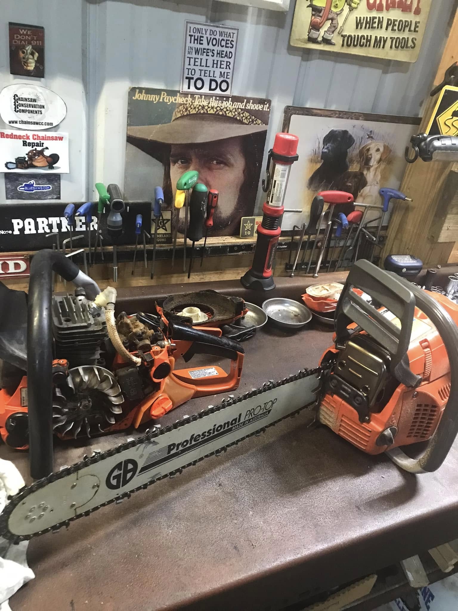

Yep why I told guy dont worry about it. It's fine since I have a ported 359 already.
I was like never know when I might need to steal something from it.
Like today stole the 346 tensioner to put in the new 359.

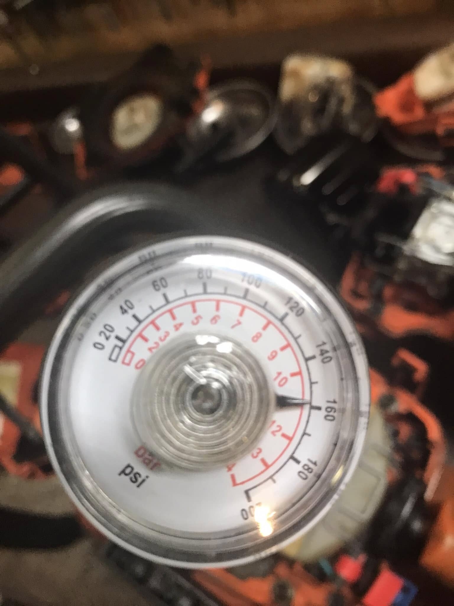

Muffler modded it my free way and test cut with. Already gasket delete and 160psi showing.

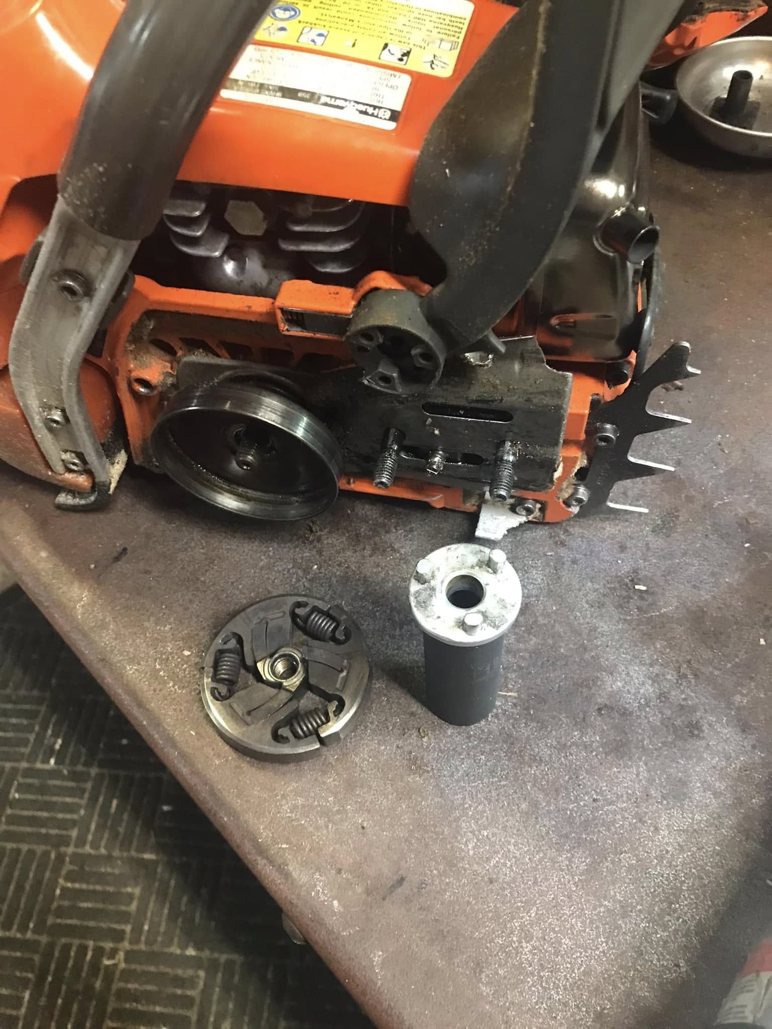

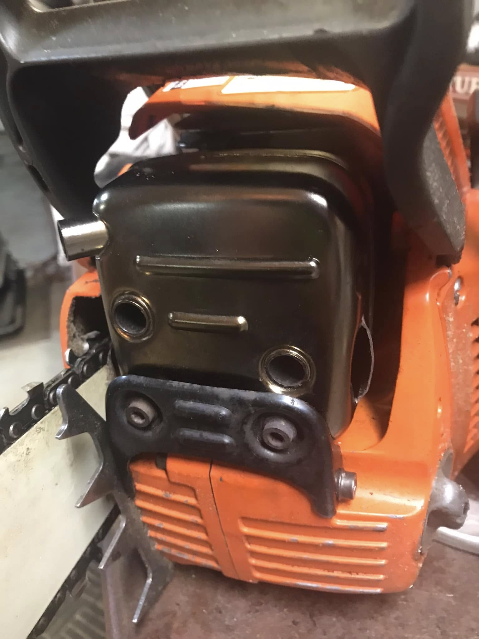

The trade in 359. Did a free muffler mod and open inner baffle couple more besides the one they come with. Gill left side.
Already has gasket delete.
Took tensioner from 346 for now.
Test and cut like a muffler modded stocker.
Echo clutch tool works for these.

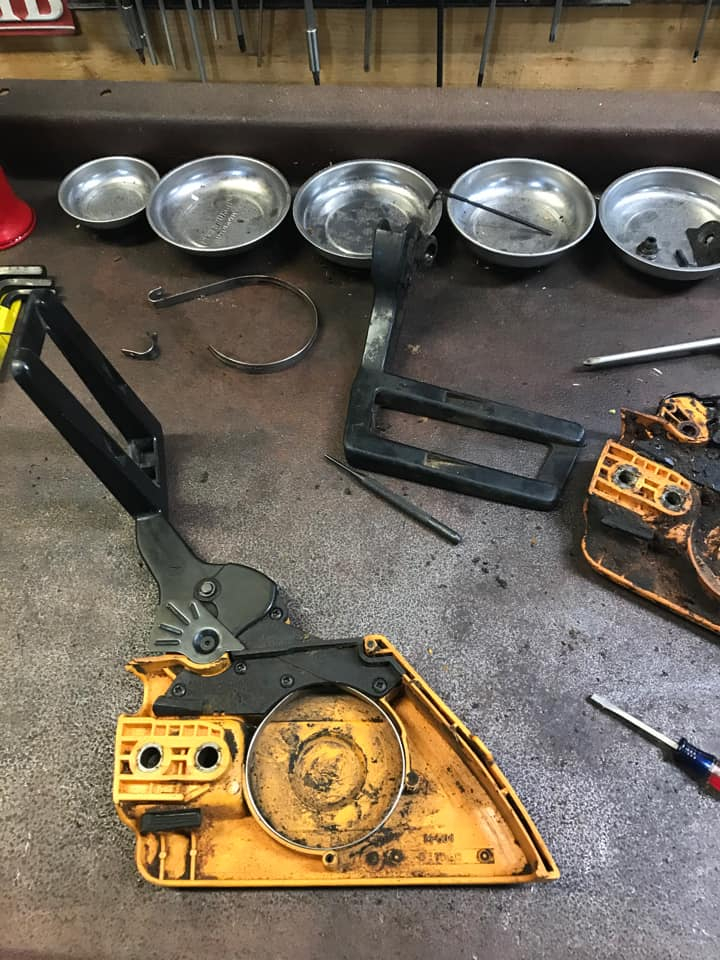

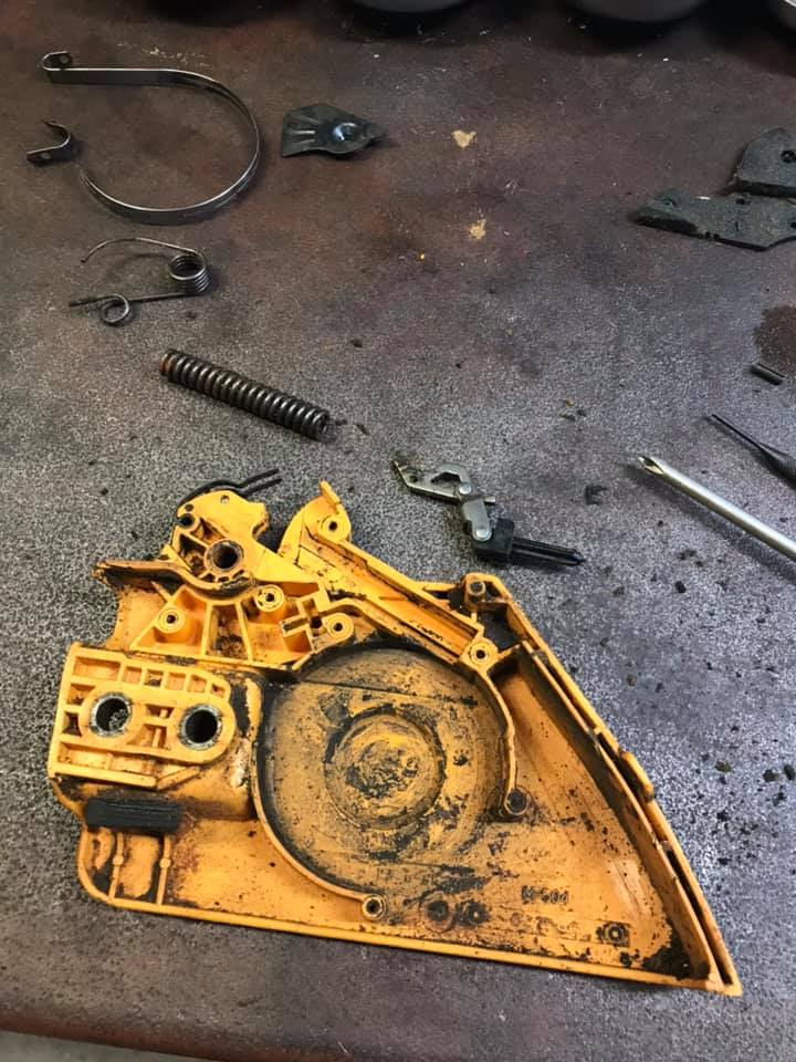

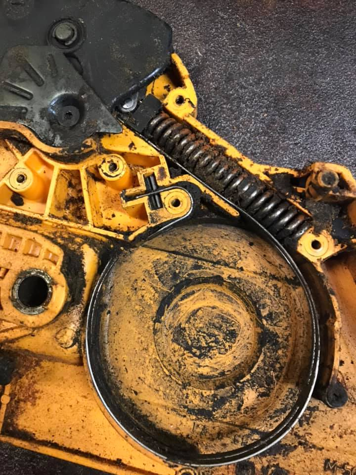

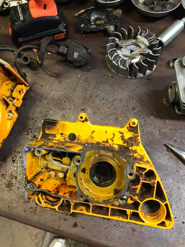

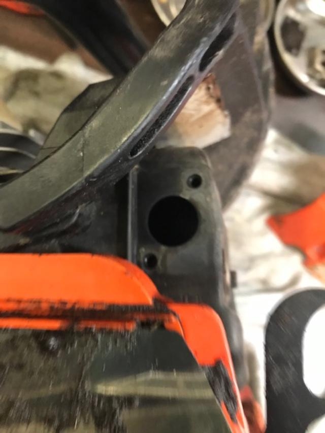

People need to stop using used oil. Nasty thick black residue all had to be cleaned out of whole side under metal plate.

It's not perfect looking inside. But fine for use and 160psi. 2009 model
