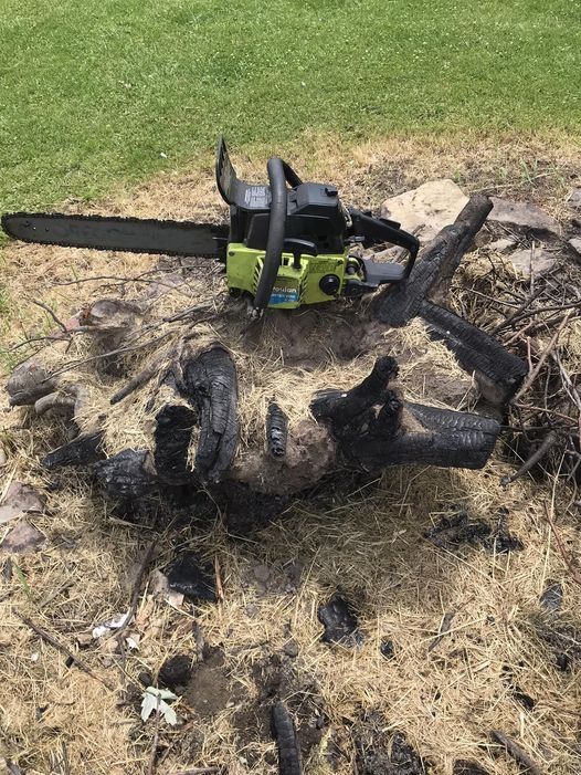

64cc poulan 4000.
Guess I didnt post it here. This was with a regular chain I sharpened that was a chain I pull from stuff coming in that I wont use for regular cutting. I call them my crap chains for root cutting. 70dl set up.
Ended up ordering a stihl carbide chain from friend and breaking it down to drive link I needed.
Man I am impressed with carbide chain for dry dirt encrusted root ball stuffs.
74dl broke down to 72dl.
Showing how far regular chain got before begging to be sharpened.

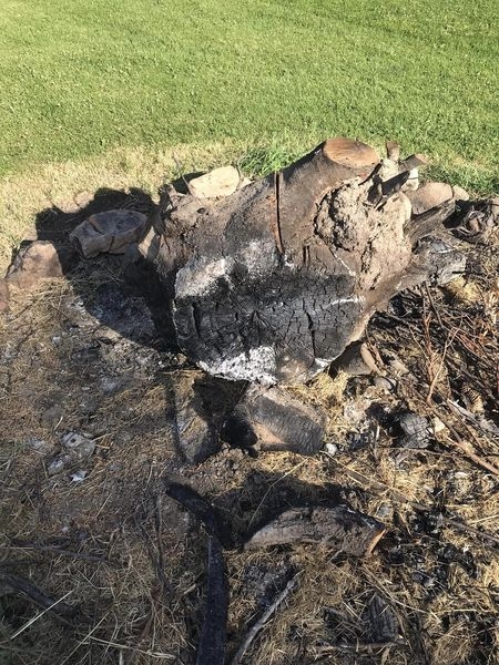

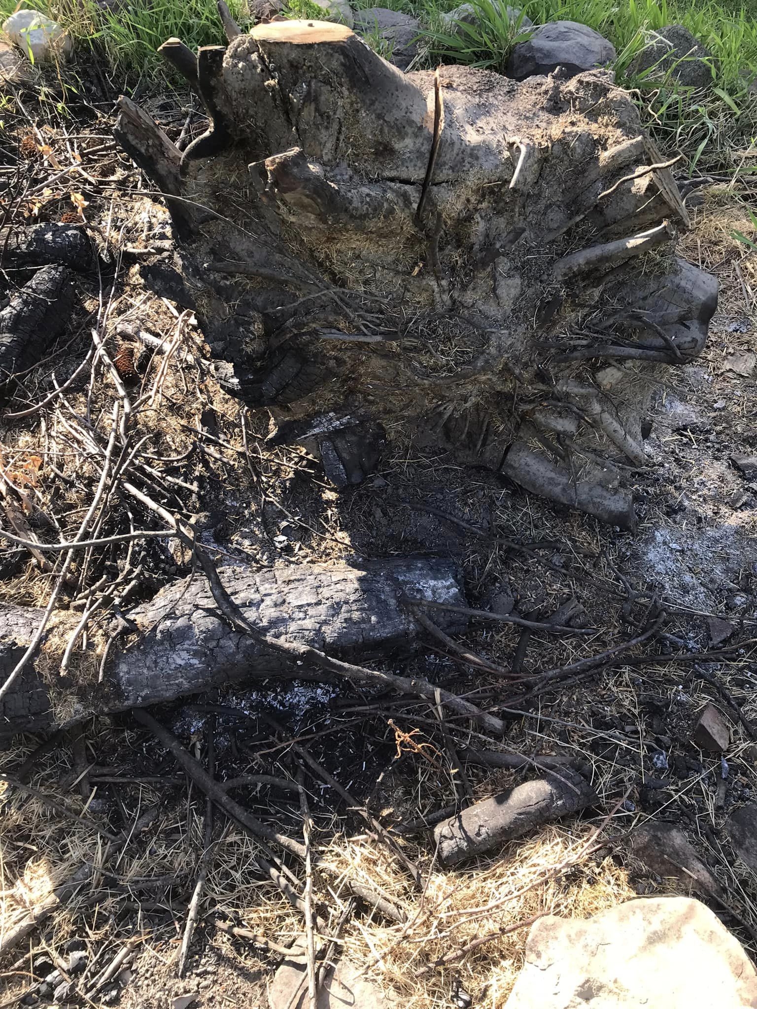

That root ball stump after I cut the tree up and then pulled it out.
This is it upside down flipped over pulling it out.

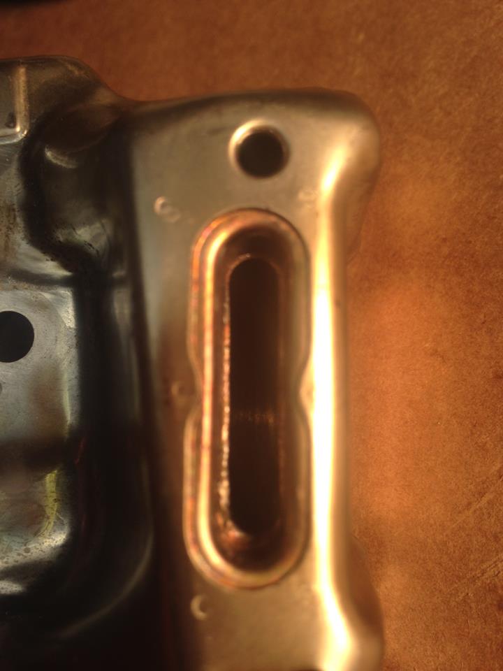

Removed the catalytic crap inside muffler so she will breathe better too. No cost muffler mod.

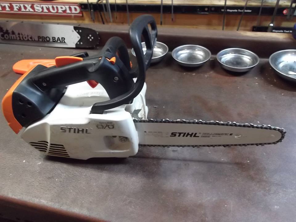

Only the 2nd one of these ever to come across the bench.
I noticed on first one that came in I prefer the trigger style over the thumb throttle these use.
/ Just another junk chainsaw
#1,748
All done. No way I could run one of these all day. My hats off to the guys that have to.
Like running a 53cc strato chainsaw awkwardly.

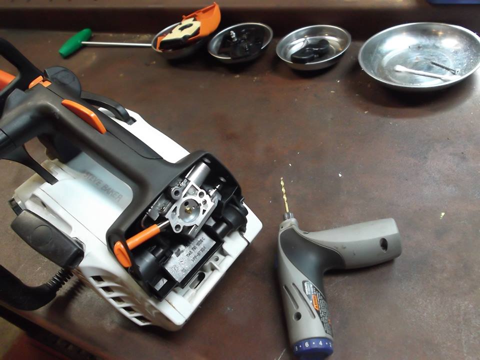

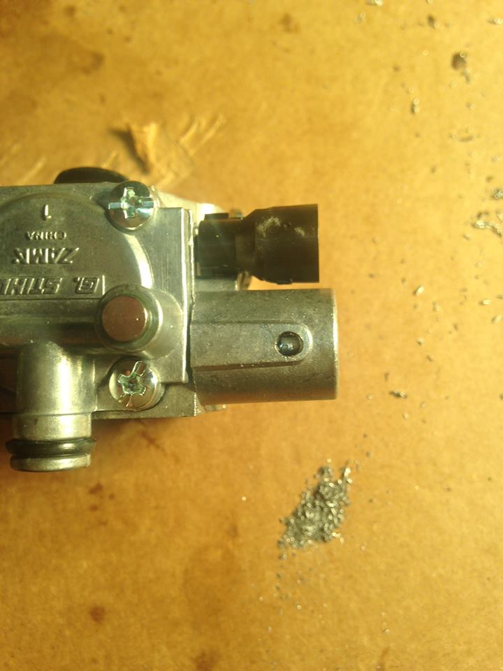

Carb rebuilt and checked. Still same zooming happening.
Told owner I didnt think it was carb kit issue from get go. But carb diaphragms were getting iffy. Plus got to put in a tan over that blue oem one on check side.
After troubleshooting came back to the cable on engine side to carb. Dealer said he just replaces the whole cable as common issue he sees.
I was able to remove rubber boot and lube inside best I could put boot back on and work it some and got it working. So good to go and even tested out in some weeds.
OEM walbro kit and they punched pump side diaphragm wrong. Luckily dont matter on this one and will still work.

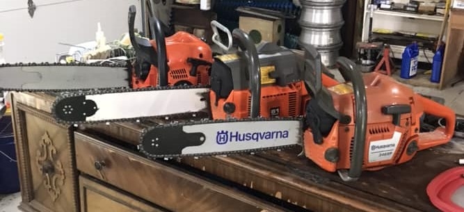

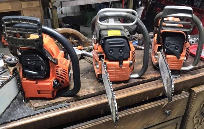

Owner picked up the 555FX and coming back to test these 3.
Just wanting a limbing saw. Something lighter then his 2101.
I got a feeling which one he will pick. :cry:

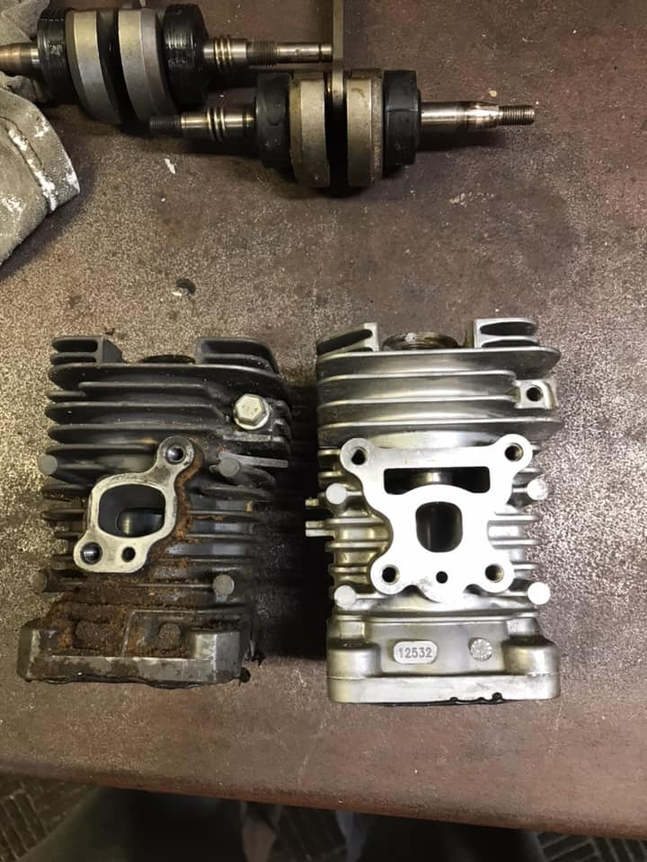

@D'oh the extra is air inlet. Be on top or even bottom too.
Cheap poulan cylinder left before like we were used to with carb and the later epa strato right with extra air inlet.

If that's a 346XP, I bet he chooses that one...
Yep ran all 3 and took the 45cc 346 OE first year saw 1999.
He said he wanted a lighter husky saw for limbing some downed trees he already has waiting.
He used to have a husky 550 mkll for such, but sold it during down times in covid years.

Ok, that makes sense that it goes right to the Transfer ports, Piston Timed, but lower, not sure how it would get timed, or what it would do that a normal bigger bored Carb wouldn't do.

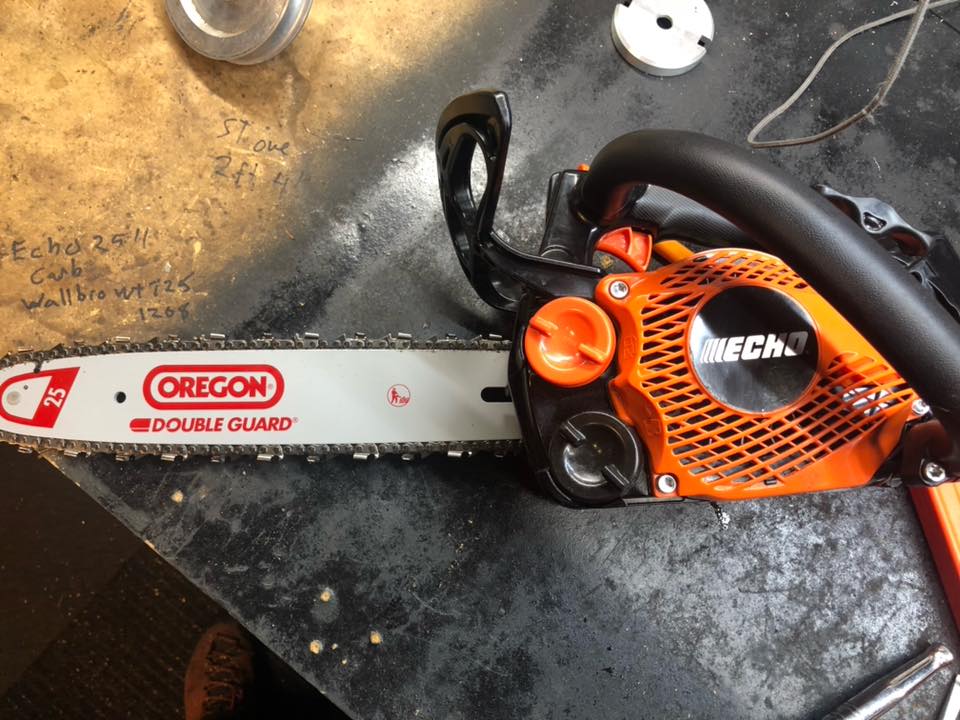

I knew someday one would turn up to buy right and used. Echo 501 bought PHO.
Which didn’t matter as I have all of that on hand.
Psi felt good and popped on choke all I cared about.
If good I can test one stock now then muffler modded to see.
The metal handle with rubber coating feels so much better then the plastic handles the cheaper version echo use.
Wish their better one came with mag clutch covers over plastic.
Mixed about those captive bar nuts.
Like standard recoil better then spring assisted one like on 490.
Quick muffler mod for no cost.
