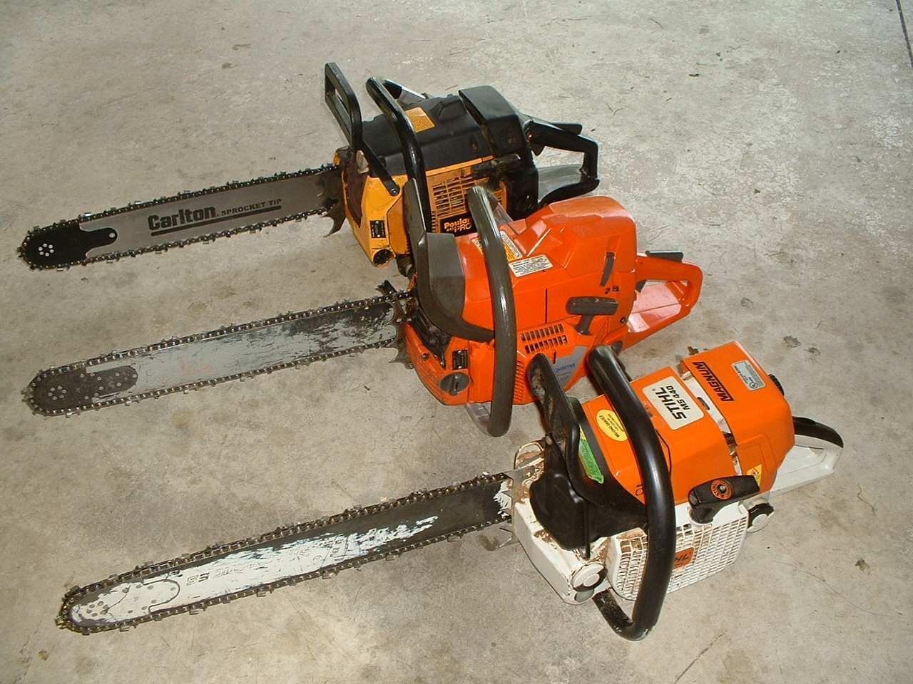

Junk just keeps finding its way. 440 finished rebuild other day and then a 046 in parts gets dropped off. :licking:
All 3 of these 70.7cc saws were rebuilt by me. 445 372 440
Testing is done in a nice piece of solid 14" ash
All saws ran 7T 3/8 and all were set in the 13.4k to 13.7k range. Chain was a fresh square off w8ye square grinder. Rakers were (guessing 27 to 29) just over 25 but less then 30.
2 cuts 14" firm solid fresh take down ash.
372 11.87 11.91 stock no muffler mods.
440 10.94 10.93 stock with muffler mod, DP muffler cover with enlarged side exit hole too.
445 10.13 10.44 stock no muffler mods and still had spark screen installed.
I really thought the 445 was going to be the slowest in the cut as quite as it was and throttle response wise out of cut. Even in the cut I thought it might have been the slowest till the times were being read out to me.
