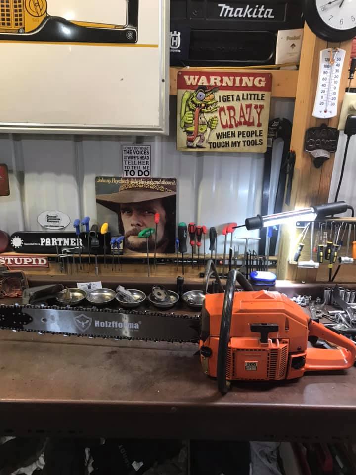

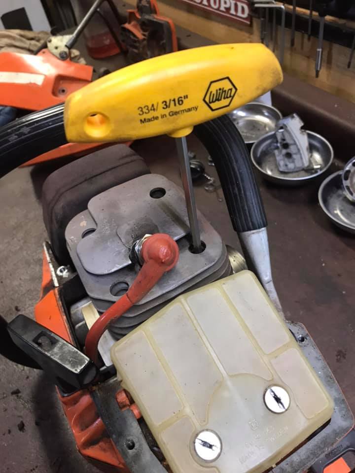

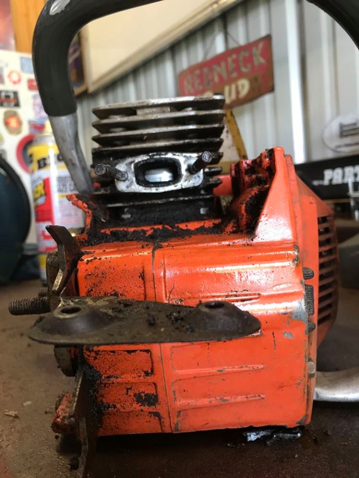

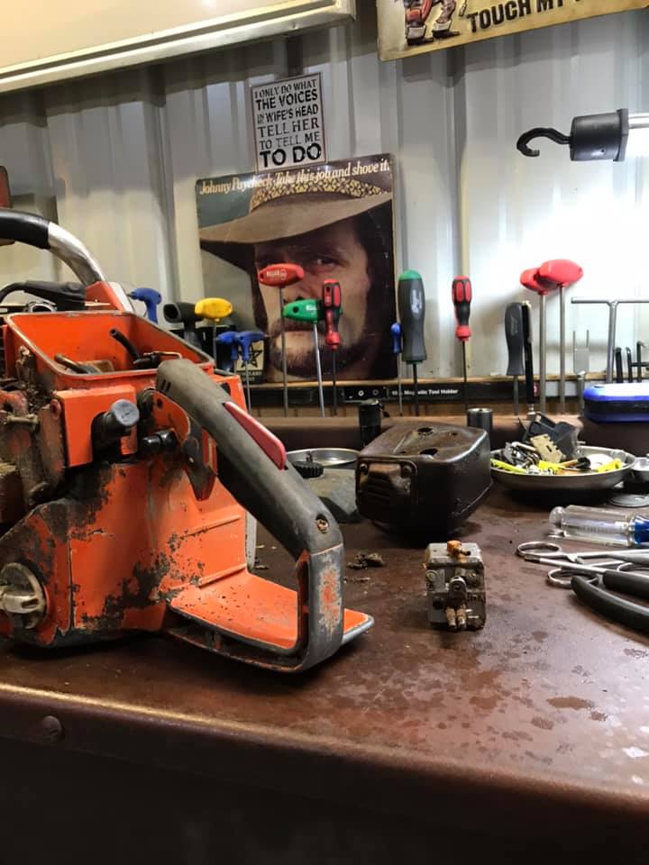

Another jonsered 2095. Same thing as last 2095, started scoring.

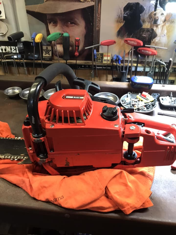

Where on earth did you get that pristine Craftsman at?
Estate sale. Wife passed and the older husband selling off everything.
Beautiful in town home with heated garages. Probably only used for yard work on tree limbs or ER times.
/ Just another junk chainsaw
#1,457

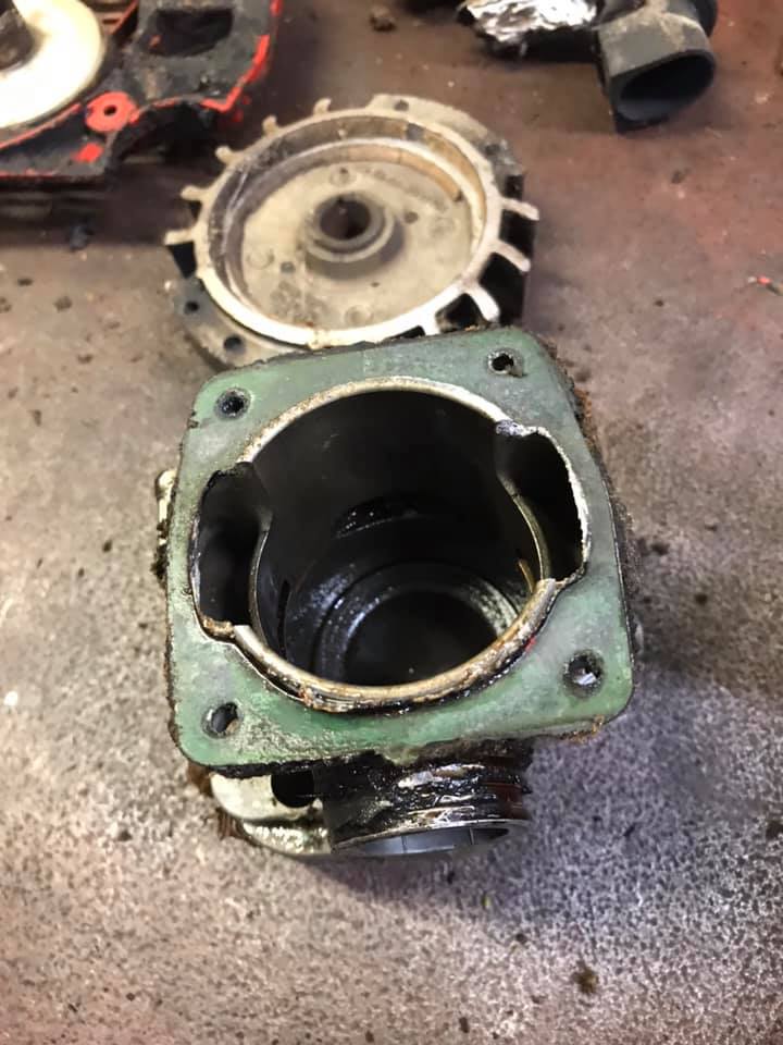

Well the paper under that Craftsman 3.7 wasn’t that old. 2009 local paper.

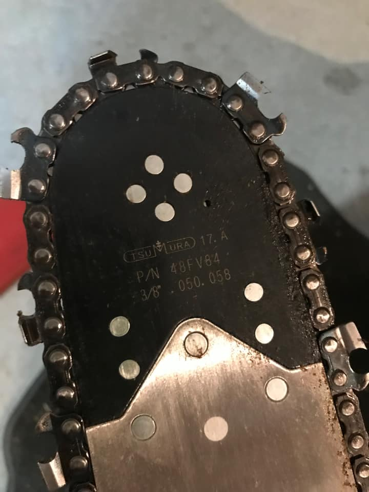

Still had a unsharpened Oregon 76 3/8 chain for back up and a 1/3 used 76 still on it in good shape.
Cool part on the 50/50 drawing I see here. It was the thin ring 3700 topend.
When I seen that bare piston without seeing ring yet I knew.

Nice finding old stock 6 rivet 3/8 they dont sell anymore for like 12 years. 11 new.
4 rivet 3/8 what they been selling for years now.

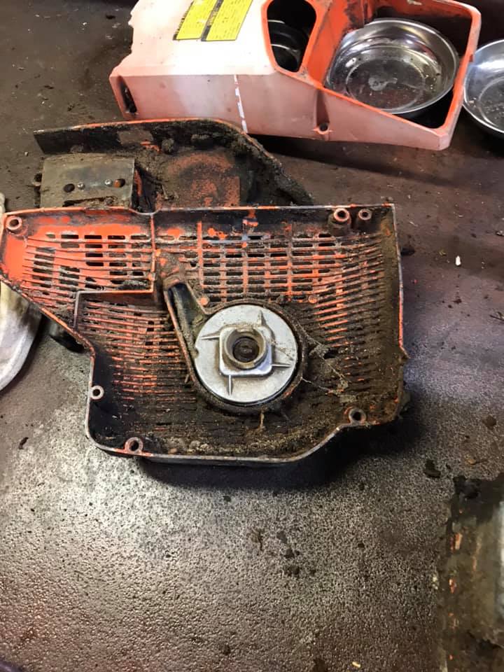

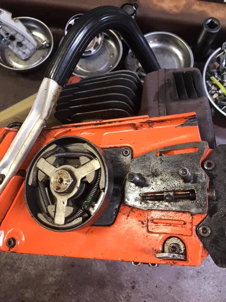

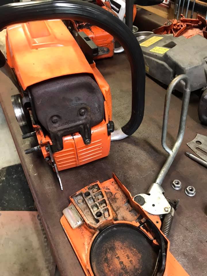

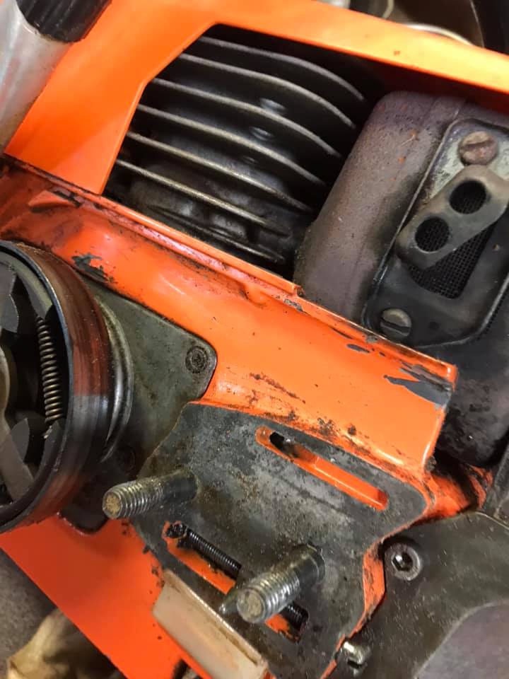

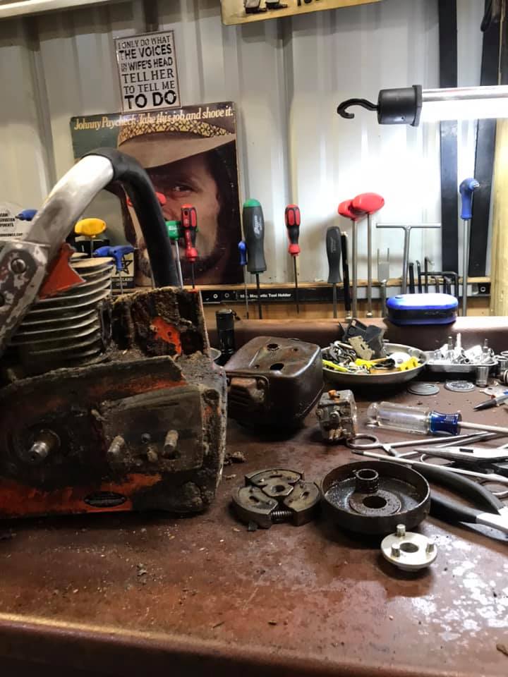

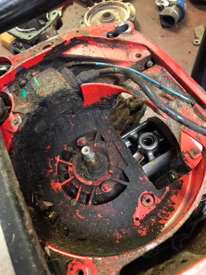

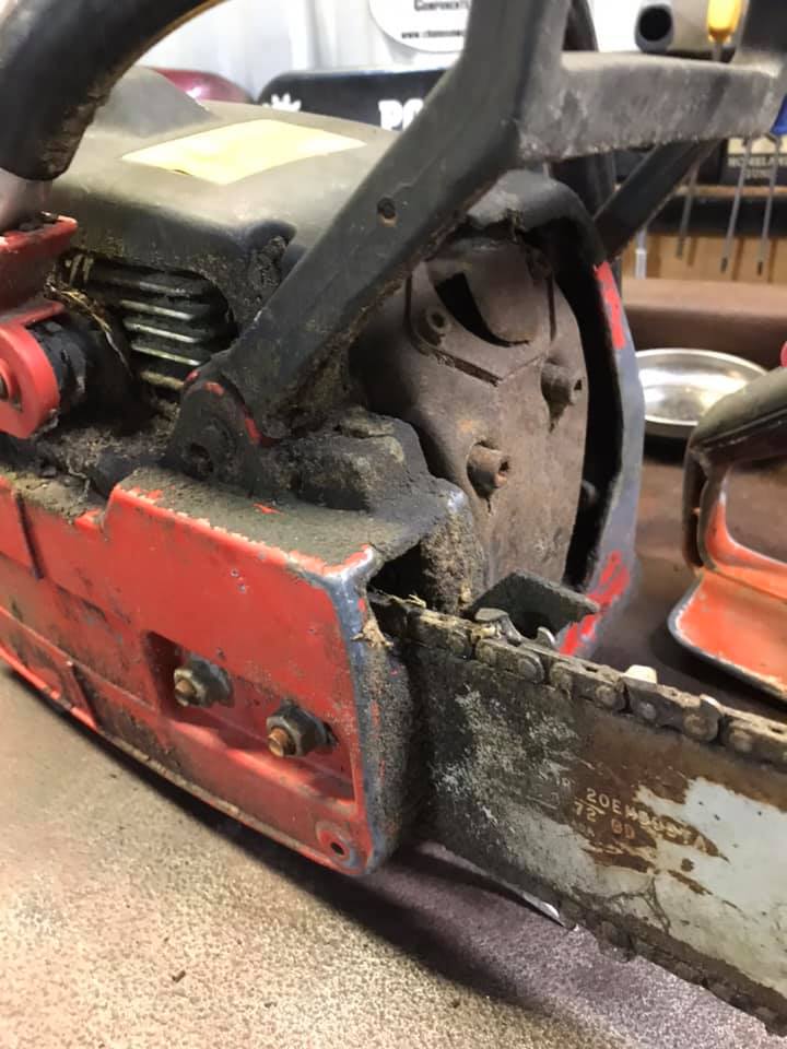

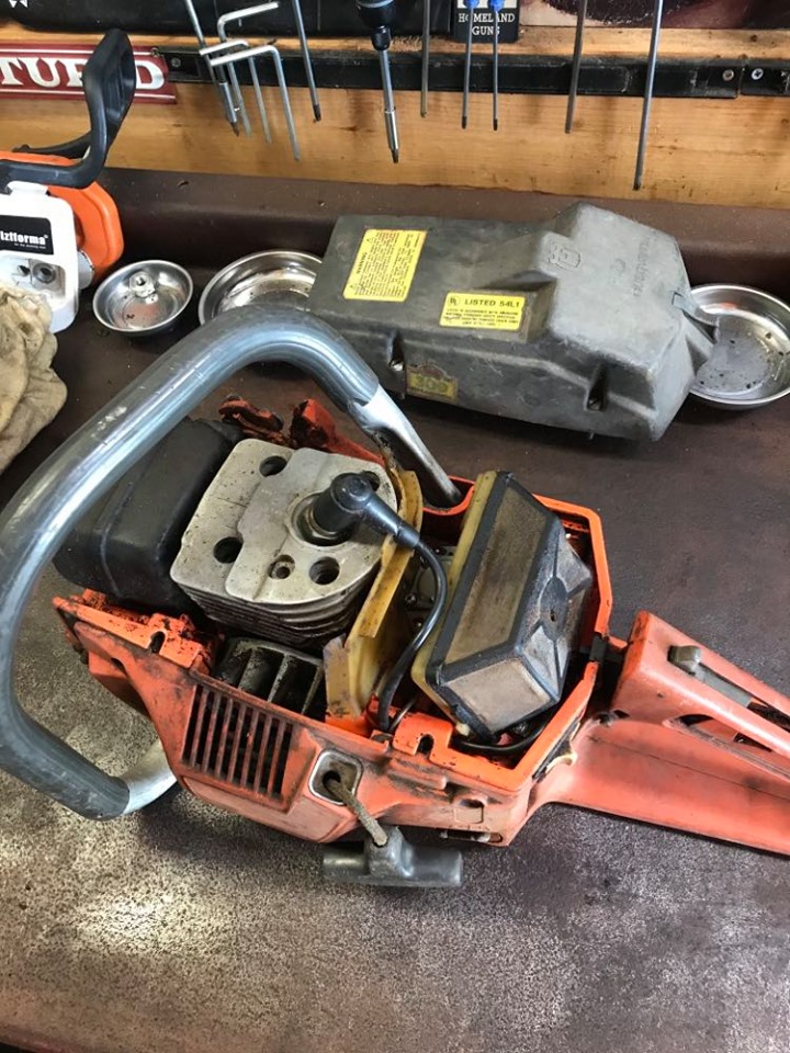

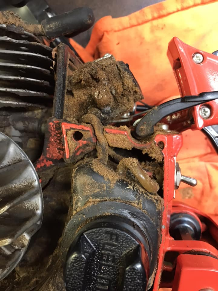

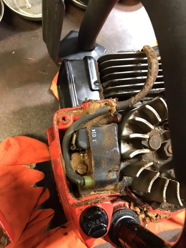

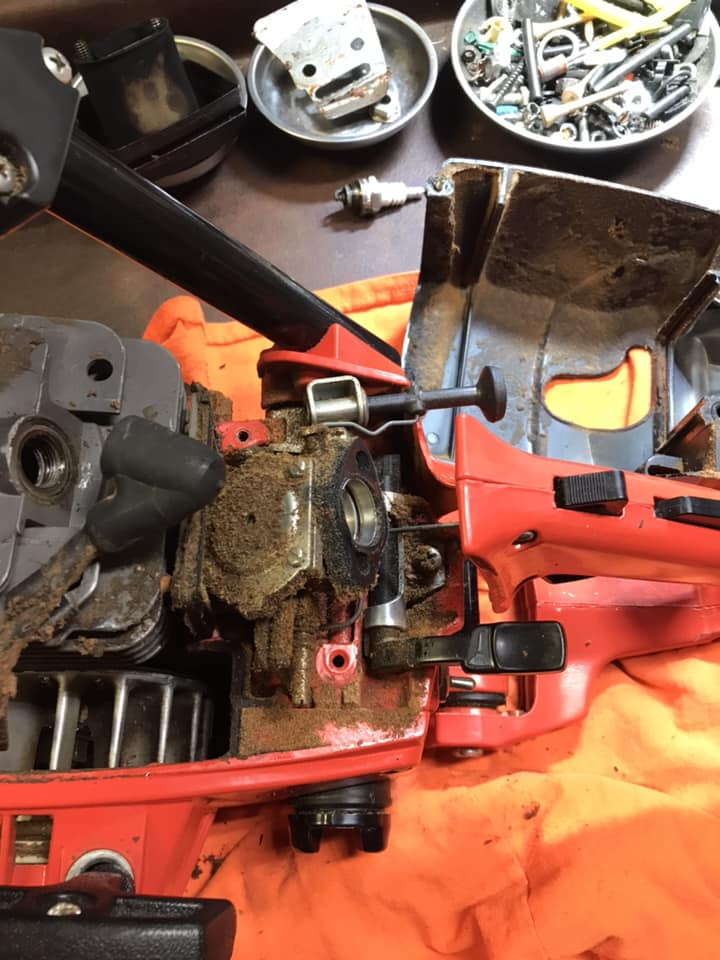

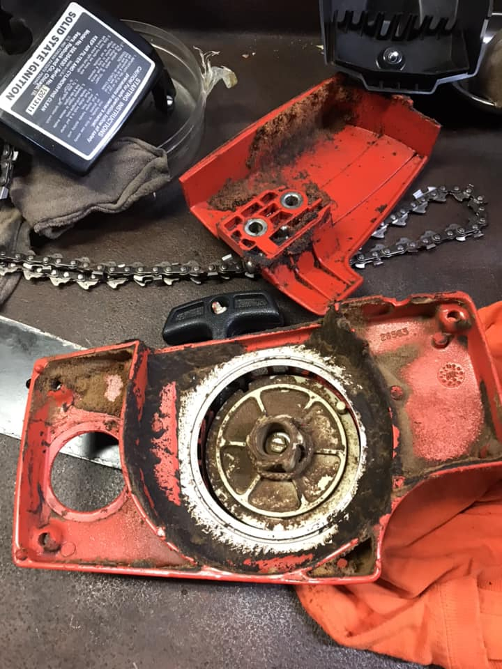

That super clean 61cc thin ring was only kept spotless outside.
You need to get under them covers cleaning folks. Around flywheel and cylinder fins etc for cooling.
Still had the black duckbill for tank vent.
When I touched it before pic it just smeared goo.
/ Just another junk chainsaw #1,460
Pretty much how far they go apart for cleaning once I put one on the bench for any reason. Still too long between cleaning sometimes. Guilty as charged.
