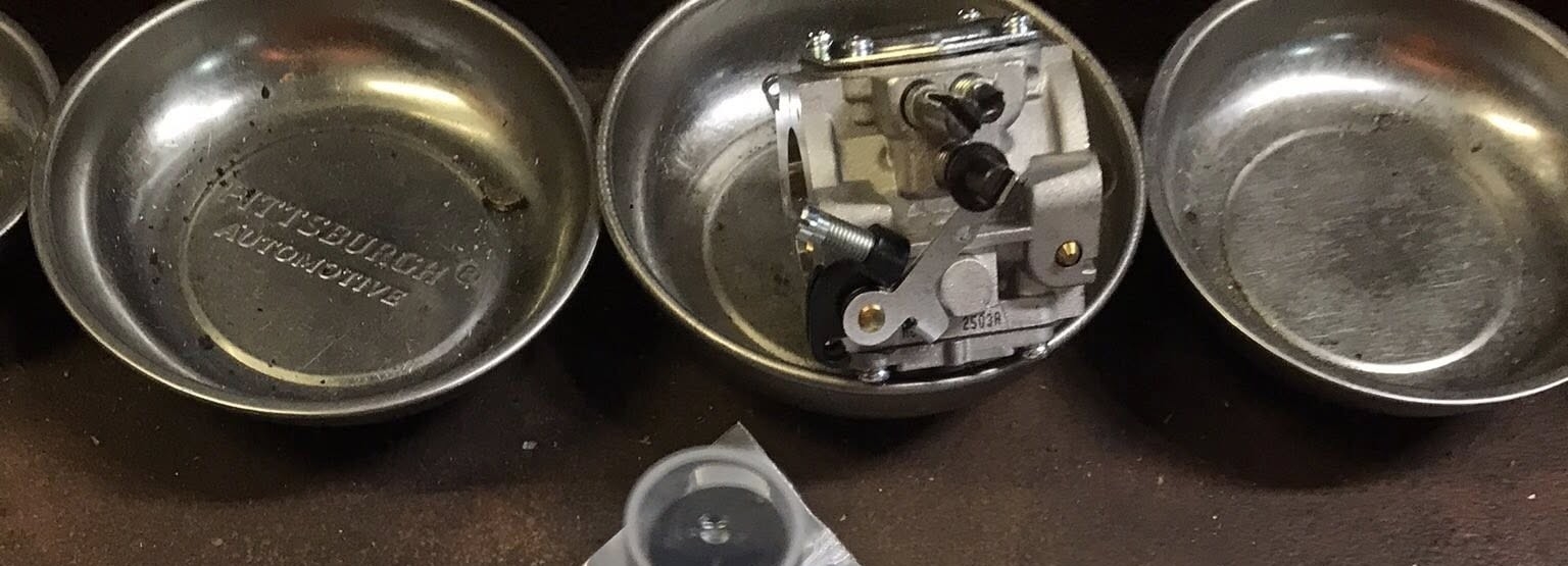

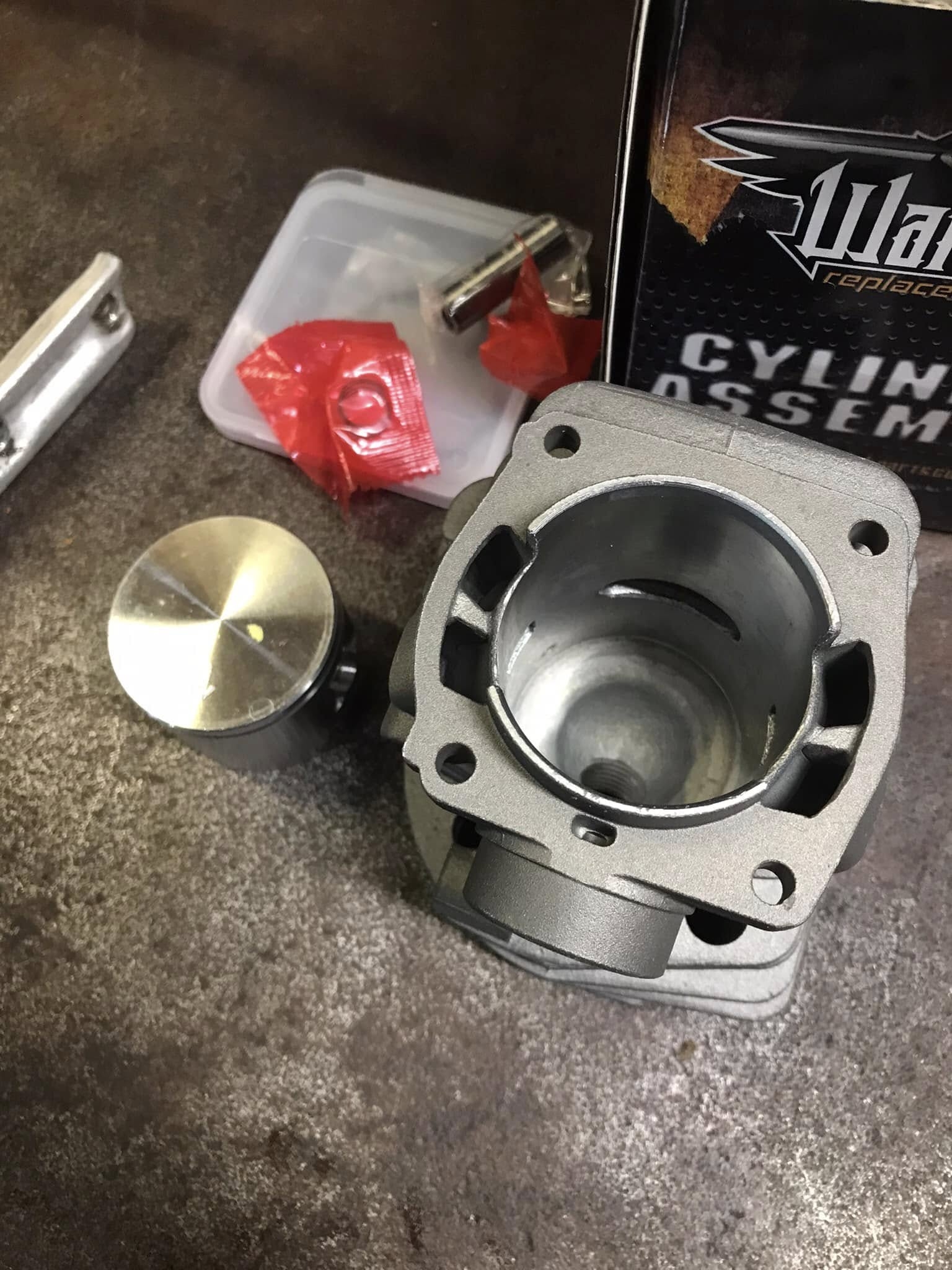

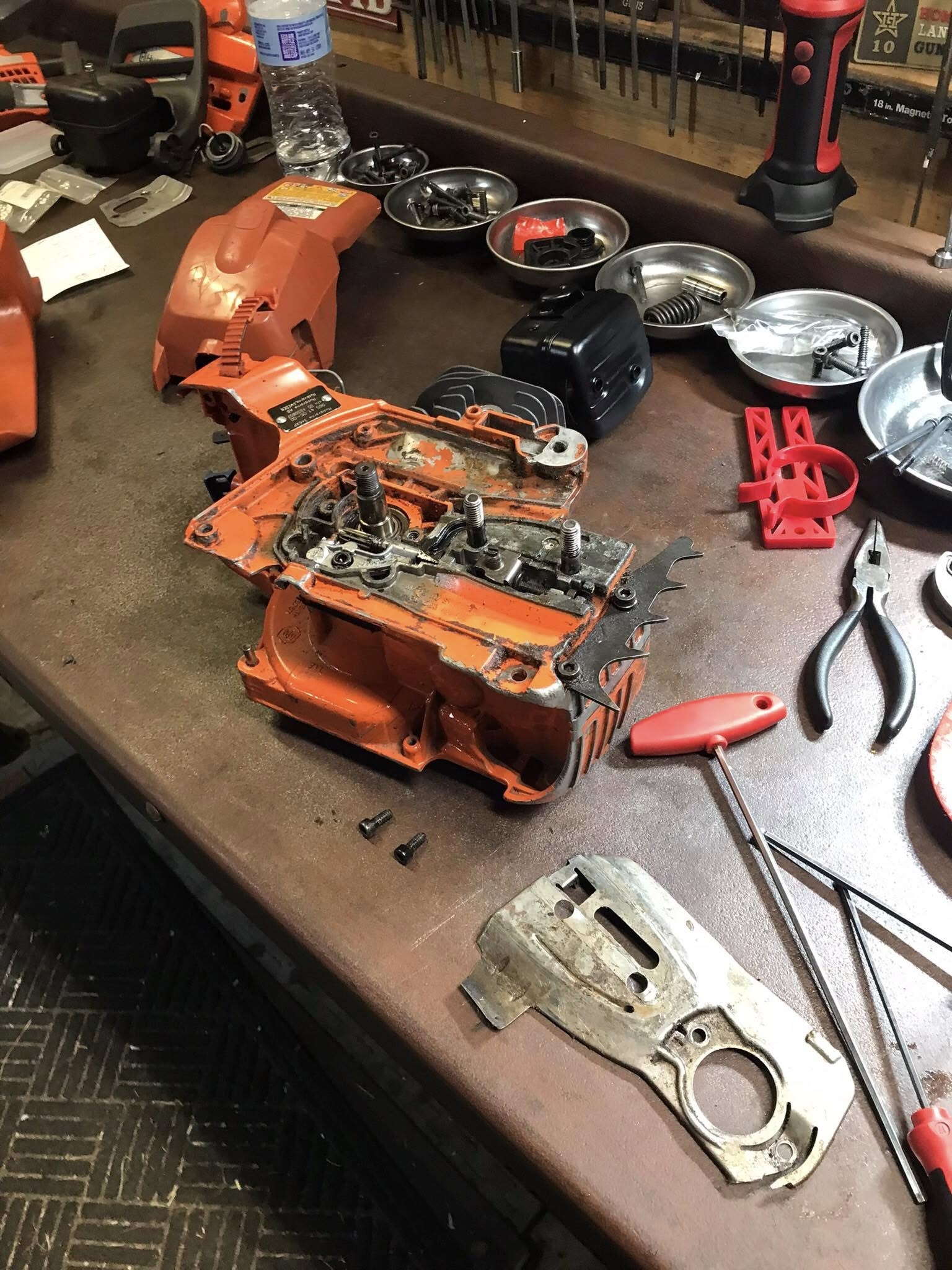

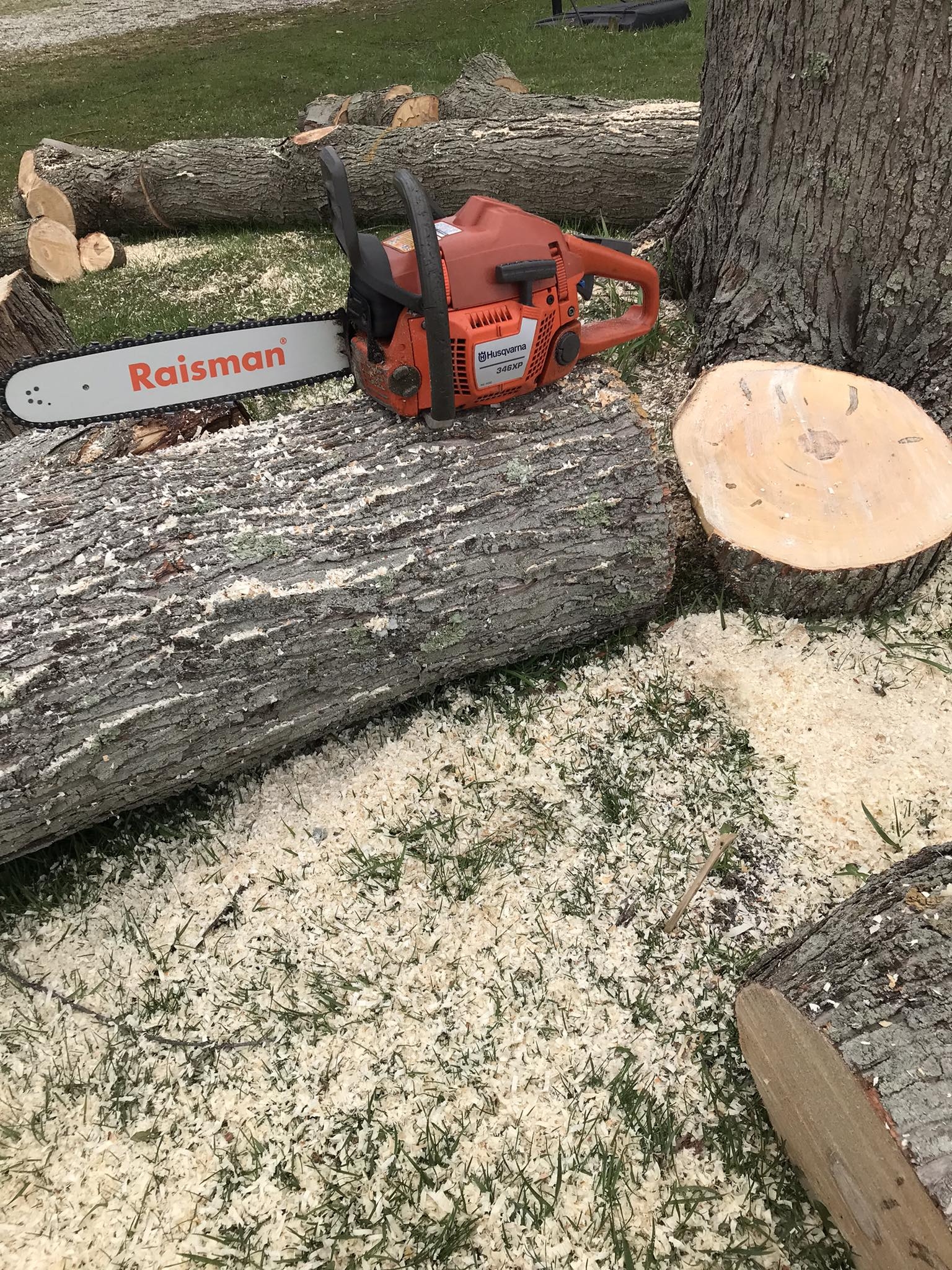

@JeepHead I'll let everyone know in my group and you here. But some day there is going to be a clone of the 346/353. ;)
Not that I care anymore being I love my echo 501's etc. I'm all set now.
But will make it easier for guy to get parts etc.
It was a PITA to find stuff on that project packrat 346 OE. It is running a aftermarket 44.3mm topend on it testing. Only off of oem time wise by about 10%
If I didnt know it anyone would be happy. Another guy ported one and said they port up good too.
View attachment 3854700View attachment 3854701View attachment 3854702
That will be a HOT seller!

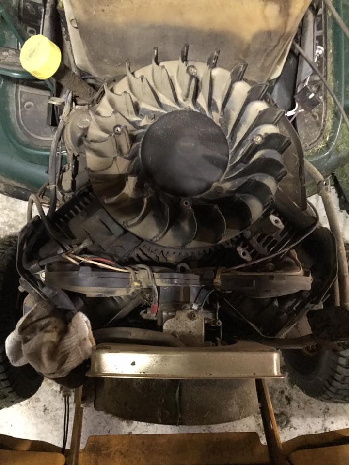

Aftermarket coils for a kohler command twin came in. Going to see how long one last. 2 for 25 or 1 oem 98

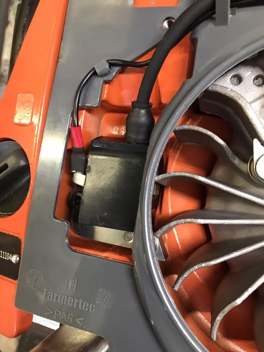

Thats what he was showing in steps before adding a H to the carb to turn it down. The plug at end is after riching it up.
14 without a H side is lean.
12.3 was getting close on my oem one way back without H and unlimited coil. To being lean.
I'm watching mine G3120 clone now to see where it goes. I put a unlimited G395 coil in it to test out with stock no H carb.
I have a H side clone carb too if it is needed.
