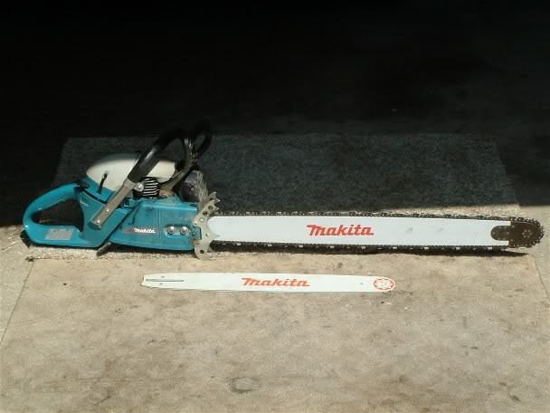

Do you ever come across any Makita/Dolmer 6401/6421/6400? Preferably with a worn out P&C? I've had a oem 7900 P&C for my 6401 sitting on the shelf, but the saw just keeps on going! Would like to build one up.
Seems all the cheap used makitas have disappeared in my area.

Guy south of me just sold a nice looking ported 6401 for 400. Another guy south of me about 30mins has a stock 6401 FS in my chainsaw repair group in 300-400 range.
Another on FB market place for 350.
Just watch FB MP. 64 73 79 all the time being sold. Some 79's now.
I just dont do the dolmars or makita myself for many years now.
Heck parts were hard enough and I had dealers around me back then.

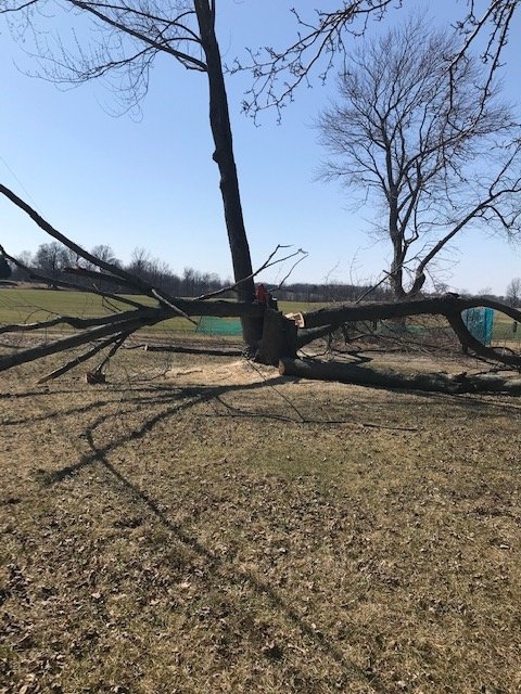

My poor 490 would not start yesterday, so switched to the 620P which started nicely.
Bit overkill for the work I had on 2 dead Ash.
Lots of powder along with chips, so will need to file the chain.
These trees are very punked when they fall and shatter.
Will look at the 490 later.
