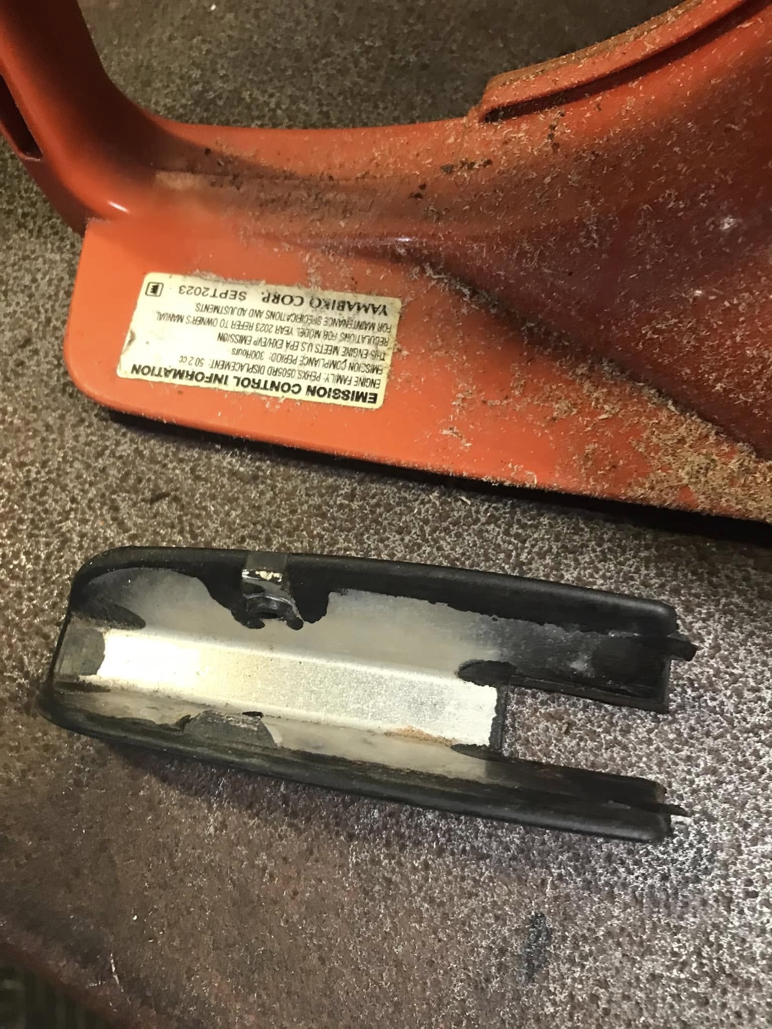

The black rear grip on 4910 is black plastic like on all saws I have ever known.
But the 501 offers rubber coated over metal there if you notice any vibrations there too.

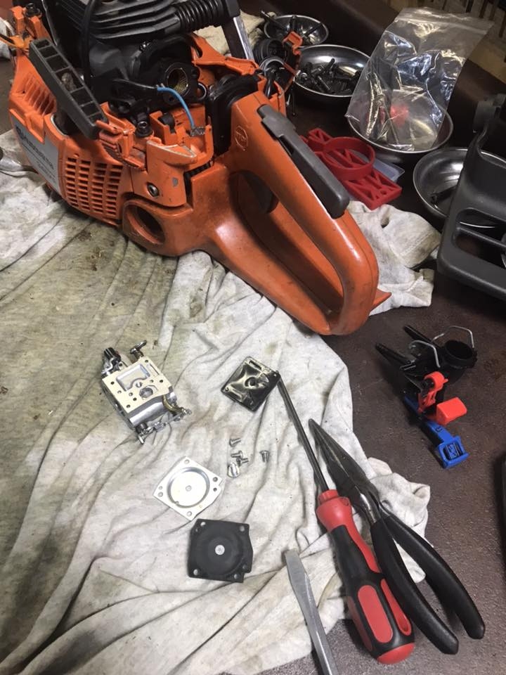

Project packrat 346 tester for aftermarket topends. Just for kicks.
I decided not to clean up the ports or beveling. As I wanted to se what joe homeowner would try by him self.
44.3 warhawk that also looks just like Dukes one he offers.
She lives. Thats a start anyways.

Packrat.
There must be differences in brake handles. Going to have to open the slot on left side in different area.
Oh forgot to get a air filter. 🤦‍♂️🤣😎✌️
Made around 10 cuts and impressed with stock 44.3 aftermarket cylinder.
Pulled carb for a rebuild kit afterwards.
Wish had done it while saw was apart or it's tank vent acting up. :rolleyes:

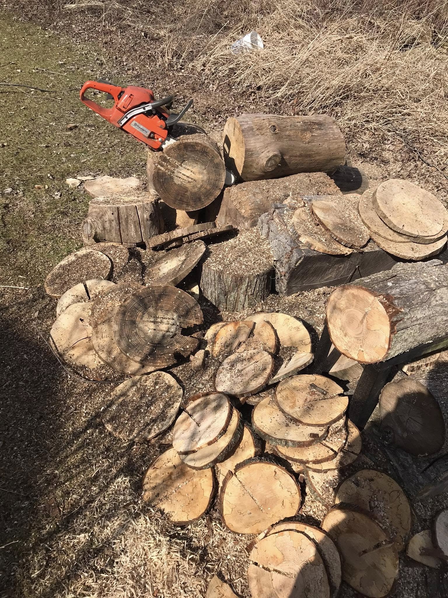

4910 I traded to guy. Told him about better 501 set up handles. = Was out giving my 4910 a bit of a workout in the wood pile today.
Swapped back to the plastic handle to see if there really was a big difference in felt vibration between it and the alloy grab handle.
Running them back to back I'll tell you there's easily less vibration with the alloy handle! Great little saw for sure!

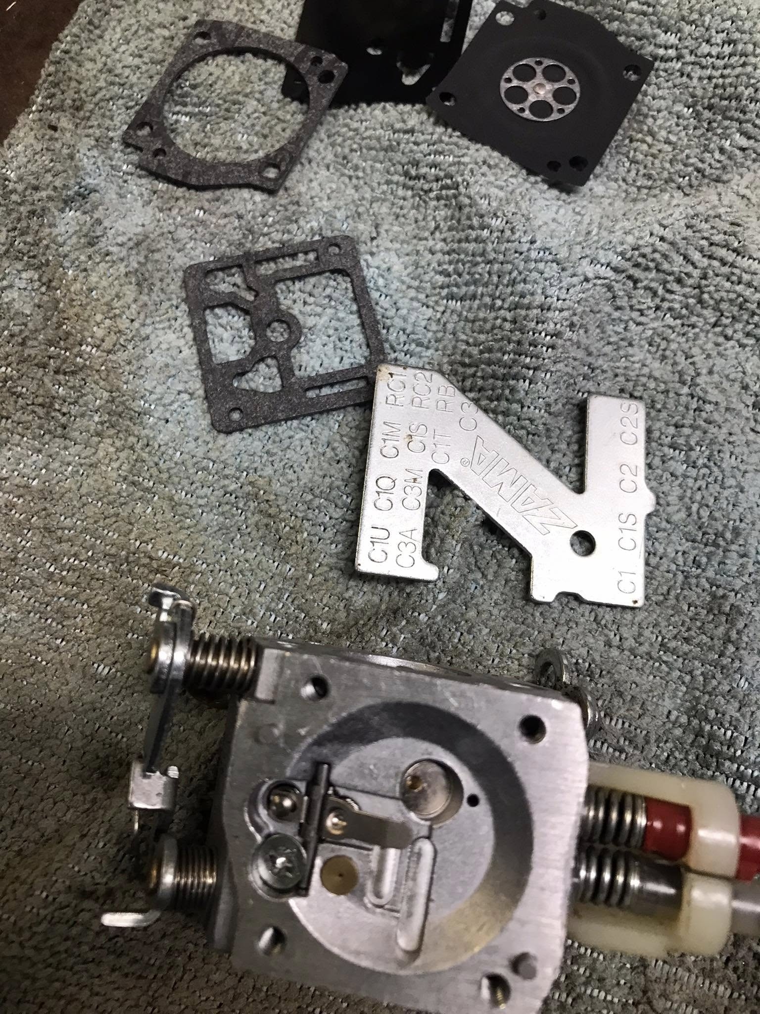

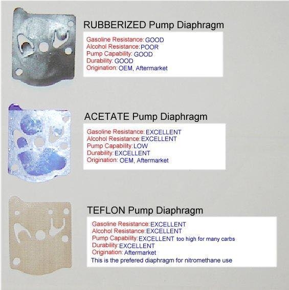

Didnt have the kit on hand for zama. Ordered 3 - 1 oem and 2 afm
Hoping to get a tan check side I like.
Hate the acetate plastic ones. Seen them in blue, clear and black.

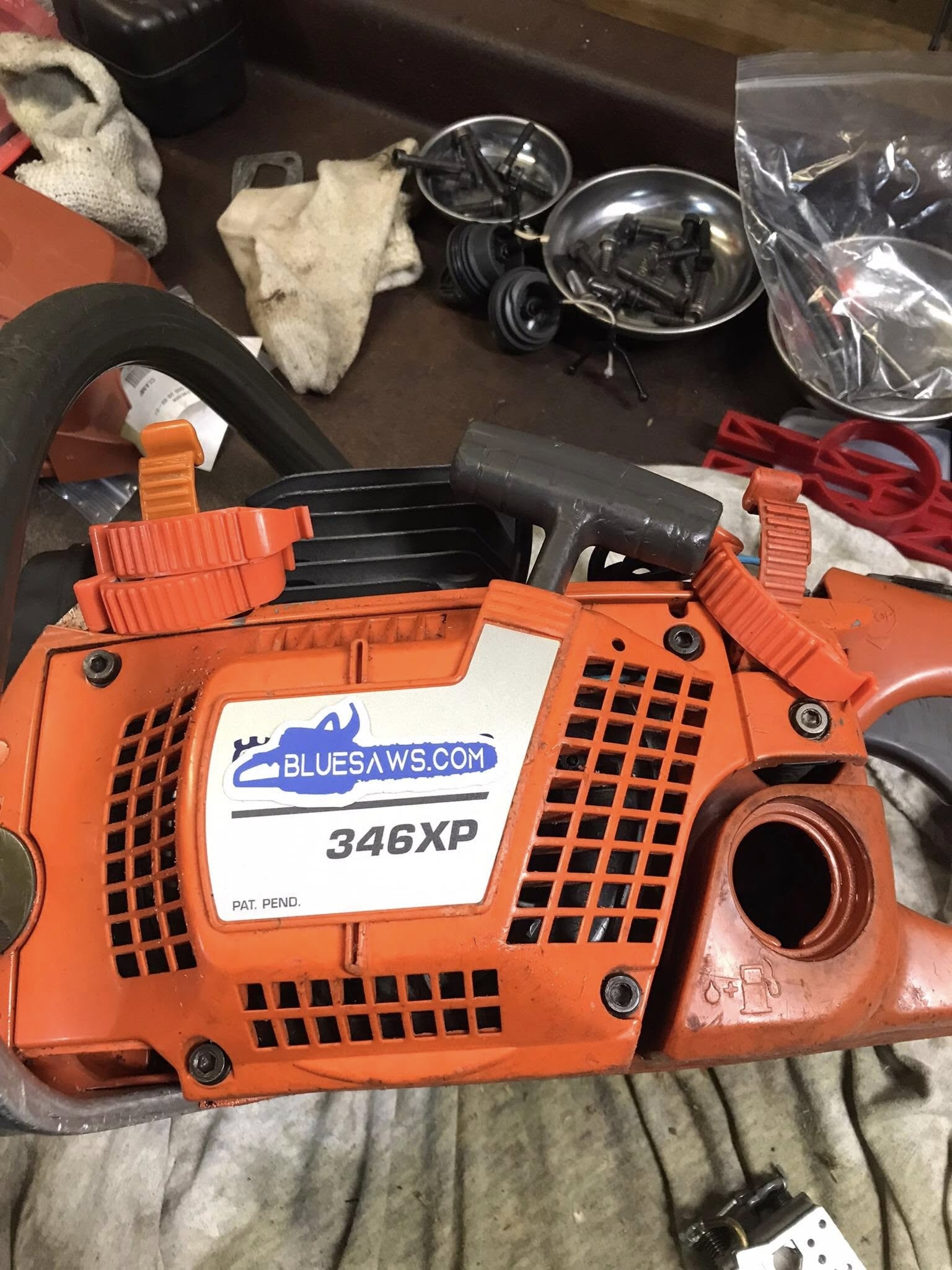

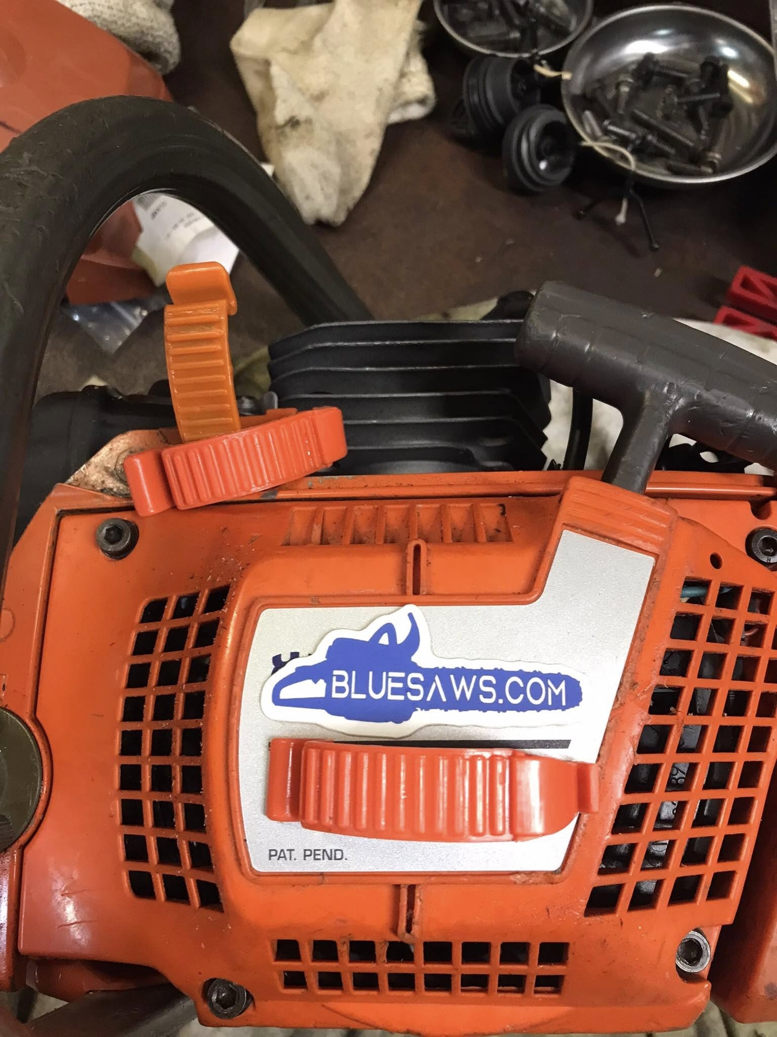

Just to show all aftermarket stuff isn’t the same sometimes. Cover buckle.
I had grabbed some parts from HL and noticed how off the orange clamp was for project packrat. Didn’t care because it was that saw. They are way way off. Front left on saw.
Just got a order from Jes and Scott at bluesaws. Look how close their ones are to oem orange compared to that way off ones HL sells.
Just so you know if doing a nicer husky.
Only like 2 bucks a piece instead of 10 oem.

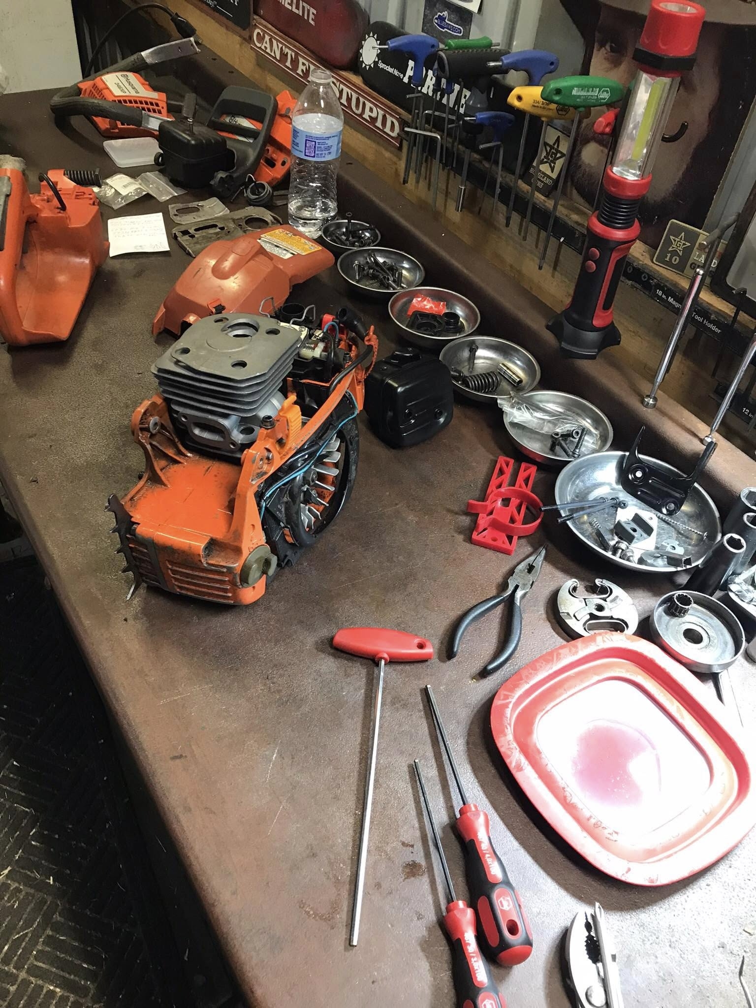

#2,040

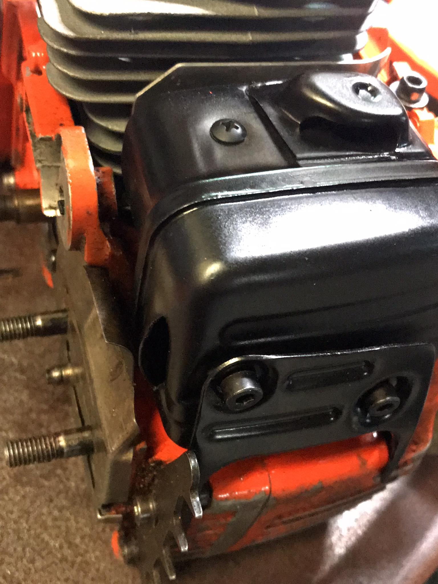

Packrat made from several different saws and tester for aftermarket topends.
Have 2 aftermarket carb kits In route and
I also have oem kit ordered.
So I dug in my kits today and found a new CTS aftermarket kit and so far passed testing.
Was hoping just carb acting up.
That 44.3 afm at end of first tank starting 2.
