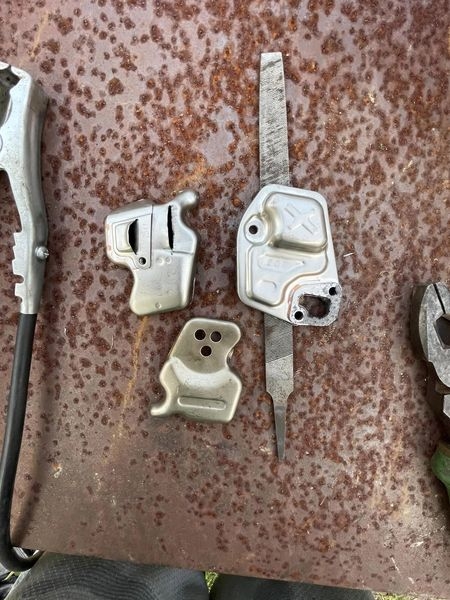

Inside a echo 2511 OEM muffler. Now you can see why they can not breath and need help big time.
Least no cat BS like in some of the others.
Friend had uncrimped his even after adding a gill exit before.

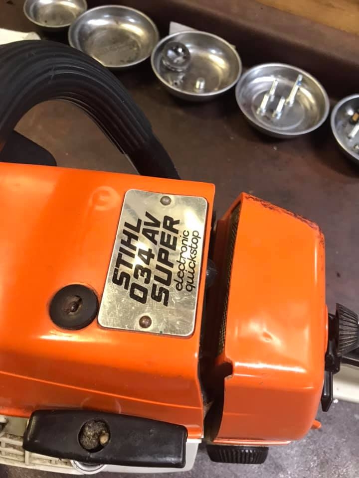

Stihl 034 super original owner. Just got to tell the story so others dont make same mistake he did.
Complaint was hard to start. Ask what all it did and he runs e-free so thats a good thing. He said he pulled the plug and cleaned and gap per manual.
I was like last time that saw was in pretty sure I put new plug in it so gap was right. I said show me where you gapped it on my gap tool as I was pulling plug. .050 he showed me on the tool. He says per his manual that came with saw. I showed him manual online it says .5mm
So then I go outside to start it. notta nothing. I'm like it have mix? Sure should have plenty. Open cap notta. So put some of my efree 40:1 vpracing in it and low behold she fires off. Shut off and tryed again from on started again.
Check the small things folks as owners. Double check your reading it right etc too.

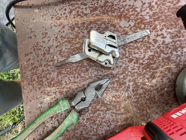

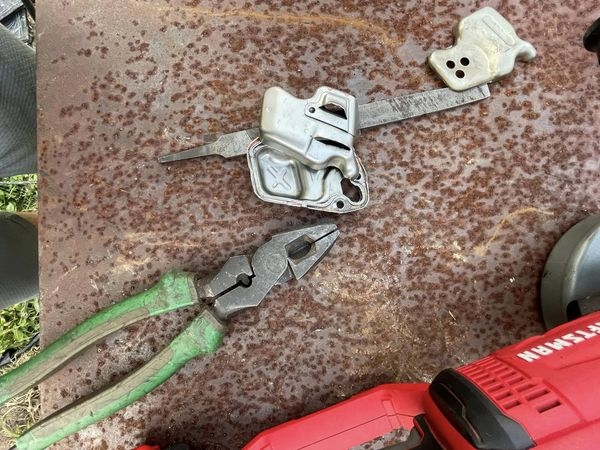

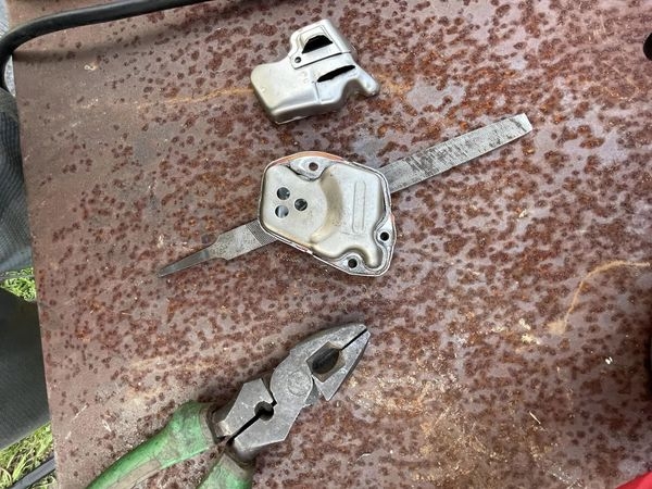

View attachment 918654View attachment 918655View attachment 918656View attachment 918657
I don't 'uncrimp' them at all. I grind off the crimped over part with my large flat plate grinder, mod the muffler and then weld the 2 halves back together again. I either use a MIG or I TIG them if they are clean.
