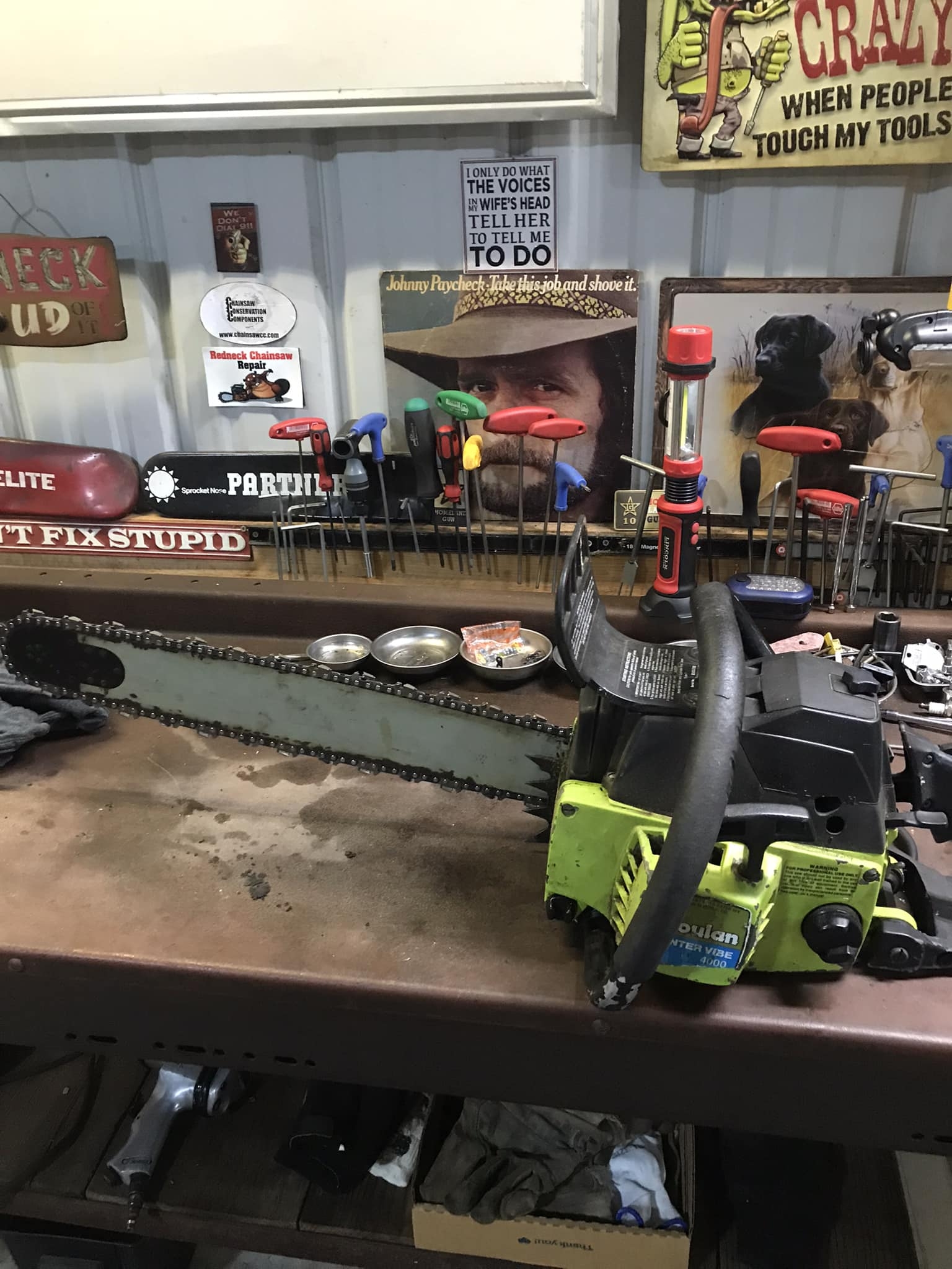

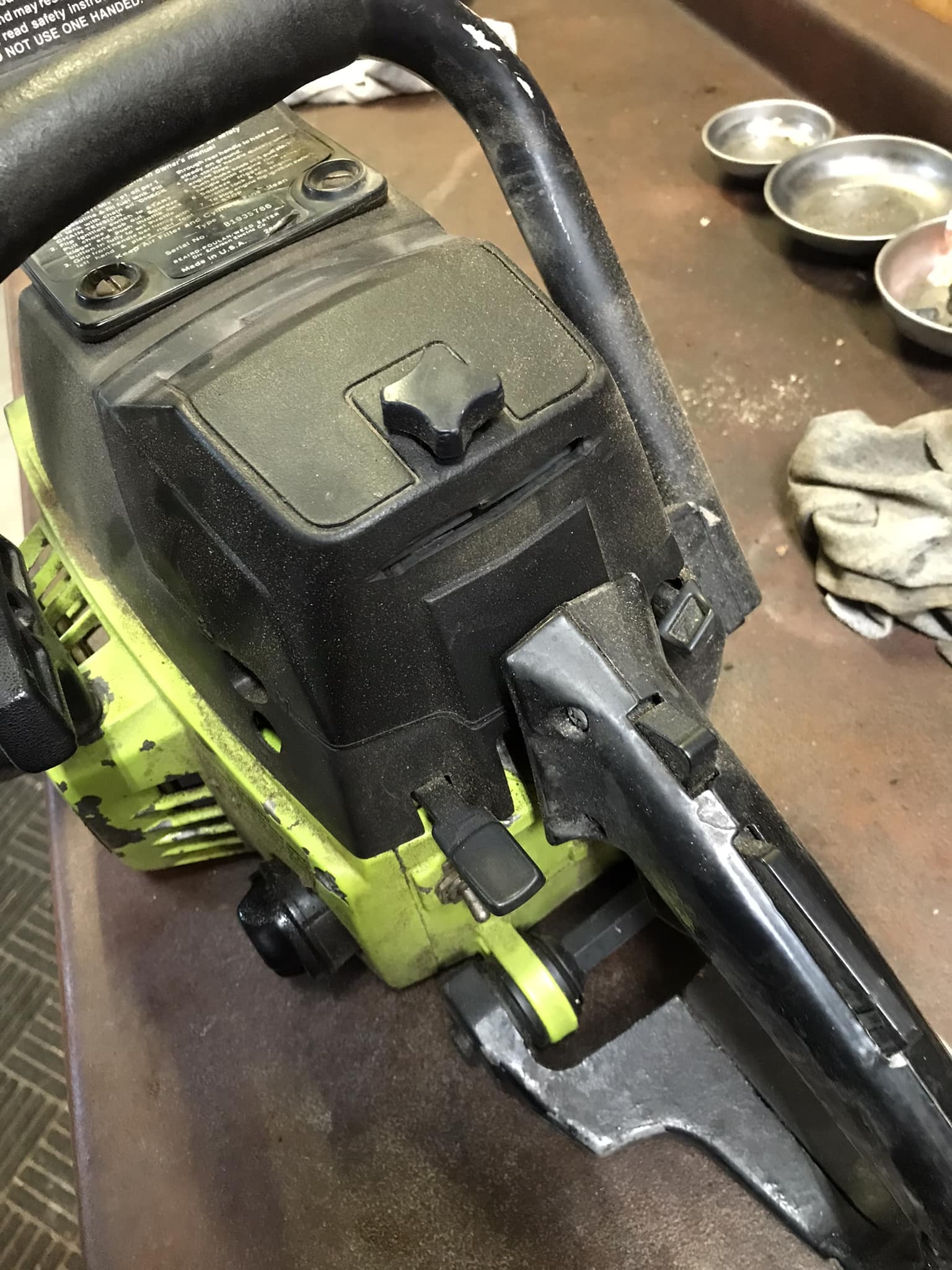

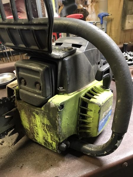

64cc poulan 4000.

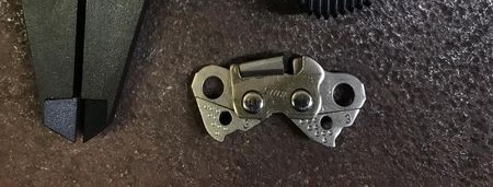

Guess I didnt post it here. This was with a regular chain I sharpened that was a chain I pull from stuff coming in that I wont use for regular cutting. I call them my crap chains for root cutting. 70dl set up.
Ended up ordering a stihl carbide chain from friend and breaking it down to drive link I needed.
Man I am impressed with carbide chain for dry dirt encrusted root ball stuffs.
74dl broke down to 72dl.
Showing how far regular chain got before begging to be sharpened.

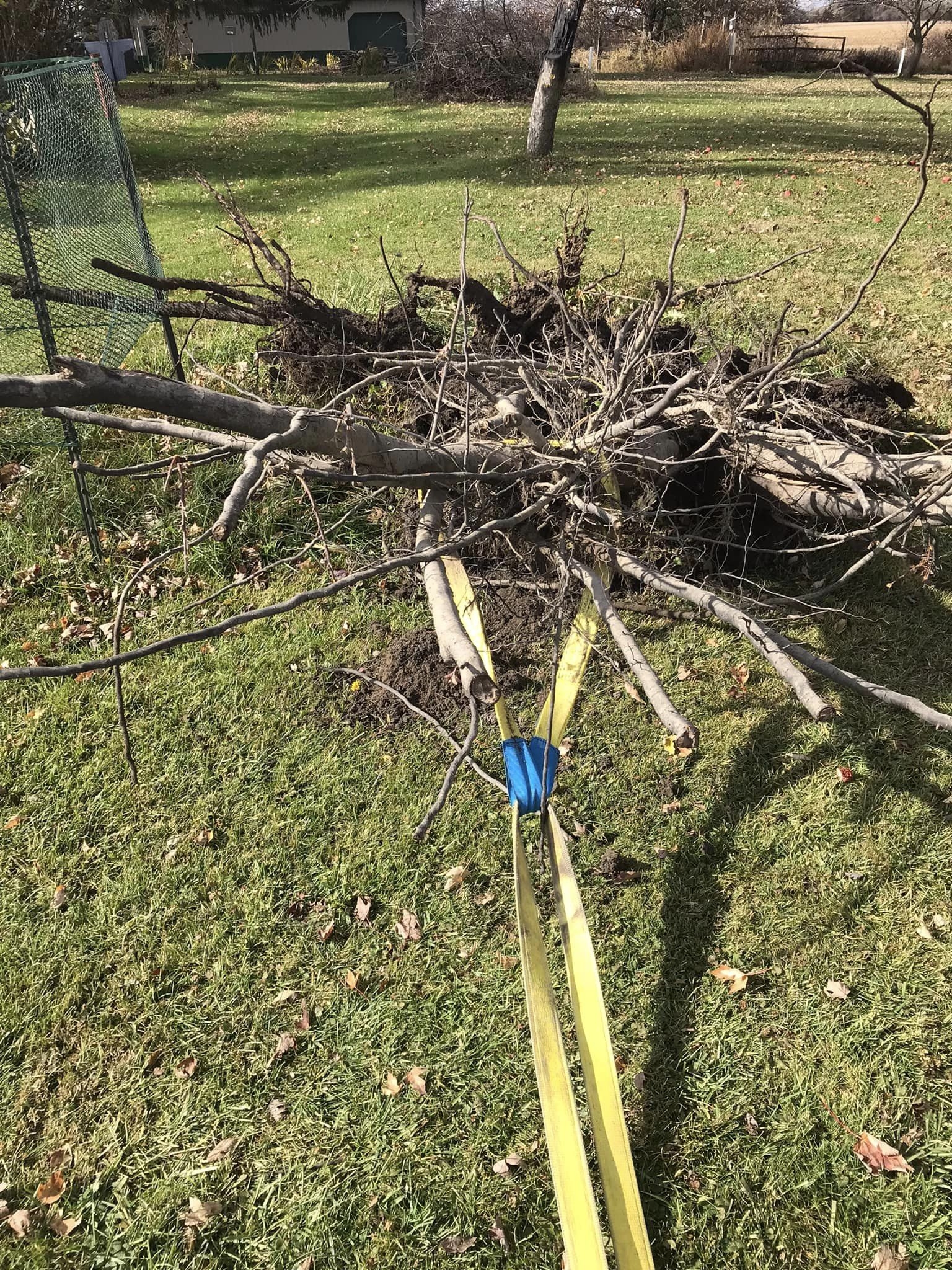

That root ball stump after I cut the tree up and then pulled it out.
This is it upside down flipped over pulling it out.
Maybe I didnt post this here last year after tornado.
New evercrip planted same year to replace the big winesap we lost. Already have another variety of those so didnt do the same.

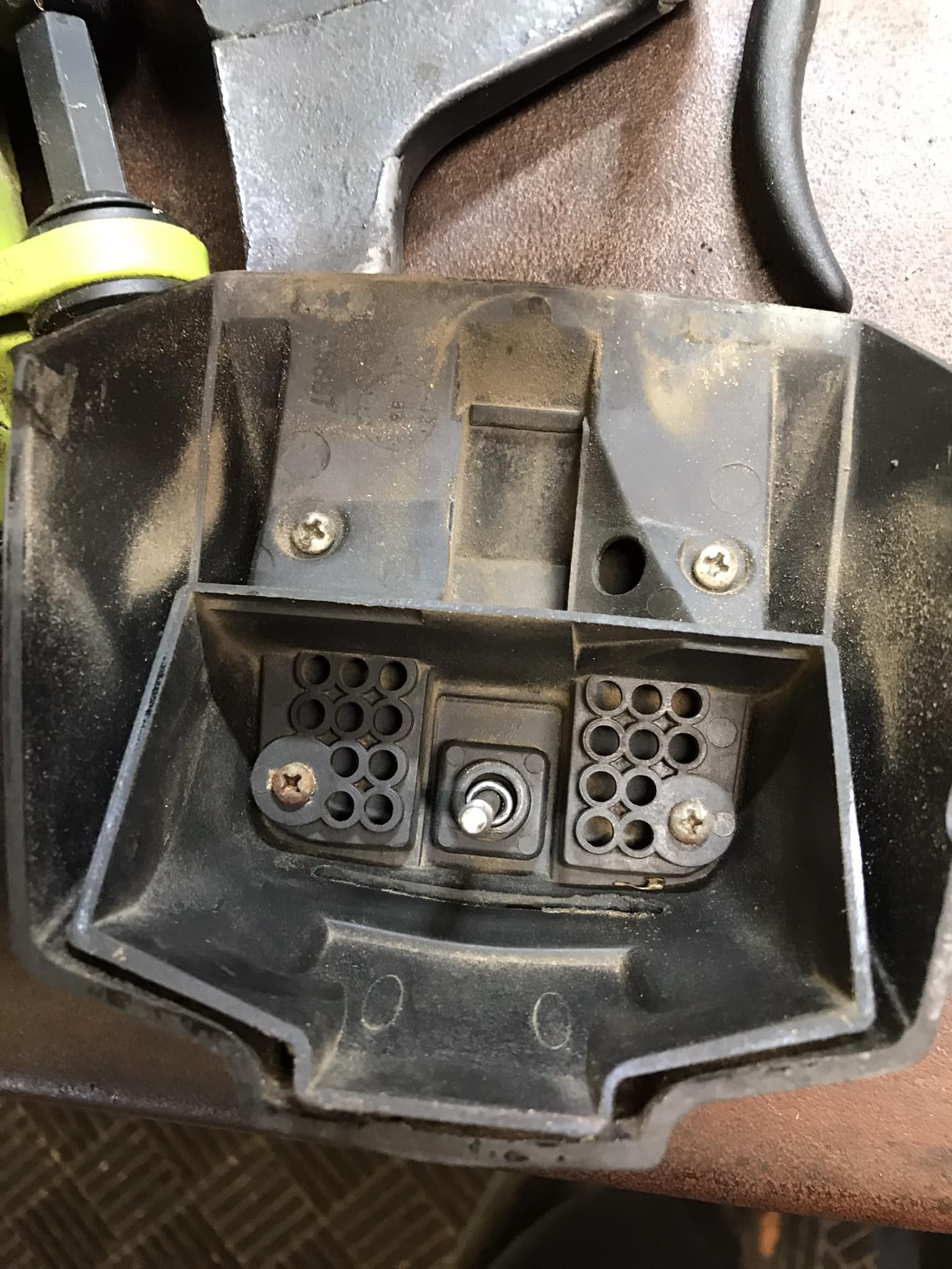

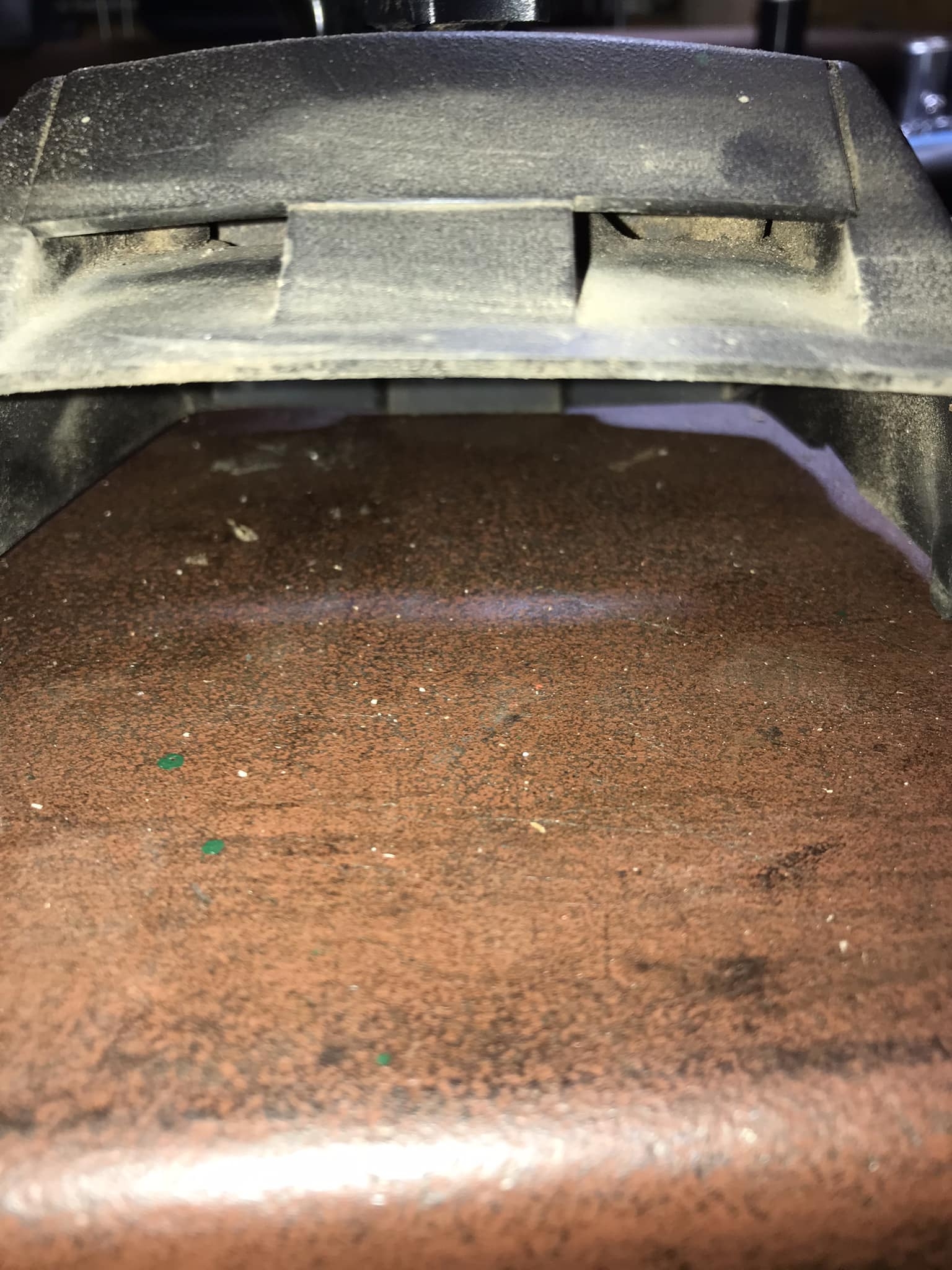

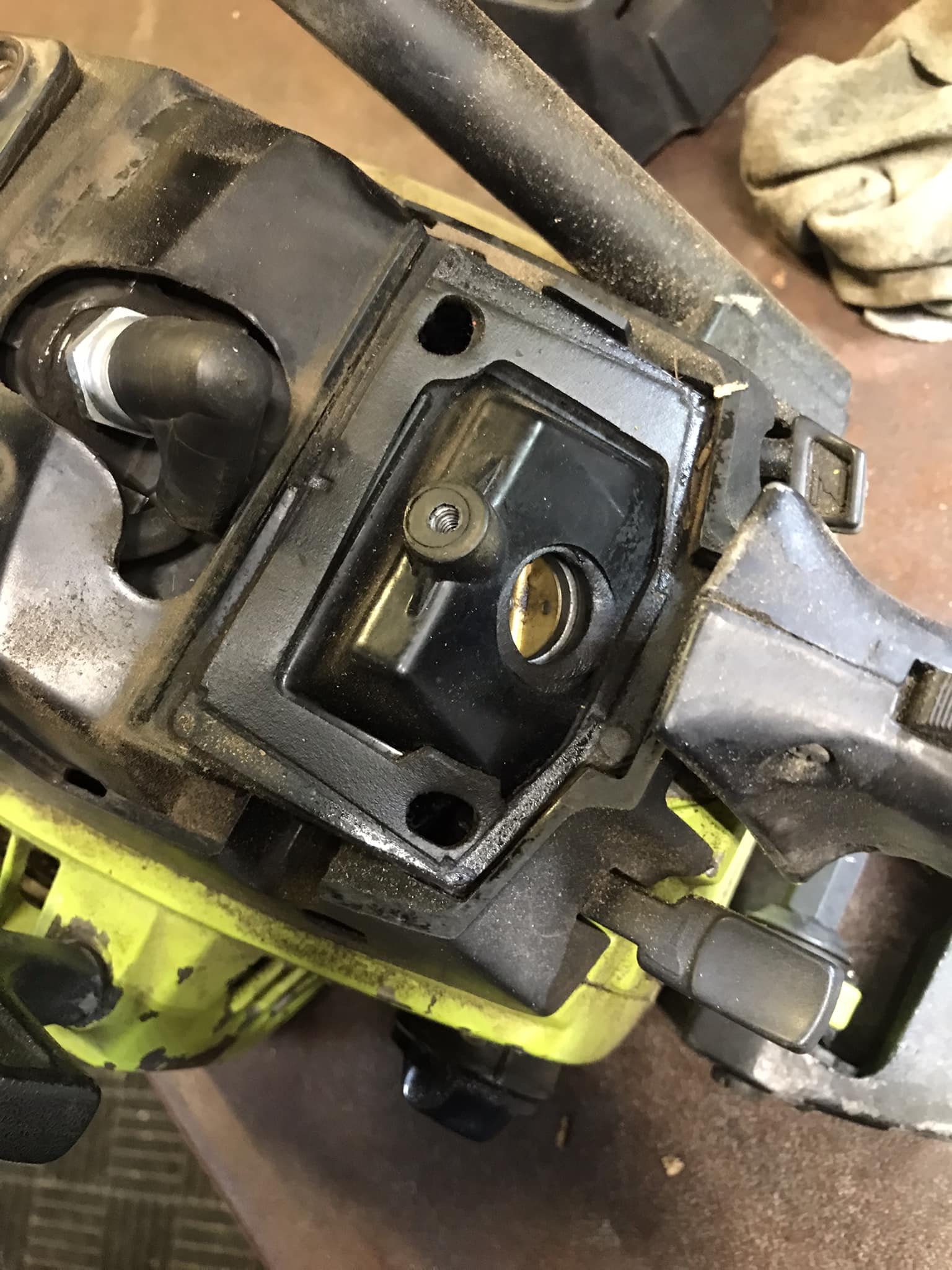

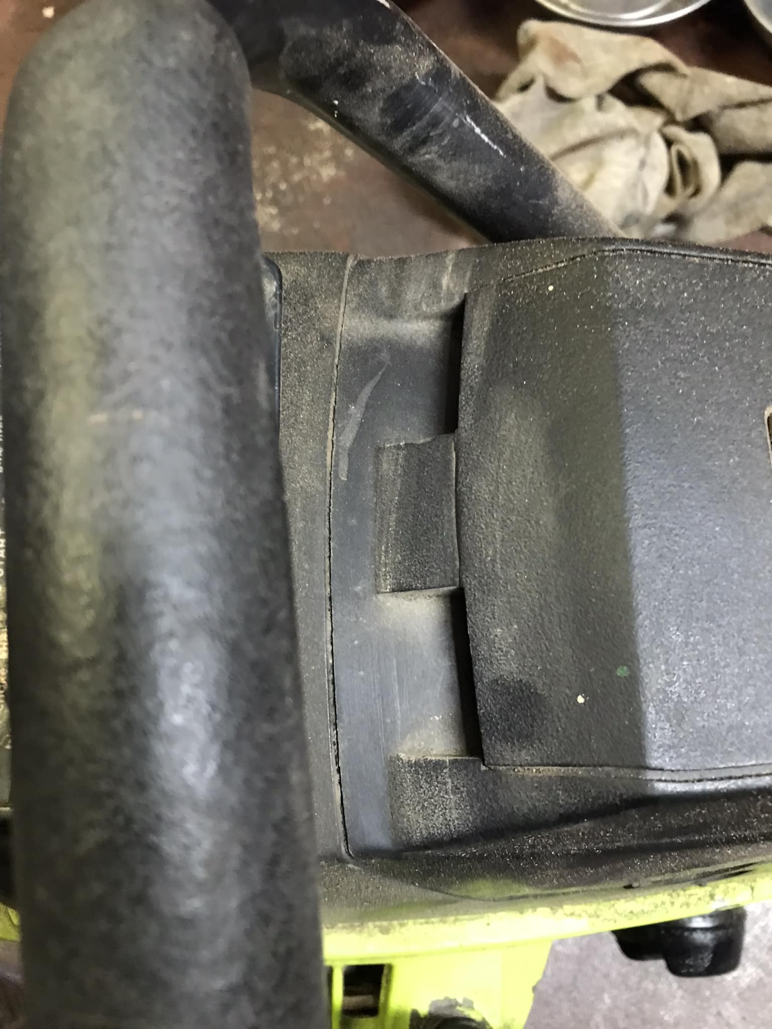

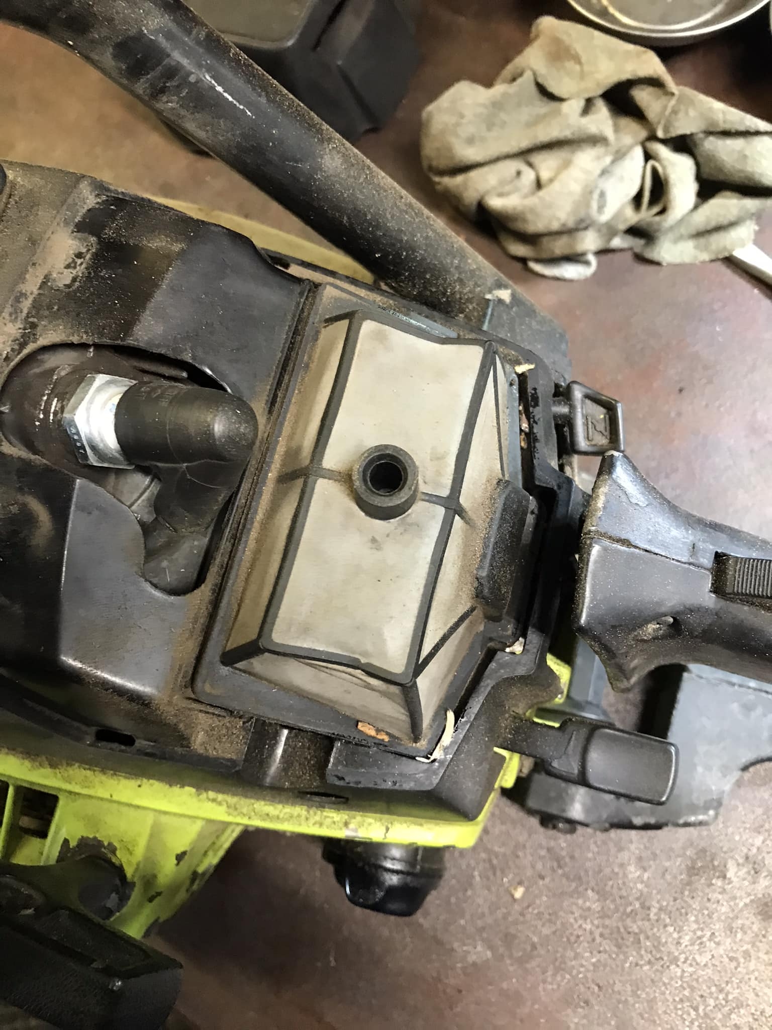

I had feared of dirt ingested while cutting that stump up. It was falling in chunks right at the 2 front inlets on af cover. I was stopping and wiping them away.
Looks like the old 80's air filter system did fine even with it mesh filter.
Oh a past owner had open the back of af cover straight to air filter too. I had thought about putting a prefilter screen over it inside cover. But hasn't been a issue to date.

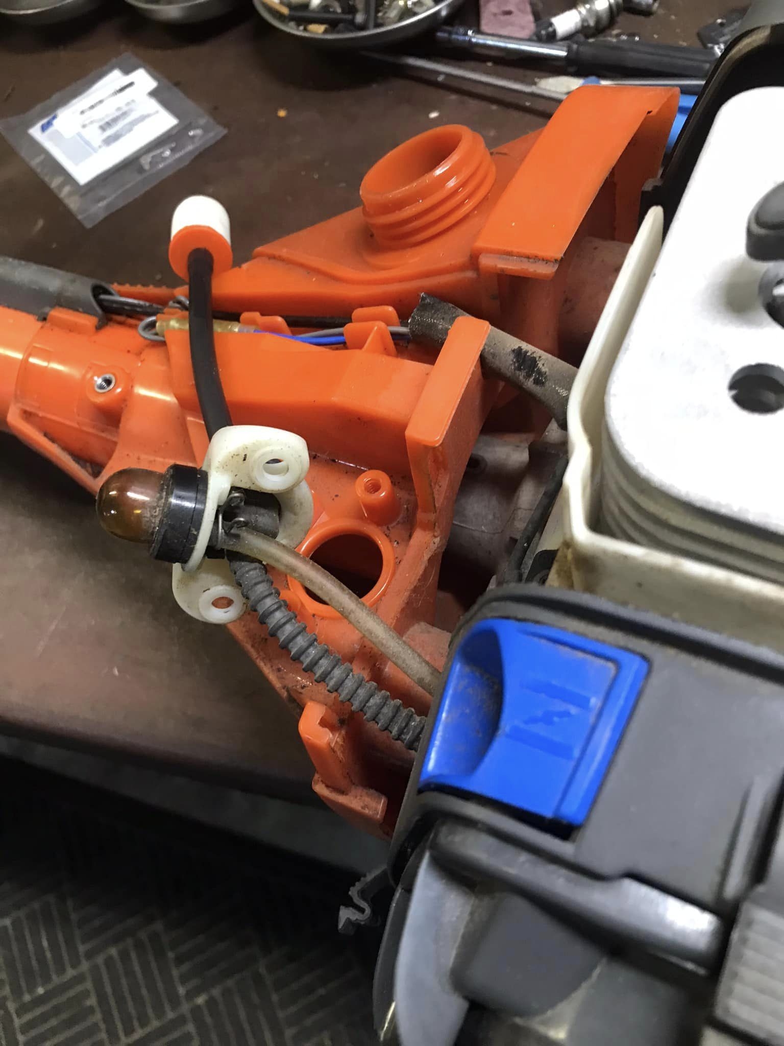

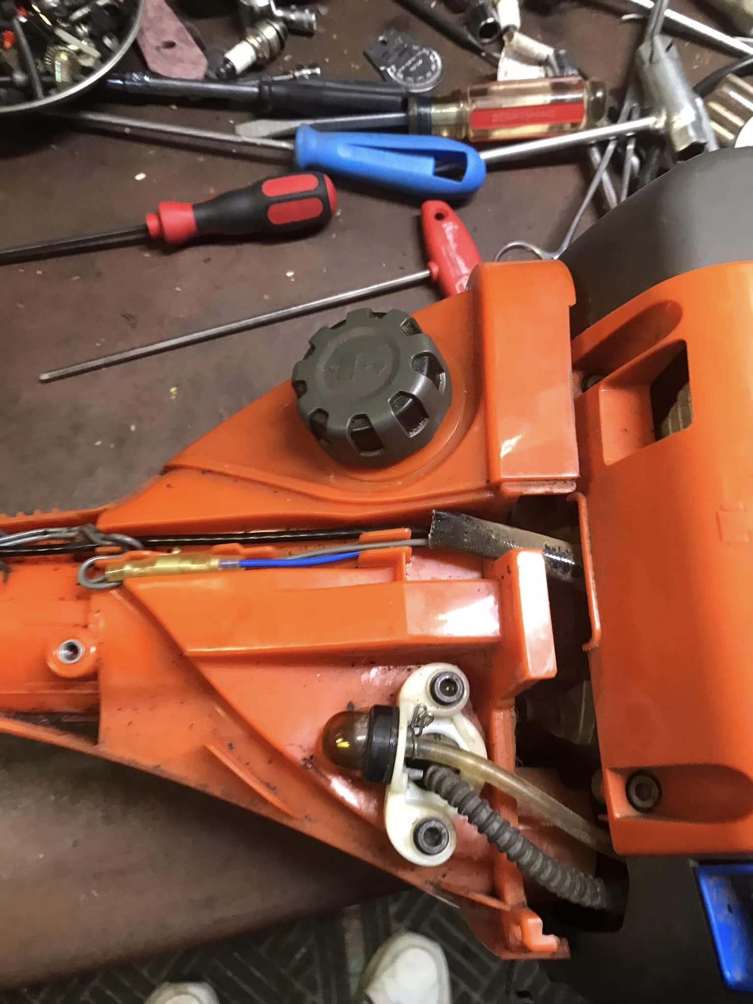

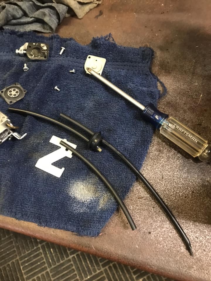

Husky uses chit clear line in some of their ope. Your lucky to get 2 seasons out of them even with E-free mix.
The fuel line itself is that small trimmer size I cant stand. It's going to normal size of other 2 too.
Updating this with with echo oem lines and think I got it all back so dont have to buy their stupid fuel line kit with junk line.
Removed the catalytic crap inside muffler so she will breathe better too. No cost muffler mod.
Waiting on carb kit. One I dont have on hand.

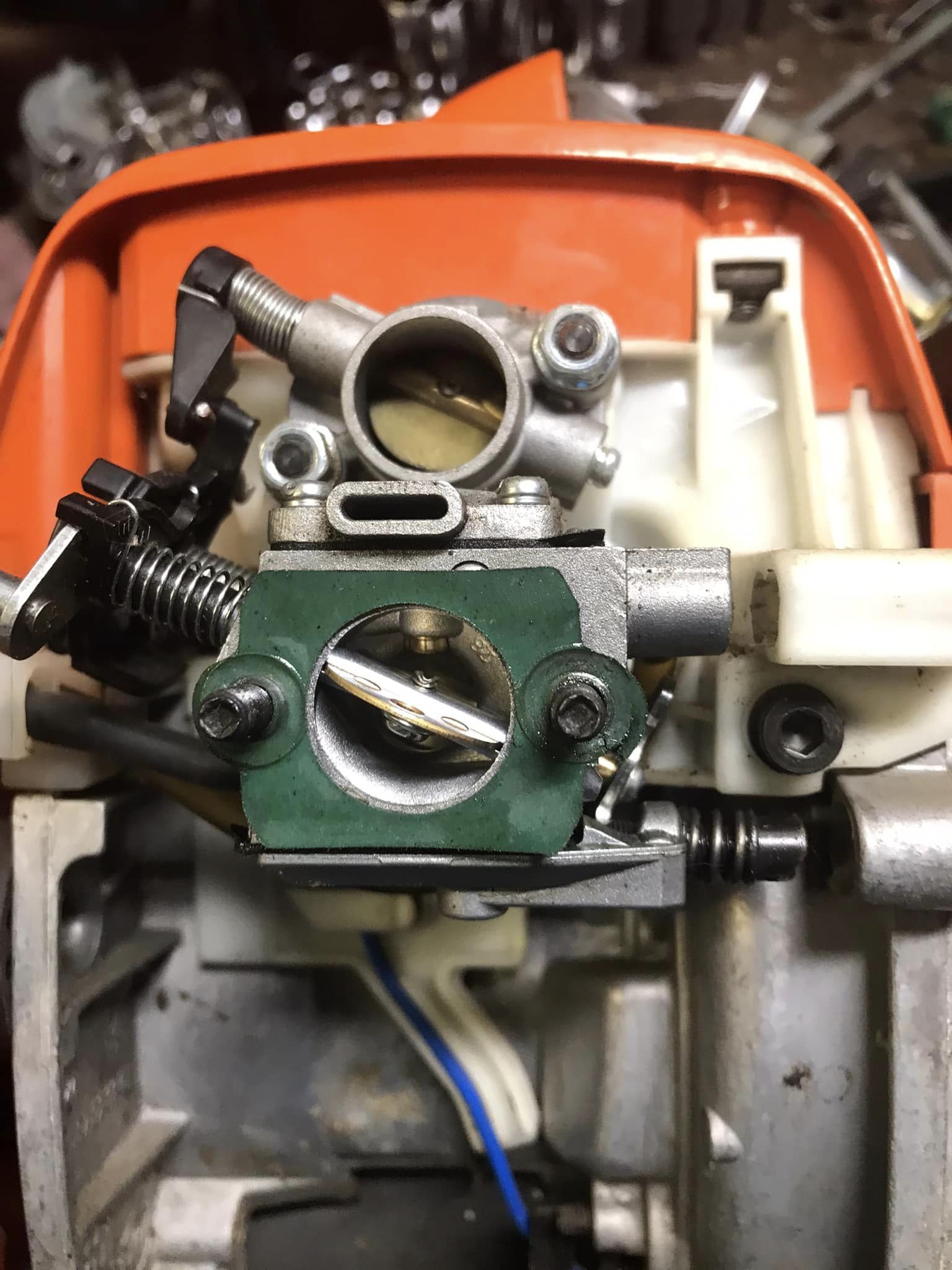

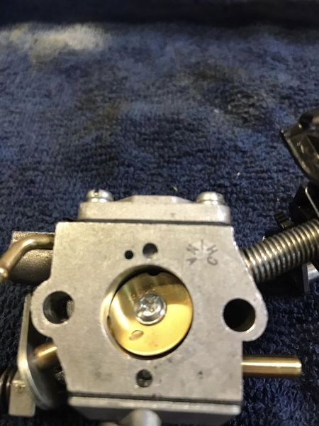

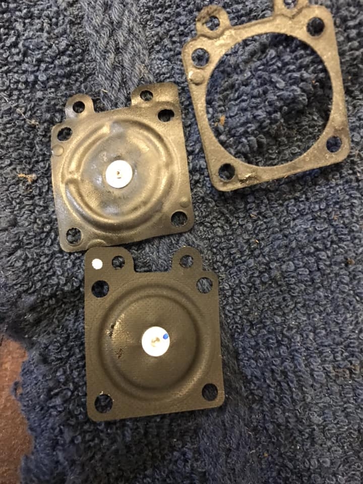

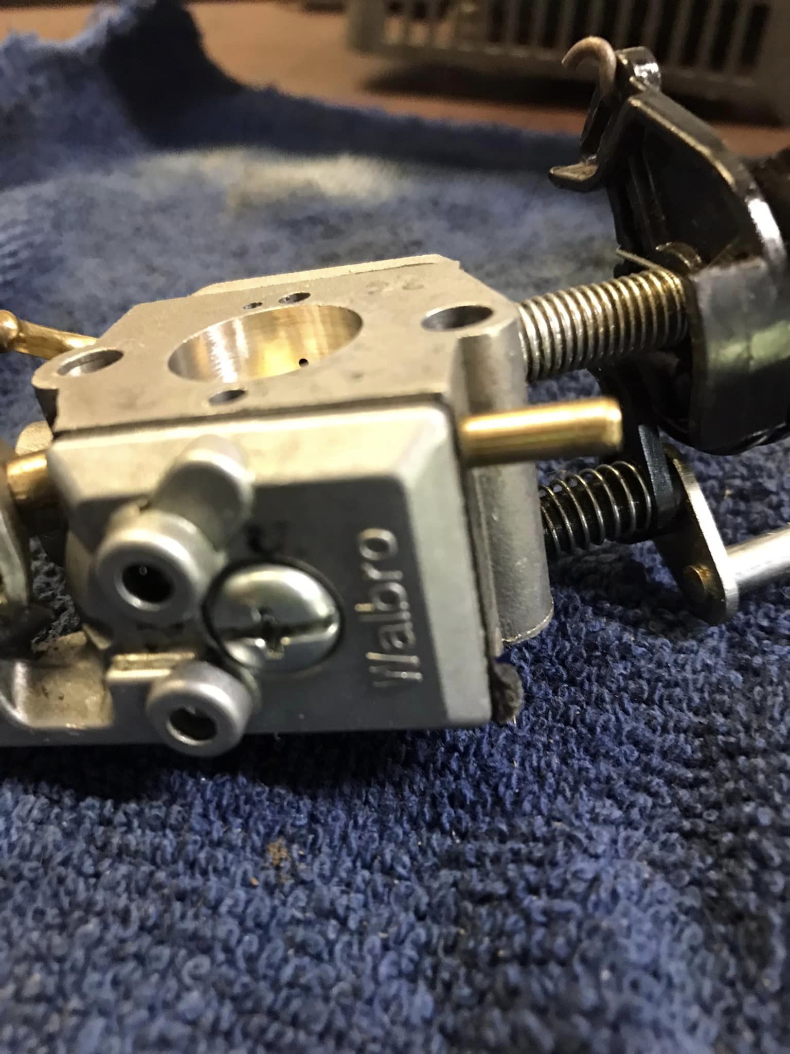

Carb rebuilt and checked. Still same zooming happening.
Told owner I didnt think it was carb kit issue from get go. But carb diaphragms were getting iffy. Plus got to put in a tan over that blue oem one on check side.
After troubleshooting came back to the cable on engine side to carb. Dealer said he just replaces the whole cable as common issue he sees.
I was able to remove rubber boot and lube inside best I could put boot back on and work it some and got it working. So good to go and even tested out in some weeds.

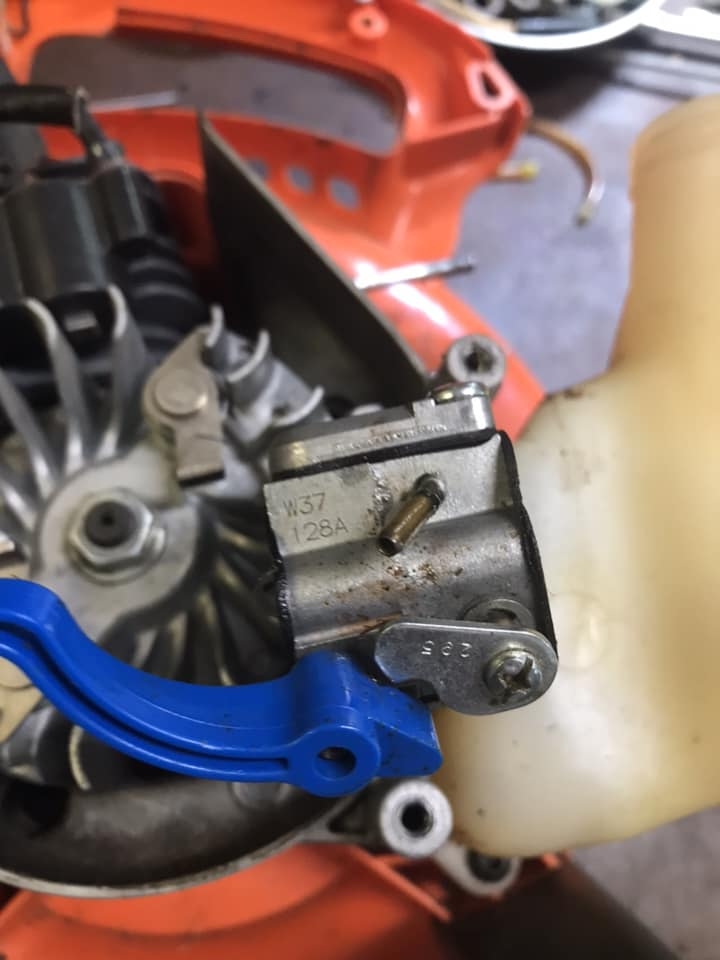

OEM walbro kit and they punched pump side diaphragm wrong. Luckily dont matter on this one and will still work.
Also the OEM Walbro carb made in China. Told folks for years they had a plant there too.

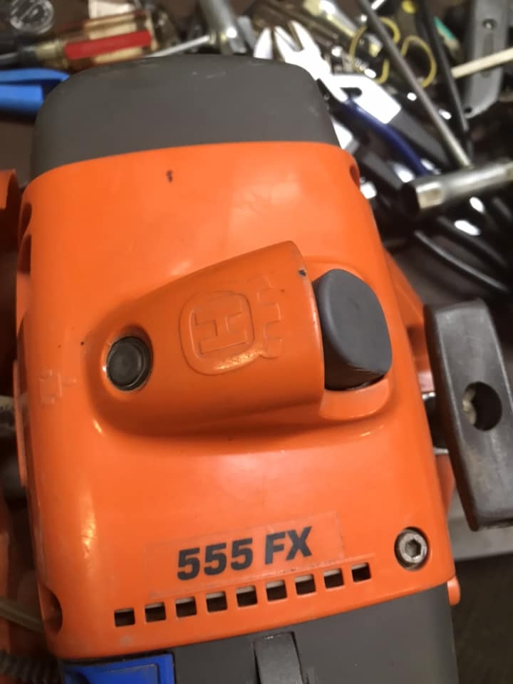

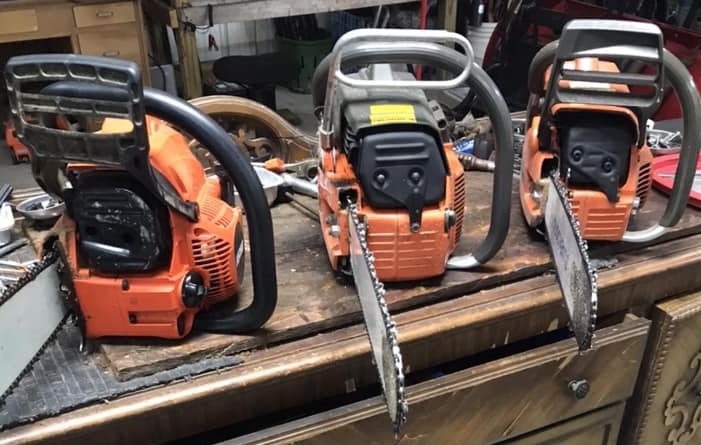

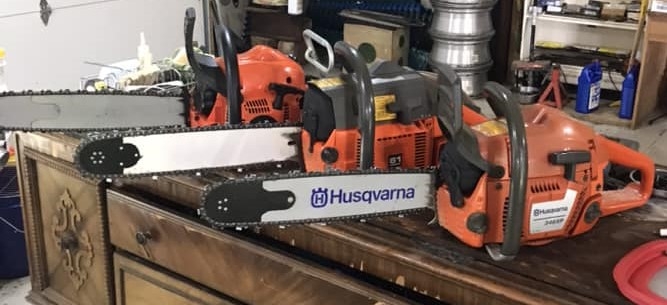

Owner picked up the 555FX and coming back to test these 3.
Just wanting a limbing saw. Something lighter then his 2101.
I got a feeling which one he will pick. :cry:
