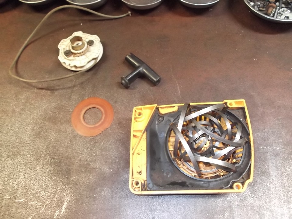

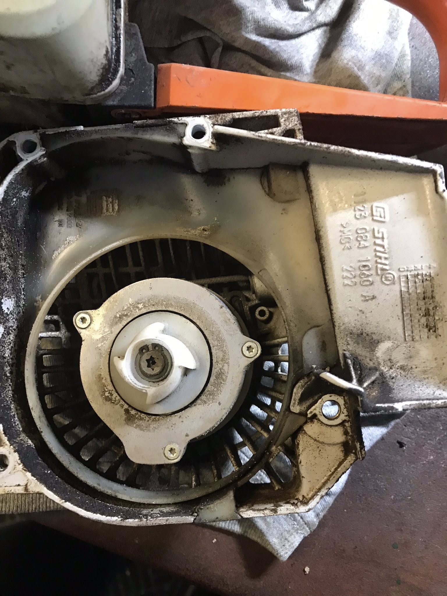

Had the pull rope break on my 2511T and while trying to put a new rope in last night, I accidentally sprung the spring. What an absolute nightmare trying to wind that spring back by hand and getting it into the holder it fits in. My fiance was out in the shop with me at the time and witnessed me throwing crap across the room exclaiming "I GIVE UP!" a time or two. I am sure it was quite comical from her viewpoint.
/ Just another junk chainsaw
#2,742
Been there done that.
I never bought the tool. Even though I have to do more then most. But they do make a clone tool for such. @JeepHead
Dont get in a hurry and forget a part like I did one. That makes a real mess.
I was ticked and didnt take my time to remove after installing it. 😂
Couple mins back in again.

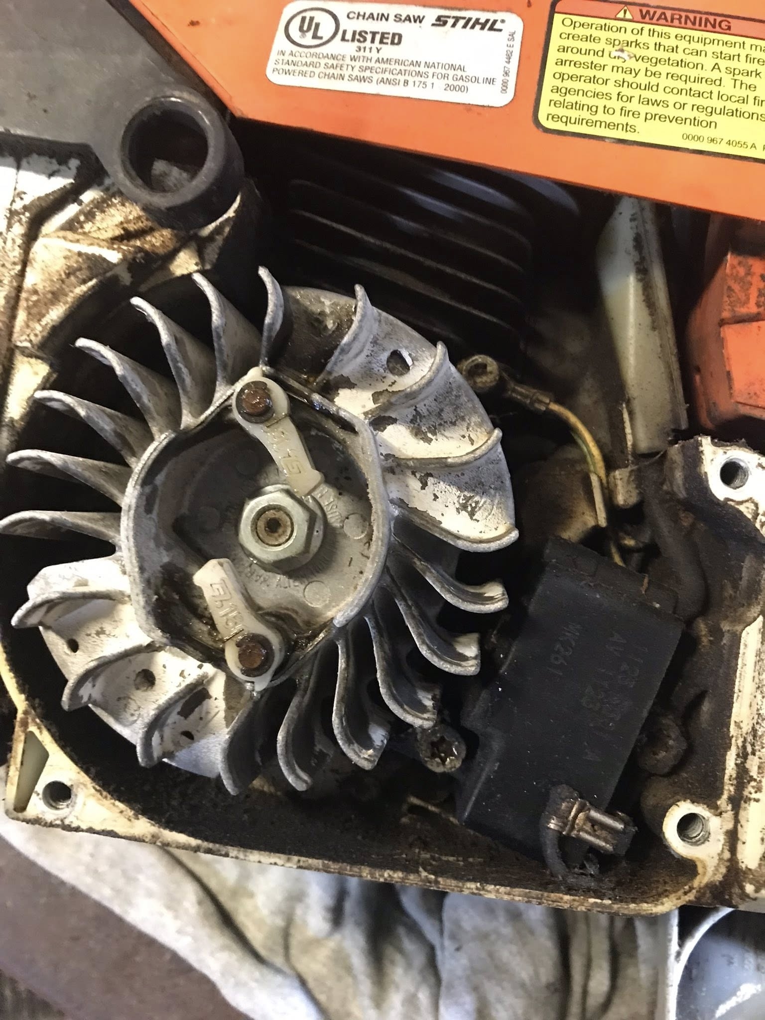

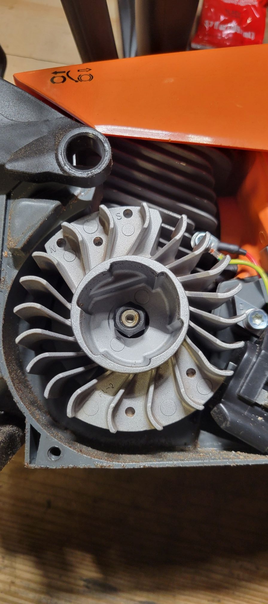

Guy helped me compare a Farmertec G255E easy start to a Stihl 250C easy start.
The farmertec 255/250 version of easy start, works like the 180 version and also looks like it too.
Comparing because the cost for oem parts for this easy start stuff is ridiculous.
You can buy the whole clone ES saw cheaper then a recoil and flywheel set up. SMH. If was ever needed.
#2,745
From a thread in my group where guy had both to compare. OEM 250 flys on regular bottom and easy start top.

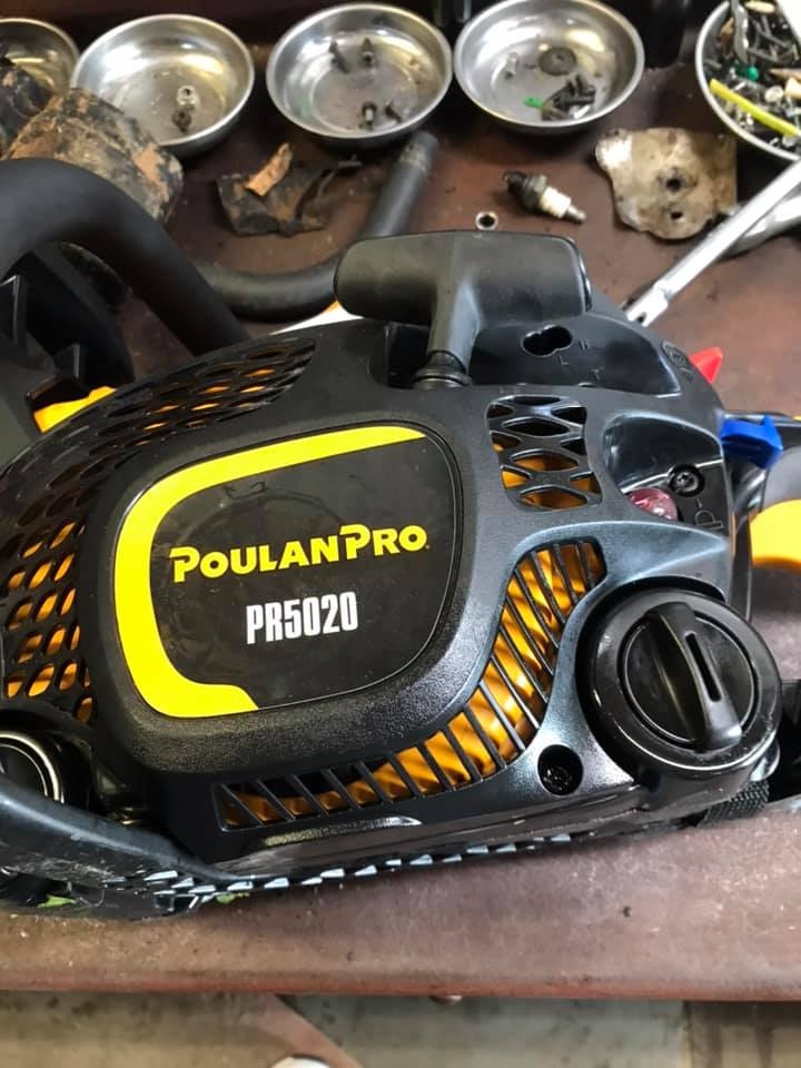

450 just the more expensive version with better parts used then it's cousin saw Poulan 5020.
Owned both to compare.

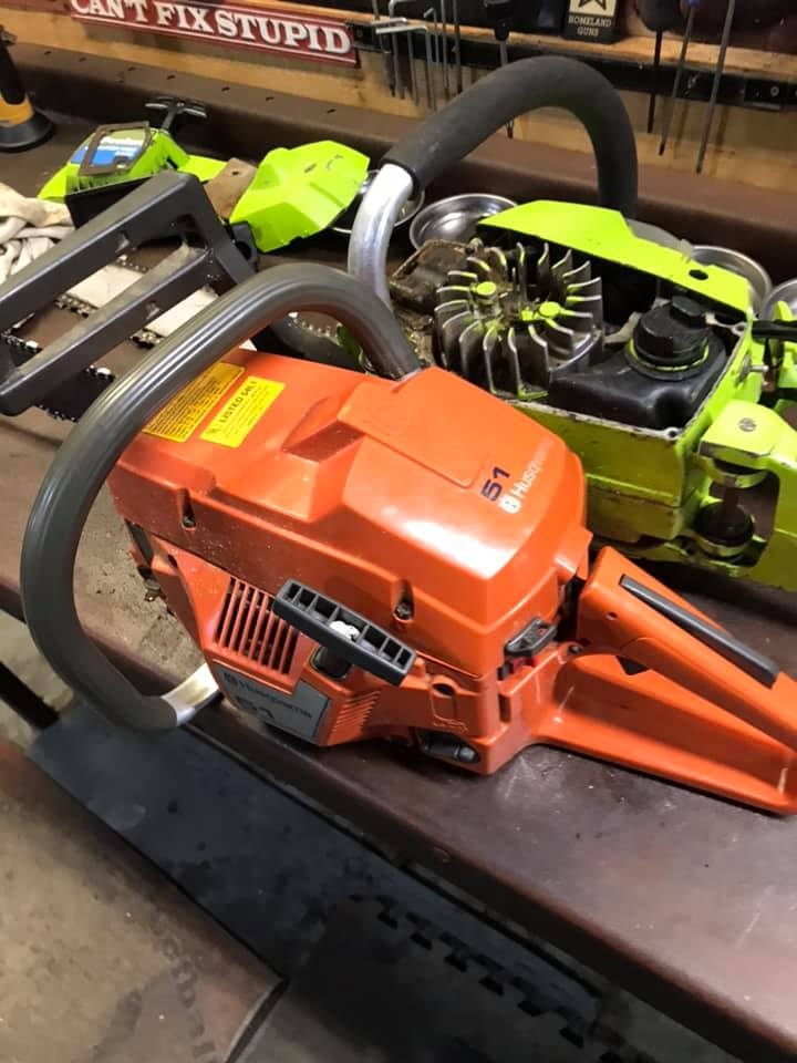

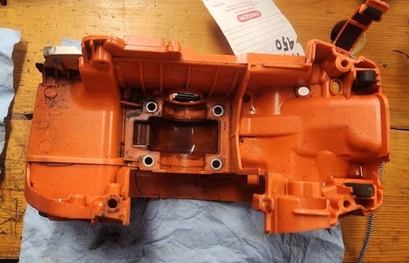

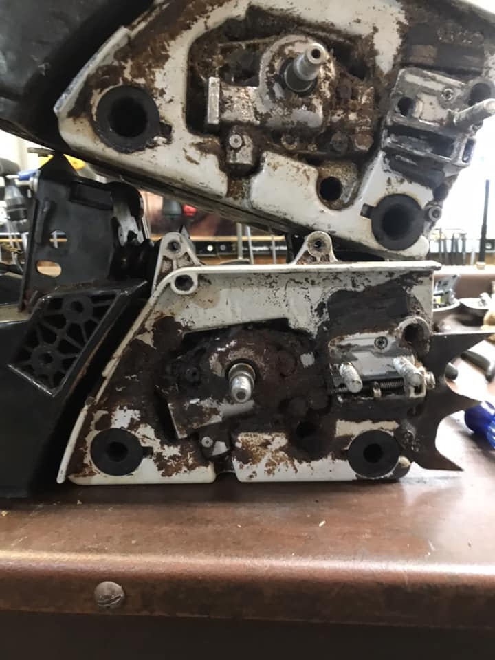

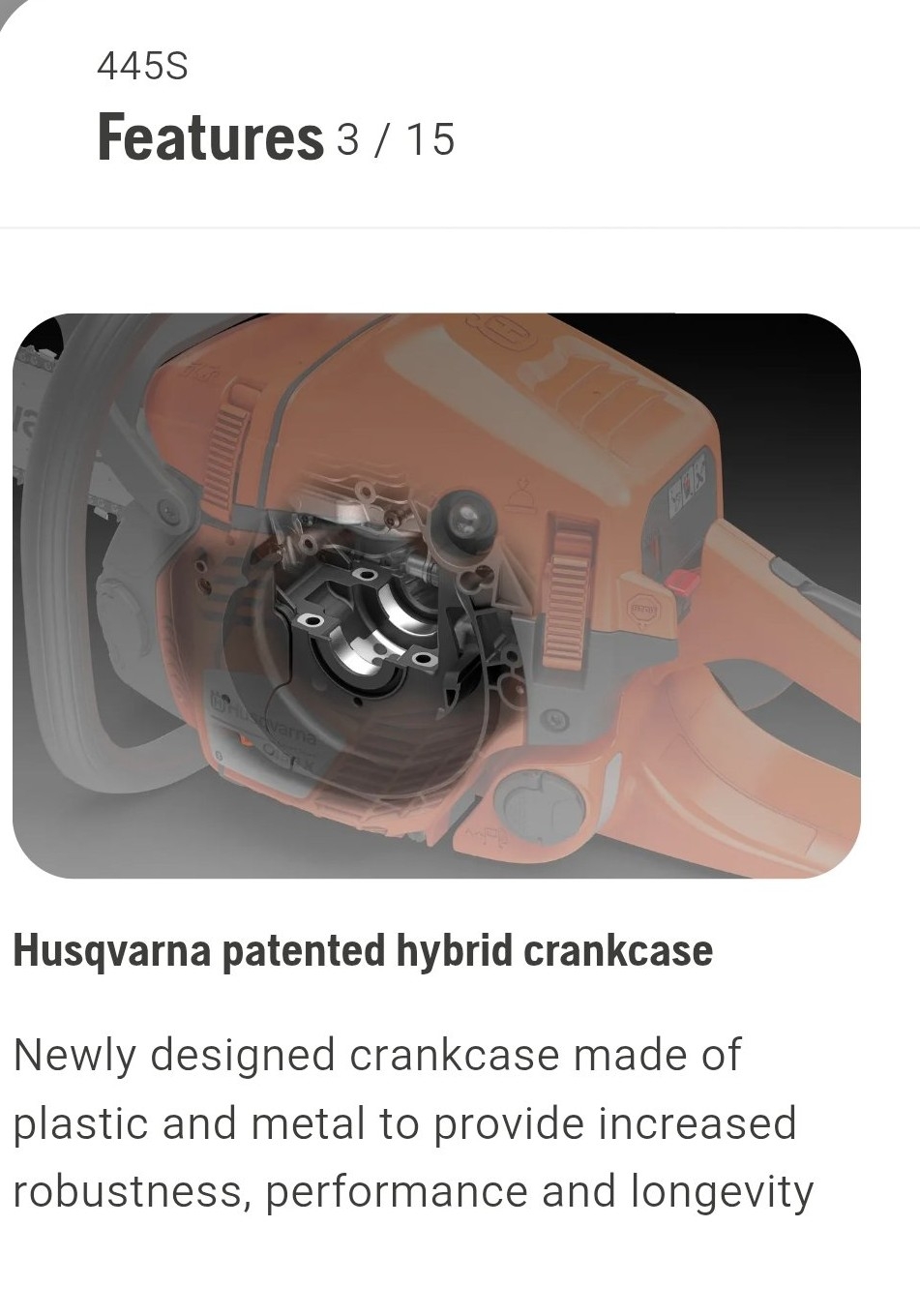

Least they finally updated them. 445S 450S
No longer just plastic at bottom.
OLD 450 top
NEW 450S they added some metal caps. To help stop with the melting. bottom

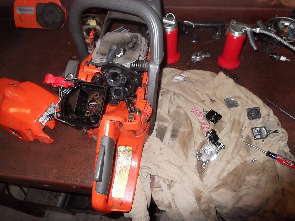

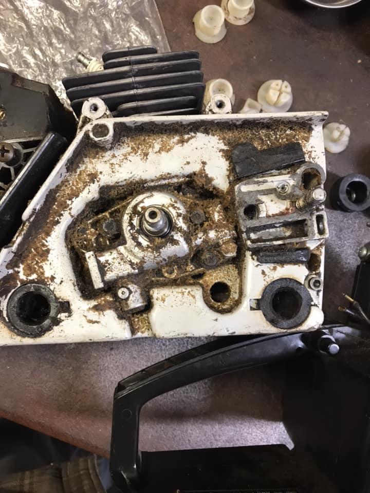

OP, two part question for ya..I'm sure you've worked on a husky 55 before ...I replaced everything on the intake side .
Have you figured out a permanent fix for the stripped screw holes in the plastic intake partition the carb bolts to?
I've seen in my saw group where some have used like helicoil inserts and I think 5mm bolts through carb ..and others who studded the bolts into the plastic maybe locitite into inserts..and used nuts to hold everything together . .which way you think is best? I have a spare partition now I might try to
Fix up..
Plus have you ever fooled around with dyeing the plastics back to close to OEM color ..I've seen that discussed a good bit..
That top cover I bought off eBay looks like 💩🤣
It and the gas tank aren't original to this saw ..this saw was given to me about 5yrs in less than desirable shape ..muriatic acid was spilled across top cover and it sat in it all weekend in the bed of a pickup and the corner of the original tank became soft mushy and leaked ..
I've replaced about everything that's bolted to the case except the coil which seems fine .
New crank seals too...everthing on clutch side seemed fine other than seal.
#2,754
No never a permanent fix. Just redneck fixes. IMO when I do saws for folks they get a new or good used partition.
I dont dye chainsaw plastics. Lot of guys in mt group do though. Use RIT dye and hot water, then soak till get color wanting.
I havent used acid in many many many years. Created troubles sometimes that wasnt even there before.
51 I think was last one in in that series.

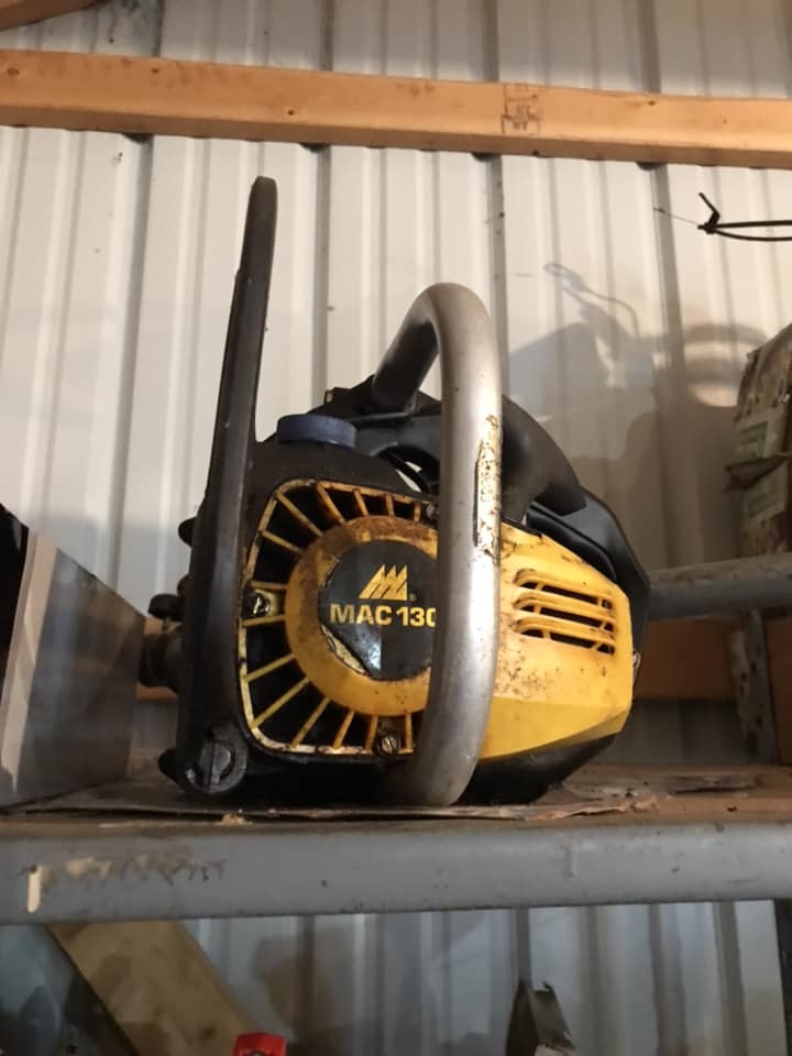

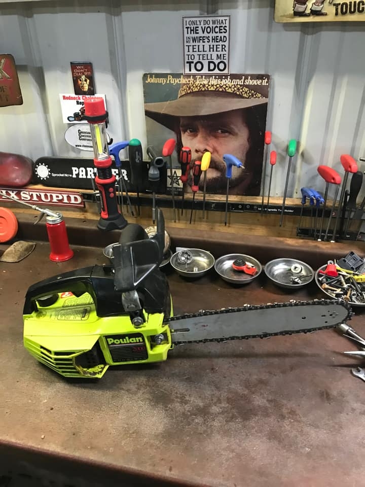

@JeepHead remember when I told ya reason dad said he bought that little mac 130 TH in early 80 or so.
Found a ad for the one before it by mac. Was pretty fitting so used in my group today.
/ Just another junk chainsaw #2,757
#2,758

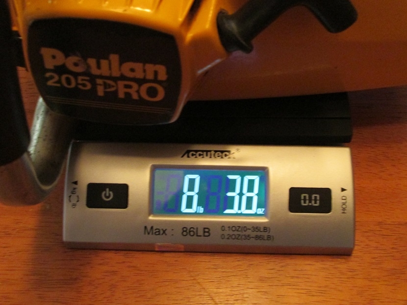

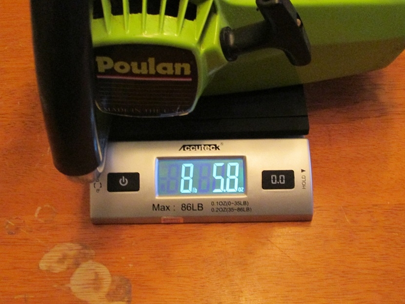

Guess better put dads saw here. Shows these ones gained weight compared to what they say above.
Dads mac 130 he bought new around 80ish I am thinking. He climbed and trimmed the heck out of the trees back then.
I hated this saw in 90's. Always vapor locking on hot days.
So it just sets on the shelf up there at top.

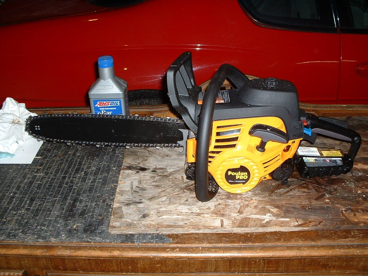

Liked my poulan 2000 better bought new in 94.
Someone else's weight pic of the newer ones like dads. No clue where I saved it from.
Friends PP205 like 2000 for weight he did years back. Heavier yet but never running issues in heat.

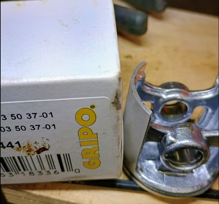

I let the SIL pick up the parts. Don't think there's any chance it's OEM, plain white box, very rough casting, minimal flash removed, no make anywhere, i.e. Chinesium. Looking up the name Gripo, it looks as if its a Quebec company.
If it was mine and I had knowingly bought a knockoff I would have. He insisted on going to the dealer so it's on him.
Flashing just not milled to size, like it missed a step.
Husky 254
Question. I checked the end gap, was 0.005, seem tight? although at 2 thou. per inch diameter 5 thou is right for an 1-3/4 diameter. The old ring was almost 1/8" so that was
definitely too much lol.
The dealer, and I use that word loosely, got another piston in. Told the SIL that that's the way they come, you have to file the bosses to fit the side to side measurement of the con rod. Sounds like a load of crap to me, never heard of such a thing.
I may order a piston from scamazon just for the halibut and see what I end up with.
