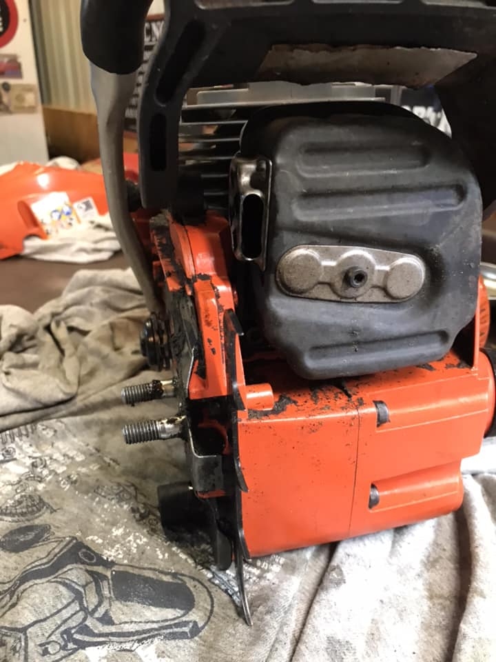

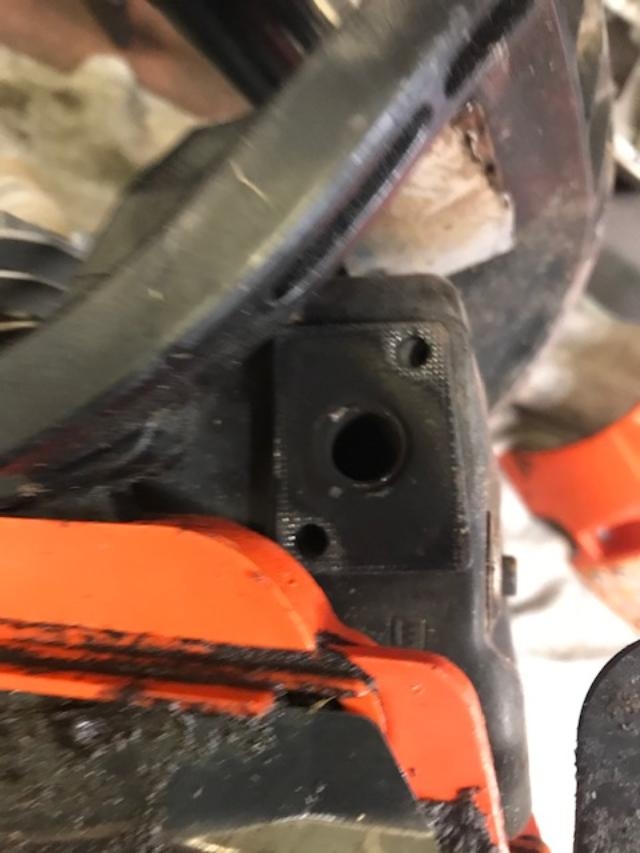

@kenmbz did you toss the inside tube and open front up?
/ Just another junk chainsaw
#2,462
Also to help keep fines from getting by the mount area. Oring.
Then small gain by doing this on them. Proven on dyno with stock and then removed.
Really nothing to worry about as my 2 stock 501 I havent done it yet. But did on the ported 490.
#2,464
I have the oring and did not pull the tube yet.
That's why I was surprised to notice a difference.
Think like 1 more slot and maybe little more open on 501 4910 deflector top.
490 lower.
IMHO still isnt enough. Inside tube pops right out. Open front up.

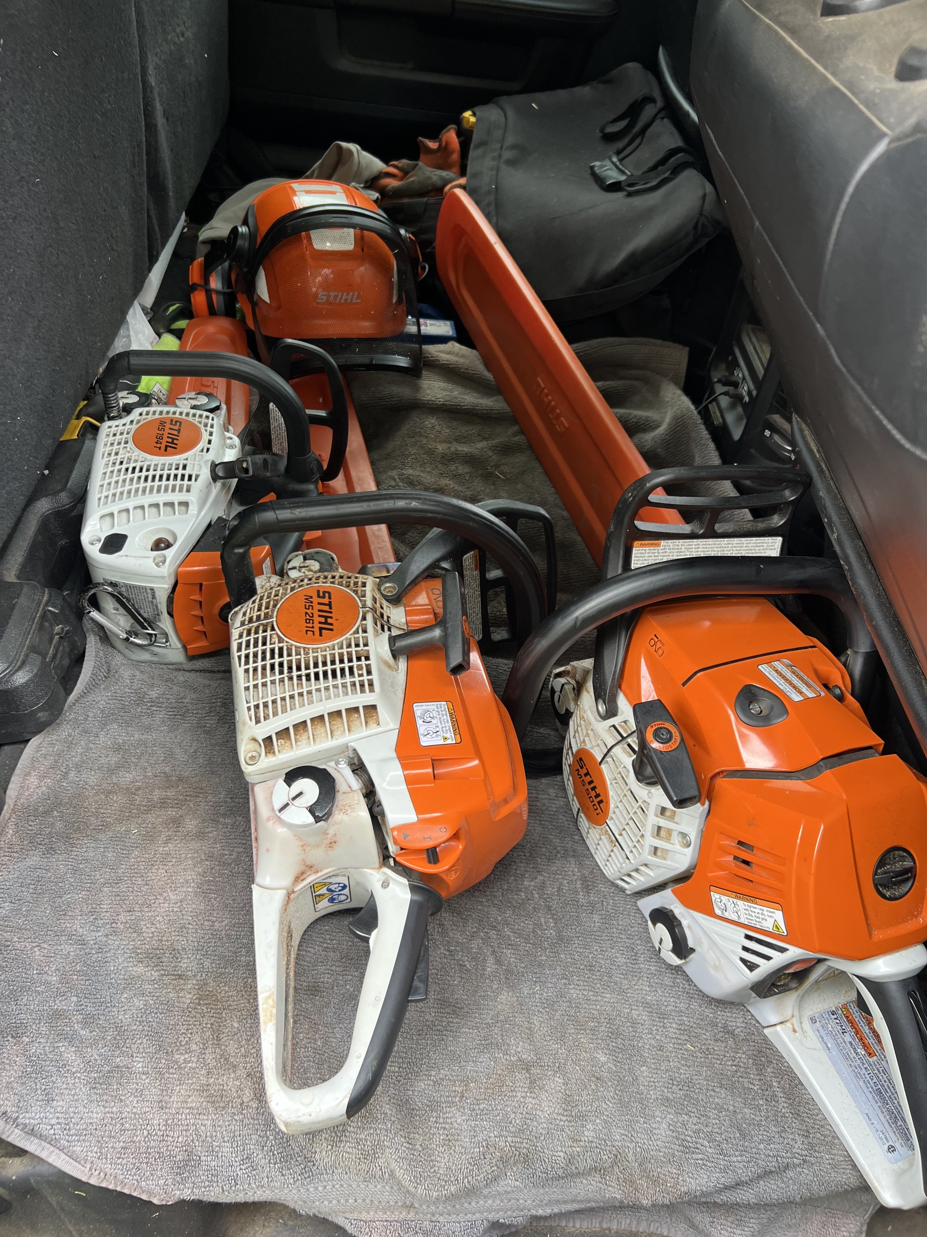

Tree work tomorrow. I just packed up the truck. Moving the tractor there tonight. Customer with large fallen tree.
Let’s rock. lol

Getting some ready to go. 346 501 2511
Nothing big so all small saws.

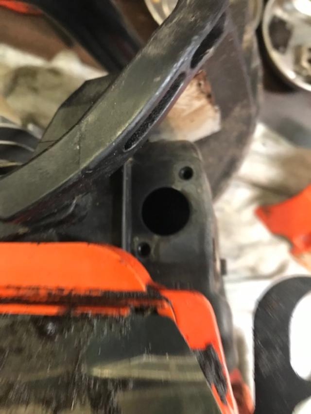

Referencing top handle saws, my Stihl MS192T seems to have a torn boot between the carb and saw ("intake manifold"). Flexing of the handle seems to be the issue is my guess. Curious if anyone knows if Stihl modified the boot to tolerate the flexing?
#2,479
Common to tear boots on top handles from pulling on them. Not just stihl.
