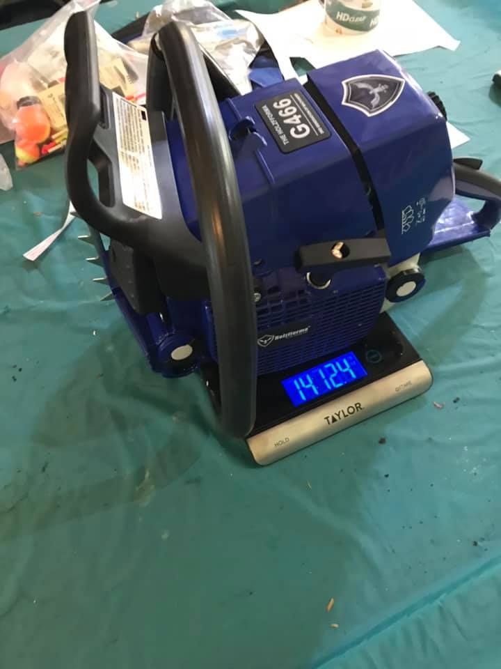

So basically what I have always known. Ported saws punch above their cc weight size.
When I got that 359 I was told it cut with OE 372 71cc. G466 cuts just like a oem 460 with a DP.
Not the turd 460 with pencil easer side outlet only. SMH
59cc - 76.5cc
upper 12lb range and upper 14lb range G466 is with small inner spike for weight shown. It is little heavier now by double bigger spikes.
Now I have ran the 359 ported with 24" buried ripping and it smiled and said more please. 😂
Thats has far as I would go on it. Stock G466 I have ran 32" buried and it smiles too ripping.

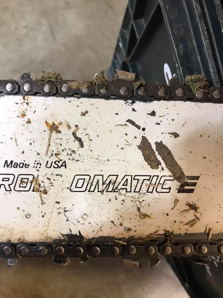

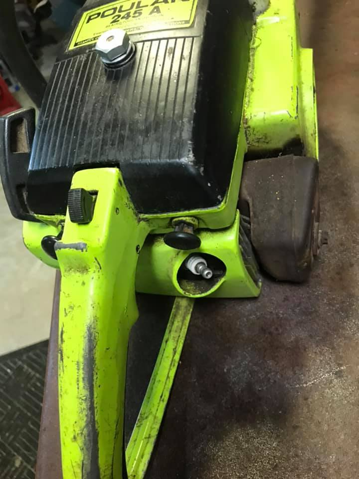

This was my grandfathers. He bought it new at Ekert Brothers in Sugarcreek many years ago. Dad has it now and tries to use it on occasion. He has had it to a shop several times but they can't seem to get it right. I mostly think they just don't want to screw with it so they don't put much into it. It will run until it get warm. Cool little saw when it works.
I took a one owner in trade from a guy I worked with years back.
Some people like those little guys. I didnt after using the one I got here.
Liked my poulan 2000 I had way more that I had bought new in 94.
So I traded it off for some chain.
They were hard to get parts for even way back then. GL.

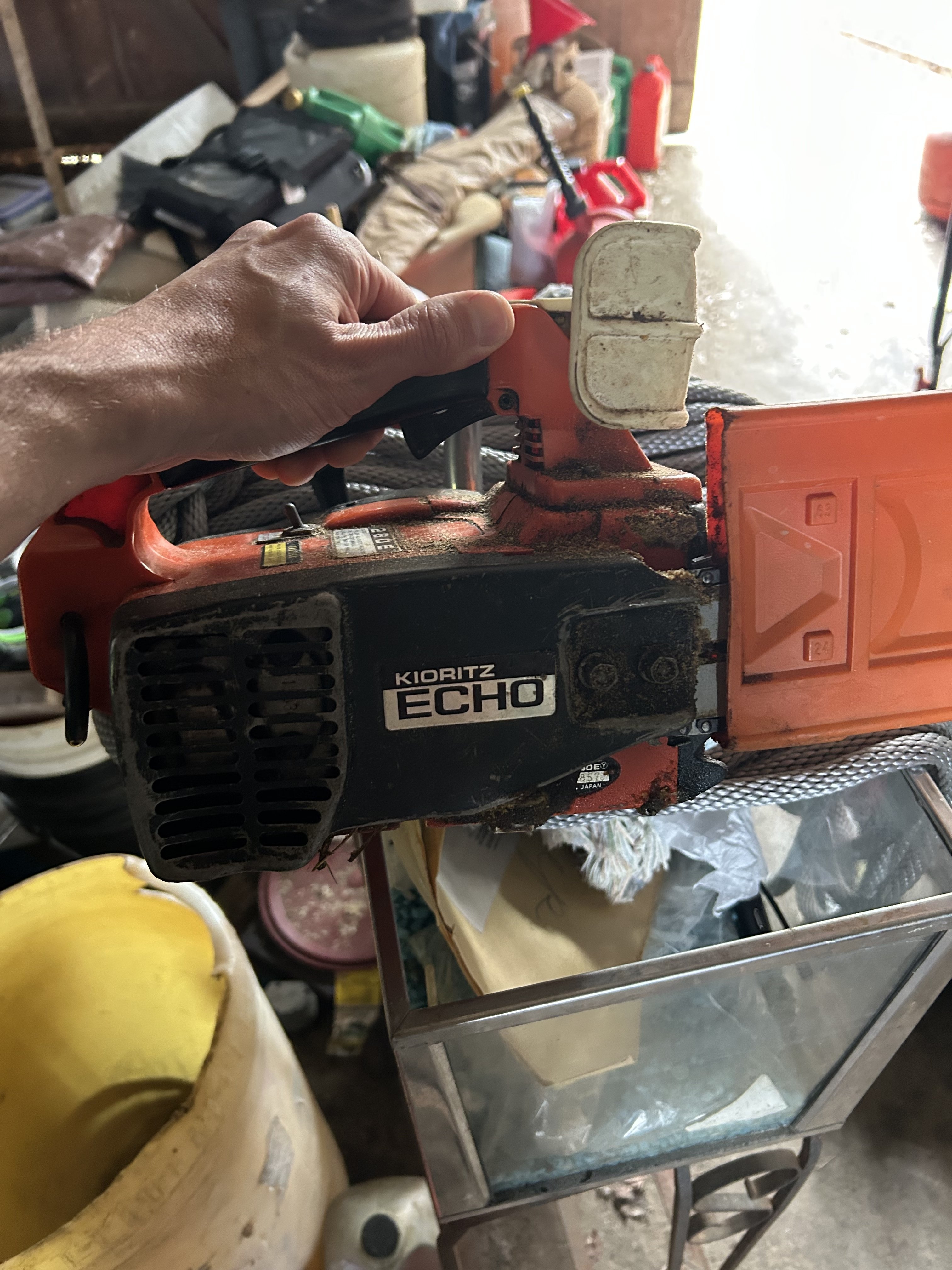

Thank you. I have a feeling its going to end up being a wall hanger for me. More nostalgia because it was the first saw I learned on.

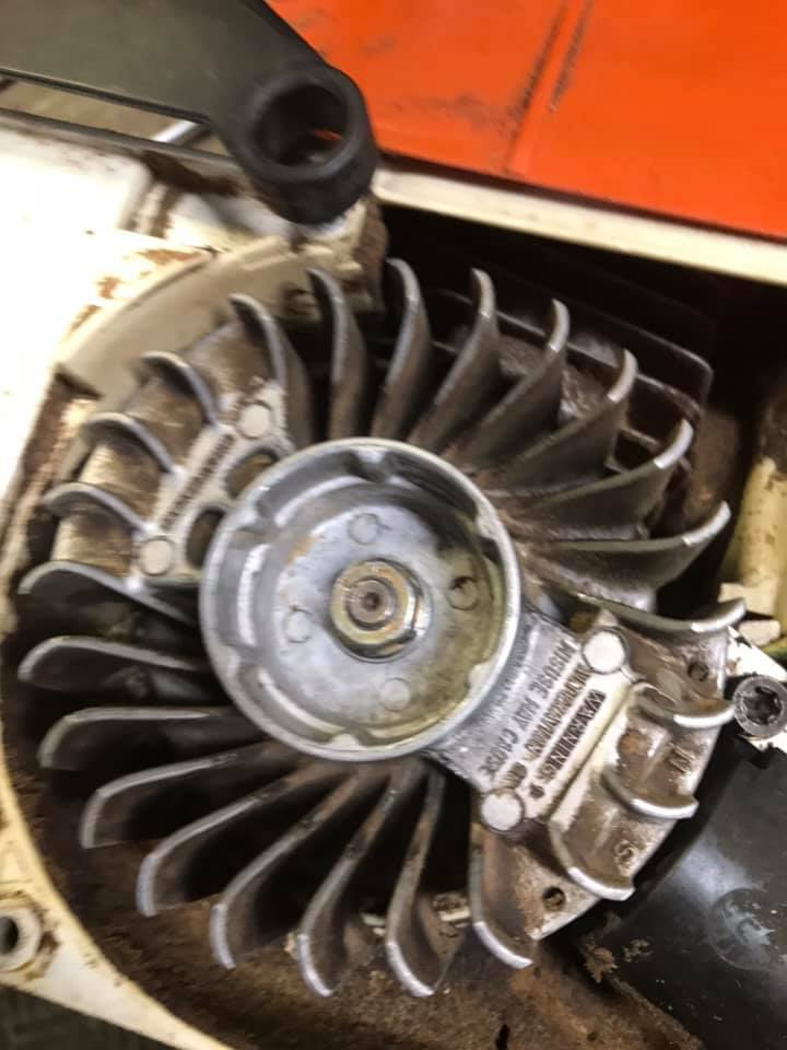

This one I am going to try and get running right. It was my other grandfathers. it will fire and run but won't stay running unless you're on the throttle. Carb work I am sure. Going to do some YouTube time and maybe teach myself along the way.

Prob just a carb rebuild time with kit. Once cleaned carb 30 mins to install. Go with oem stihl line if want it back right. Aftermarket will not run right in bends.
I started using echo oem line myself so I dont have to order stihl oem lines when needed for guys. If they ok it going that way.
Then check impulse and plug while in there.
Take peek at piston etc too just in case.
They take to a simple muffler mod big time. 18-23% gains and carb retune that are stuffed up bad.
