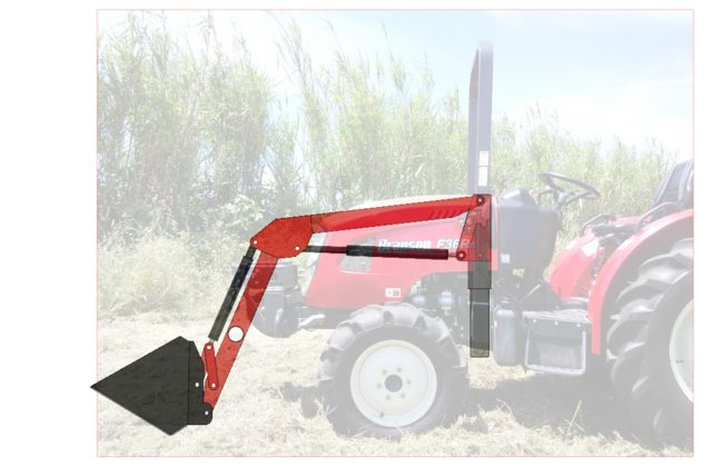

That's more or less how I did mine. Just went ahead and checked lots of loaders in person on farm shows and other events, to get an idea on how it's put together, thickness of materials used, cylinder placement and sizing, hoses, etc. Did take some pictures but didn't really take any measurements.
Another trick I used was to find a picture of another tractor like mine that had already a loader, import the picture to a CAD software, scaling it properly, and then get all the dimensions I needed. Won't be fully dead on but will be perfectly close enough.
In the end, came out with my own CAD model to make sure I had all the right geometry, clearances, strokes, etc.
If you have a good picture to start with that can work quite well. I have done this myself. Sometimes, because the scaling difference is so large, big corrections need to be made. However, some pictures are done so well that careful scaling can result in dimensions accurate to within less than 1mm, or about 1/32".
