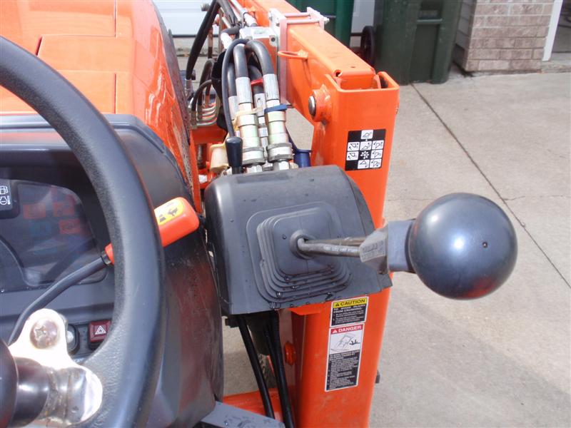

I also used an ATV winch switch. most are water proof two position momentary rockers that are perfect. Mine came with a handle bar mounting bracket for about $25.00 :thumbsup:

Mine is a rubber coated water proof switch I got in the kit from Fasse. The kit isn't much more than the switch, the electric/hyd valve and a pre-made wire that runs between them (plus a fuse). I had to extend the wire for my install, so I didn't gain much from it other than having the plug already on one end. You can barely see it in the pic just under the control stick knob, to the left (the sort-of rectangular black thing). Not a great angle on it.

The research I have done leads me in the direction of making my own, but after seeing the prices for some of these handles a JD LVA13698 is priced at around $172 and has 3 buttons on it all thumb operated. It could be made to fit most any control valve with a little fab work. It is the control handle that fits a JD 110 TLB (Construction Equipment). I hope this might help

I used the JD Grip for mine and bought the parts "piece mill" and got away about $100 cheaper than that (and I stole the idea for doing that from someone else) - My build thread is over here:
http://www.tractorbynet.com/forums/customization/358086-kioti-ck-35-3rd-function.html
