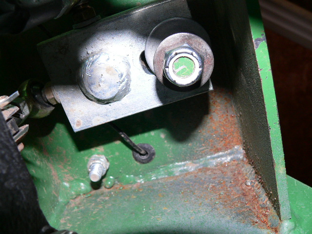

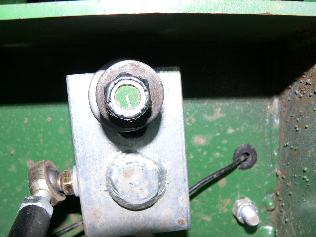

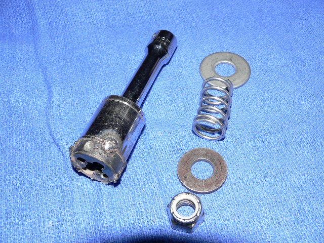

OK, this looks real good, but I can't quite understand the pictures. Could you take a few more. I want to add this to my machine and get rid of the bungee. Nice job.
That is all the pictures I can get. I took many more than I posted and the ones posted are the best. But all I did was place a washer against the joystick block , then a spring, another washer, and then a locknut. I like the stop collar but think the nut gives much more adjustment.
To set the spring tension all I did was push the joystick into float position and tighten the nut and spring assembly until it was snug then about a half turn more. That did it.

How does the joystick feel during all other operations? It seems like it would have a funny feel to it.
/ Joystick float adjustment
#44
It is a bit tighter but I have full range of motion. Actually I like the tighter feel of it.
