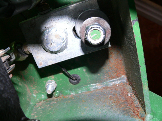

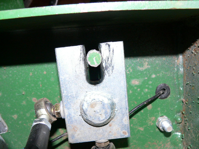

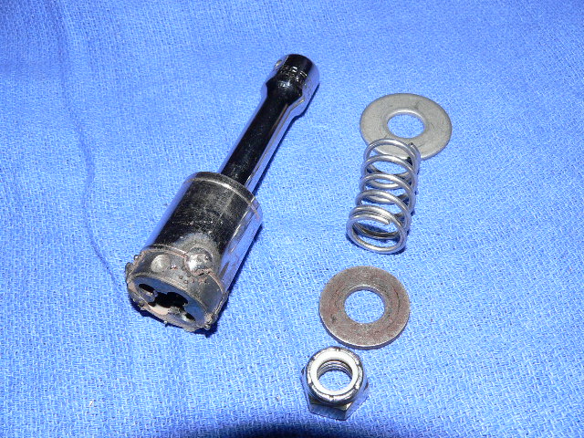

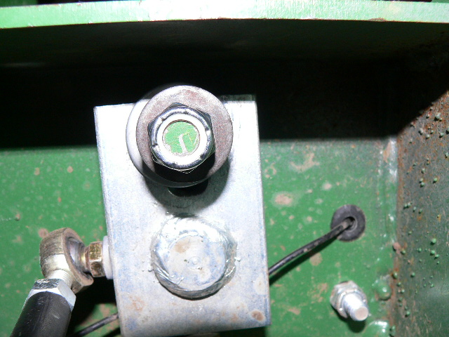

Here is my attempt to add a bit of pressure to the joystick assembly to hold it in float mode. Pictures save me thousands of words so please have a look at what I attached.
In short, my joystick has a block at the base and a piece of round bar stabilizing the movement of the joystick. Leveraging those two features I cobbled together a die to cut 7/16 x 14 threads into the rod as far up as I could go, cheap HF tools made it easy to sacrifice a socket and die to the welder. Then I played around with springs till I found something that pushed the joystick forward while in float mode but also allowed full travel of the joystick. The joystick is a bit tighter but so far no other unintended consequences have emerged. It's raining here so I don't think I'll get to test it out this weekend but once I do the report will be posted here.

Well we finally had a dry day when I could cut a bit of grass. I am happy to say that the added tension of the spring worked just as I had hoped. I never popped out of float while cutting. I must say, this looks like a best practice!

OK, this looks real good, but I can't quite understand the pictures. Could you take a few more. I want to add this to my machine and get rid of the bungee. Nice job.

Hey swampman, I also did your mod and second the notion that it works.
Thanks!!
Although, instead of threading the post i used a 3/8" set screw locking collar.

That's a good idea too. Another idea may be to drill a small hole putting a cotter pin through it, holding the washer and spring against the block. Threading a nut onto the post, or using a set screw collar would be slightly more "adjustable" though.
