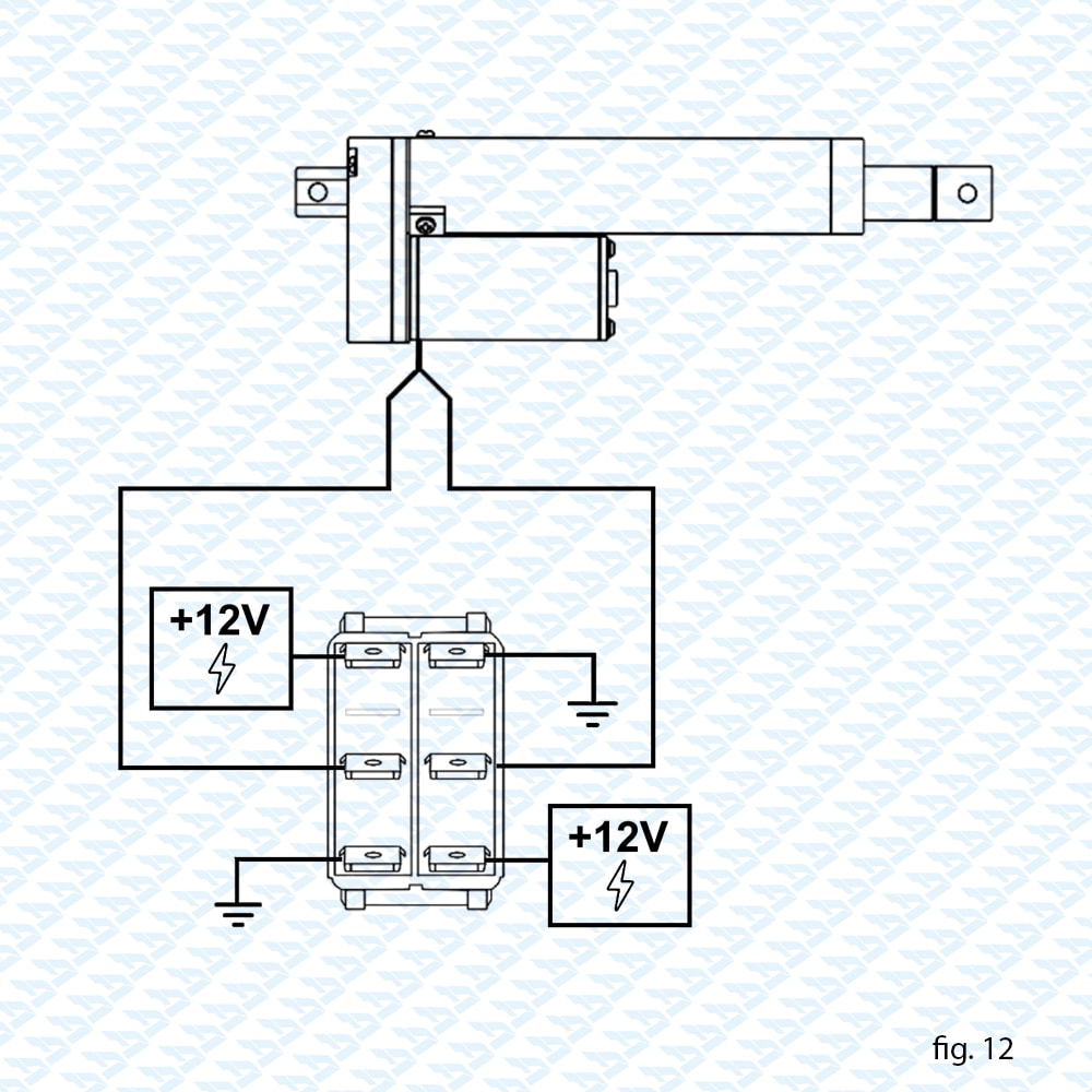

yooperterry
Member
Oct 10, 2019
33
SAult Ste Marie Mi
John Deere 2025R
So I purchased a 2no joy stick switch to build a control for my frontier SB1154 shute. However the switch does not have a diagram for the elec. connections?? There are 4 screws for connecting the power and control for the direction you'd want the shute to move. But if I were to connect a + & - that only leaves 2 connector screws for power out? Anyone know how these things are wired for this type of control?? Thanks
   / Joy Stick from ebay #2
I'm guessing youre planning to use a linear actuator for movement? The actuator only has 2 wires? A momentary double pole, double throw switch would work.
   / Joy Stick from ebay #3
Typical of how to wire 2 axis NO joystick... IF you need to change directional control (up/down) to coordinate with Acton of a linear device reverse the polarity of DC voltage supply...
